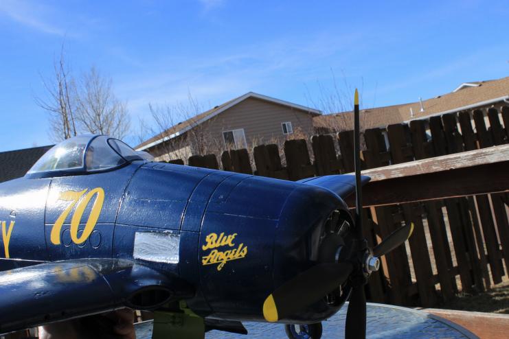

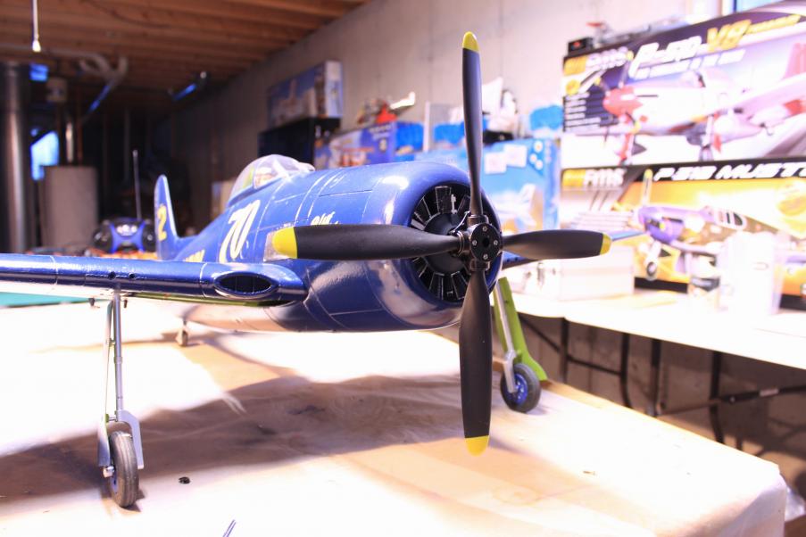

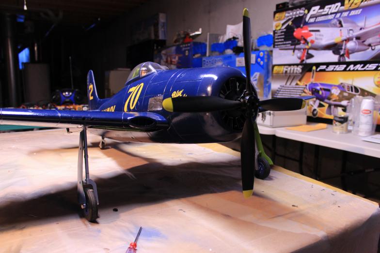

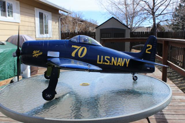

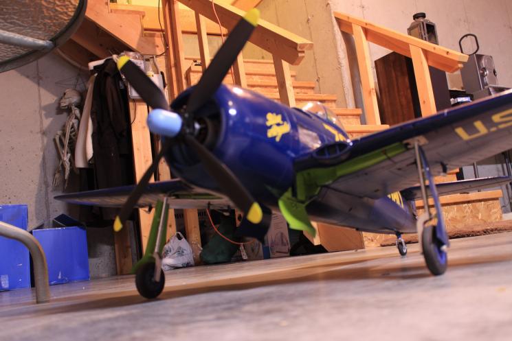

            Got the new 650 kv and Mantis ESC in her last night along with that big Corsair prop!!

ID:	66512 Looks great an with the battery back a bit, it looks like a CG at 81mm, right where she was. I'm not wild about the honkin' Blue nose, so that's got to go, hey Bob, what did you used for a nose cone? Hard to tell from the pics.
            You'd have to stand her up a fair amount to dig the prop into the ground , which is great, but this is such a great flying bird, I'm hoping she stays that way. I have to admit, that prop looks totally awesome and sooooo right!!
            It's a pretty simple swap out, the motor mount holes have to be redrilled as it won't fit into the original holes which are positioned at 12, 6, 3 and 9. The six position will hang down below the firewall, so it has to go on in an 'x' manner. The floor board of the battery compartment comes out with four screws and its super easy to swap everything out. The only problem comes with the fake radial, you have to lose a lot of the center hub in order to get it to fit over the 650 and also allow cool air to flow, so I have a little more trimming to do
            In the meantime, I'm just going to use a washer and nut to retain the prop rather than the big blue nose until someone gives me an alternative.

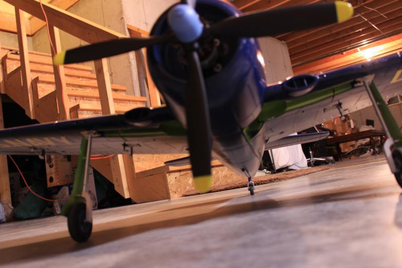

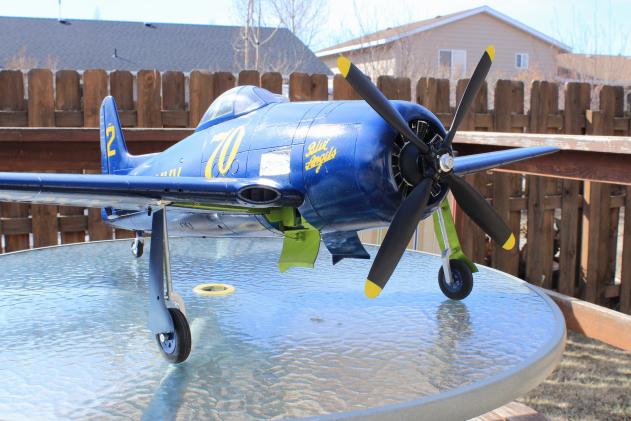

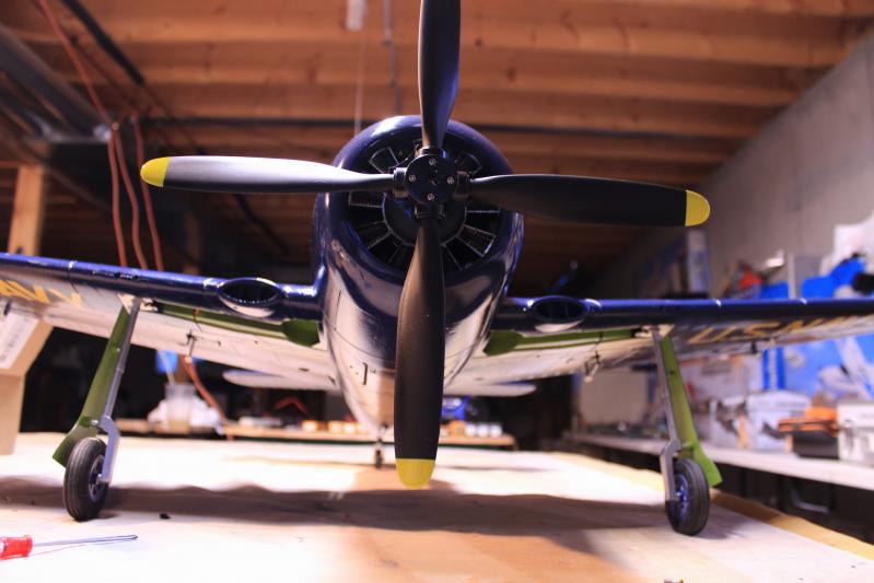

              Holy Crap!!
              Just got all the bugs worked out of the Bearcat, nothing major had to widen the opening on the fake radial and cut a small groove into the backside of it to allow for the fins of the 650kv.
              Put the prop back on, straddled her and ran her up!
              Holy Crap!!
              I didn't even hit full throttle and she was screaming and the wind was unreal!!!
              This could be what you'd call unlimited vertical

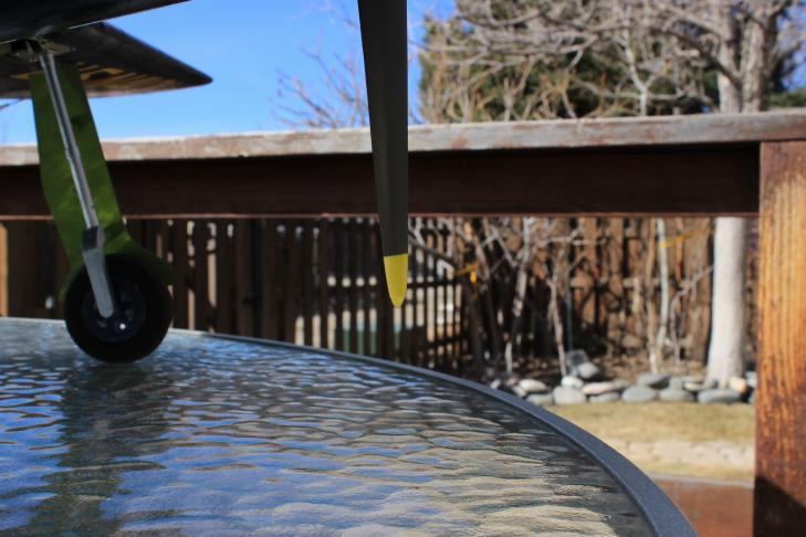

              Click image for larger version  Name:	IMG_9493.JPG Views:	1 Size:	48.7 KB ID:	66639 prop clearance Click image for larger version  Name:	IMG_9494.JPG Views:	1 Size:	52.6 KB ID:	66640
              as you can see is pretty good Click image for larger version  Name:	IMG_9495.JPG Views:	1 Size:	47.2 KB ID:	66641 you'd have to land at this angle before she'd touch her prop, which is pretty tail high. Click image for larger version  Name:	IMG_9498.JPG Views:	1 Size:	54.6 KB ID:	66642
              got rid of the dorky blue nose and just went with the straight washer and bolt, looks more stock that way.

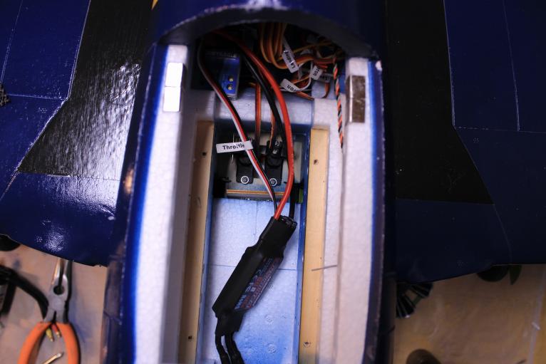

                            Here's mine all together now, minus electronics and decals...Mods include 16" prop (from 1600mm Skyraider), FMS 4250-KV580 motor, ZTW Mantis 85A ESC, and BF-109 retractable tail wheel...will be flying with 4000mAh batteries...will be installing gyro as well...
