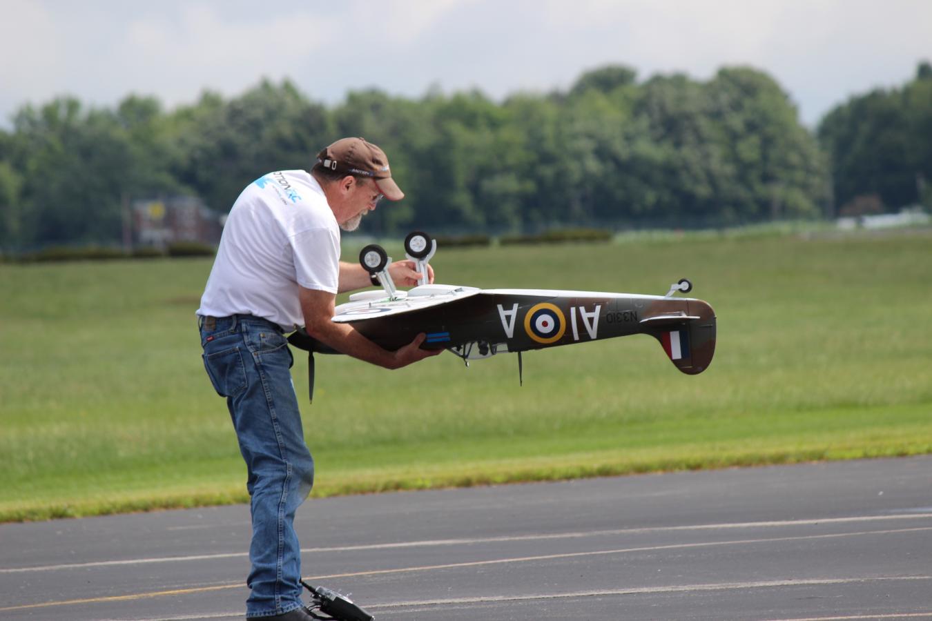

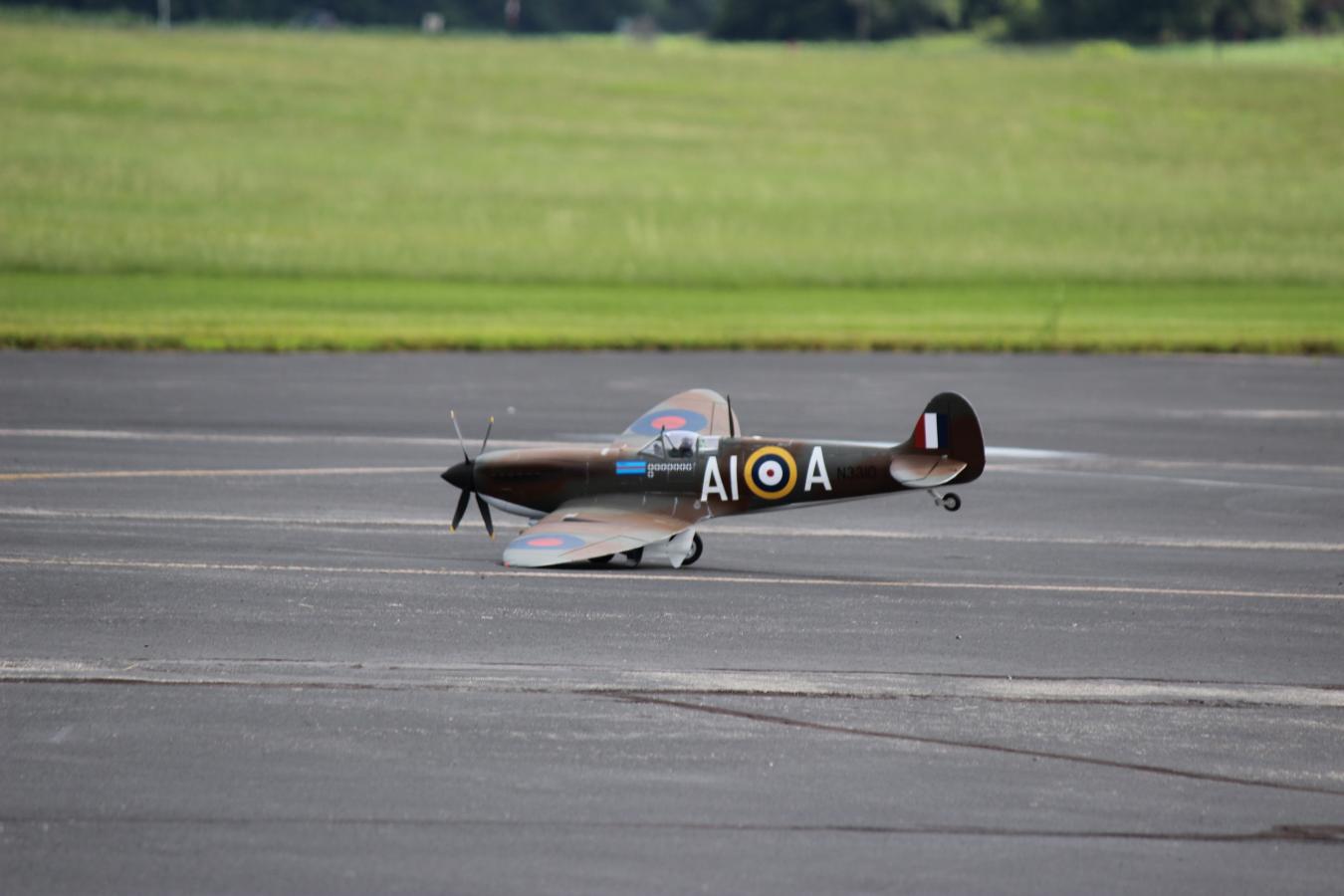

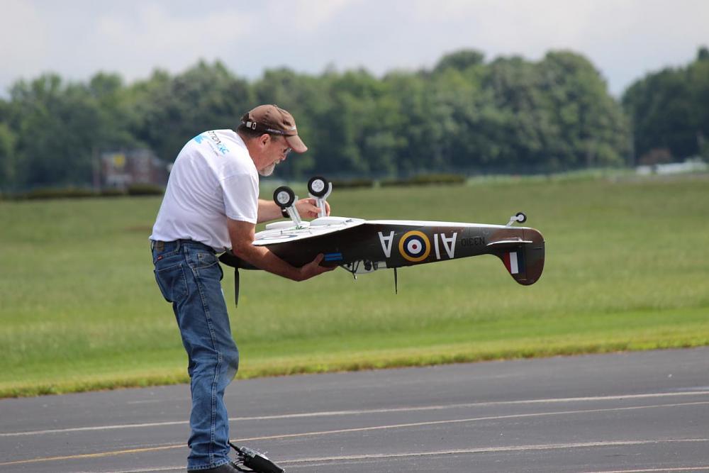

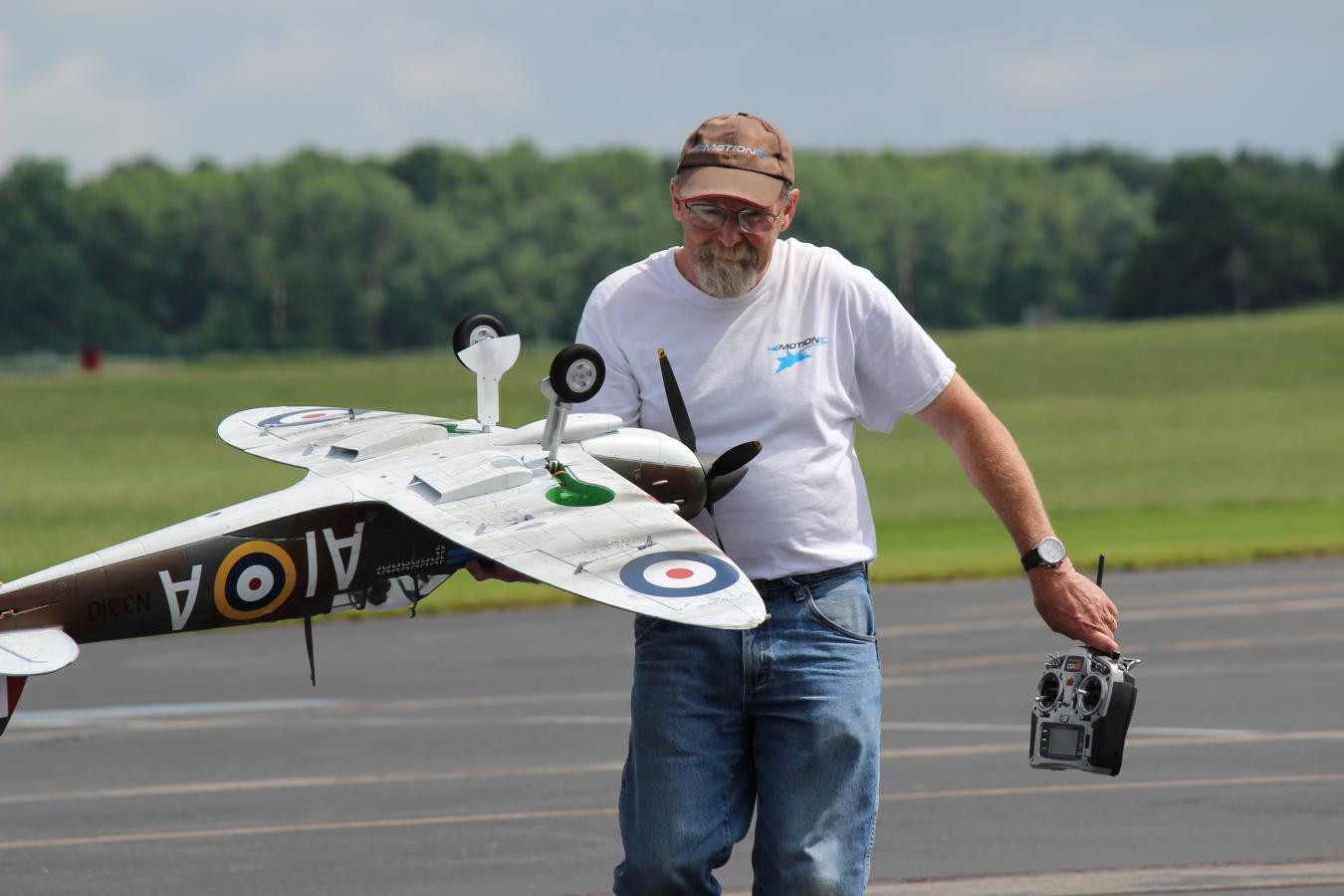

    The undercarriage mod works great, it makes taxing and take off run a breeze.
    It nosed over on the first landing and discovered the wheel spat had dug in and snapped half of it off.
    Second landing was a great 3 pointer without any hesitation of nosing over.
    I might repair the spat and round of the leading edge, but remove them until the grass is cut again.

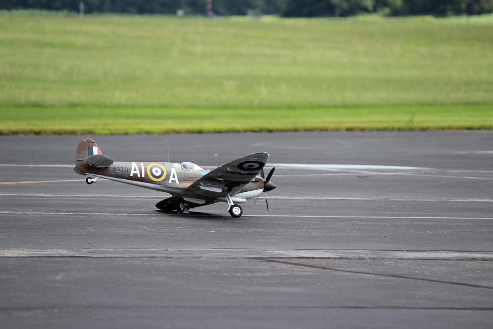

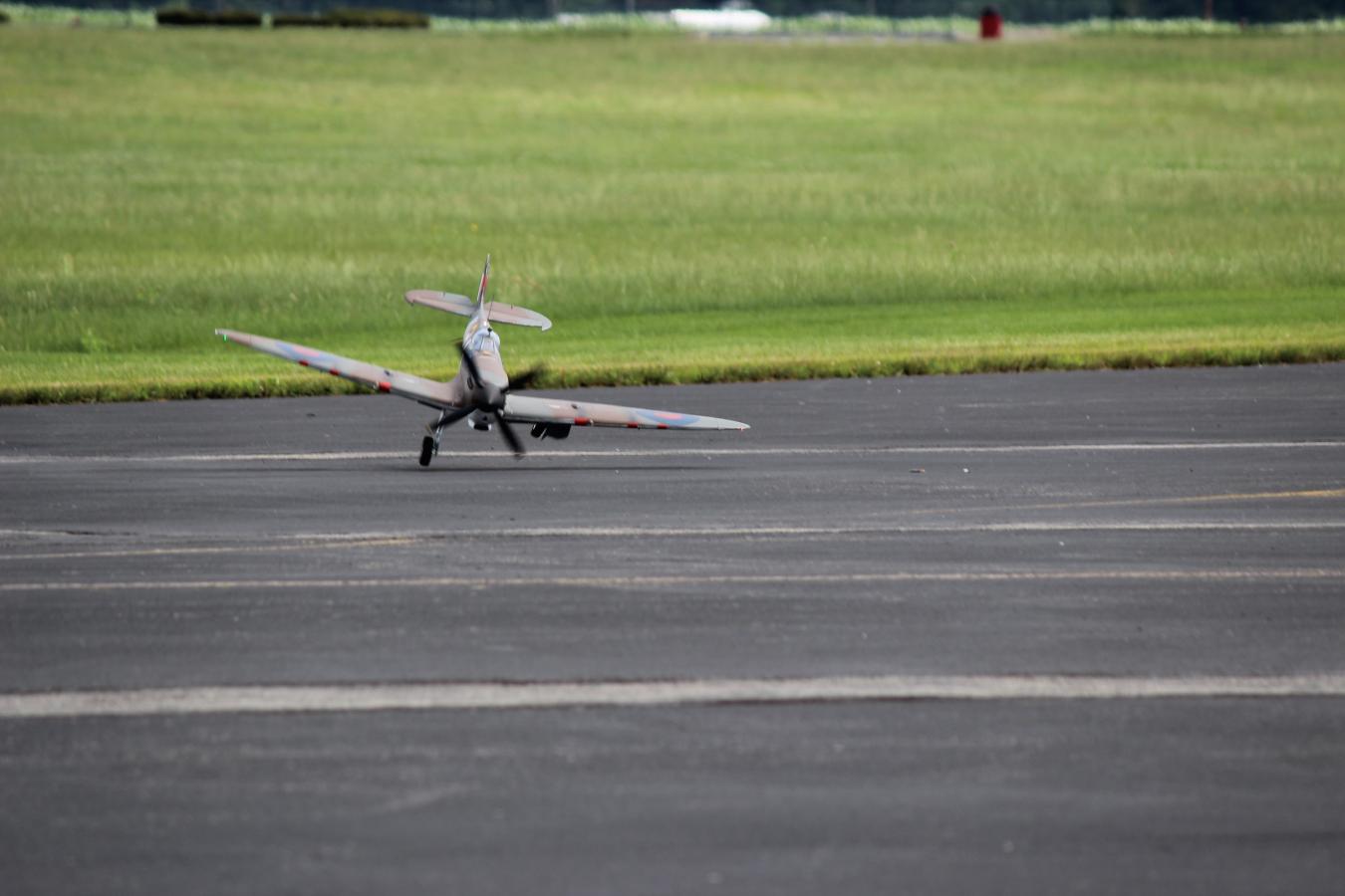

    Youtube link received from a friend of my Spitfire landing last Sunday
  • royhdg

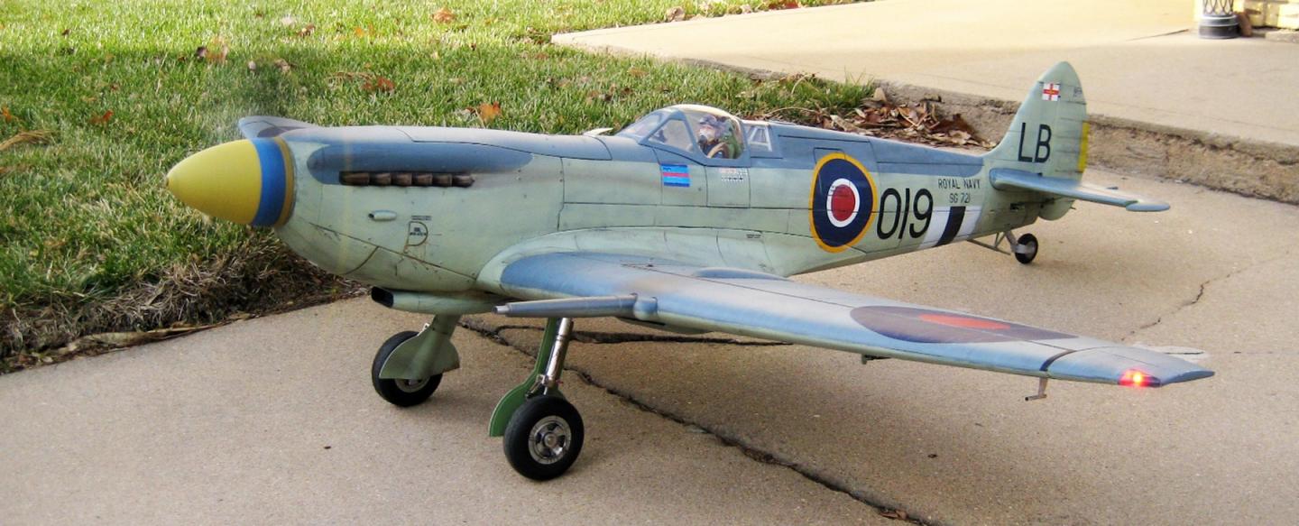

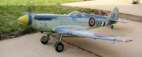

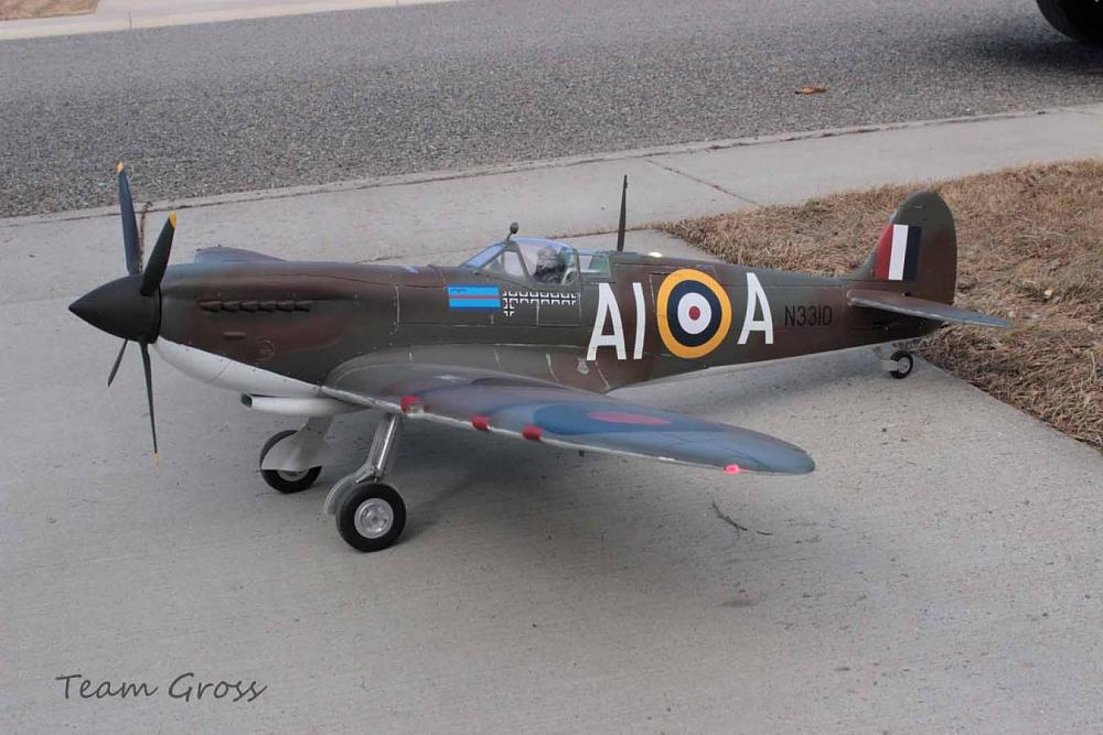

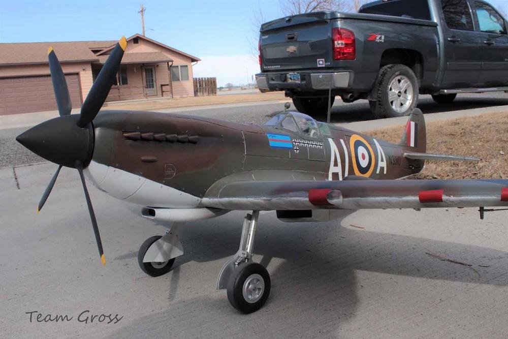

    Most have seen the results on my Spitfire, but to save you the time of scrolling back..
    Grossman56 Click image for larger version
