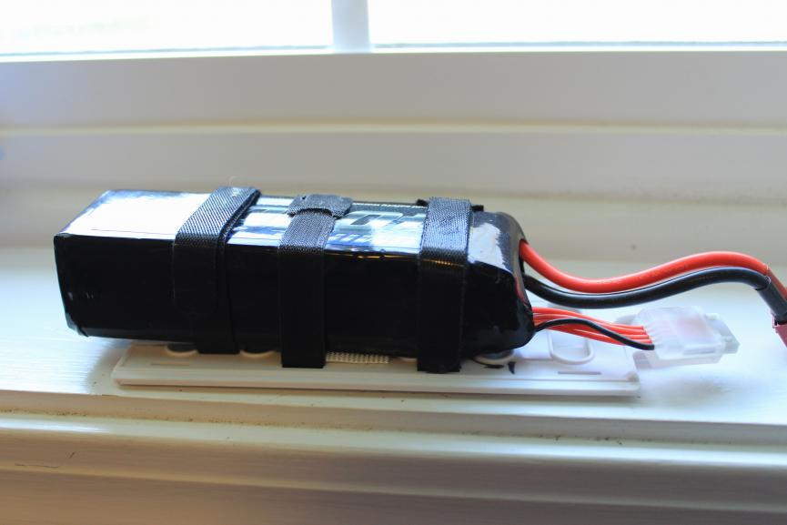

                            Nose weight? It don't need no stinkin' nose weight!!LOL
                            A nice chunky 4000s set slightly forward will do the trick. Just ran downstairs and yanked the tray out of my P-40. I left the battery in so this is exactly where it was on the last flight yesterday.

                              That's how I like to control weight with added battery. 2 good things come from it. 1 longer flight time, 2 better current capacity

                                Puts a better definition on the term 'dead weight', give me more gas any time!

                                  Exactly, and it'll be like running premium fuel over 87. You know that "cleaner burn" :)

                                    I prefer not adding dead weight as much as you guys, but I was running into issues trying to balance at the 55mm mark recommended in the manual. 70mm is working a lot better. Now if I could get the weather to cooperate I am ready to maiden.

                                      :Confused: Jim..........these guys(including myself) aren't adding dead weight at all. A 4000mAh is a perfect weight for hitting the CG of 70mm and is at the top end of the recommended battery range.
                                      Must be you missed my response to you on post #13 ;)

                                        Charlie's right Jim, I fly mine right where the picture shows it and my 3600's are slightly, and I mean SLIGHTLY more forward than that. This plane flies great! I must admit though, and I'm probably being picky, I prefer flying it with the 4000's.
