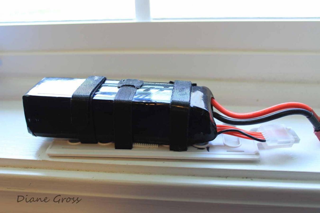

            The battery tray just slides into the airplane, the small triangular locks and the finger ring go towards the rear of the plane. When you push it in you'll feel it snap into the locked in position. As for the tray itself. it comes with a Velcro strap to hold the battery in place. I augment this by putting Velcro on the bottom of the battery and the tray and added two more straps to further secure it...
            Click image for larger version  Name:	IMG_9781.JPG Views:	0 Size:	79.2 KB ID:	197559 Here's the position of the 4000 4s battery I used when it was a 4s system, I've since upgraded to a 6s system using a 4500 6s battery.

              I personally think that 4000 packs work best. They balanced out perfectly in the middle of the battery tray. I have a 5cell pack that was the ticket, but I'm not sure I can find many more of those.

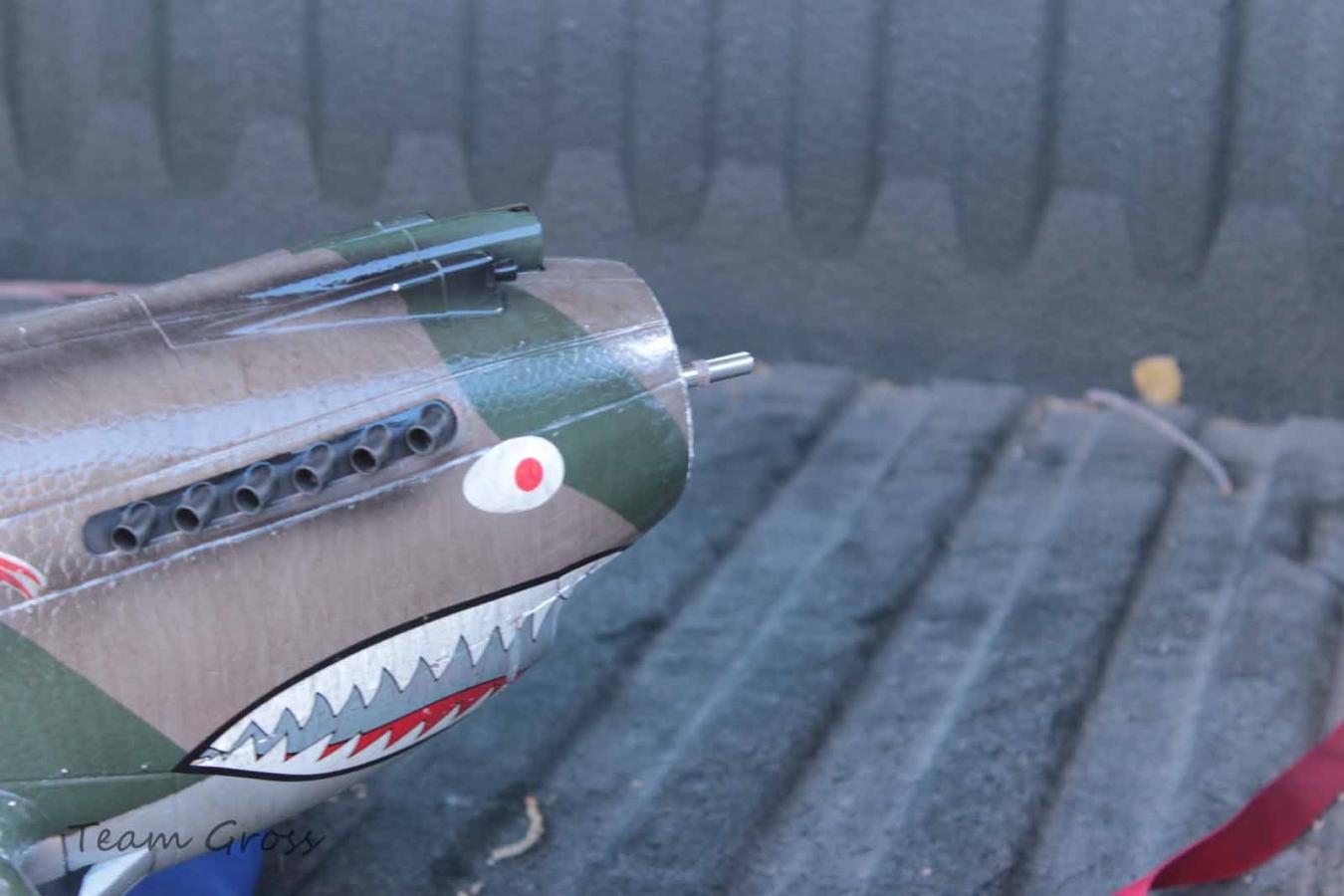

                  So, we had our Spring Fly In yesterday and the day before. Actually yesterday as Saturday was a wash out.
                  I'm flying my P-40 and I'm down at the East end of the runway, I notice she's not responding the way I would expect. I try to speed up and I've got no response. "Hmm", thinks I. Dead battery?? Seems odd as I've done on lap so far and lately I've been able to get 10+ minutes on a battery. So I drop the gear and get her on the runway, quite far down and I notice something peculiar from a distance. "No way!" thinks I, but "Yes way" is the answer. She has no prop or spinner. Sure as all hell, everything from the fuse forward is gone except for a small washer-like piece of the spinner base plate. Upon inspection, I found no damage at all to the rest of the plane. Weird thing is , I never saw anything fly off the plane, so its out there somewhere in the sagebrush...

                    Remember me telling ya last fall about the stock prop/spinner not liking the 4258-460kV setup.
                    After two back to back flights where I shredded props, switched over to a MAS 14x9x3 with the Nitroplanes version of the FMS P-40E spinner.
                    By the way, these failures happen shortly after getting back home from showing it off to you at NEFI.
                    Ever since then...........no frontal explosions in high speed power dives ;)

                        Yep, I remember, I was hoping to get that info. Don't know how much I'll be buying in the future, just got my lay off notice today, last day on Aug 12.
                        Anyway, it was strange, I didn't even see it leave the plane!! Probably a good thing as I kept my cool and landed with no damage to the plane. Even the props sudden exit didn't do any damage. But some dummy left her on a glass table in the sun:Sweating: and she gatored back up:Angry:wonder who that was:Thinking:

                                          UPDATE UPDATE!!!:warning::warning:
                                          This just in, two guys wandering the back forty of the field came across the aforementioned P-40 prop, well at least the spinner back plate and the blades, all in surprisingly good condition. The center of the back plate was ground out as that was what was on the prop shaft. I'm still not sure how the front spinner piece came off, must have unthreaded itself once the spinner was spinning freely from the prop shaft which means that out there somewhere the front spinner and even the screw could be sitting in good shape too. They found it almost directly in front of the runway, and out a few yards. This means that I did half a circuit and landed without so much as a scratch without a prop...In a warbird....Chalk it up to dumb luck I guess.:trophy:
