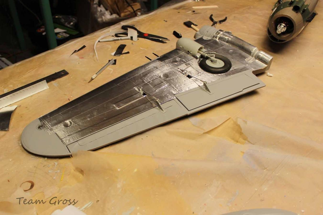

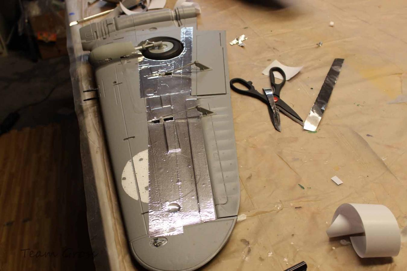

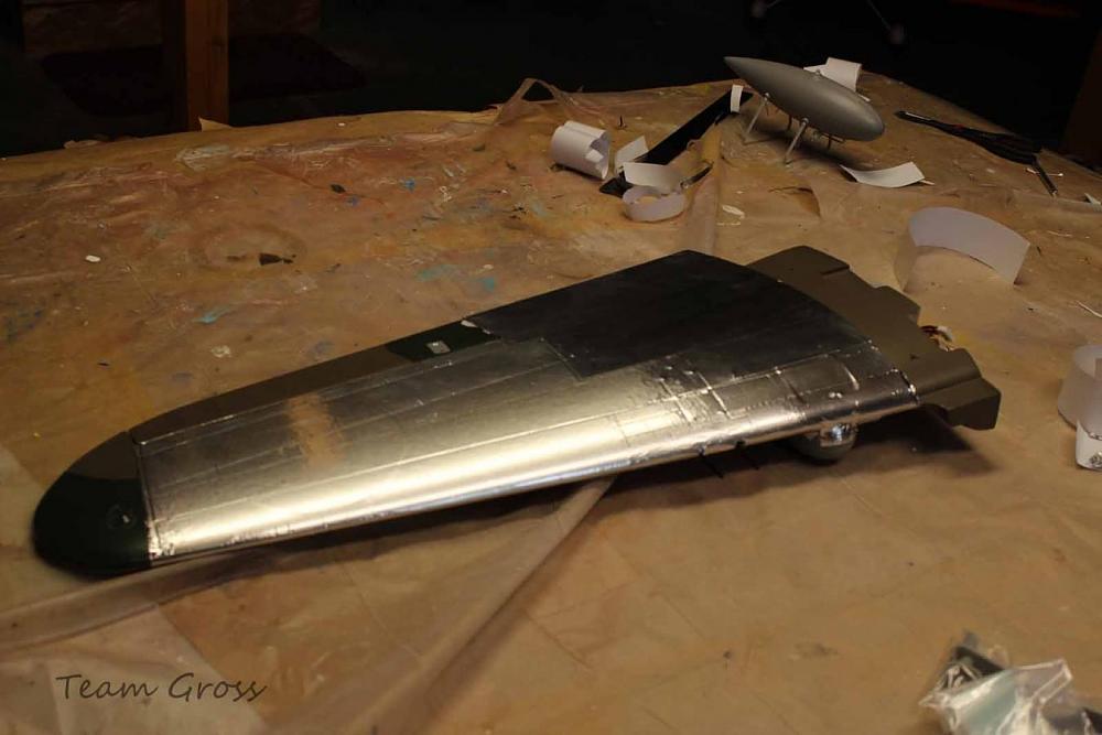

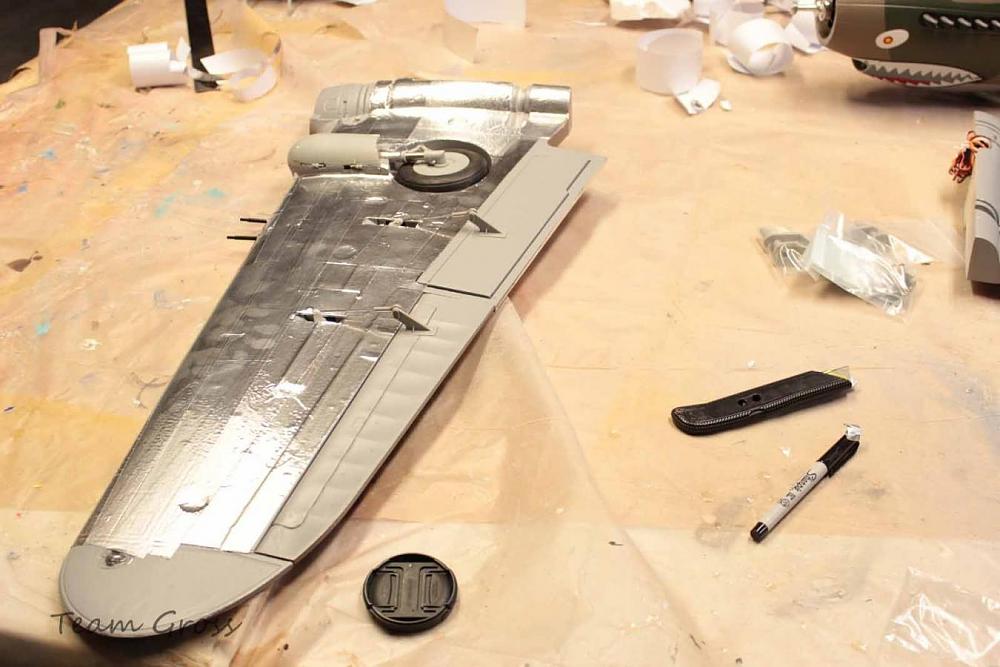

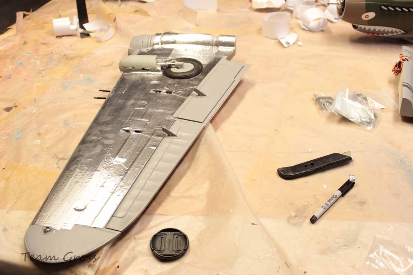

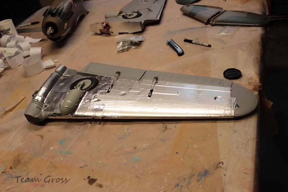

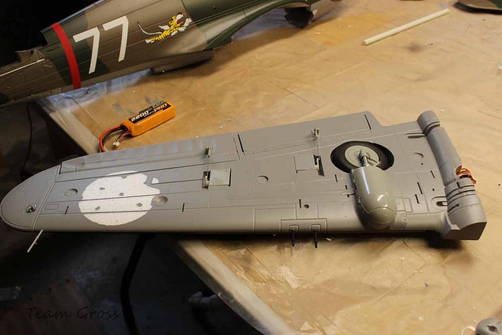

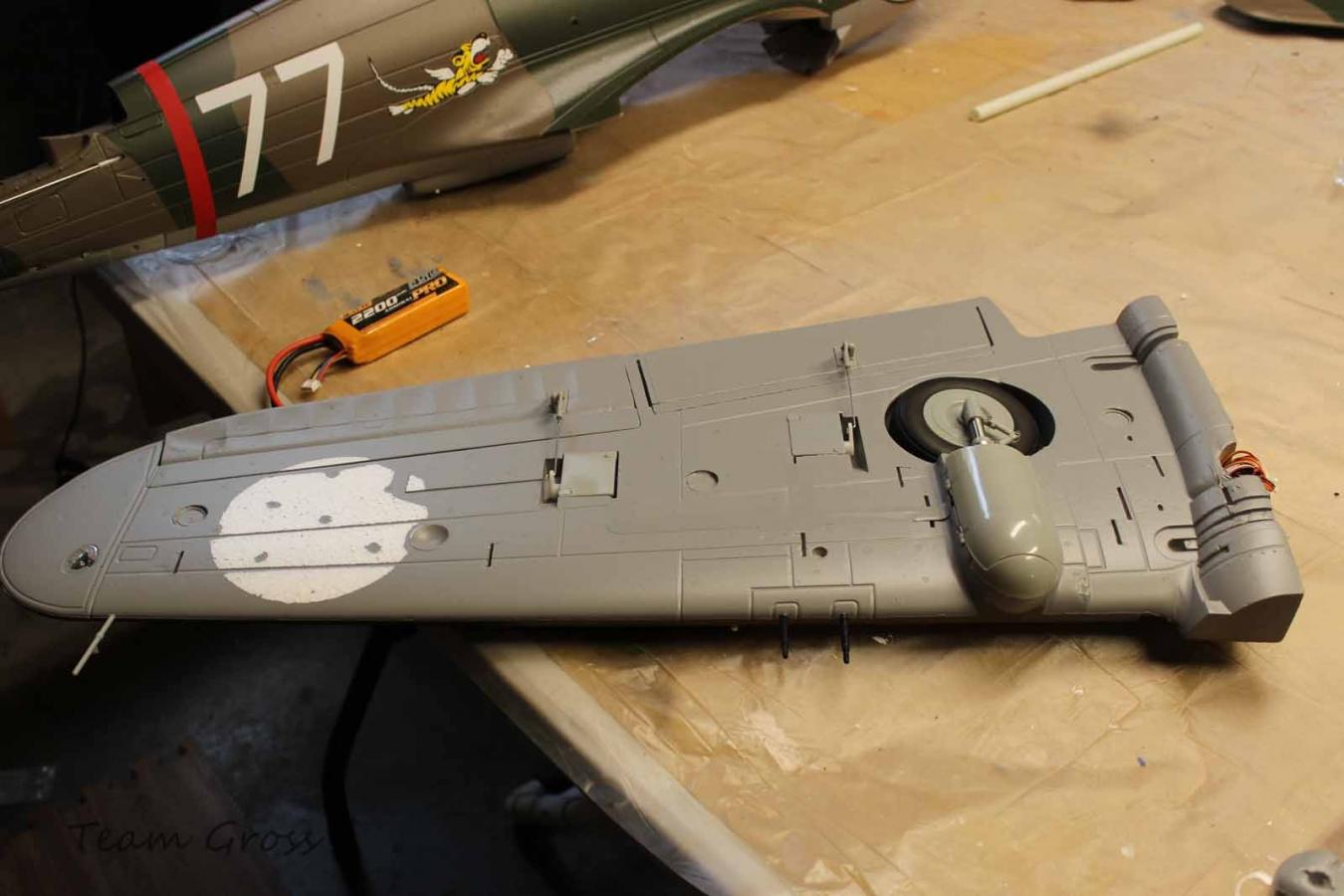

The decals on the lower wing were very loose with the corners already peeling up. As if they wanted to come off, so I obliged them!
Then, into the fun stuff!!!

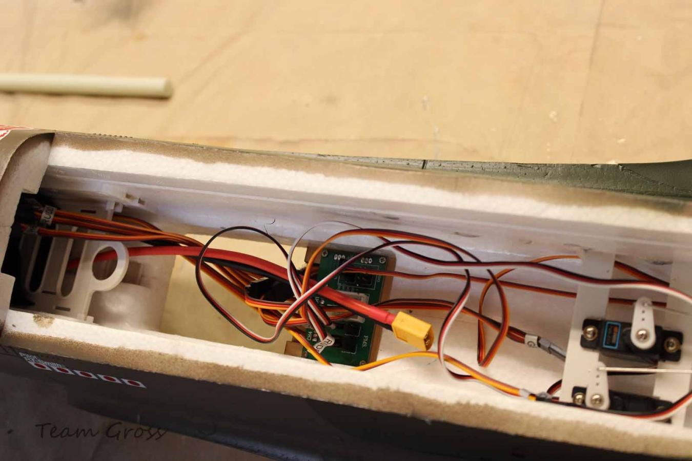

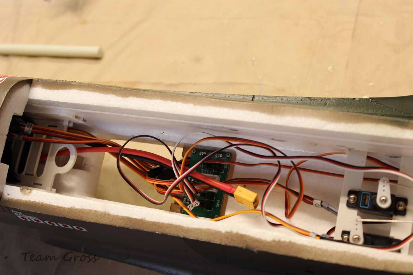

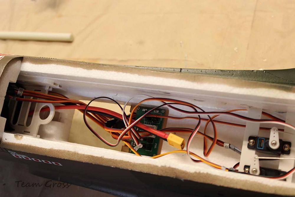

I did notice that it came with the infamous Predator ESC, which I think, for piece of mind if nothing else, I'll swap out.

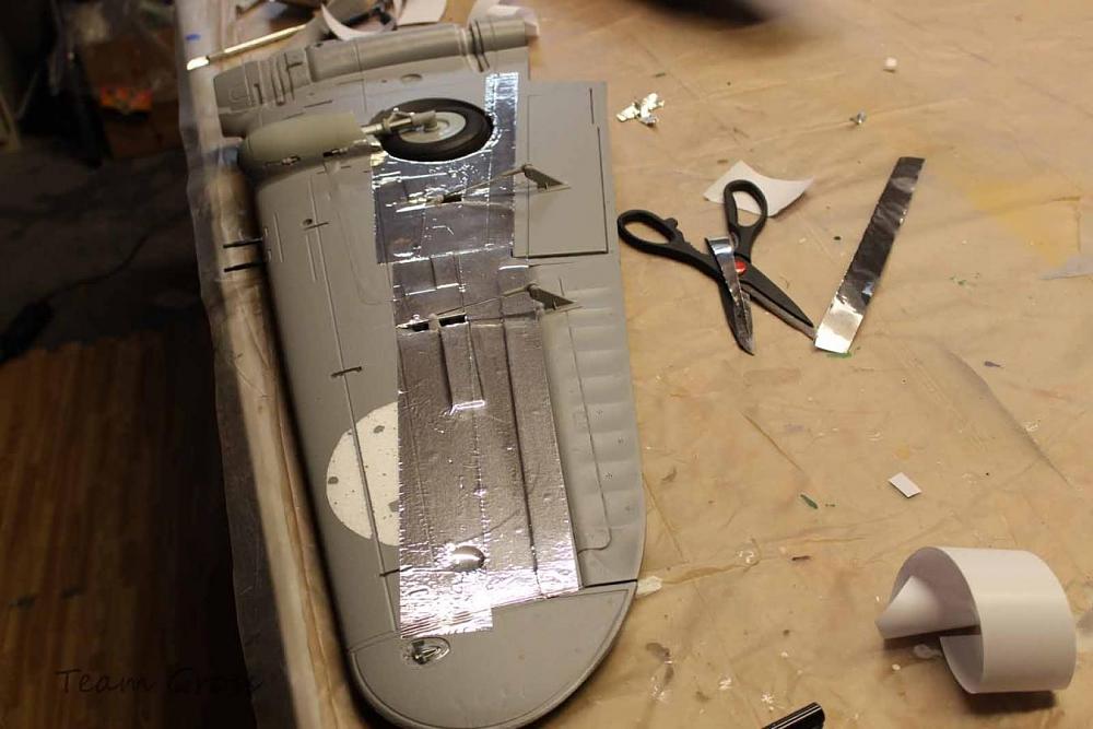

You'll notice the different sheen on the underside inboard of the wing. All I did was run the tape from front to back rather than side to side and it gives you this effect.
More to come!!!!
Grossman56Team Gross!Comment

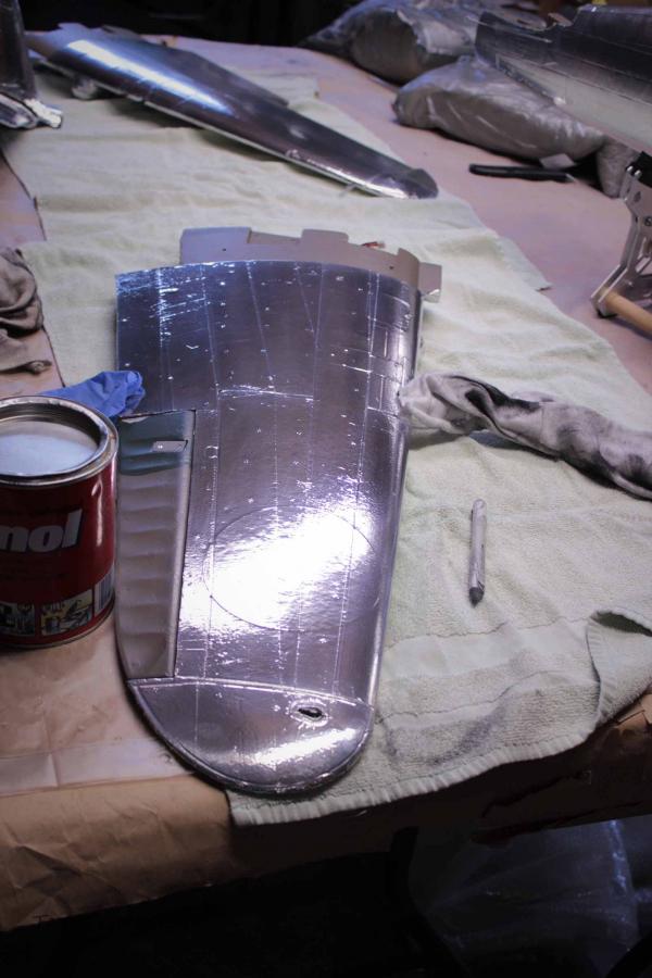

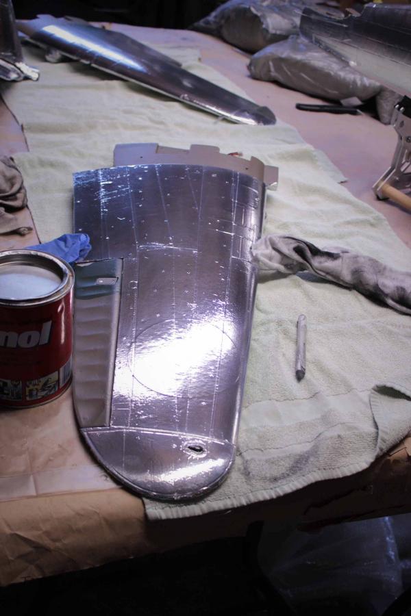

BTW, I use Wenol for polishing the metal. I still have two quart size cans left over from my DC-3 polishing days, it's coming in very handy with these shiny airplanes. After the tape is laid down and sits for a bit, the tension seems to relax, by polishing, its amazing how much more detail will pop out from the surface and how many imperfections can be rubbed out. I've compared the finish to the Flite Metal on My Little Gal II and the Flite Metal is more mirror like, but the tape gives a great authentic look, you'll see when she's done.

Edit: I finally received my new ESC from Motion RC yesterday. Going to swap out that predator ESC. Thanks again, everyone!Happy flying!Comment

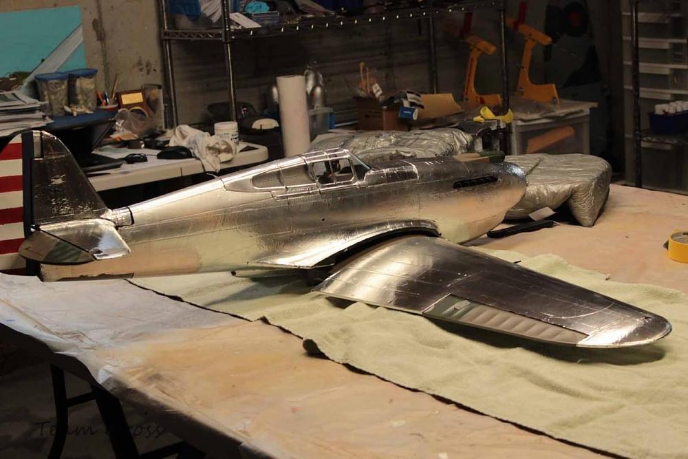

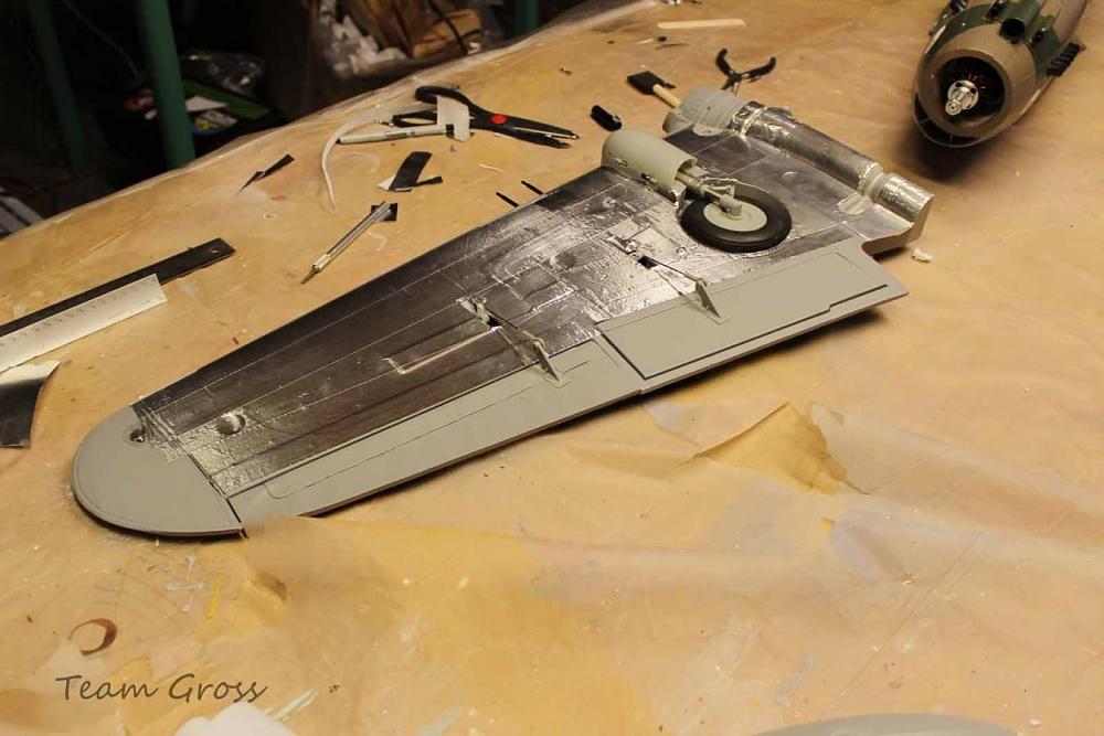

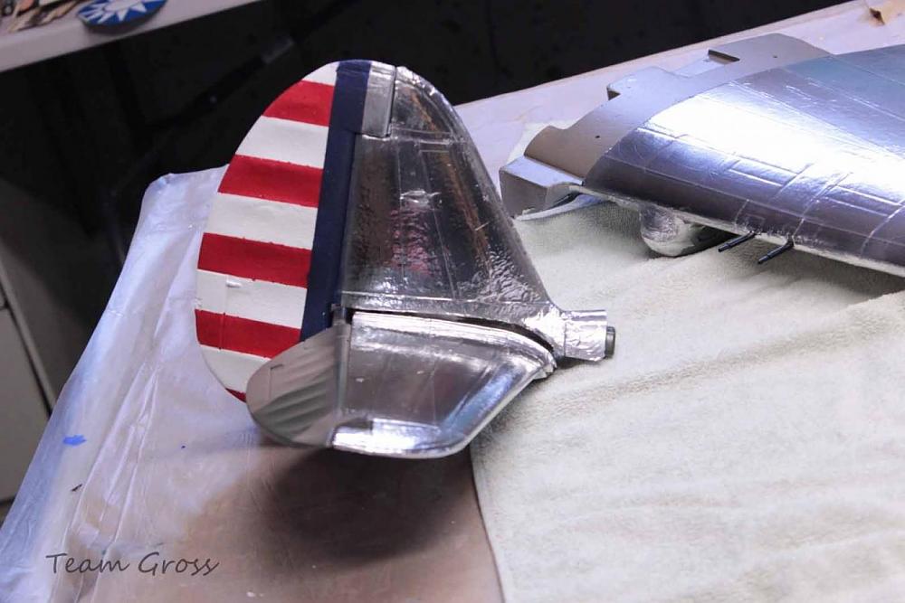

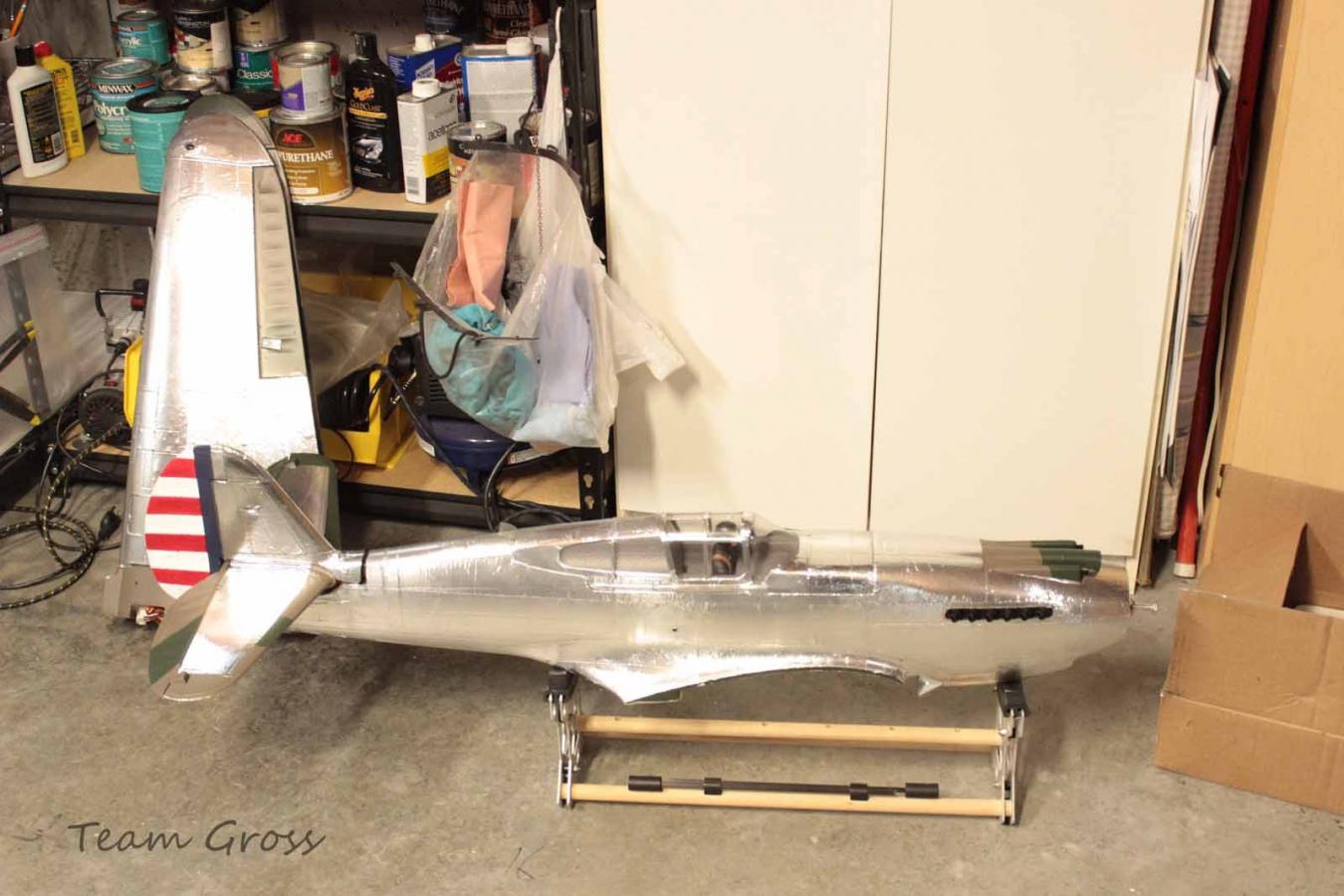

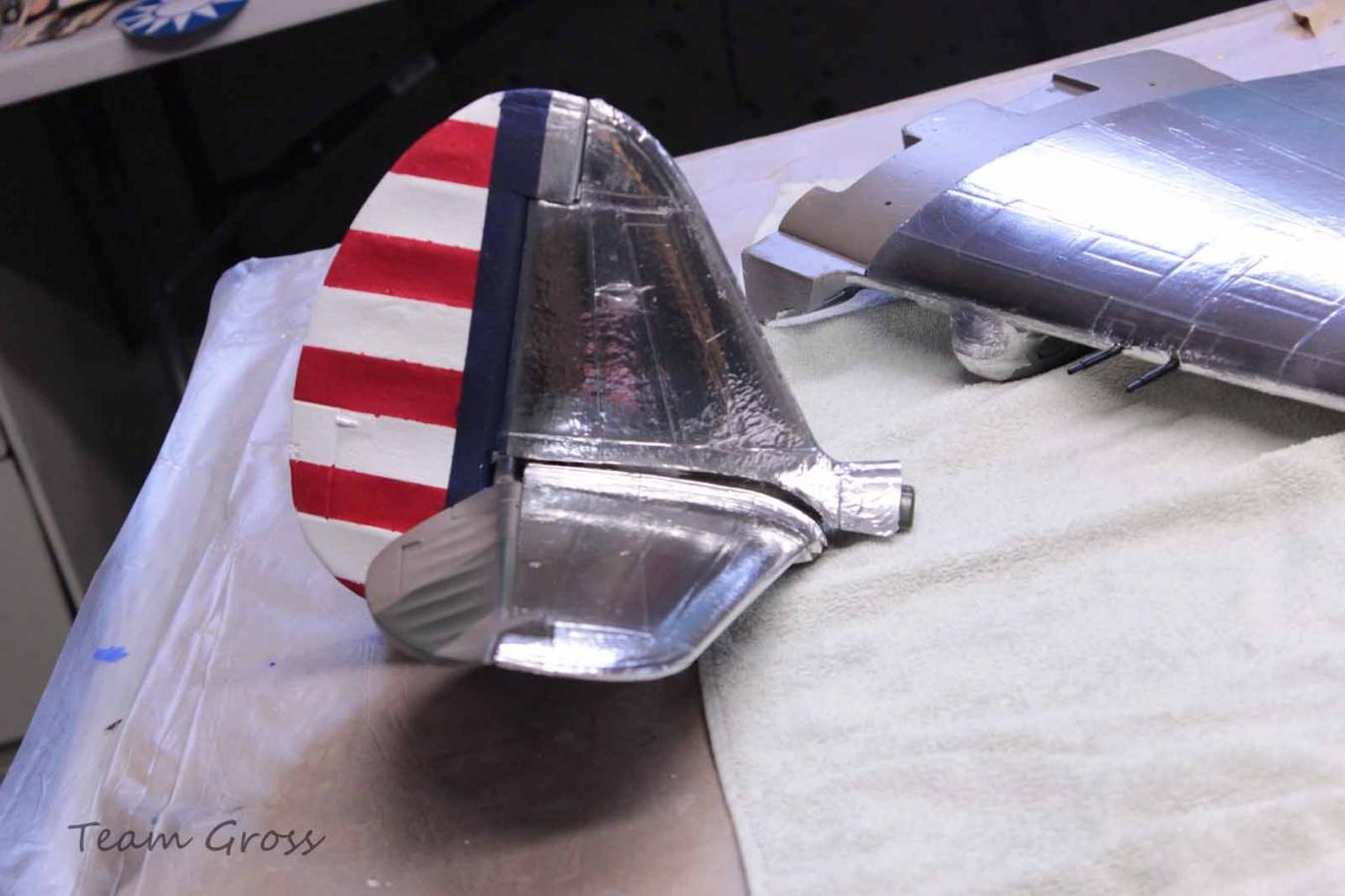

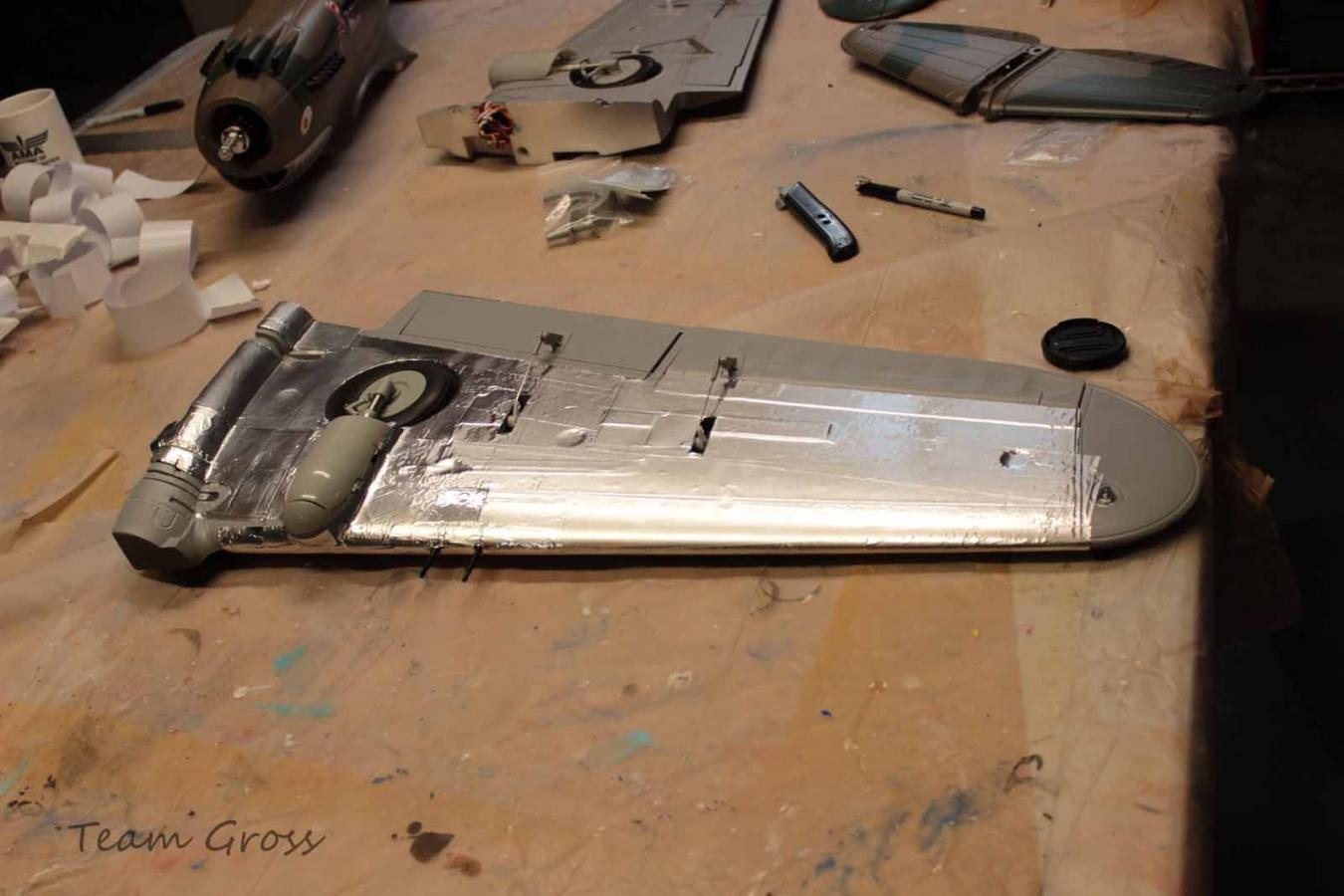

Here's an update on the P-40! The new fuse is complete, one wing is done and the horizontal stab has most of its covering on:

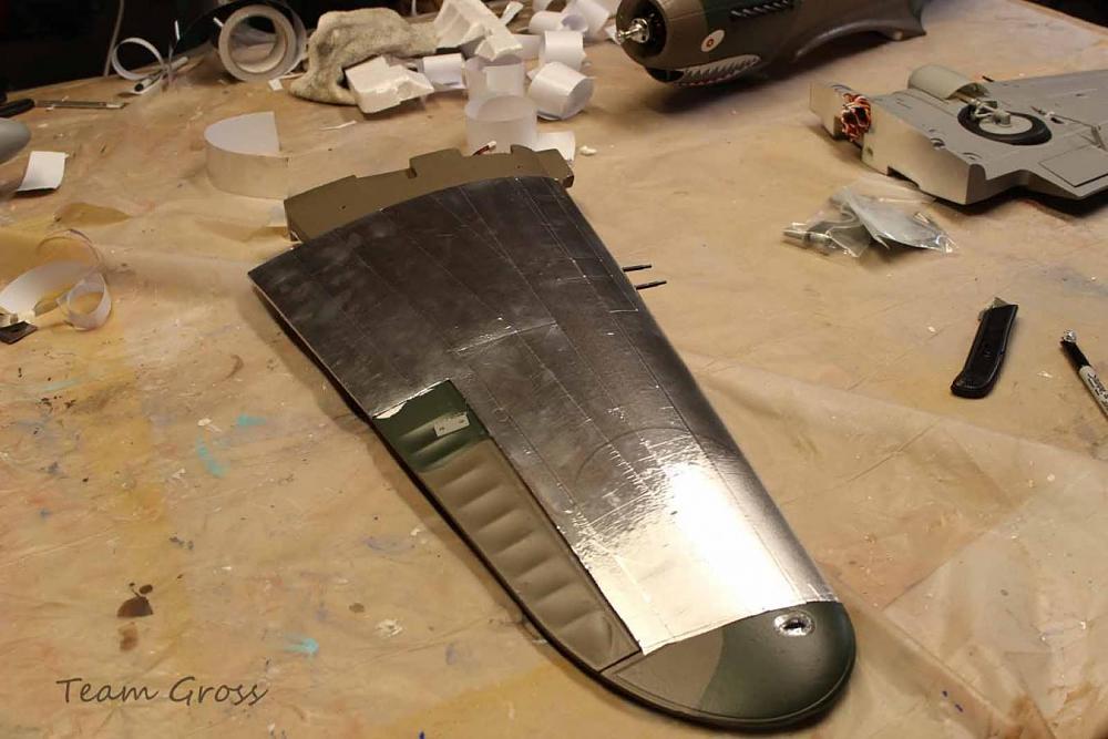

Other than the cockpit hatch, nothing has been polished. I managed to cover the air input 'jaw' and it looks great. The cowl flaps are going to be painted red, white, blue, red, white. Decals have been ordered from Callie Graphics, just the basics the prewar insignias top and bottom of the wings and on the fuse and also the 'U.S Army' on the underside of the wings. One more wing to go, the top of the wings is very easy, the bottom is slightly harder because of the flaps and the retract housing, will probably have to paint those with chrome paint as well as the fuse guns and the rear retract doors and the panel forward of them. I didn't want to cover the little panel in case I have to get in there at some point in time.
Team Gross!Comment

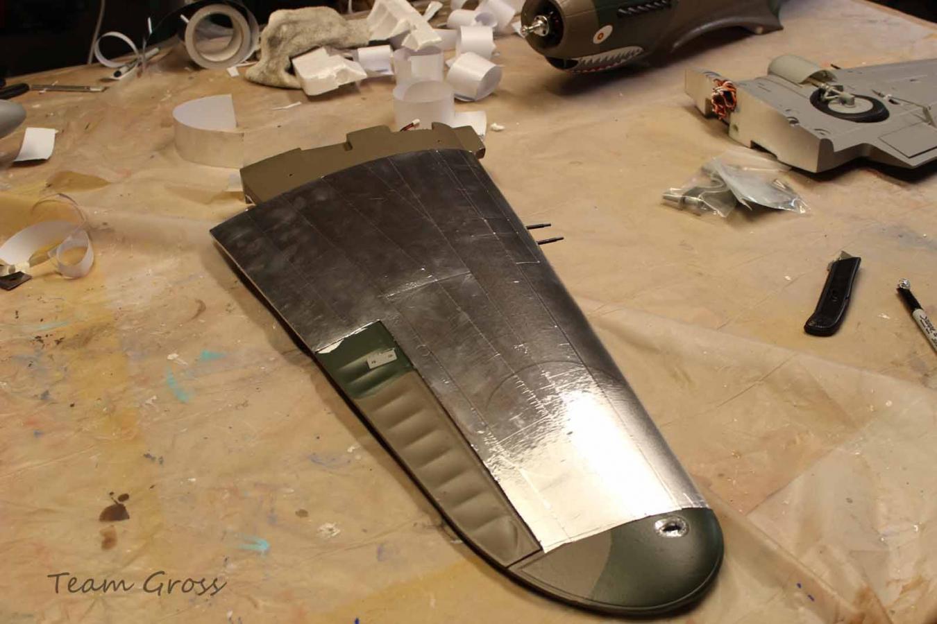

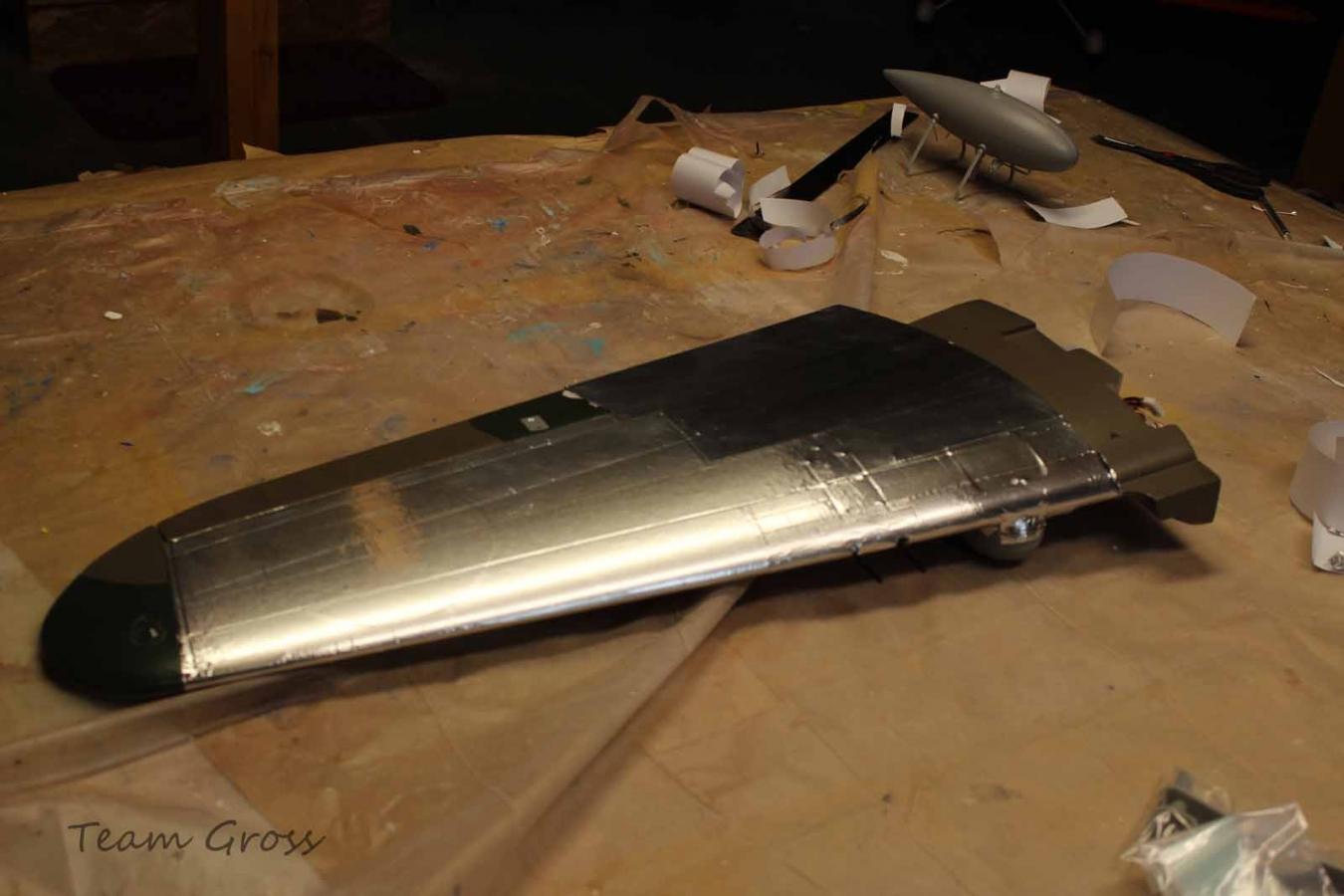

Finished up the metal work last night! I was just getting the hang of it again, dang!
I was looking at the rest of the fleet through the corner of my eye, and they all ran and hid!!
So, now the polishing begins, which will probably take a couple of nights and into Saturday, then I'll paint the walkways on the wings and all the control surfaces will be painted silver. I'll use the chrome paint for the gear doors and the fuse guns, it does a pretty good job. Got decals on order from Callie, being shipped on Friday.
Once she's polished, you have to handle her with gloves on as fingerprints don't look pretty. Can't wait to see her assembled!! Going to look so cool I'll get more pics once the polishing is done.
BTW, I found the best way to apply the tape is to tape off the edge of the piece you're mating up to, leaving about a 1/16th" overlay. Always work from the back to the front so the overlay works with the wind . On the upper part of wings, I worked length-wise, cut the piece a little longer than what I needed (approx. 1/4"). Put it in place and used tape to secure the side that I was going to smoothen towards. Started peeling the backing, stretched the tape away from the taped end and started laying it down, using a blending stump or as they call it in the videos, a burnishing stump, to smoothen it out as I worked to the taped end, pulling some more backing off as I went. Once I was near the end of the piece, I'd release the taped end and pull the remainder of the backing off and smoothen the last of it. A little cut with an exacto knife where the tape goes under the metal and then pull the tap off, it will cut an edge right along the tape edge. It worked very well.

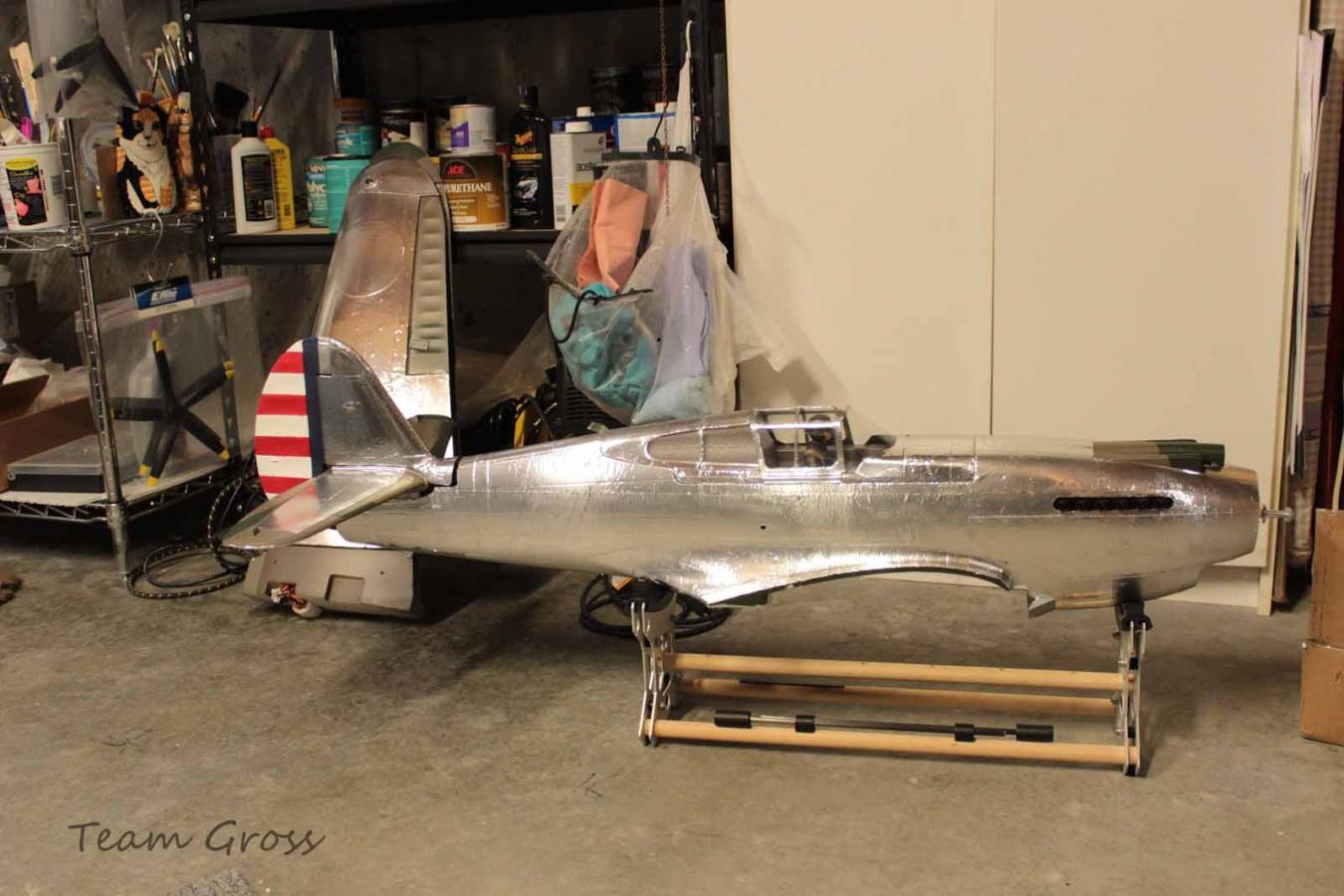

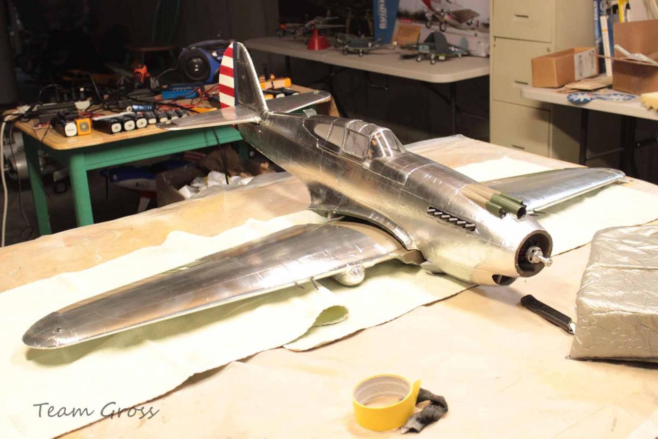

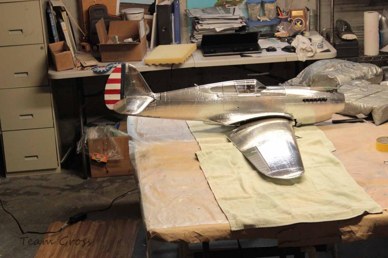

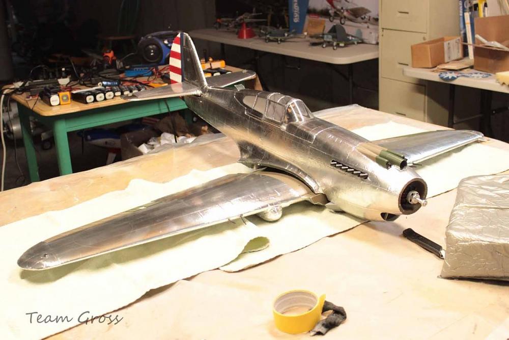

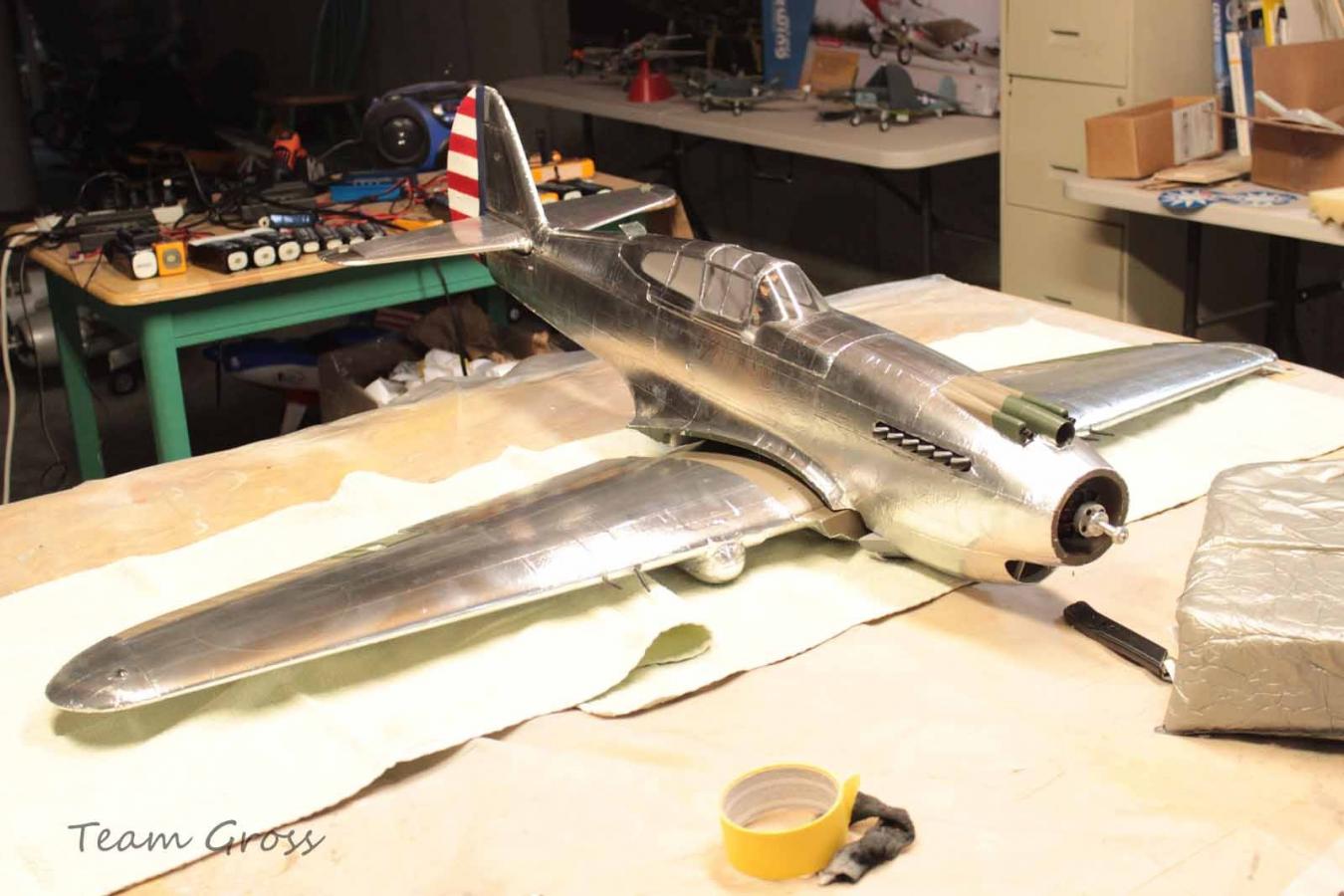

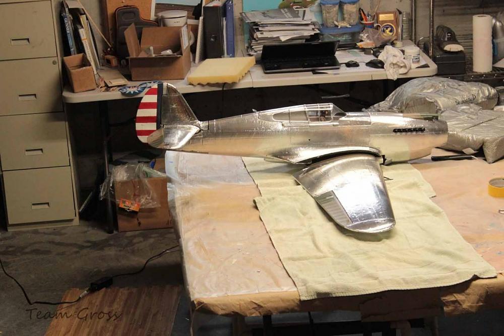

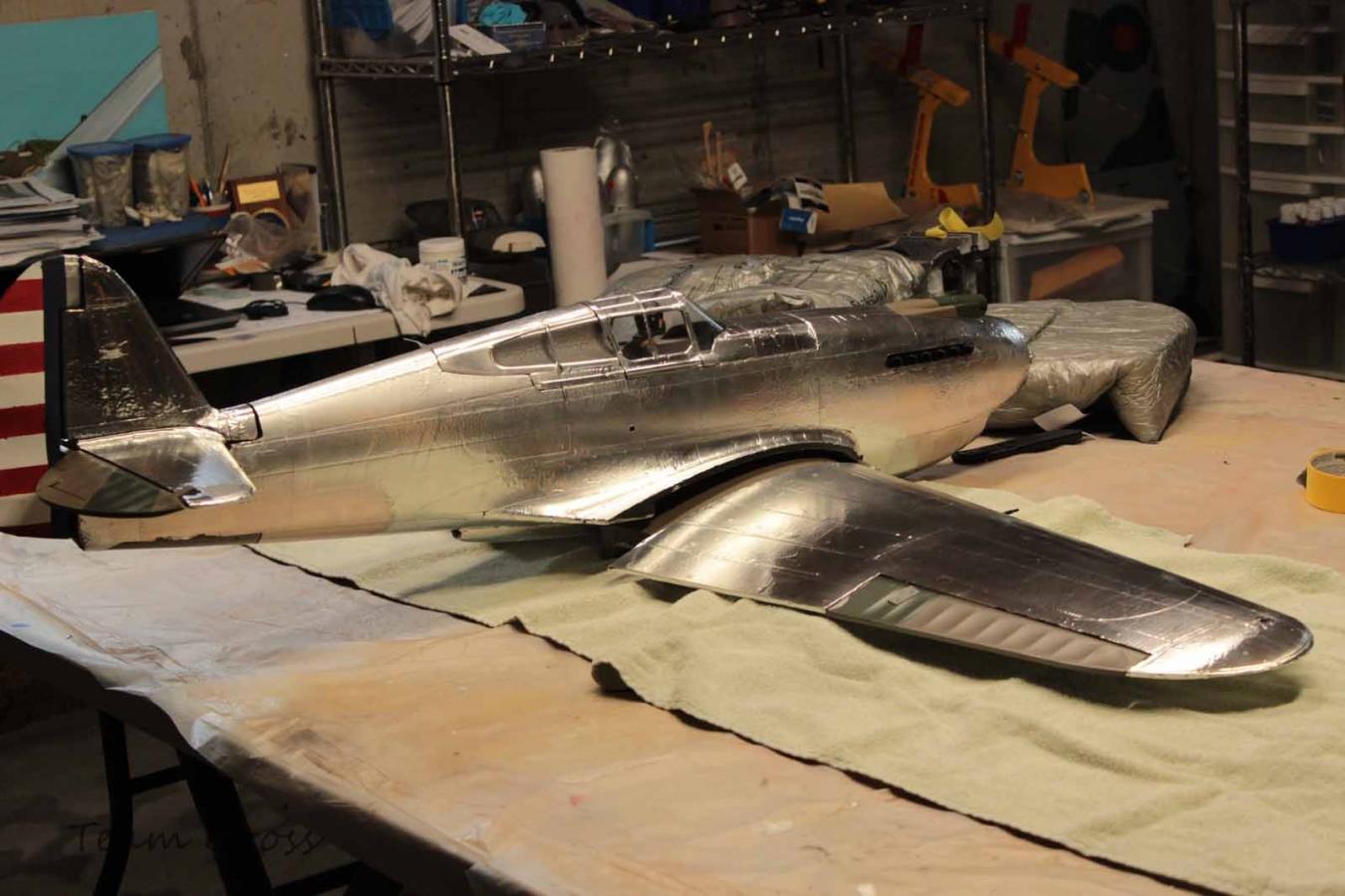

Did some polishing last night, Also, laid her out in approximate position to get an idea of what its looking like........
Hmm, don't know why that one posted twice, but oh well. Now the pics showing the general layout are before polishing, the one of the wing and the tail assembly are after. Note that one of the guns is loose so I'll have to glue that in again, no biggie there. Just picture her with the Air Carps insignia on the wings and fuse. She's going to be an eye catcher!!
