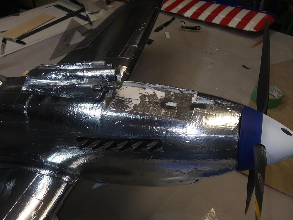

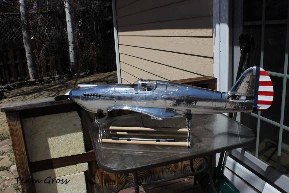

                  WOW, been a while since anything was posted in this thread!

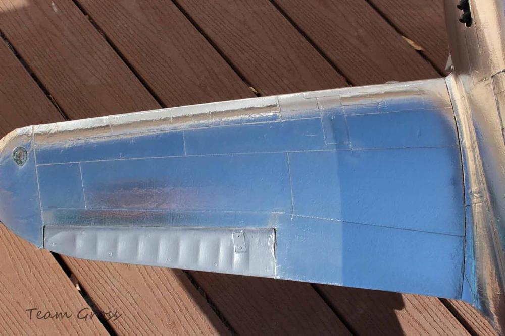

                  The 'Hardway' P-40 has been recovered using Flite Metal and is looking great!

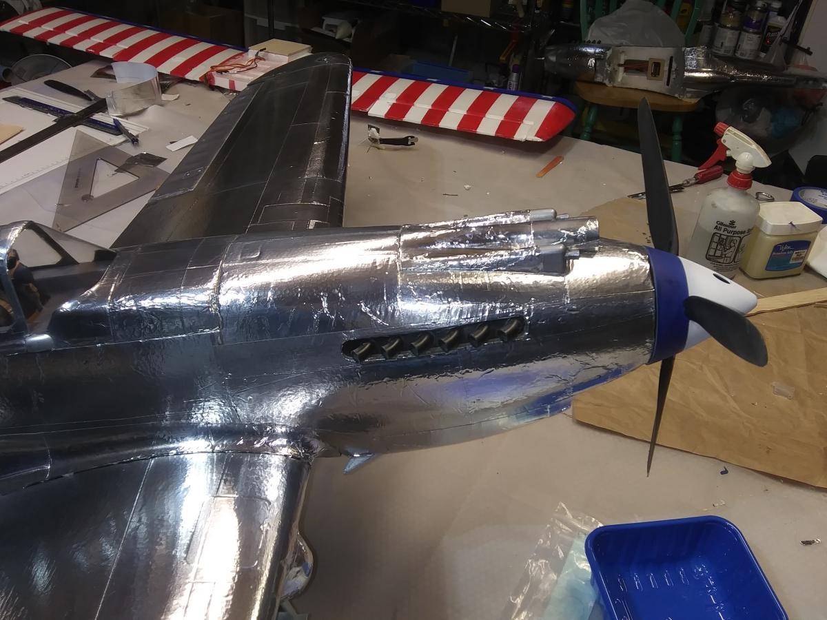

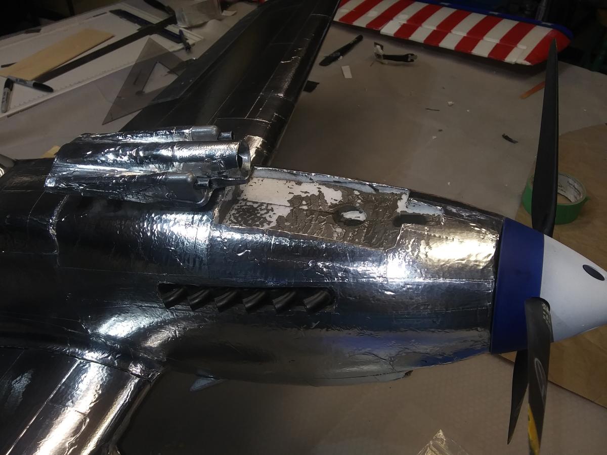

ID:	331875 I found out something interesting that I wanted to share with you. the gun bay on the top of the fuse,
                  is actually removable (to a certain degree)

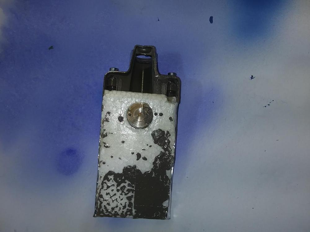

                  Underneath it FMS has put a large weight for balance Click image for larger version

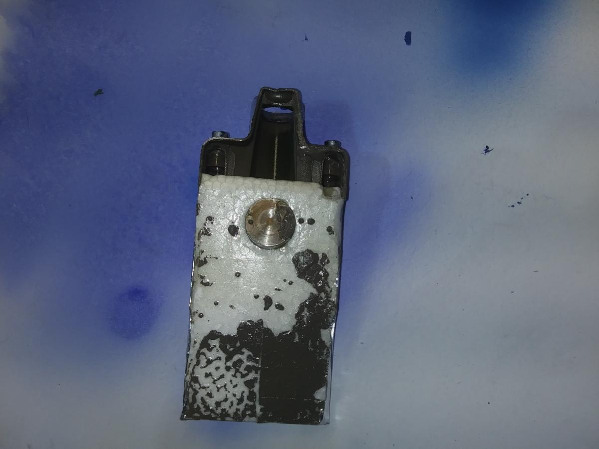

                  I had some problems with getting the plane in the air which really surprised me as the old P-40 flies and continues to fly so well. So the plan is to balance this one exactly as the other and see what happens this time. After all the work on her, I admit its a little scary to try again, but, fly or die. Won't be 'til next season anyway.

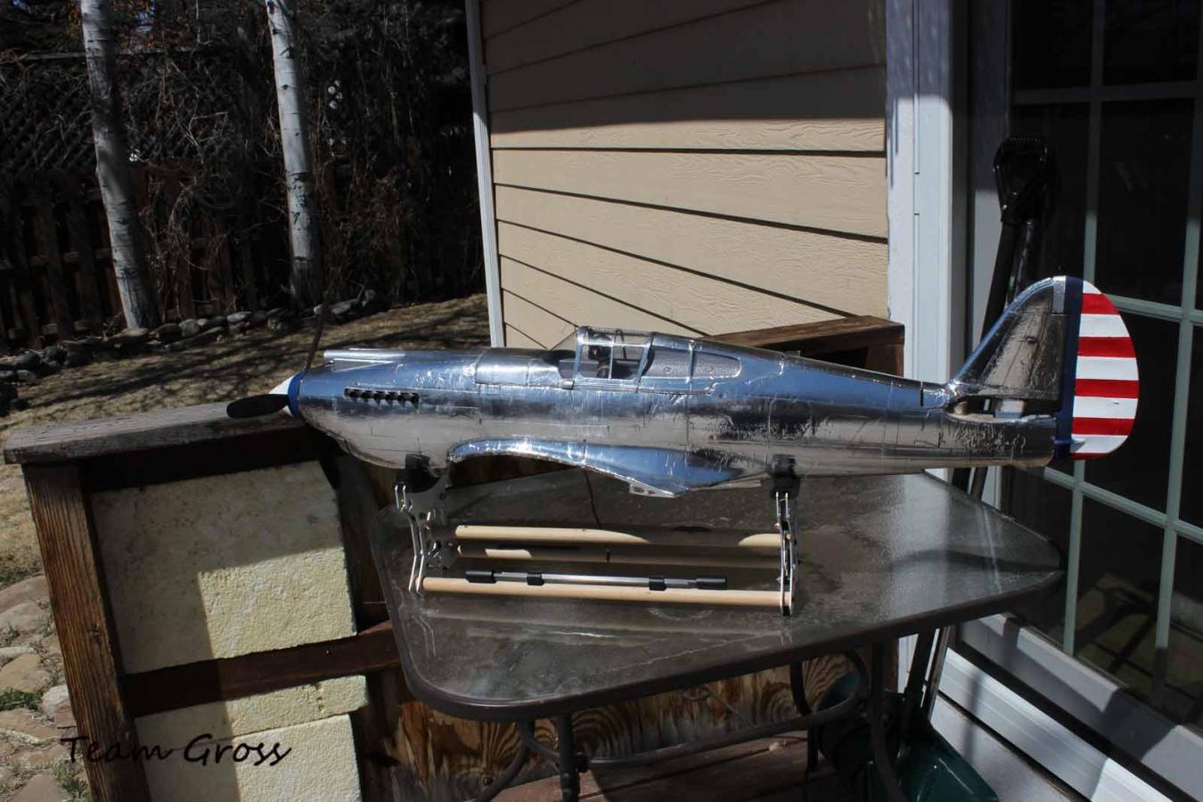

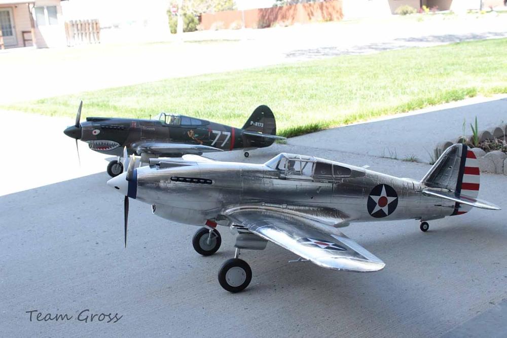

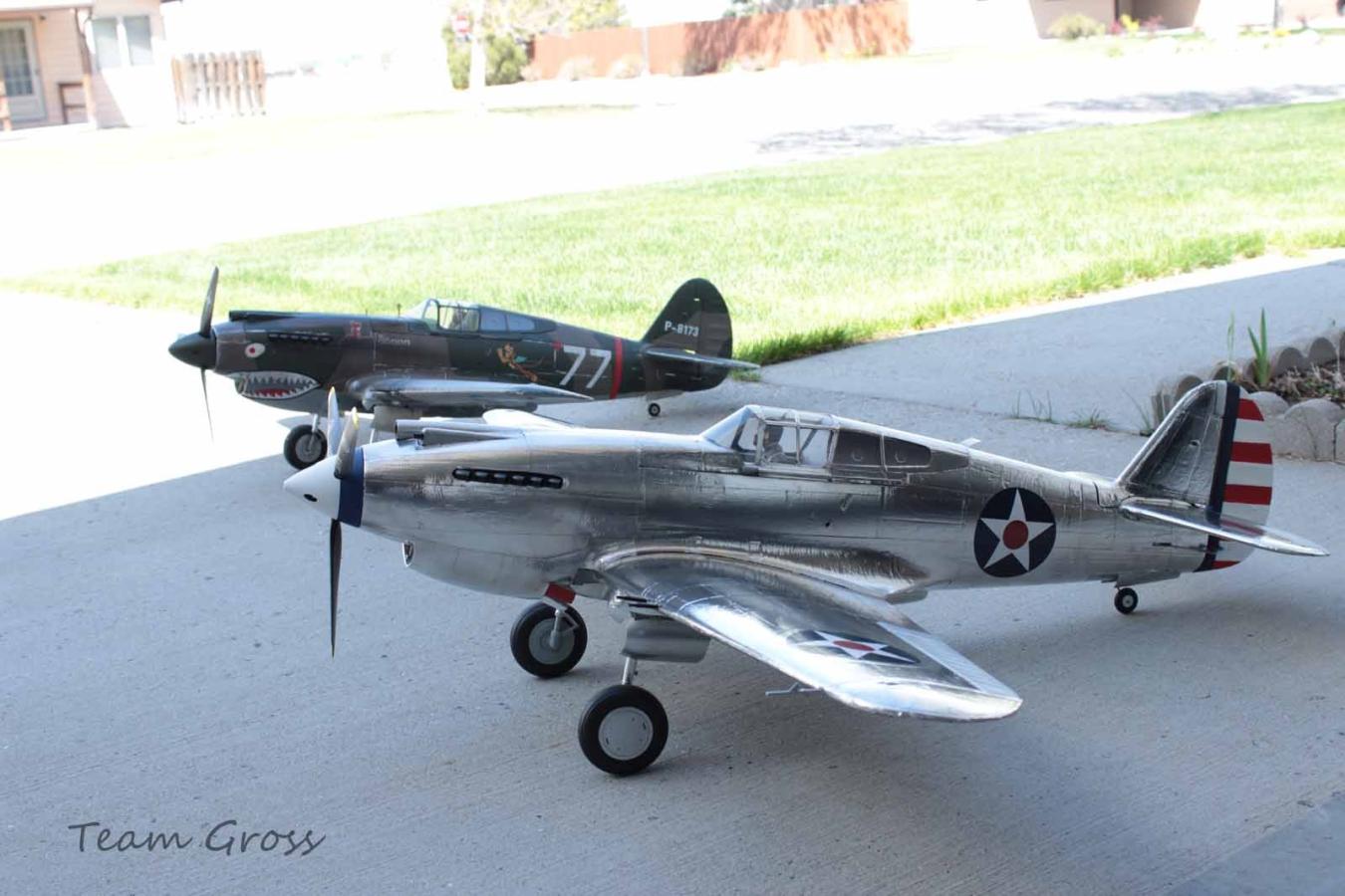

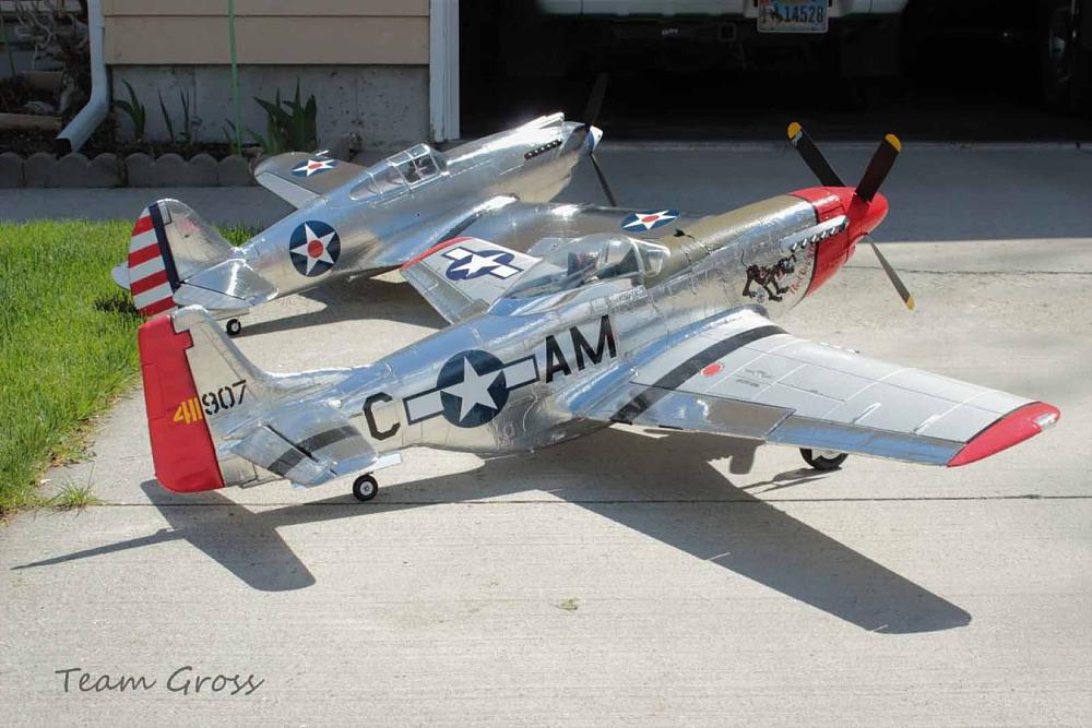

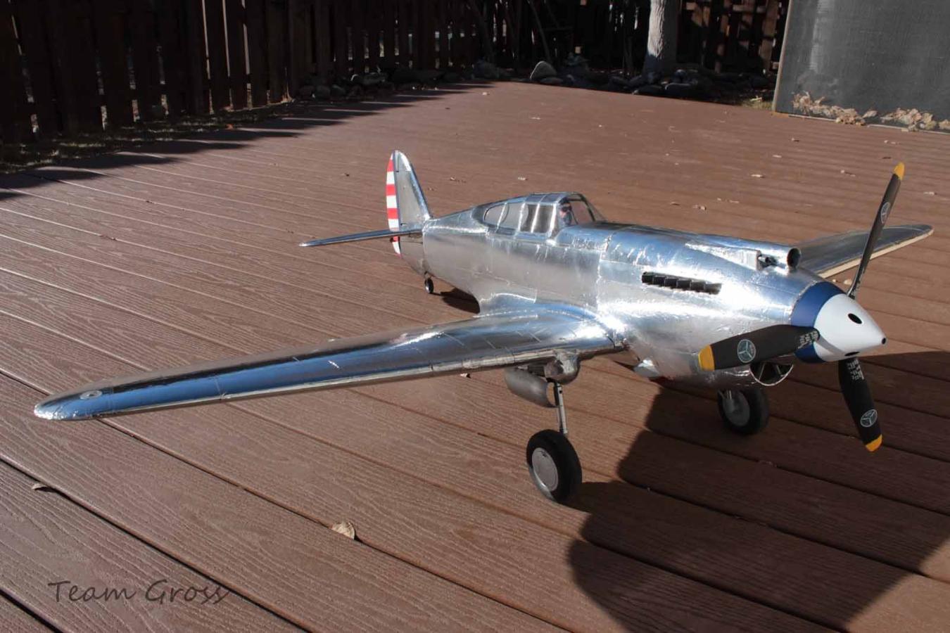

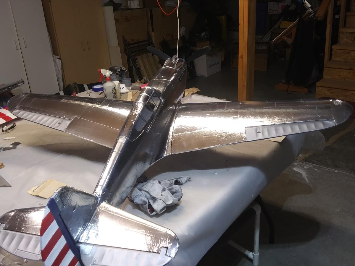

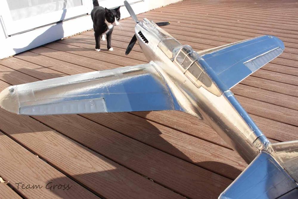

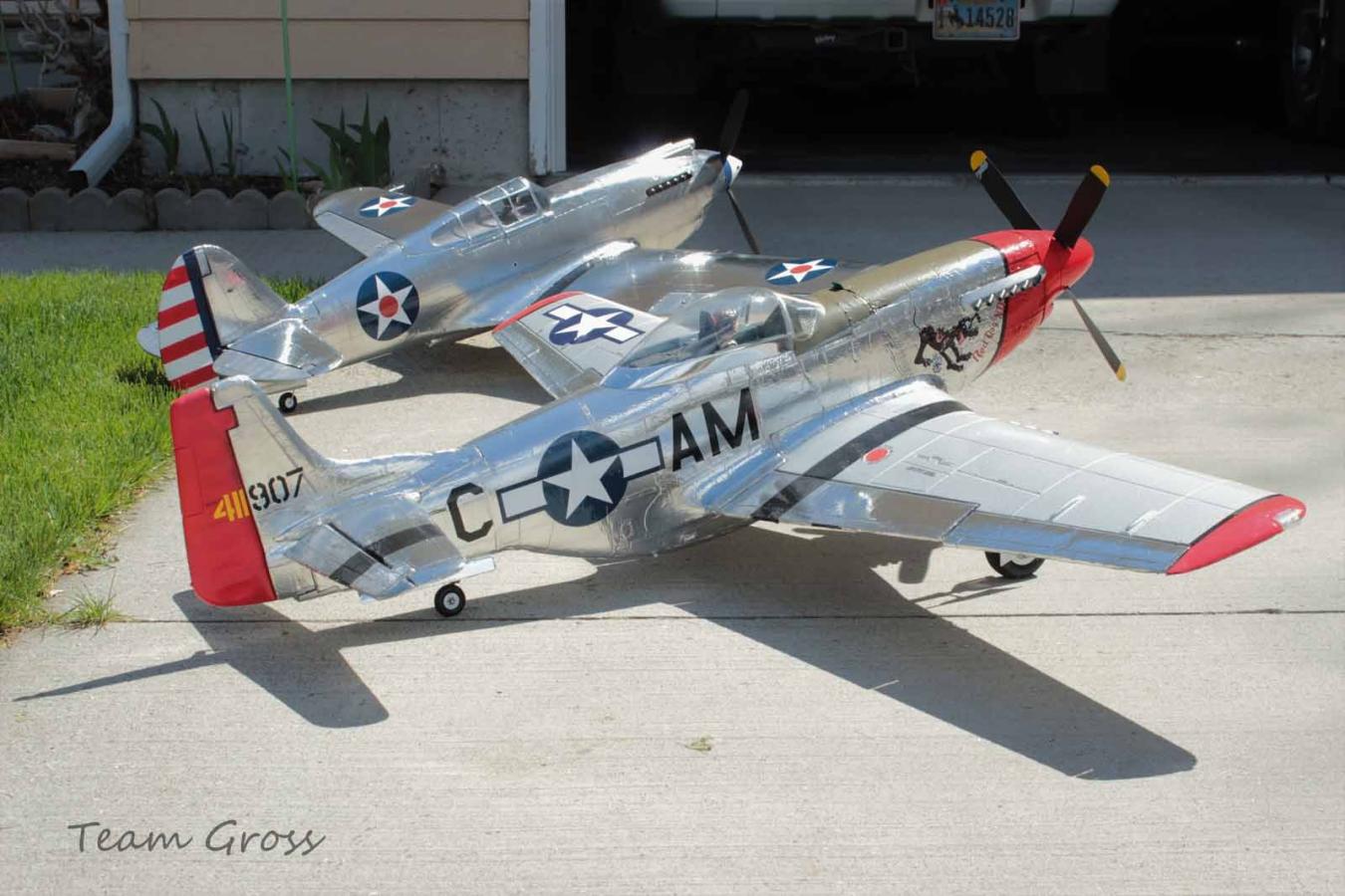

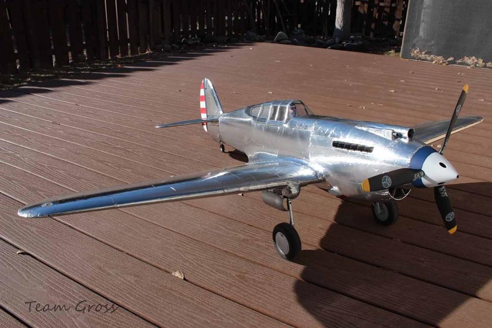

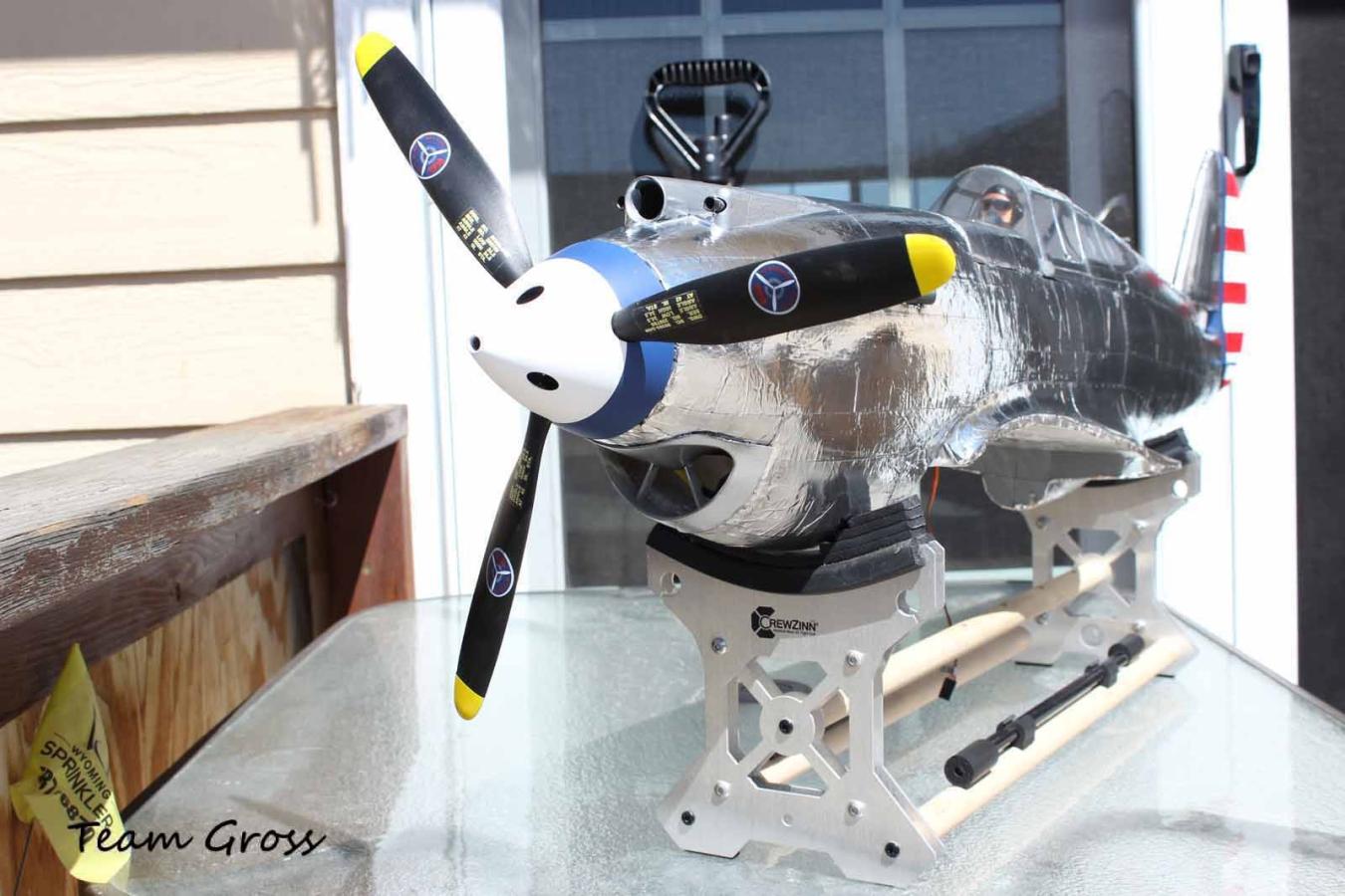

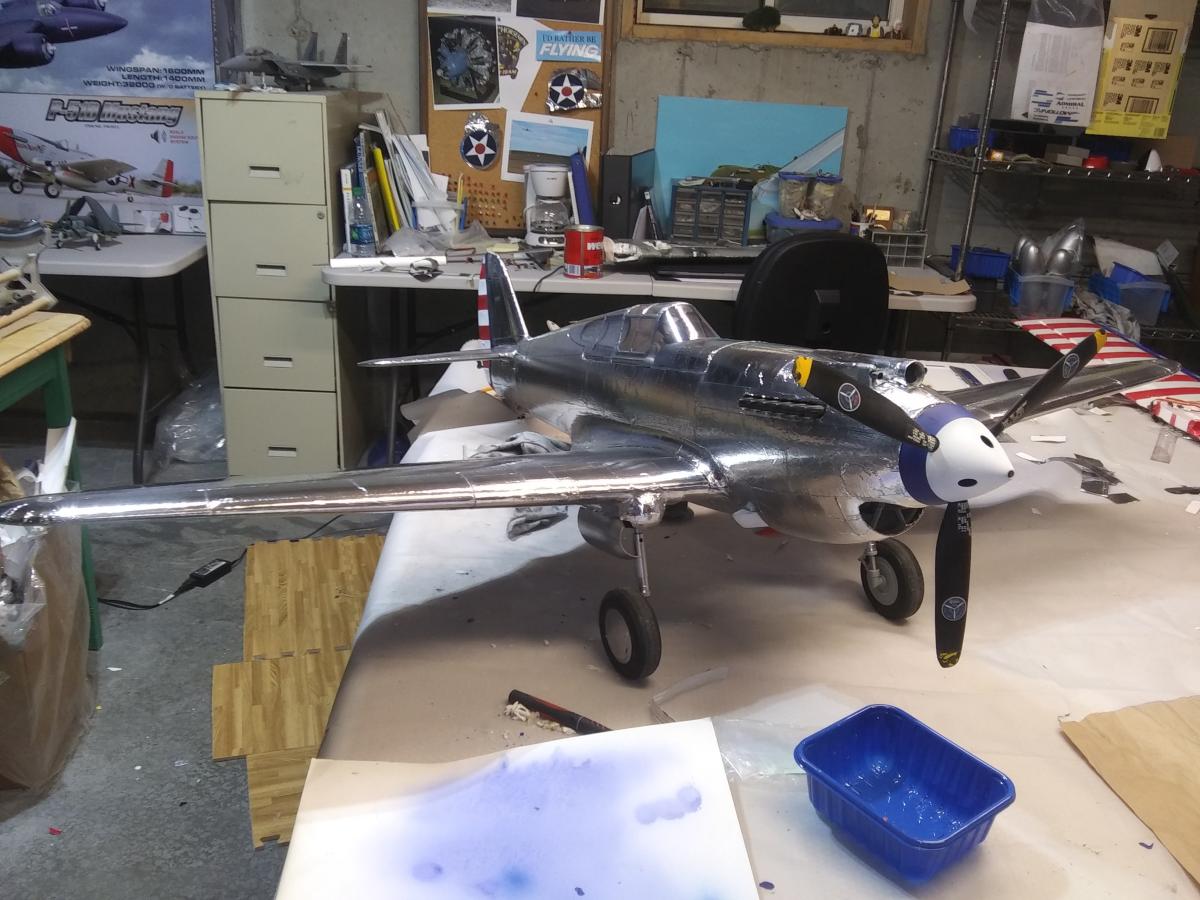

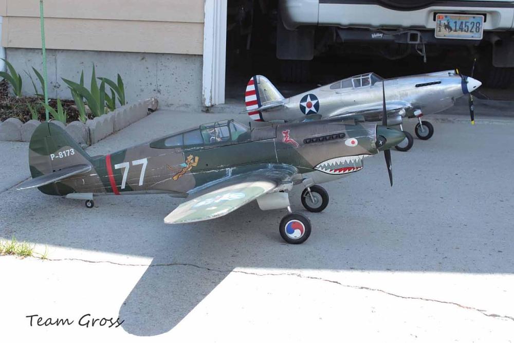

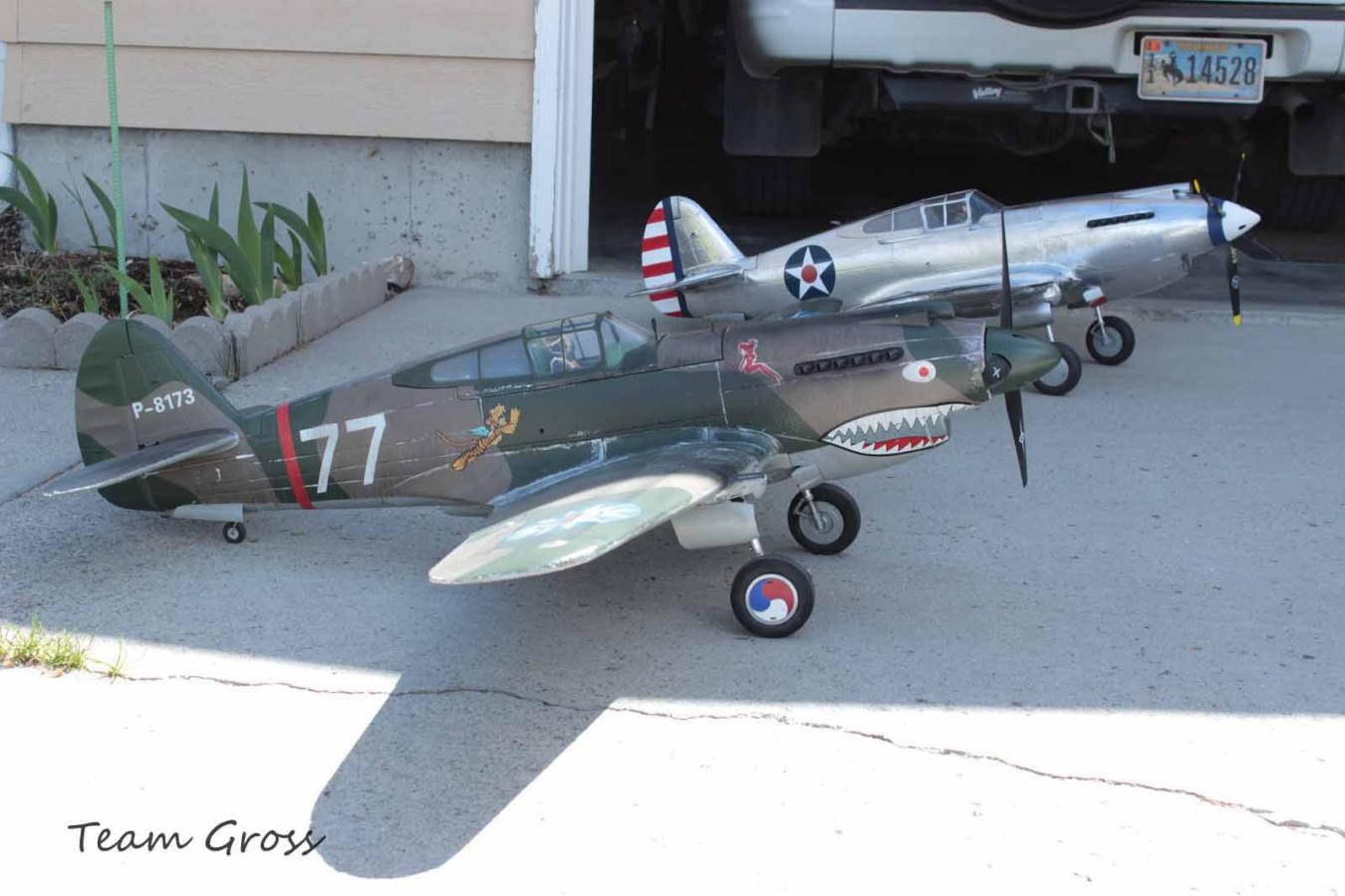

                      Thanks RM, I started out with an idea and an old fuse, then had a new kit donated to me. Originally I did it with chrome duct tape simply because I had a bunch of it laying around. Had a major problem trying to get it in the air and ended up doing some body work and stripping off all the tape and replacing it with Flite Metal. It looks a lot better but under florescent lighting it looks rough. I'll get it outside on the next sunny, non windy day now that I'm feeling human again.
                      This was the old fuse with duct tape:
                      Click image for larger version  Name:	IMG_4898.JPG Views:	0 Size:	131.8 KB ID:	331993
                      Click image for larger version  Name:	IMG_4899.JPG Views:	0 Size:	147.2 KB ID:	331994
                      And this was the new plane with duct tape: Click image for larger version  Name:	IMG_4938.JPG Views:	0 Size:	119.4 KB ID:	331995
                      Click image for larger version  Name:	IMG_4941.JPG Views:	0 Size:	124.2 KB ID:	331996Click image for larger version  Name:	IMG_4947.JPG Views:	0 Size:	144.9 KB ID:	331997
                      So I have to order some decals from Callie again, then she's back! The plus side is that beautiful shine, the negative side is that you are constantly polishing out finger marks unless you wear gloves while handling her. BTW, The Mustang has been refinished from the cockpit forward as I just wasn't satisfied with the job. Looks much better now.

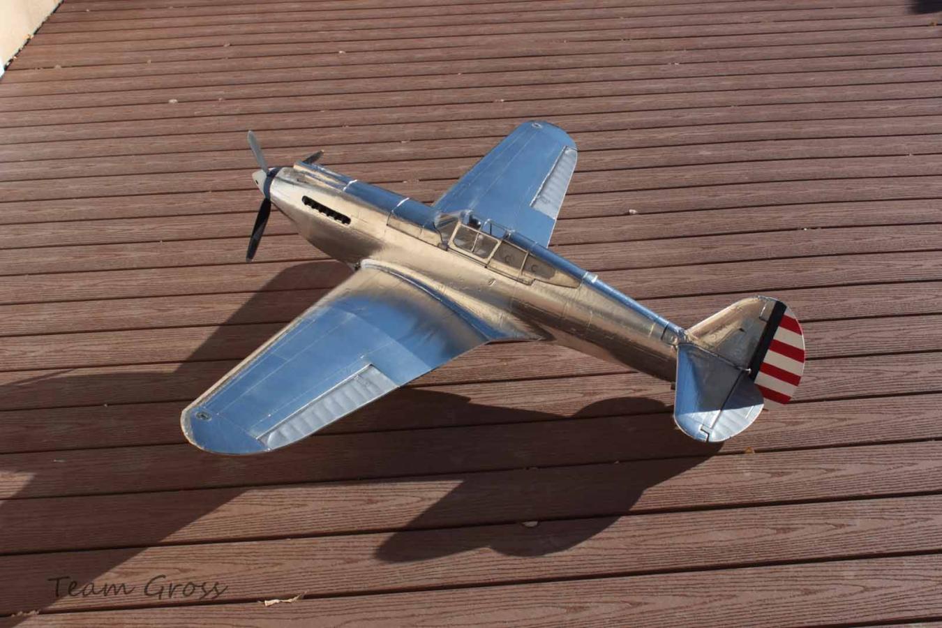

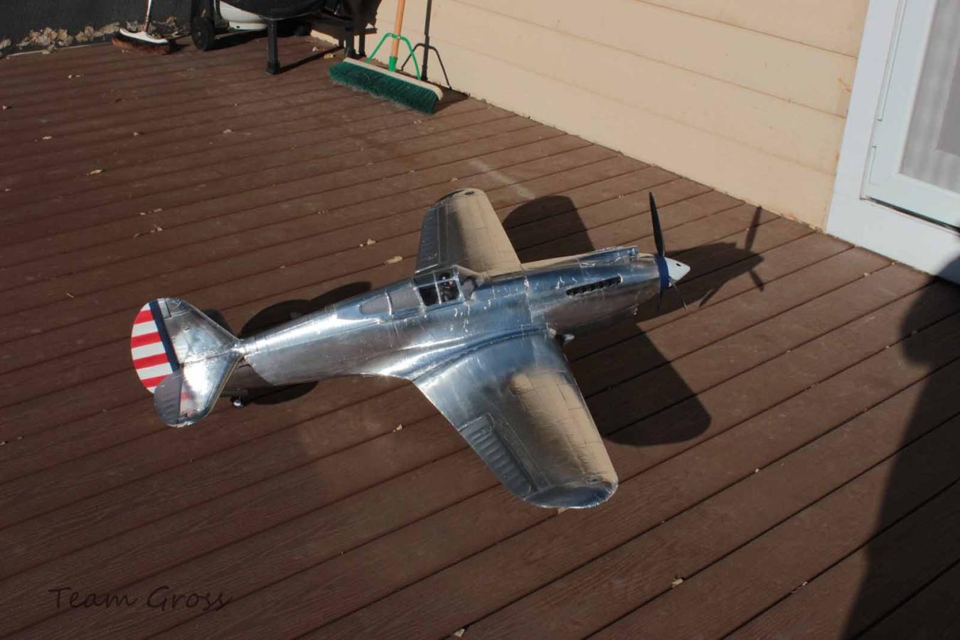

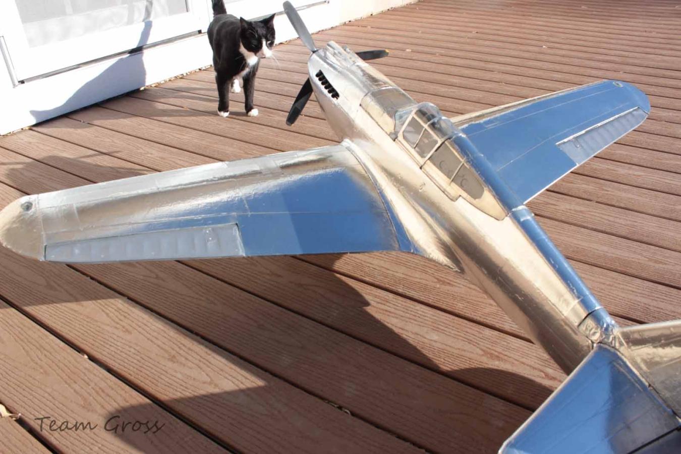

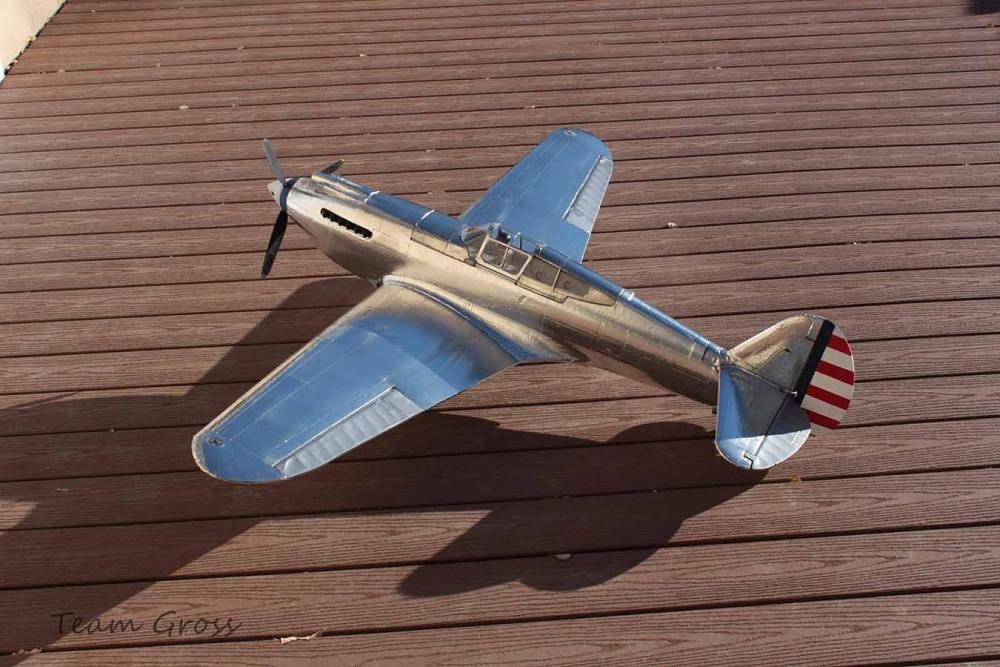

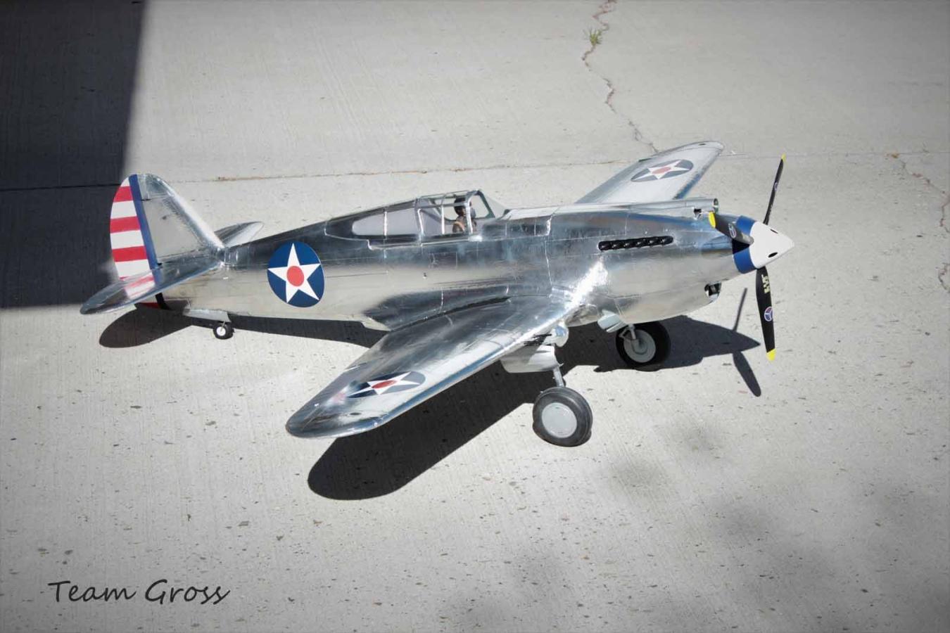

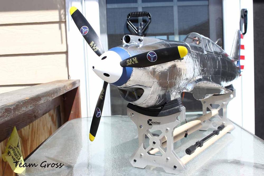

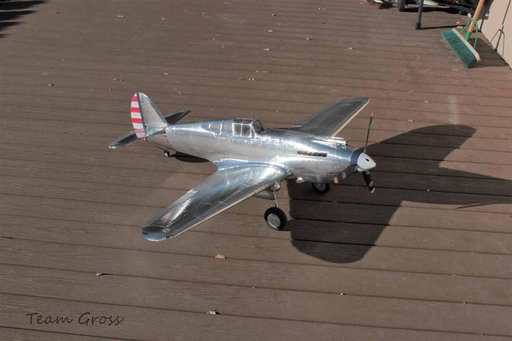

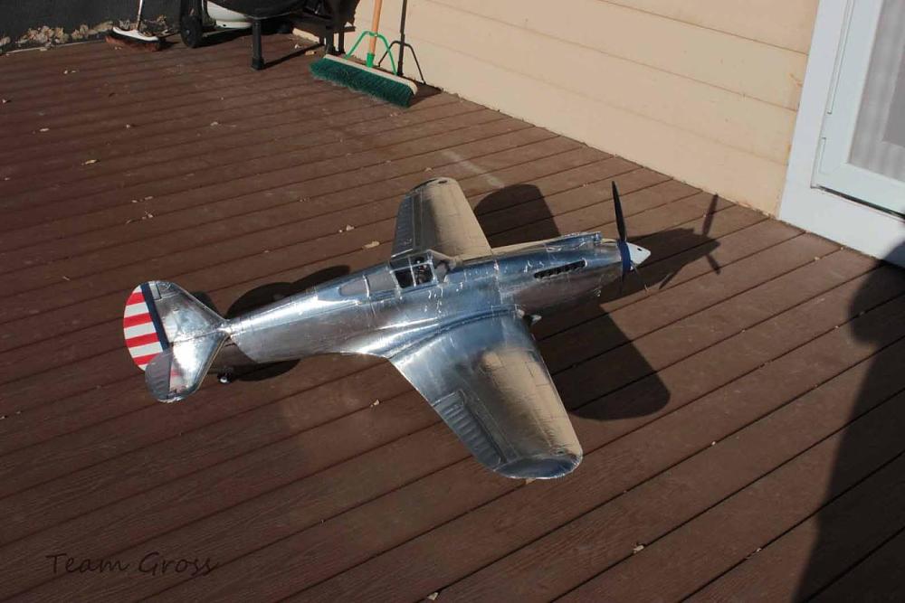

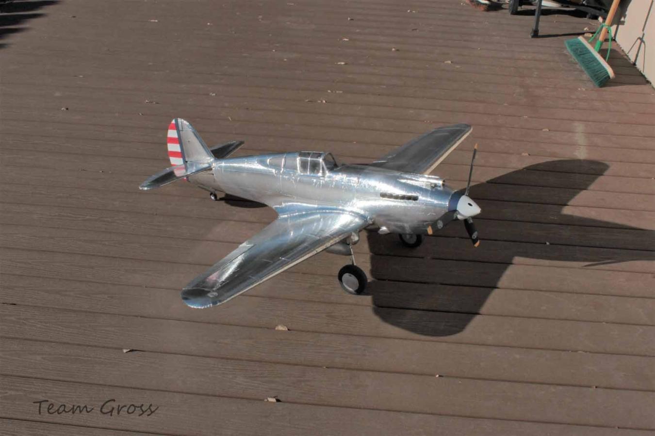

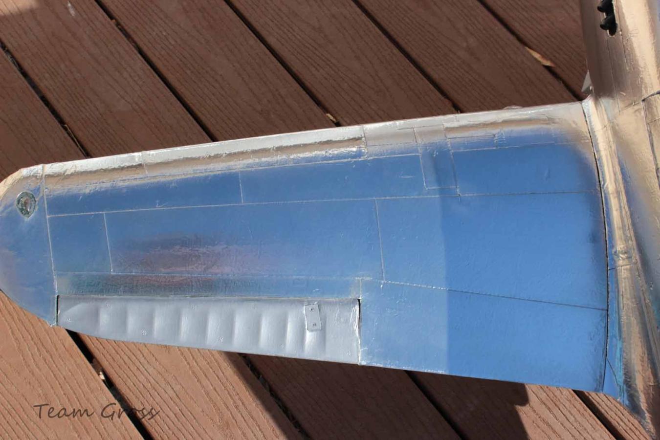

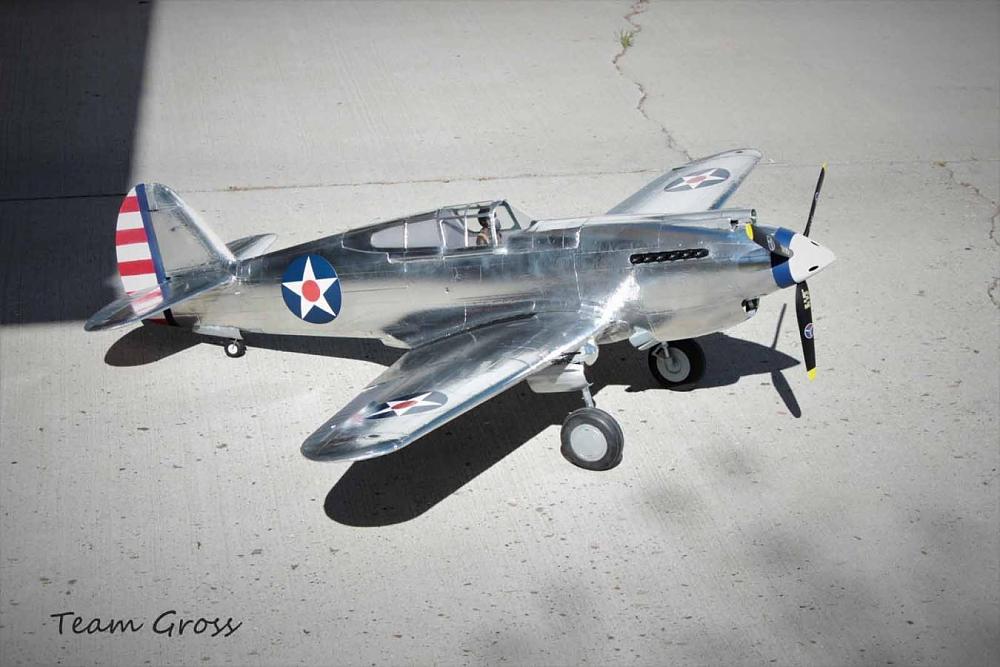

                            The sun is out today so here are the fresh pictures as of 15 minutes ago.
ID:	332134Click image for larger version
ID:	332135Click image for larger version
ID:	332136Click image for larger version
ID:	332137Click image for larger version
ID:	332138Click image for larger version

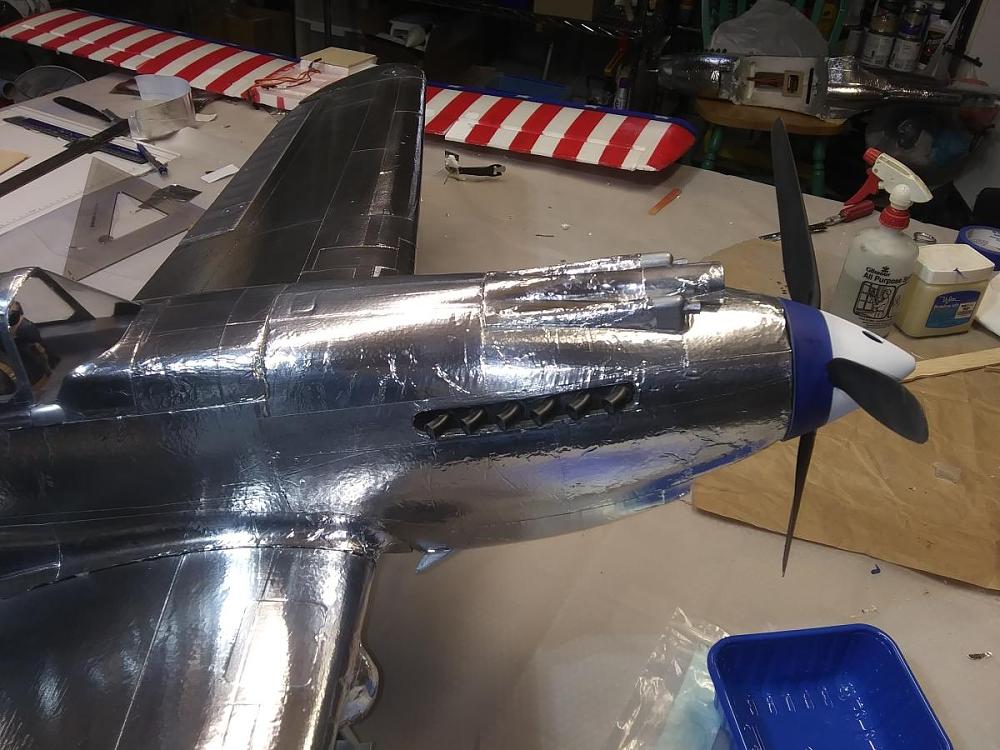

                            Of course, the ailerons, rudder and elevators were fabric so I painted them for authenticity. Panel lines were followed on the wings as close as I could. The best part is the prop blades have a history too. A couple of seasons ago, after I installed the 6s system from Ryan's old Thunderbolt, I was still flying with the stock prop and spinner. Suddenly, it felt like I had no power! Thinking I'd burnt out a cell on the battery, I quickly dropped gear and flaps and landed safely on the runway. Upon closer examination, I found that I'd lost my prop!! My buddy Charlie Brown (OV-10) put me on to a prop and spinner that he uses on his 6s system in the same bird.
                            A couple of months later a couple of the guys were walking the walk of shame and came across the back plate complete with propeller blades on the back side of the field. I had actually flown a half pattern and landed sans prop! When looking for some prop blades, I realized I didn't have any new ones, so refurbished these, they balanced up really well, so there they are. The old hub BTW was ground away in the center which slides over the prop shaft, now the Flying Tiger now sports a one piece prop and a different spinner. This is what that looks like. The 6s system rocks in the P-40!

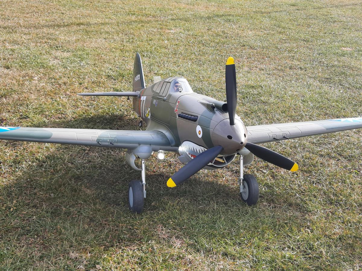

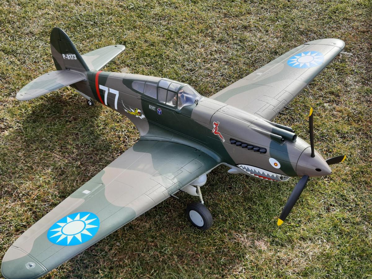

                                      Maiden flight today.
                                      FMS P-40
                                      What a great warbird.
                                      Looks fantastic on the ground and in the air.
                                      With some updates:
                                      retractable landing lights.(also had some original P40)
                                      Sound system with V 12 Allison Sound.
