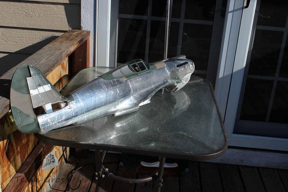

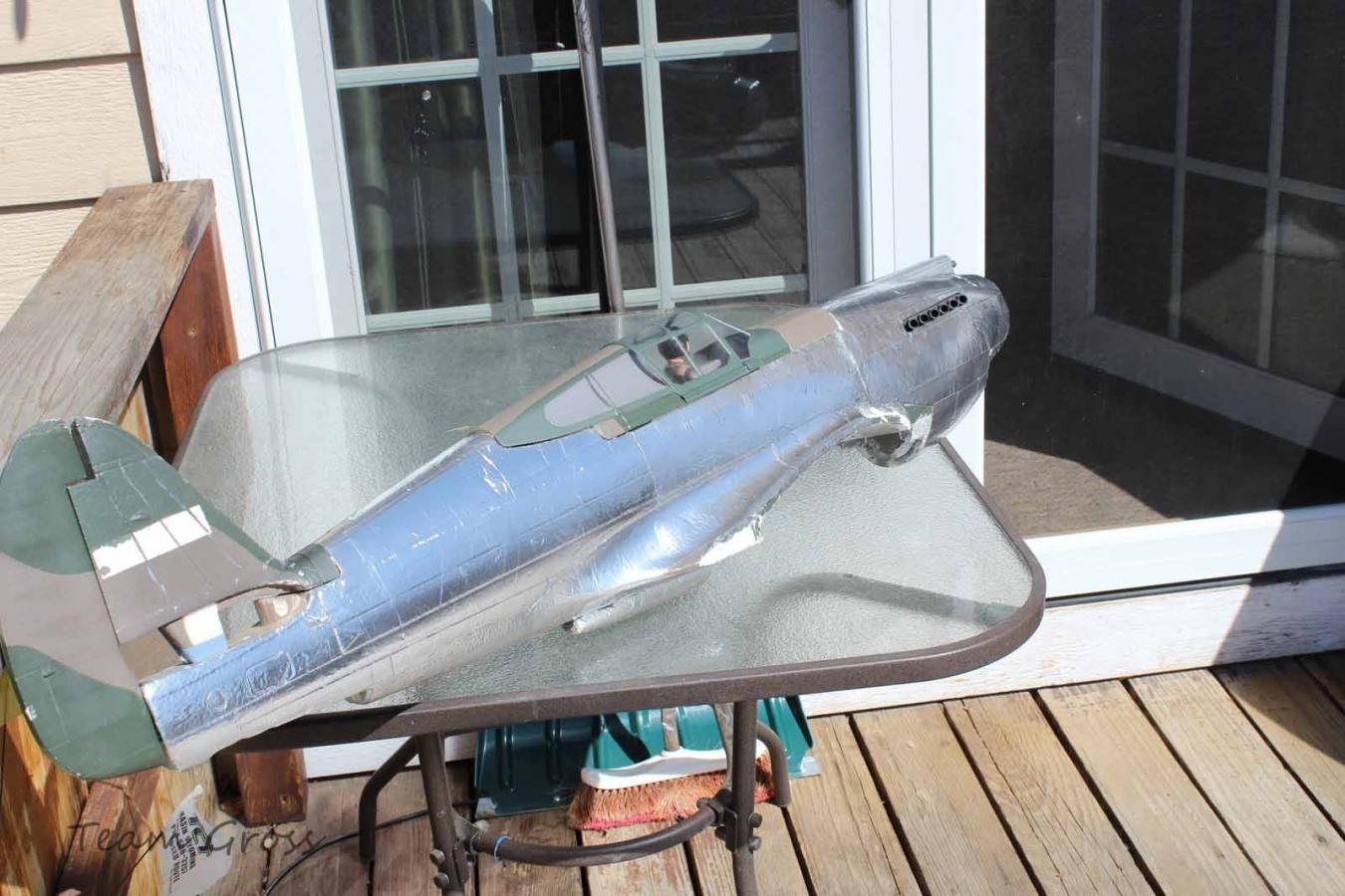

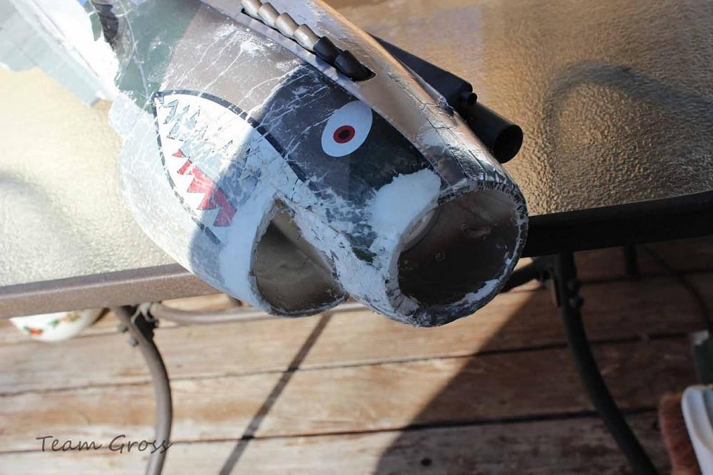

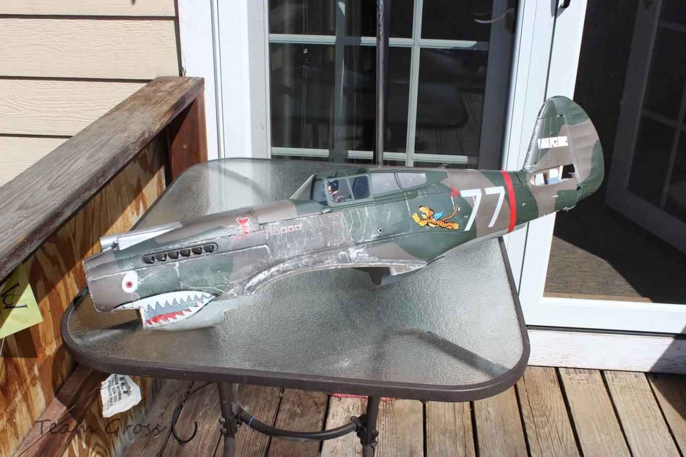

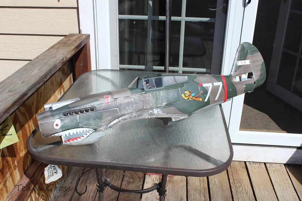

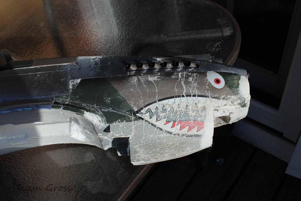

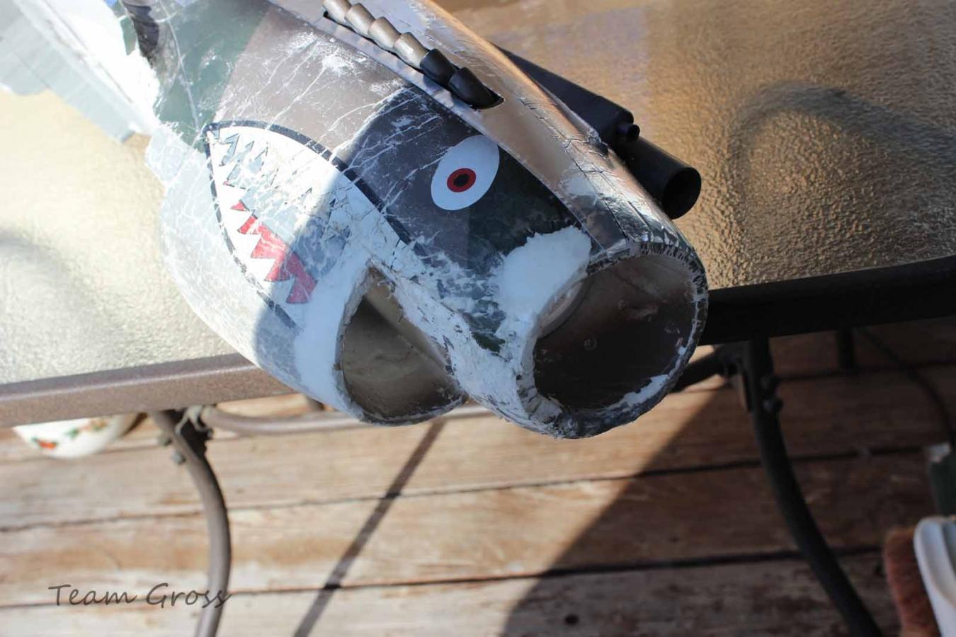

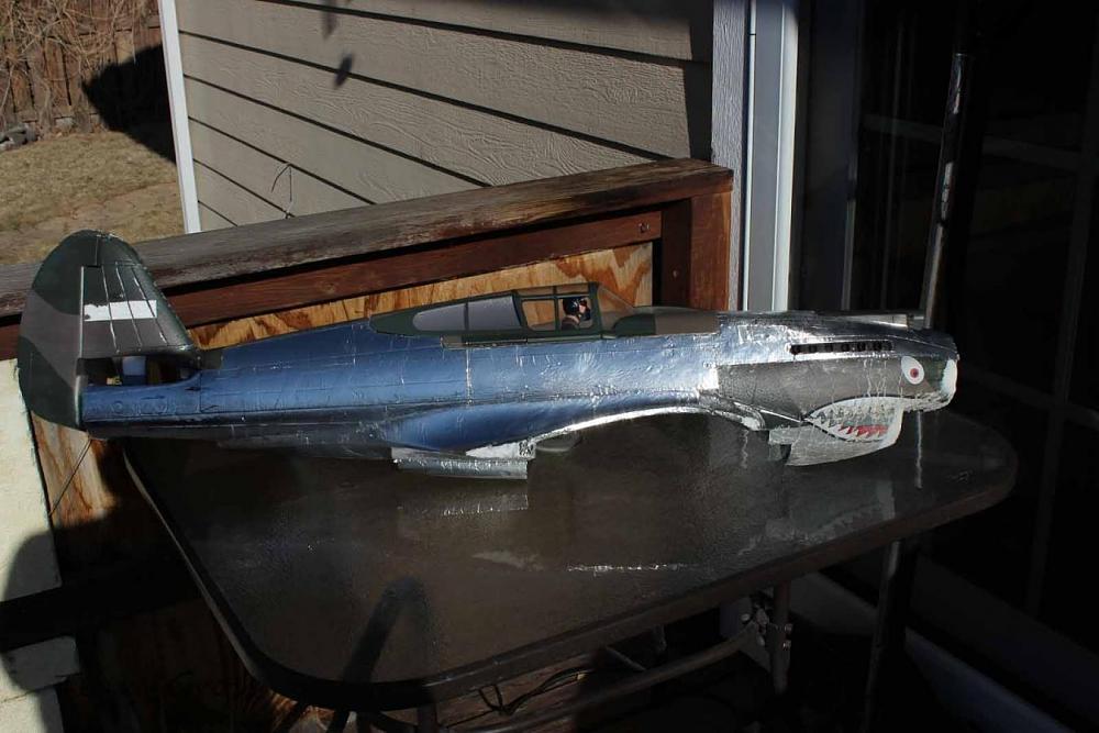

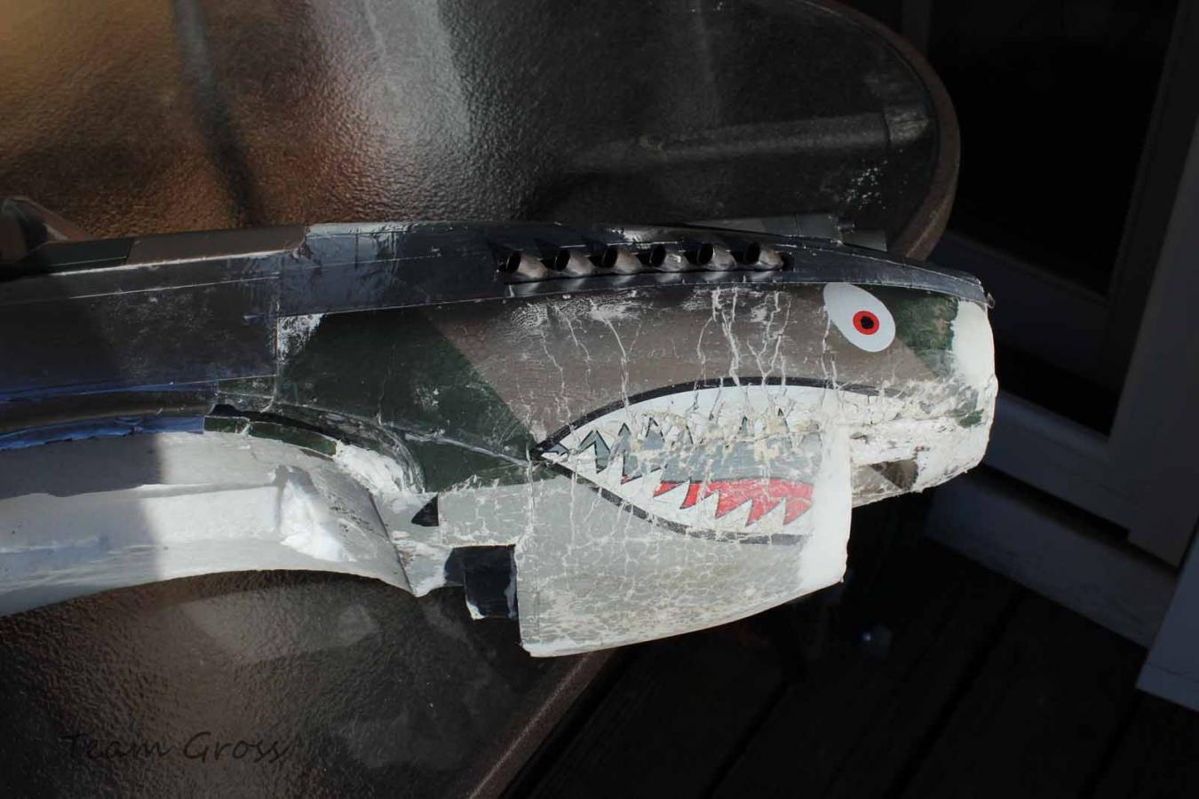

                                    So, after coming home from Nefi 2017, I ordered a new fuselage, new wings, new vertical stab and canopy hatch among other things and rebuilt my crashed P-40. The broken fuse and wings have been sitting in a box downstairs since then. A couple of days ago, just out of shear boredom, I pulled out the fuse to have a look at whether it could be repaired or not. The plane augured in at Nefi while in the infamous Nefi Triangle and basically went in nose first although I may have hit at a slightly better angle as I was pulling back on the stick at the time! At any rate, the result was that the nose was stressed and the fuse was broken on the starboard side right where the front of the hatch fits into the fuse. From the nose , back, she was in good shape, so a project was born. Epoxy took care of the break in a short time and some putty work to eliminate the stress marks took care of a lot of the damage. I've had two rolls of aluminum (read chrome) duct tape sitting around the house since before the Flite Metal days with My Little Gal II and decided to use it for this project to see if I could recreate a fuse something like this.....
                                    Now, so far I've covered one side with the tape up to the break and it looks really good, I'm in the process of sanding and reshaping the nose now.
                                    Unfortunately, the wings are right offs as the centers were completely mangled, so they would need replacing. The horizontal stab is on my P-40 rebuild from 2017, I do have a brand new canopy/hatch, motor and ESC along with props and spinners. The servos are also in the other P-40 and by the time I bought everything in order to get her into the air, it would cost less than $50 over a new kit!
                                    Right now, the funds aren't available for a flyable bird, but I thought I'd put it out there to see if anyone had a spare set of wings or horizontal stab, used, new , whatever. Otherwise she'll be hanging from the ceiling for awhile. Which is ok as it is, for right now, just something to while away the hours and keep the creative juices flowing.
                                    I'll keep an update going with some pics of the progress as well.

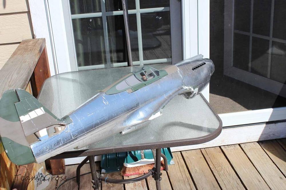

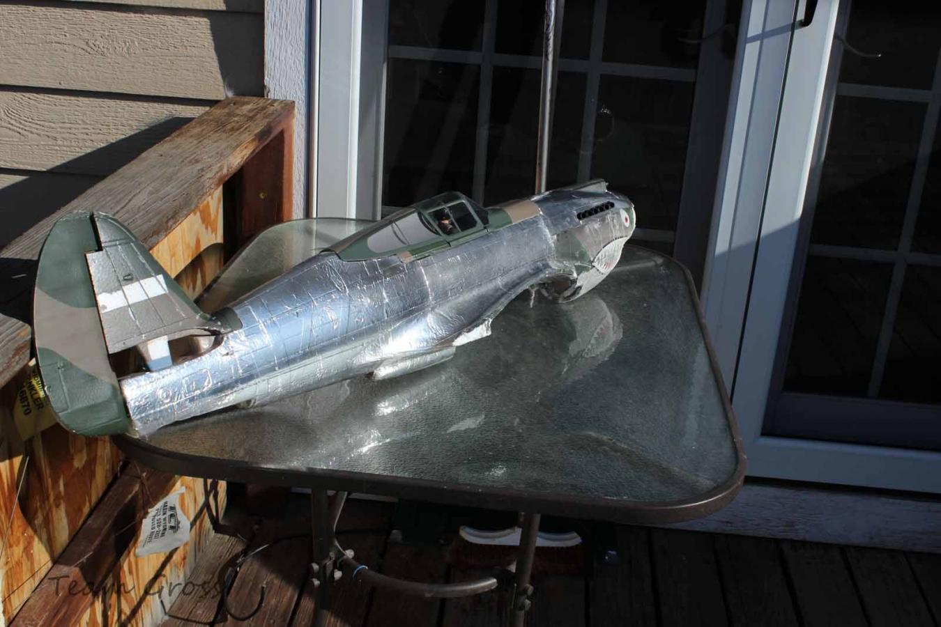

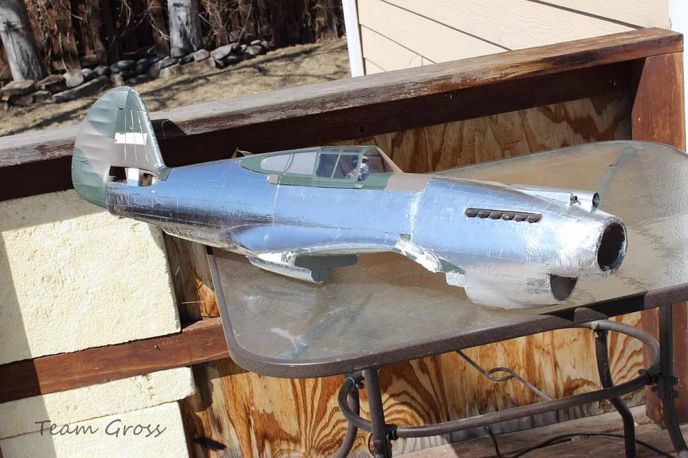

                                      • 7383
                                      #218

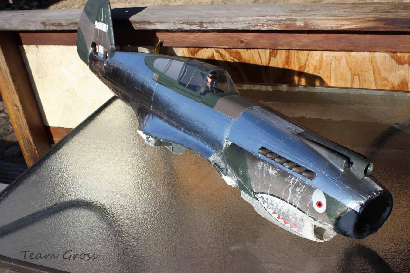

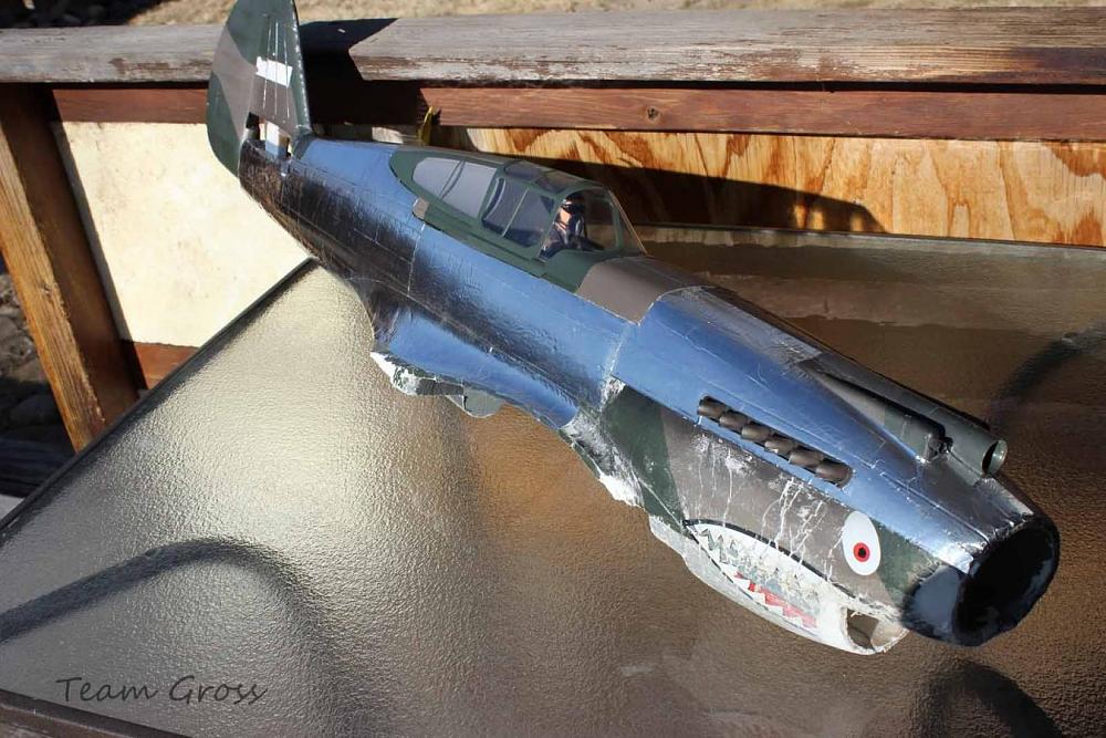

                                      So, as of this morning, here's where she stands, did some more work after taking these and the nose is pretty well complete, a couple of small repairs before covering to complete on side. Anyway...

                                        Grossman56, Now that's an impressive rebuild. Really diggin' the 'chrome' work. Best, LB

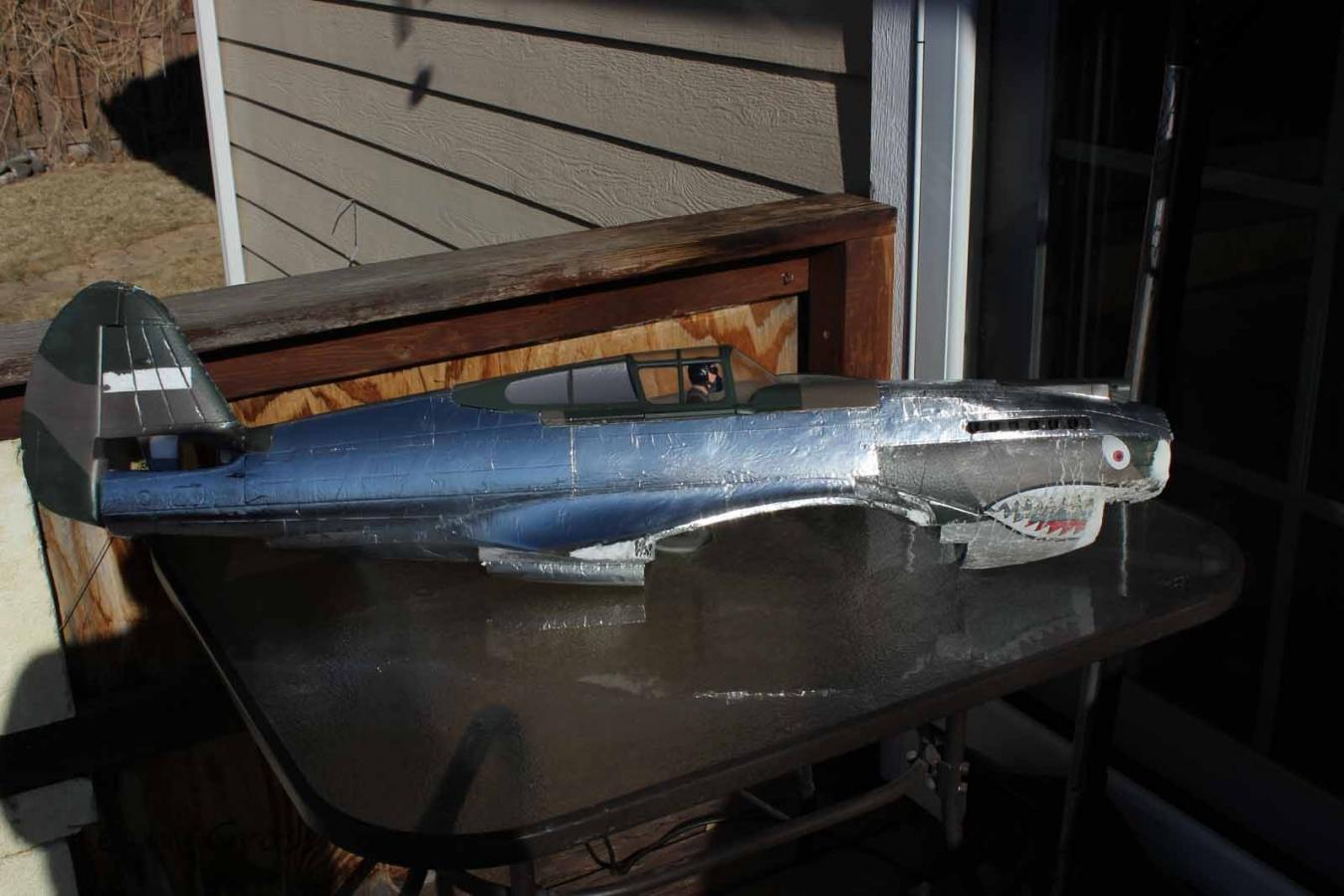

                                          #220
                                          Thanks LB, it's just something to do since the wind is up!

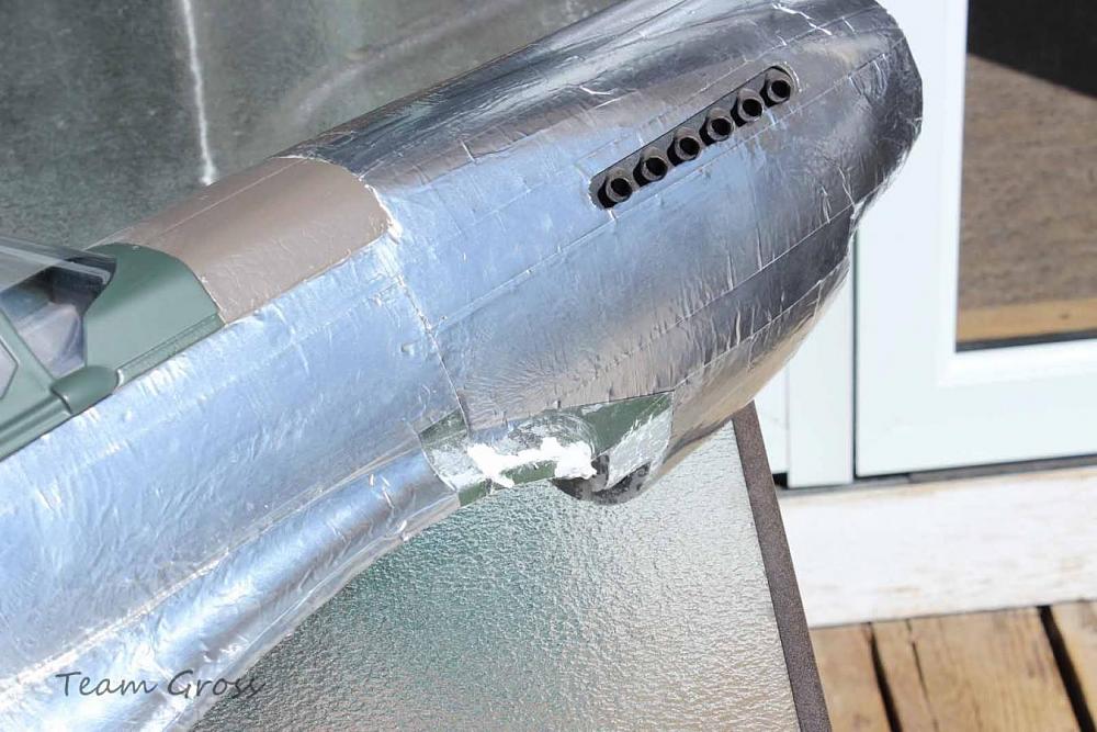

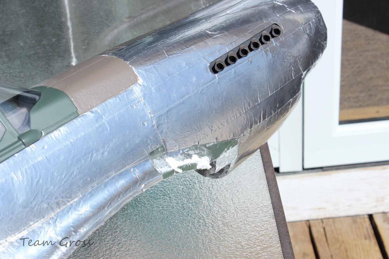

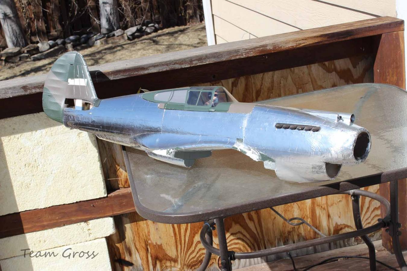

                                          Here's the result of today's work..
ID:	247485Click image for larger version
ID:	247486Click image for larger version
                                          Not the easiest stuff to work with and neither is the Flite Metal, but hey, I wasn't going for show quality, more of a learning experience.
                                          Just to show what has been done so far, here's the other side that hasn't been 'chromed' yet, BTW, I am saving the kitties!!
