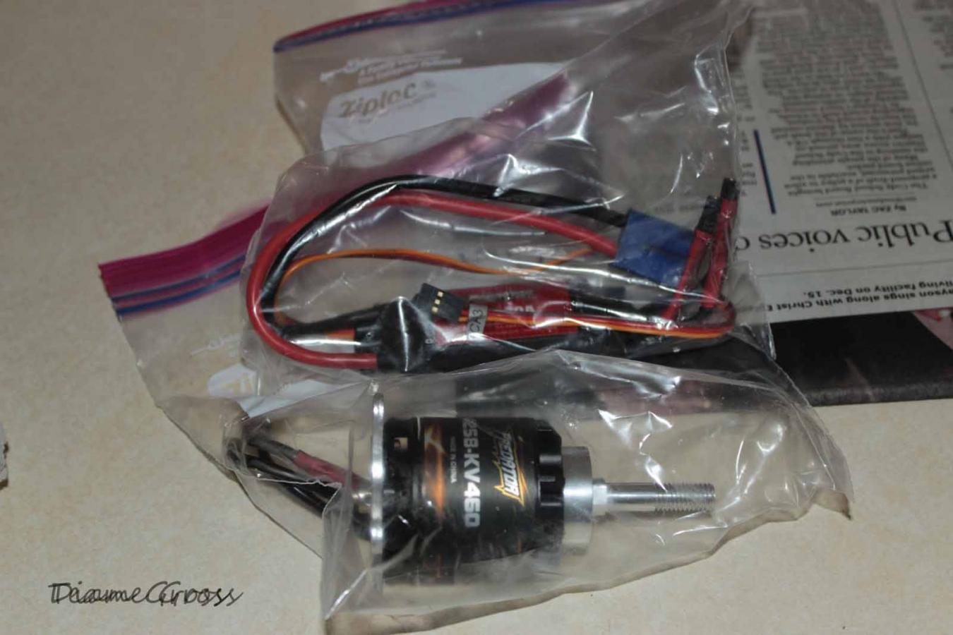

                  #308
                  I wouldn't fly it with 6s with the stock 650kv setup! If you want to see a prop disappear very quickly (at the least) that's a good way to do it.
                  It may be that someone has replaced the stock motor as CB and I have done. We converted ours over to 6s using the stock FMS system from the P-47 Razorback
ID:	263845 which Ryan Ramsay was nice enough to sell me. Even with this system, you can lose a prop and spinner (don't ask me how I know!) So its wise to convert the prop and spinner as well.
                  On the positive side, even with the stock system, this airplane is a great performer, just check to see if it has the updated ESC (Its a Predator ESC) if so, you may want to convert it to something else as they don't have the greatest reputation.
                  My Silver 'Hardway' P-40 is running the stock 650kv and she's staying that way

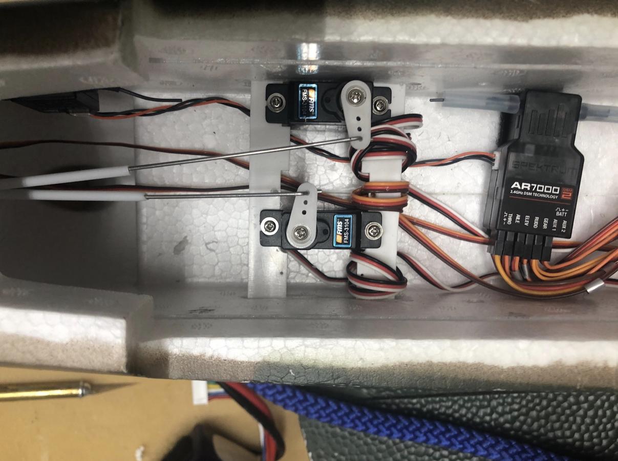

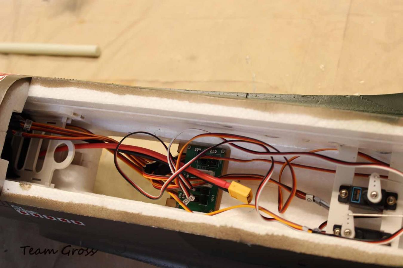

                                  #316
                                  Originally posted by Slowflight
                                  Thanks CCH for the info, I found the post is #226 and is apparently a manufacturing defect, needs either a servo replacement or a reverser, I think I have one someplace in my junk box. Today I just disconnected it and flew with a tail wheel fixed but I increased the rudder travel, made a couple of flights like that and it was not a problem, if I dont use the elevator to keep the tail planted the rudder steers the plane, I fly out of grass field so that helps. But once again after 40+ years of flying giant scale planes Im truly impress with how well this small plane flies, is a keeper even if I have to fly it with the fix tail all the time, best $50.00 bucks Ive ever spend. as for the ESC when it goes it goes, I punished it today with a 5S and the previous owner was using a 6S and it still there, so will see.

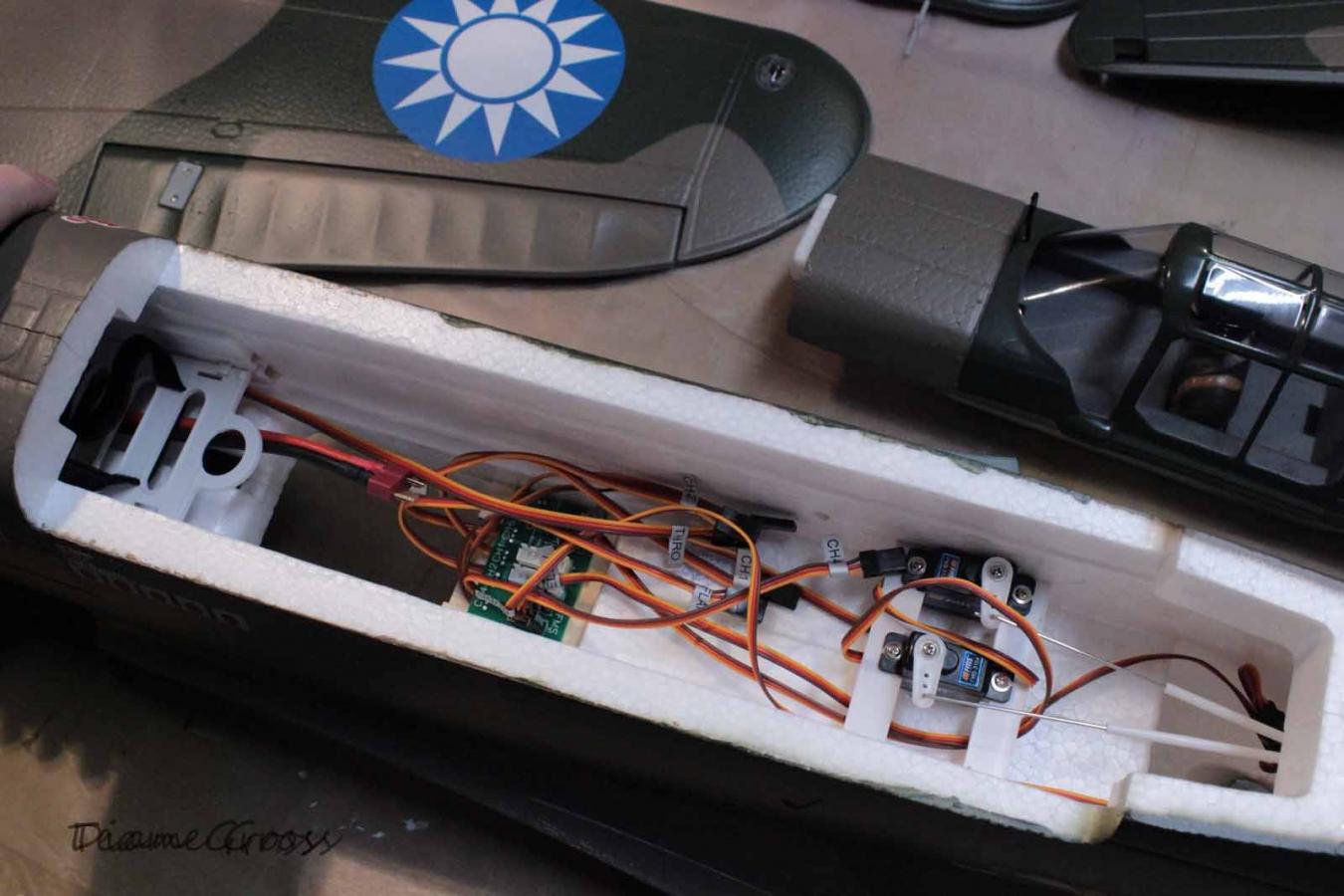

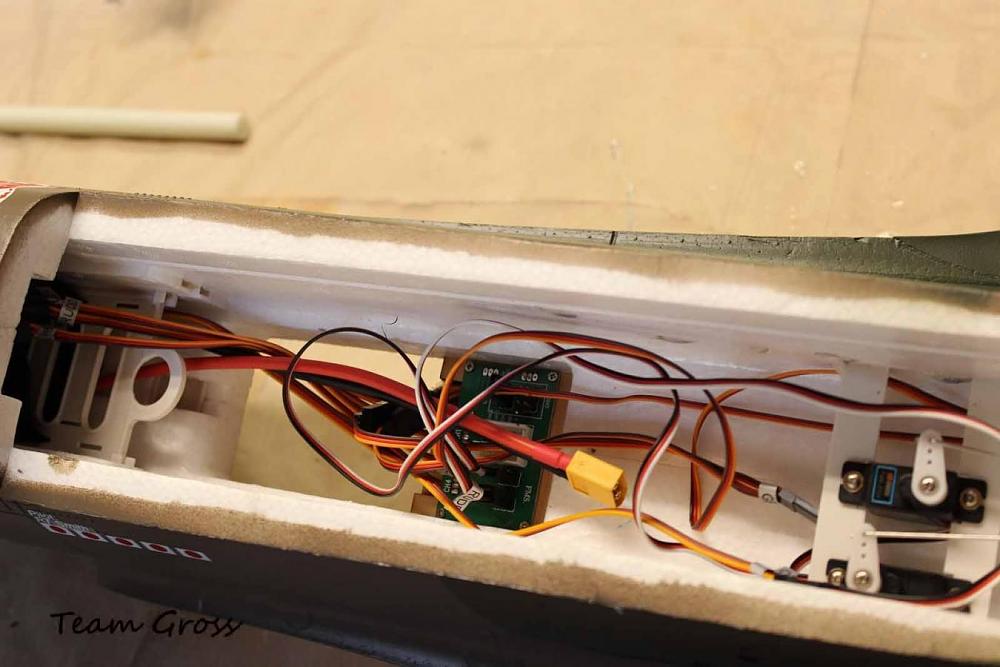

                                  Read post 286, the plastic piece that the servos are attached to is installed backwards. I just reversed the elevator and ground out the starboard slot to accept the servo, then turned the servo 180 degrees. Now its the same as the first P-40 I have. It should look like this. I didn't bother moving the elevator servo as I stated, just the rudder servo. It should look like this
ID:	264145 Not like this..
                                  Solves the problem in the few minutes it takes to grind out the slot with a Dremel tool. I emailed HH and told them about this.
                                  • Slowflight
                                    • 60
                                    #317
                                    Thanks Grossman problem solved, I moved the elevator to the spot where the rudder was and just elongated the cutout and done. I must be loosing it, been building giant scales for 30yrs and drawing my own plans and I didn’t come up with this solution, only proves that there is always room to learn from others. I guess I’ve been complaisant with the use of new technology, when I started in RC there was no servo reversing switches but there were right and left servos, so solutions like this were the usual way to solve it. Thanks
                                      • 7331
                                      #318
                                      Somewhere out there is a guy or gal installing these pieces backwards, hopefully, Horizon informed them of this and they'll correct it, in the meantime, we all get this problem

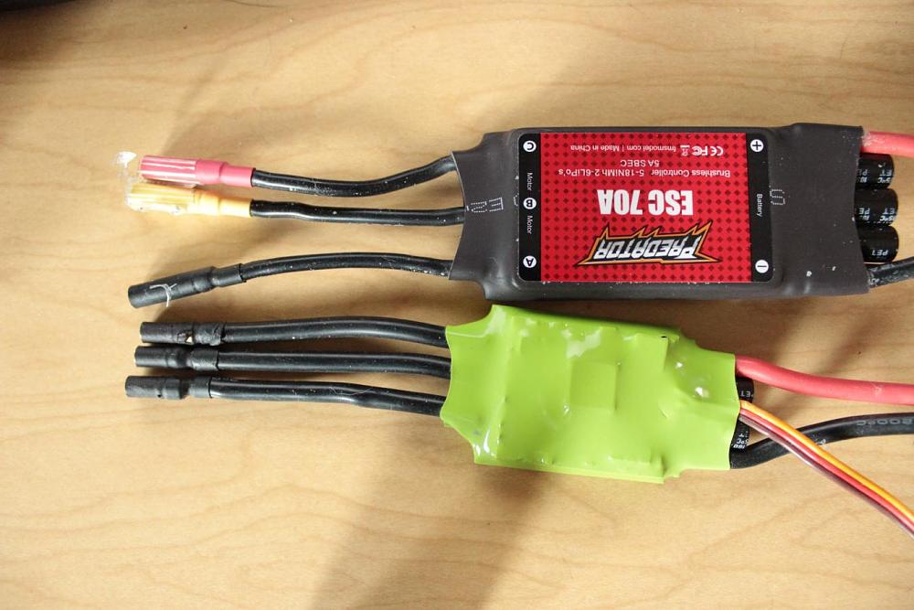

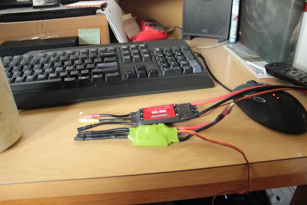

                                          #320

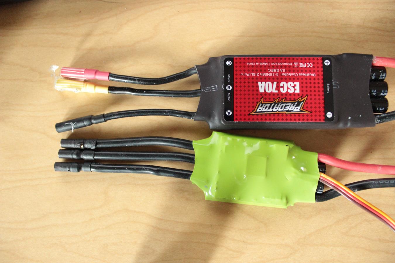

                                          You may have just lucked out and got one with the old stock motor. Easy to tell because the Predator is black and says' Predator'
                                          The ESC is black with a red sticker on it that says Predator as well.
                                          Here's a couple of pictures, the green ESC is a Mantis 85A which is what I have used with all my 650 kvs thus far, the black one is the stock Predator ESC .
                                          Click image for larger version  Name:	IMG_5177.JPG Views:	0 Size:	125.1 KB ID:	276273Click image for larger version  Name:	IMG_5176.JPG Views:	0 Size:	122.4 KB ID:	276274
                                          You can see that the diameter is bigger and the 4 mm is also longer. If you have the white motor, which is the original 650 kv, then it should have the 3.5 mm, so go with the Mantis if you want or just use the stock 70 A. I prefer a little more of a safety margin myself.
                                          The silver P-40 is now a winter project as, well, lets just say the maiden didn't go well, not quite sure why but she barely got off the ground and and decided to land upside down, no the ailerons were not reversed. So my plan is to strip off all the tape as it wrinkled pretty good, to the necessary repairs and fly her. If all goes well, I'll get some more flight metal and refinish it in that. Can't say I don't have anything to do this winter as I also busted the nose off the Pitts which is due to poor servos so they'll all be replaced with HiTecs.
