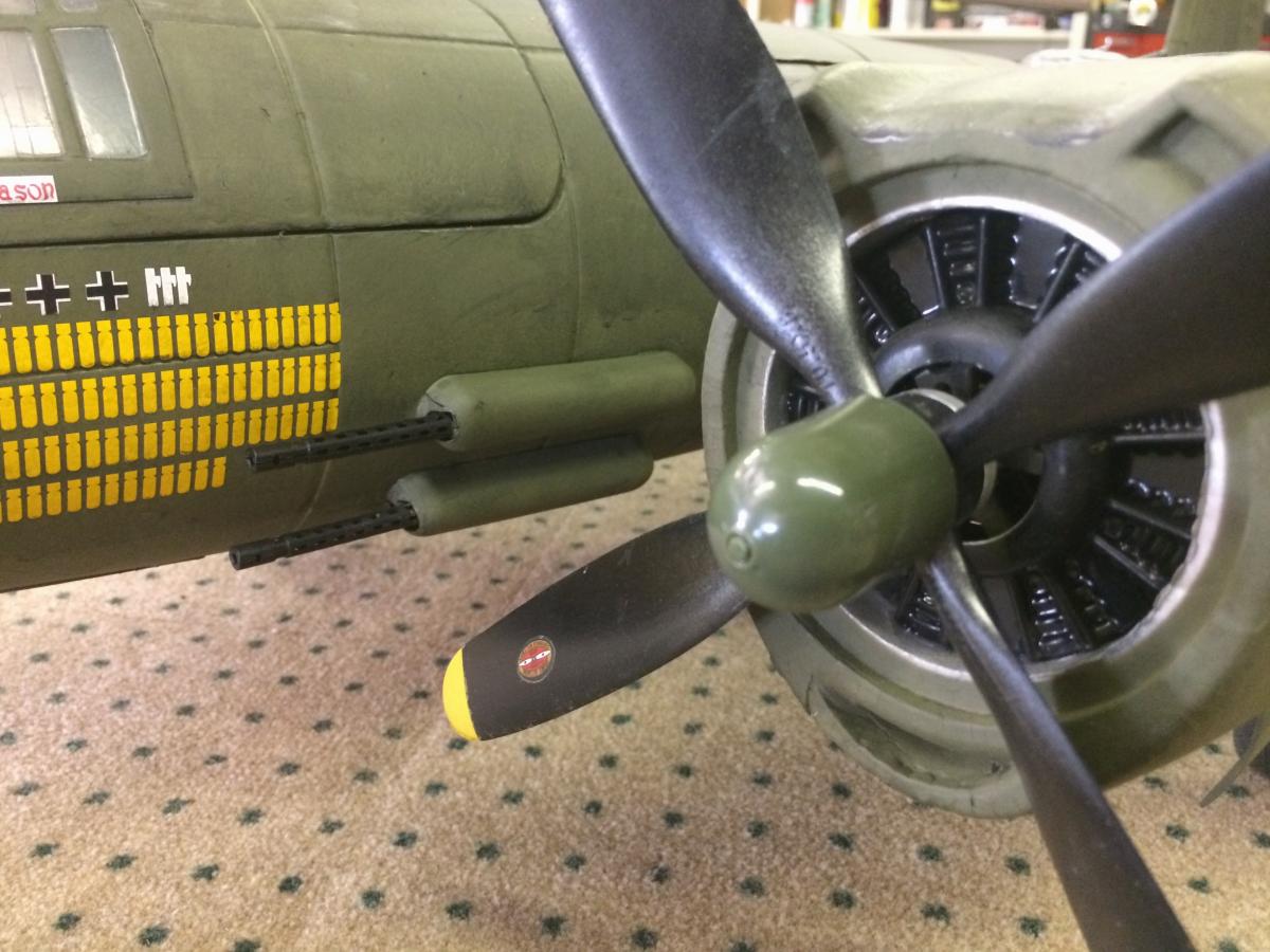

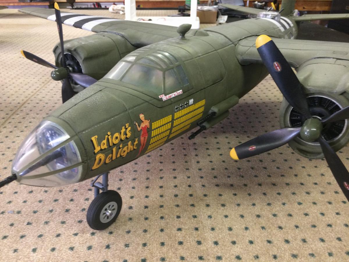

    • Weathering complete...

      • Super nice Tired Iron!
        My decals showed up. I'm not done but they look great.
        • TiredIronGRB Looking really good, but why is your cockpit glass so hard to see thru? Did you do that or the factory?
          • Originally posted by quitcherbitchen View Post
            I think those two guys had some hemp stashed ;)
            • I saw a picture of the Bombardier. He started it. LOL
