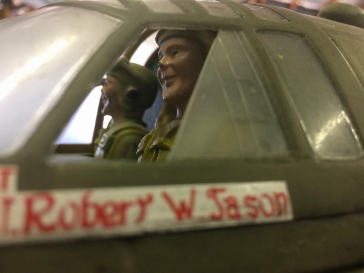

                          Your pilots look to big
                          • They will go though the weight program. Lol

                              heh - I painted a mustache on my pilot as well!
