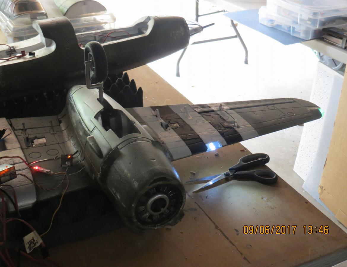

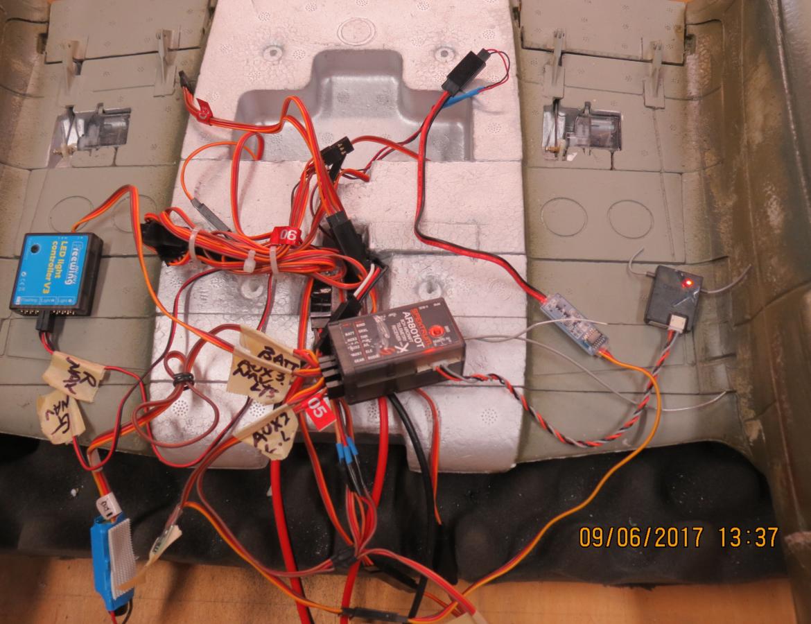

                                Click image for larger version  Name:	B-26 gear extended and L.L. on.jpg Views:	1 Size:	90.5 KB ID:	95508Click image for larger version  Name:	B-26 gear setup with labels.jpg Views:	1 Size:	133.4 KB ID:	95507 In the final throws of moding my B-26. With help from one of the guys at Robin's Hobby in Glendale, CA, I was able to first replace the red/green landing lights with white ones. Added new larger nav. lights (not the ones in the L.L. area) and covers. The covers are a little to big to be plush with the top and bottom of the wing tip, so I'm flushing it at the top and let it overhang the bottom (will add a piece of blu cor to create a fairing. The wiring setup allows the L.L. to go out when the gear is retracted and on when extended. With the L.L.on after I taxi in, I can turn them off using the Aux. 2 switch leaving the navs. on. If anyone would like to see and know about the wiring setup, I'll attempt to describe it later.
                                  You have been busy, Brent! I like the idea of on/off landing lights. I would like to do that to mine. If the brain trust up here cannot help, I will be picking your brain!
                                  Bob
