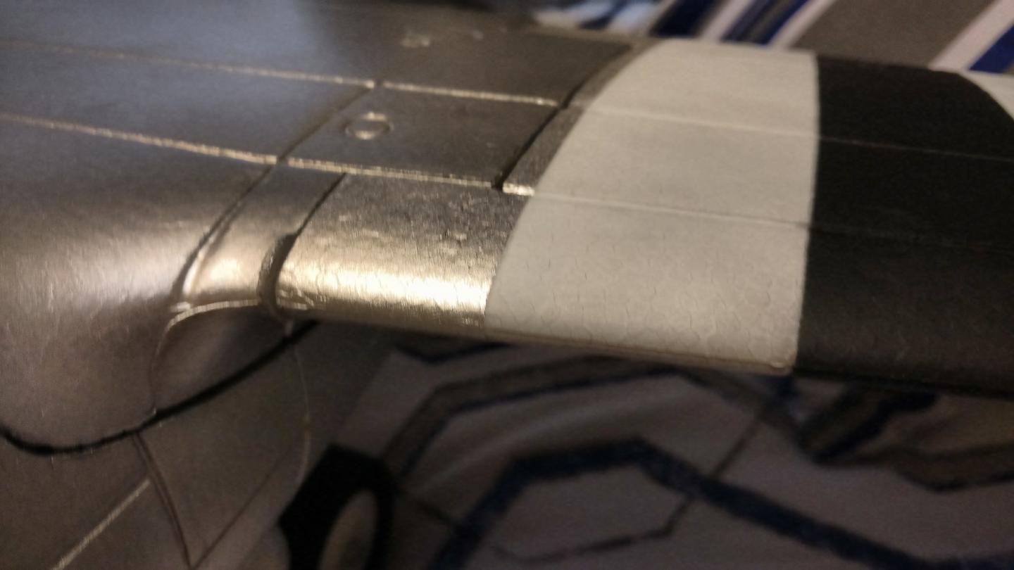

                            • Some defect I found while assembling this bird, the wing is the one I am not sure what to do outside contact Motion RC

                                • Originally posted by Bearcat View Post
                                  So what it looks like is that the bottom of the right wing panel is fitting properly, but the top has a gap. I'm thinking that this probably won't affect the flying and maybe you can just install a shim to close the gap.
                                  But I agree this problem is a defect - my guess is that the two halves of the wingtip were glued together incorrectly. (If it was the wing center section that was off, the other wingtip would have the same problem but reversed and the nacelles would be screwed up as well.) So its possible a replacement right wingtip panel will fix this.
