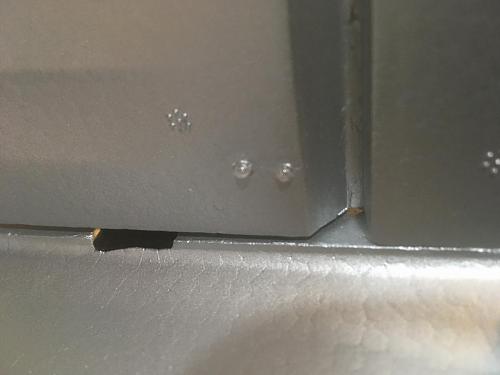

                          #1072

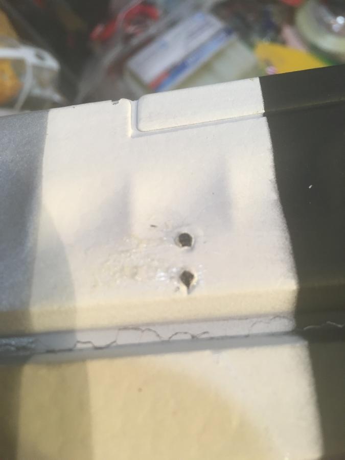

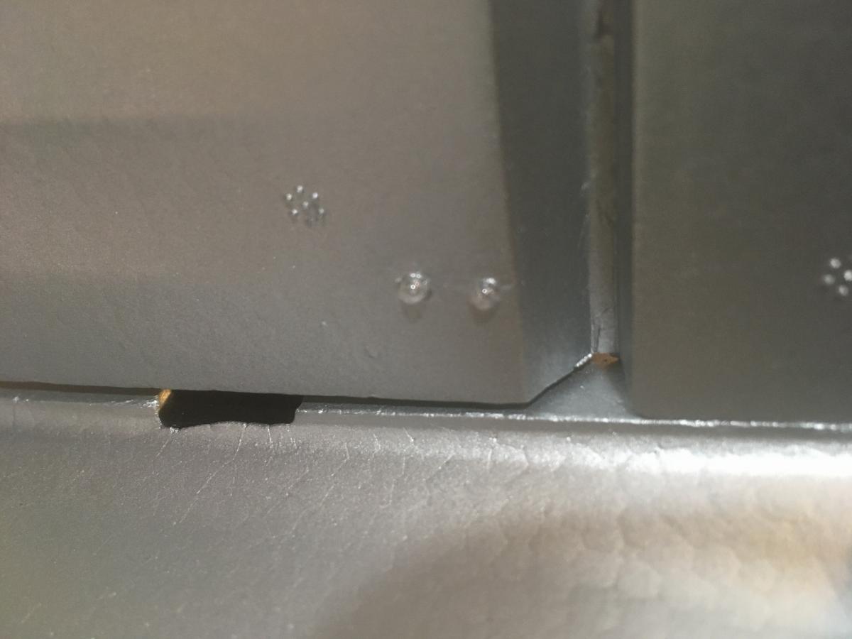

                          Interestingly enough, I bought a bag of these horns, backing plate and screws from HobbyKing some years ago. They were a few bucks but I could fit them onto several planes, estimating each one would take about 1/2 dozen sets. Oddly, HobbyKing no longer sell these in favor of the ones Dynam uses on this plane. Looking at them closely, they aren't a simple flush glued piece. Each horn has 2 pins that go all the way through the control surface and I notice that they've pushed glue into the holes where the pins go. I've put my plane through some pretty aggressive maneuvers and none of the horns seem to be prying loose. However, I use quite a bit of expo on mine, especially when I haven't dialed down the rates. I can imagine that if someone were to use high rates and little to no expo, those horns would take quite a bit of yanking around and could work loose.
                          On planes that come with the screw type horns, they usually aren't installed. That's left up to the end user to do, so they aren't saving any time do it at the factory.
                          I've attached a couple of close up shots of the "other" side of those control horns and you can see where the glue has come through. On those ones that didn't seem to have enough, I leached in some foam safe CA as added insurance.
                          Click image for larger version  Name:	IMG_2955.JPG Views:	1 Size:	33.3 KB ID:	100669Click image for larger version  Name:	IMG_2956.JPG Views:	1 Size:	63.5 KB ID:	100670

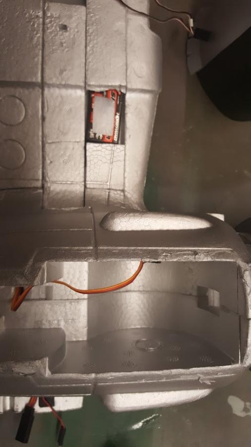

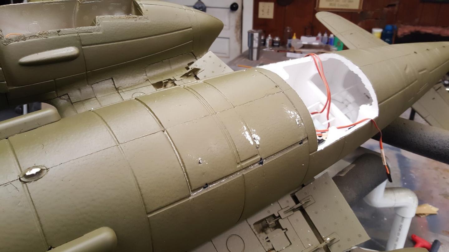

                            Whats happening guys!! Thought I would share my B-26, and where it has been, and what I have done.

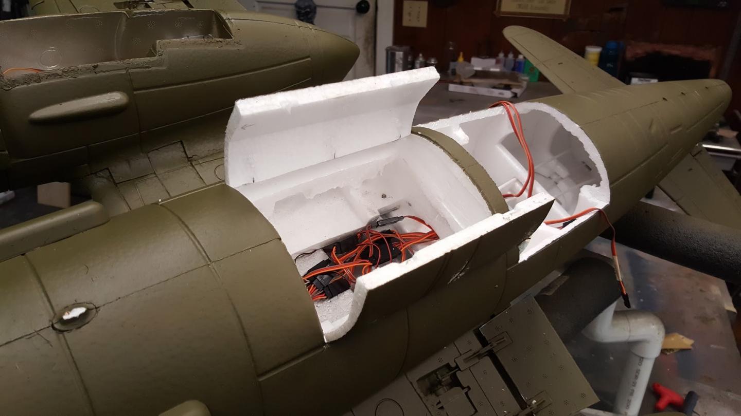

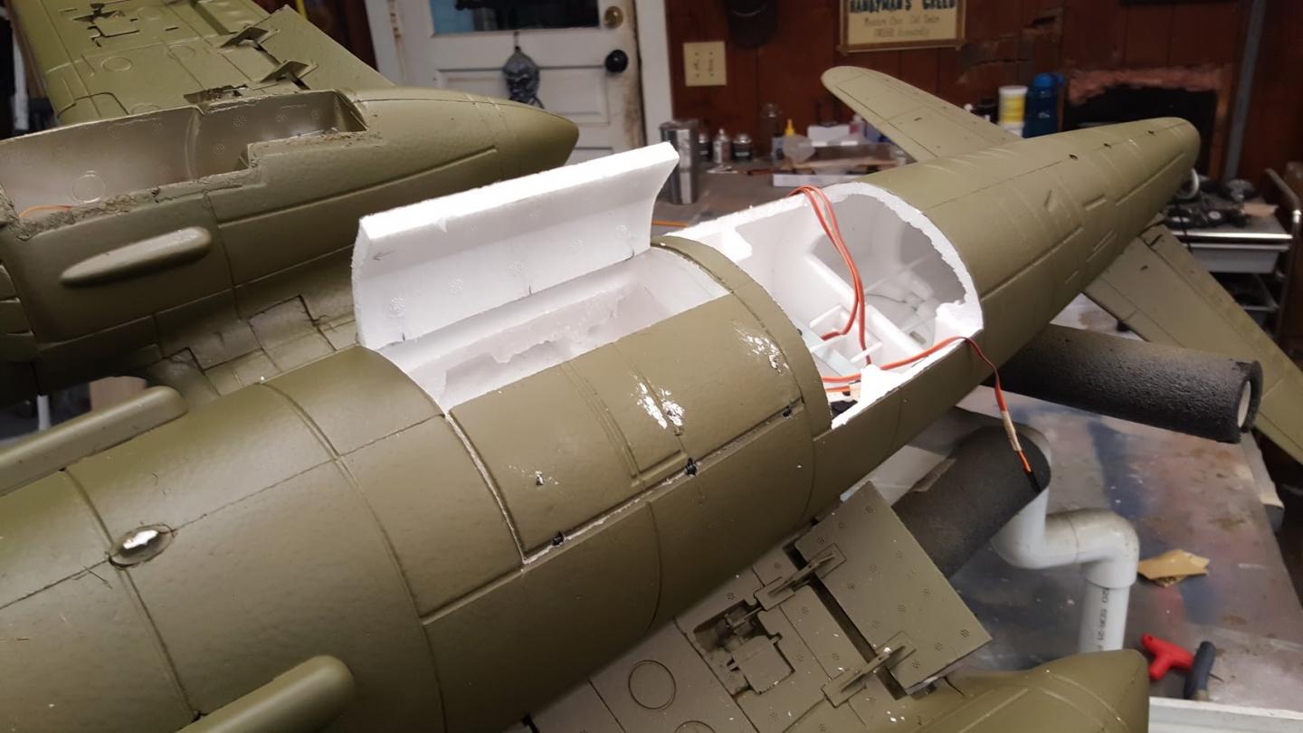

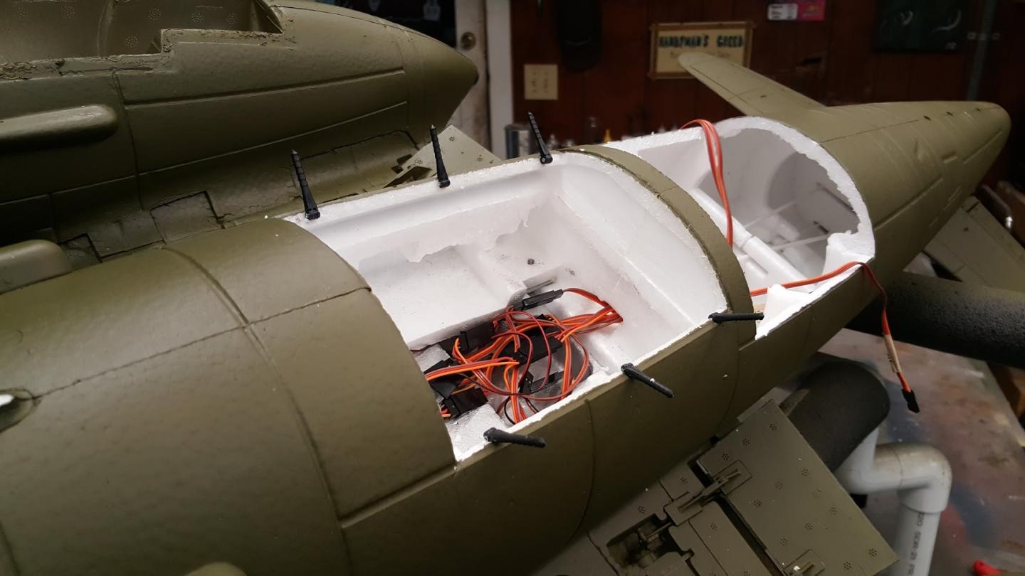

                            So, out of the box, everything worked just fine. Of course it has an XT60 connector, and all of my high end 4S batteries have an EC5 on them, so I changed it out. No big deal right? It wouldn't have been if I had not put the negative bullet in the positive hole accidentally!! I get to the field for the maiden, and BANG!!! The wires instantly fused and exploded. A shard landed on top of the wing and melted a nice hole in it. Of course, it fried an ESC in the process.
                            Anyone who has done any work on the plane knows the ESCs are buried in the nacelle, and you can't access them. I had to cut the nacelles off. I did this by running my Exacto through all of the glue seams that I could reach, and then rocking and pulling the nacelles until they came free. Fortunately, this did not result in any visible damage, and I was able to access the ESCs. I have a ton of spare parts laying around, so instead of ordering new Tomcat ESCs, I replaced both of them with the 40A Hobbywing ESCs from my ill fated Freewing 64mm A-10. These worked great, as I had no desire to put the ESCs back in the nacelles, and they had very long motor wires. This allowed me to mount them in the bottom of the wing in the forward wire trough. I cut the center out of the covering foam, and left the heat sink open to the airflow.
                            Once this was done, I also added a very long Y connector in the mix to run up into the nacelles so that if I ever needed to change out the main gear, the connection would be right there, and I wouldn't need to fish anything through the wing and nacelle. With all of this in place, I was ready to put the nacelles back on the wing. This is one nacelle back on, showing the connector in the wheel well, and the exposure of the ESC.

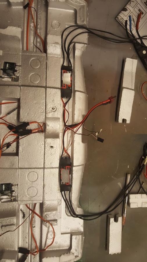

                            Time for some mods for this bird. In this case, a bomb bay, paint job, and a wheel change!!
                            I cut the bomb bay doors off the bottom of the plane, and of course, the elevator and rudder servos are right there. I cut the entire tray out, clipped the z bends off the pushrods, and pulled them back out the end of the model. This left me with a nice open cavity. I then cut out the panel lines directly behind the bomb bay to move the radio equipment to. I didn't want to move it forward, so back was the ticket. I found a nice, clean open bay, that even has a nice shelf to mount the servos to. Clipped the guide tubes for the pushrods back, and re routed all of the wires from the nose to the new radio bay. Then I added a few Robart hinge point pinned hinges for the doors.
                            Then, I separated the doors, drilled the holes in them and prepared them for mounting. This is as far as I have gotten on this part of the modification, as I need an Admiral 10 channel receiver, and a GT Power electronic switch before I finalize the door servo position and control horns on the doors. The finished product will incorporate an electromagnet on each side of the bomb bay made from two 16 penny nails (one on each side), that will magnetize thin sheet metal strips that will be on the inside of the bay walls. Then, I will fashion some foam bombs, with a little lead shot in the nose of them for ballast, and a thin metal strip on the side to "stick" to the metal strips while the magnets are energized via the electronic switch with power from the flight battery.

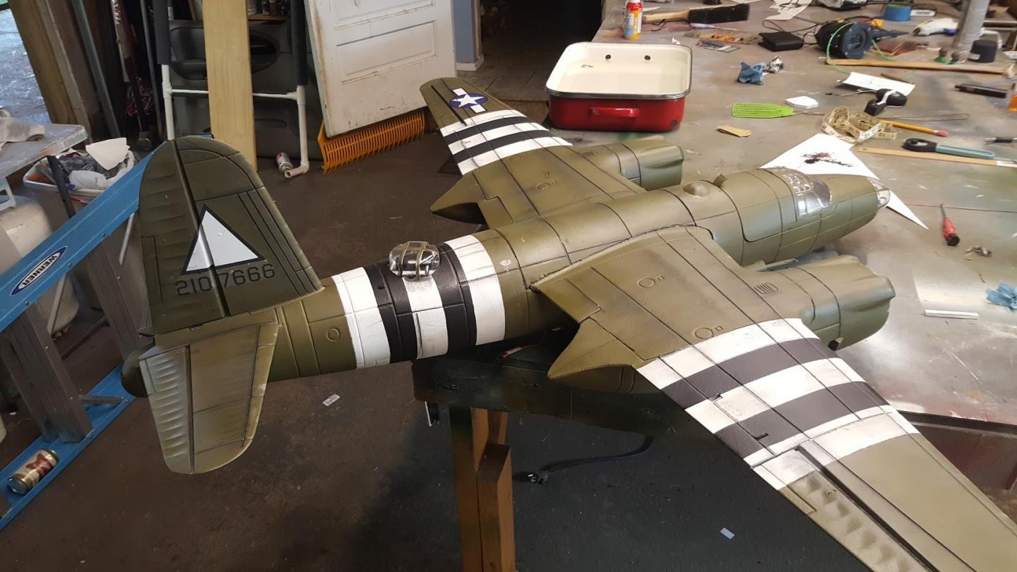

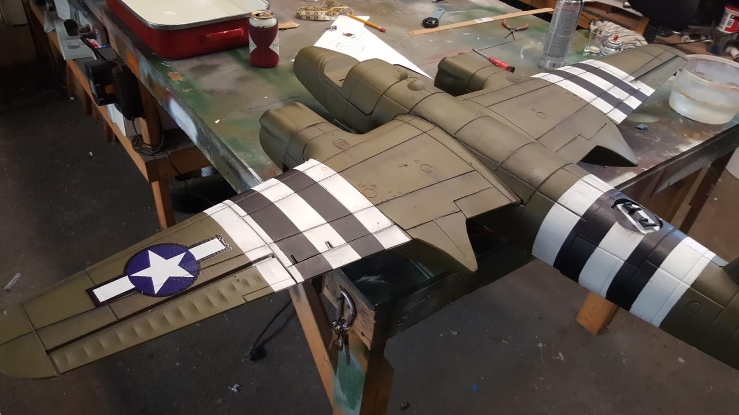

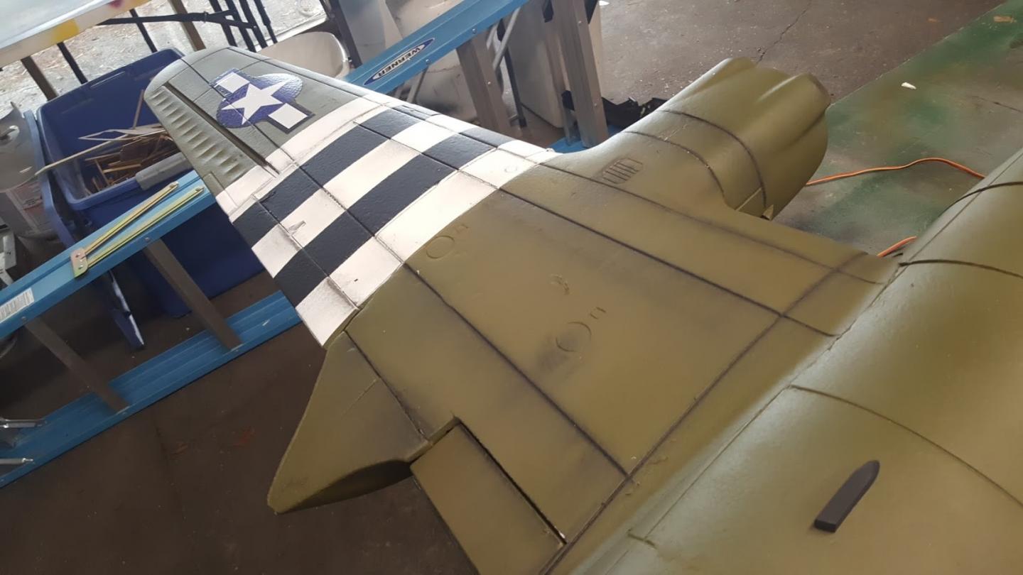

                            PAINTING AND WEATHERING

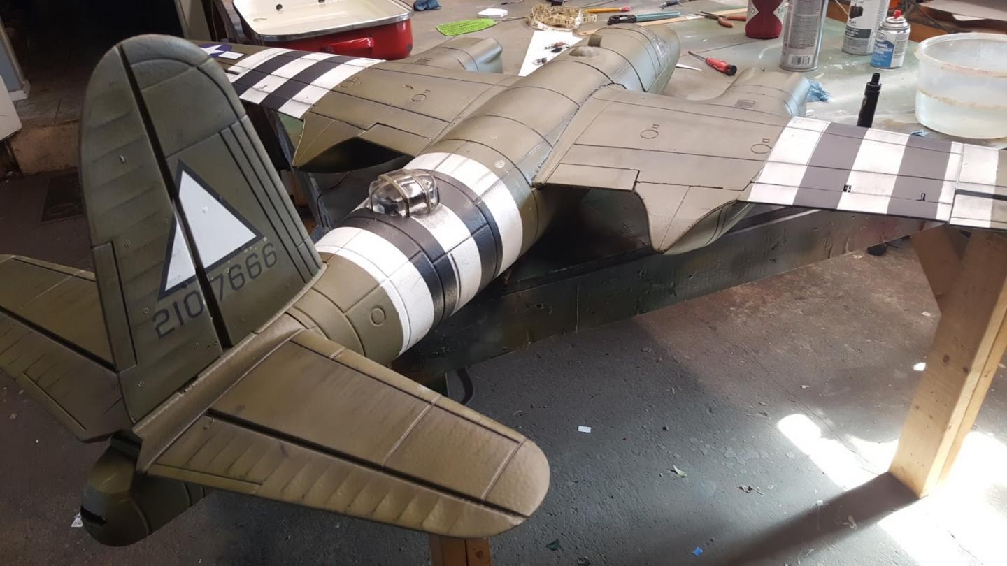

                            The finish is Testors OD Green sprayed directly over the factory finish, with no additional work being done to it. I replicated the invasion stripes using the "Blue Paper Towel" method of masking, and it worked very well, as usual. I used Rust-O-Leum Profession enamel in Flat white and Flat Black for the stripes. The bulk of the weathering has been done using a "Generals" charcoal slab (Available at Michael and ACMoore) as well as "Generals" pastel chalk for the leading edge distress and some brown mixed in to simulate rust here and there. I use the slab to apply the charcoal to the panel lines, and then use a paper towel to fade it out in the direction of airflow
                            So, this is where I am at. Since these photos were taken, I have painted the OD bar through the fuse invasion stripes in anticipation of decal application. I have Callie making me the "Little Pink Panties" nose art. I will just use the stock decals for the rest of it, as there are no liveries that I really care for in the OD color. So, it will not be a "scale" livery, but that's okay, it will still look really good, and outside of a few aficionados, no one will ever be the wiser. I will post more as I get it done. I will be ordering the receiver on Wednesday, so I am hoping to have her complete by our Event of The Year November 11th.
                            Happy Landings guys!!

                              #1074

                                Kloverzero---Your plane is beautiful---hope with all your efforts, it flies as well as it looks. Good luck

                                      #1078
                                      I put three good flights on it before the starting the mods, so hopefully there is no change in the characteristics, because it flew very nice previously!! Thanks as well, I am putting some time and effort into the finish!! I think a nice bomber is worth that (and it helps with re-sale value, LOL)

                                        #1079
                                        Kloverzero the plane looks great. I have one on the way. Still haven't decided on a livery. I hope some day to do a bomb bay but will see.
                                        Would you mind a short explanation of the Blue paper towel masking?
                                        • quitcherbitchen
                                          • 927
                                          • Altadena, CA
                                          #1080
                                          Looks good Kloverzero. My only suggestion would be to forget the magnets and go with servos on the bomb bay. That way you can close them.
