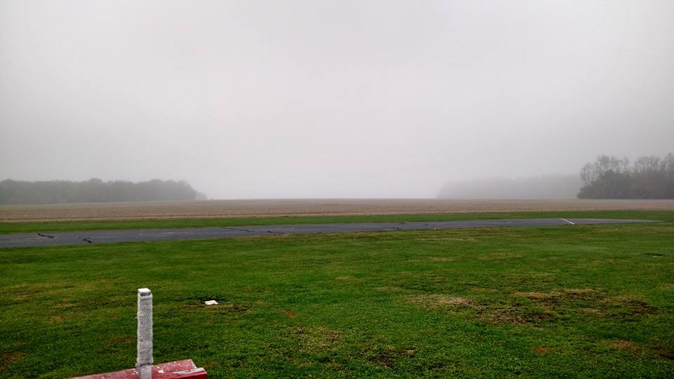

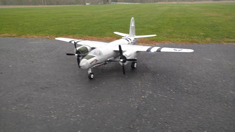

                          • This morning a did a huge test with the B-26 and honestly I knew this could have ended badly on landing but I flew with the temps being 44 degree and foggy as hell. This test answered the retracts answer and I have answers for everybody so I will break this down from start to finish.
                            *44 degree tempature
                            * retracts will raise and lower but if they don't wiggle the rudder stick and they will drop 100% of tries.
                            B-26 flew great with some windy but man with silver paint it blends in the fog too fast!!!
                            Elevator I was able to bring flush but the plane is too nose heavy at 55mm for CG so I will move the battery back to 58-60 mm range next flight.
                            Both flights were conducted with an Admiral 4000
                            First flight it was noticed she was pitching nose up when you let the sticks go, I was forcing down elevator to keep her from stalling, I did manage to take her to the edge of a stall twice before giving her down elevator and lower power, landing was done in the grass with purrfection.
                            Second flight I changed the elevator from 3mm up to even ZERO..this gave me a stable flight with no tip stalling but let go of the stick and she dives even at full power so this tell me to move the battery back 3-5 mm or the elevator might need a slight up or maybe use a lighter 3600 4s battery..
                            Also the right cowl came loose again which caused the angle to point down and I kept noticing a pull to the right so I will epoxy this down and that should take of that issue.
                            Has anybody shimmed the front landing gear to raise the nose alittle?

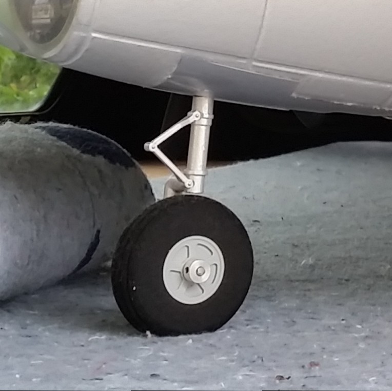

                                    • Originally posted by Bearcat View Post
                                      Do you mean 2 3/4 or 2 1/2 or 2 1/4, Tower Hobbies is not showing a 2 3/8 wheel of that brand.. ( which is made in Hamilton Ohio near me!)
                                      Hi there,
                                      By the way, yeah I installed a slightly larger nose wheel. This helps the model take off a bit easier. But the REAL reason I did it is because the full-size B26 sat on the ground like that (picture below) and I wanted it to have that look. Its just a silly anal-thing I like to do, I like my planes to look scale. Well at least I try. Sigh. The main wheels aren't correct either.
                                      Well I'm pretty sure its a DaveBrown. The wheel doesn't have the size printed on it - I just measured it the best I could, using a ruler. It's bigger than 2-1/4. Maybe its a 2-1/2? I was shooting for a wheel that was slightly bigger than the original one.
                                      I guess what you can do is take the nose wheel off yours, and measure the distance from the axle to the point where the wheel will touch the strut... that's the maximum size (multiply by 2). My wheel is just clears the strut. Here's a picture of the nose wheel on my B26.
                                      By the way, Motion has these. This is the "treaded lite flight" type. Here's a link to the 2.5" size. Here's a link to the 2.25 size.
                                      I just measured again just now. I swear to God, it's exactly between 2-1/4 and 2-1/2. So I don't know what the hell is going on.... :Thinking:
