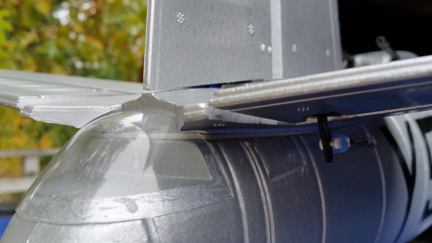

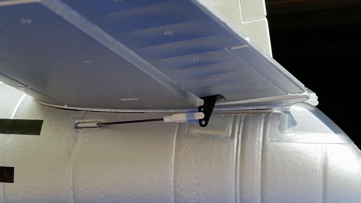

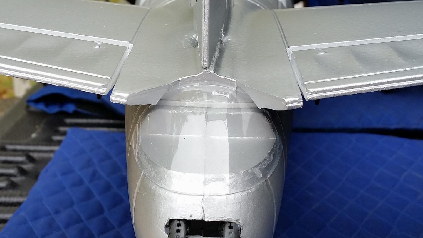

    • Anyone have pictures of the shim mod ?
      • Originally posted by weedsnager View Post
        I posted them in RCG, but here you go...
        • Is the entire shim 3mm or is it tapered?
            3mm at the back end...you can see the taper in the bottom picture.
