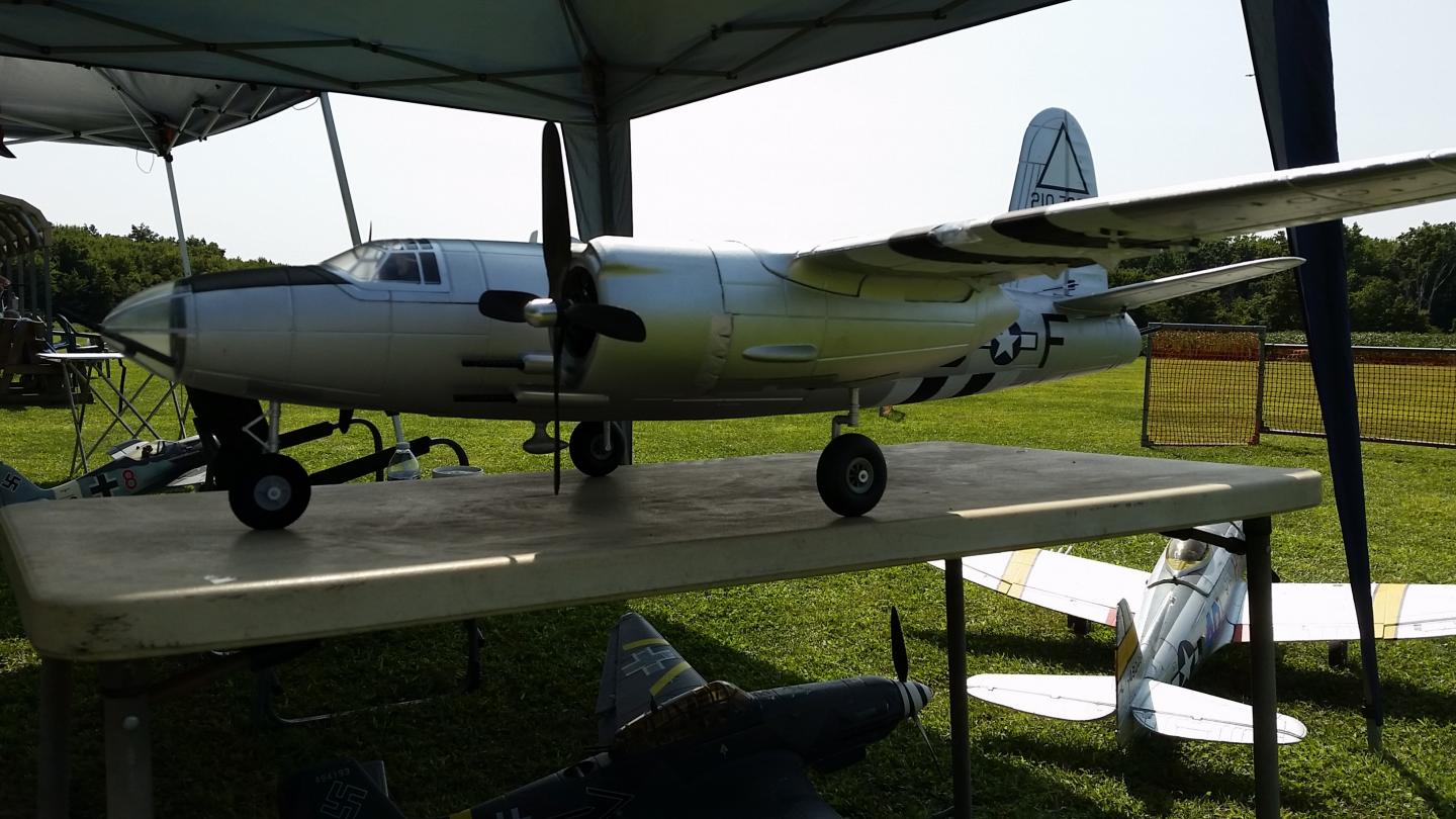

  • Congrats on the maiden. OUTSTANDING job on the paint / weathering. :Cool:
    Woody
    • Nice Brent. Corey did great and it makes your WOW planes B-26 look amateur both in looks and flight characteristics.
      • Thanks guys for the kind words. All the effort I put into her was well worth it. Here are a few more pics I took at Apollo on the day of the maiden.

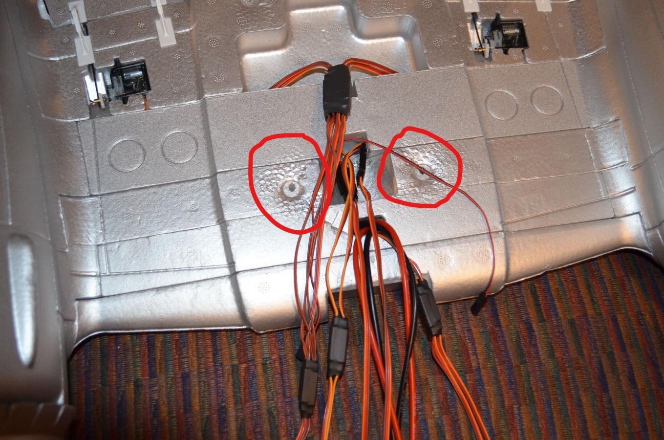

                              • Trying to get this buttoned up today. Doing electronics and details... Replaced the elevator servo with a 17g MG from Freewing. Using a CC 20 BEC and added telemetry wires for the flight pack voltage. Replaced the Y and 3-Way connectors in the wings and changed out the aileron extension wires since they were glued and stiff at the connection points. Then used heat shrink to secure them all and get them into a "neat" rat's nest! LOL Opened up the dummy engines to help the ESC's breath. Have to clean up the openings a bit. Then I am going to pull the motors and check the ESC connections and heat shrink them together if possible... May reverse the motor rotation to spin the props outboard.

ID:	94342 On the underside of the wing, you can see how crushed the attachment points were from the mounts breaking loose in the fuselage. Also, the wires were pinched in the saddle too.. I am so glad I took the wing off!! Hope all the issues are sorted out now.... :Drinks:
                                  • Absolutely, I really think it is an absolute must to remove the wing and do a complete check over.
                                      Agreed. Better before you fly than later in a "what the hell happened" mode.
                                      Bob
