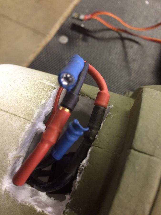

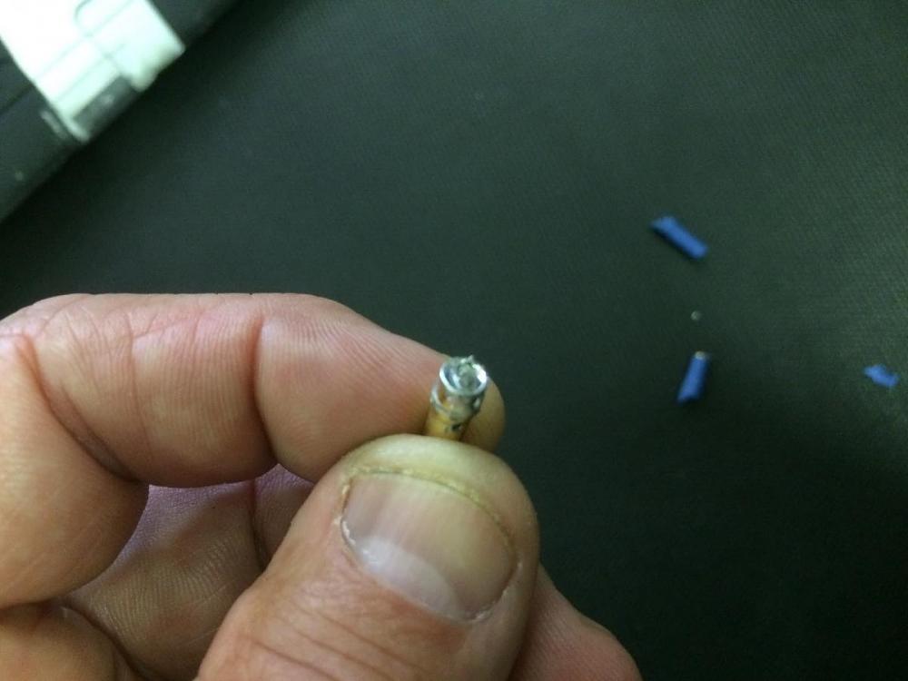

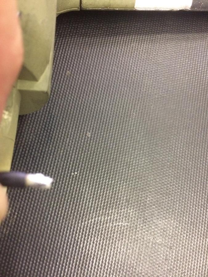

        One of the ESC terminal ends that plug on to the motor came loose, all that was holding it was the heat shrink, it looks like both the wire and terminal were "tined" good but had pulled apart to the point were only a very small pin point was holding it on.

        Oh wow, yet another thing to check carefully for sure. :(
        • That is an easy fix, too bad the airframe isn't.
