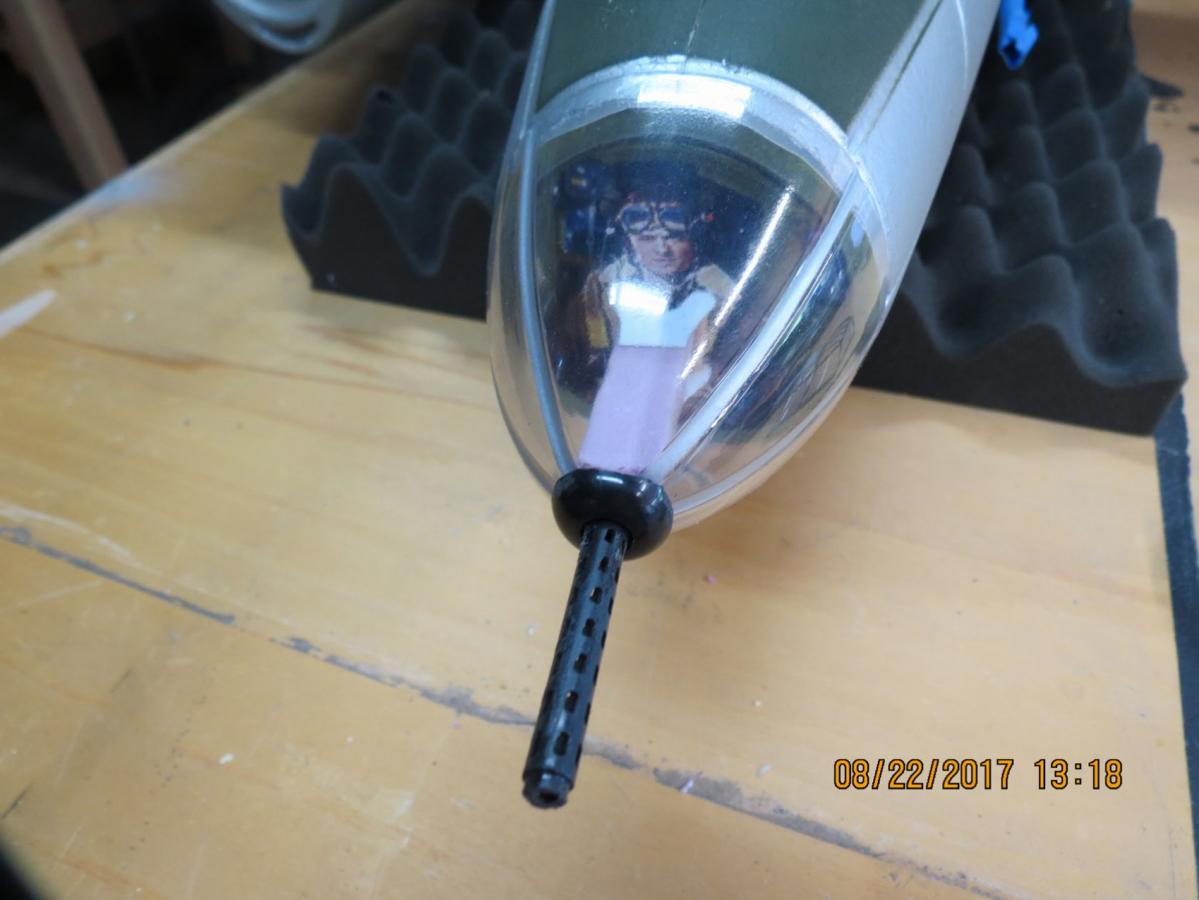

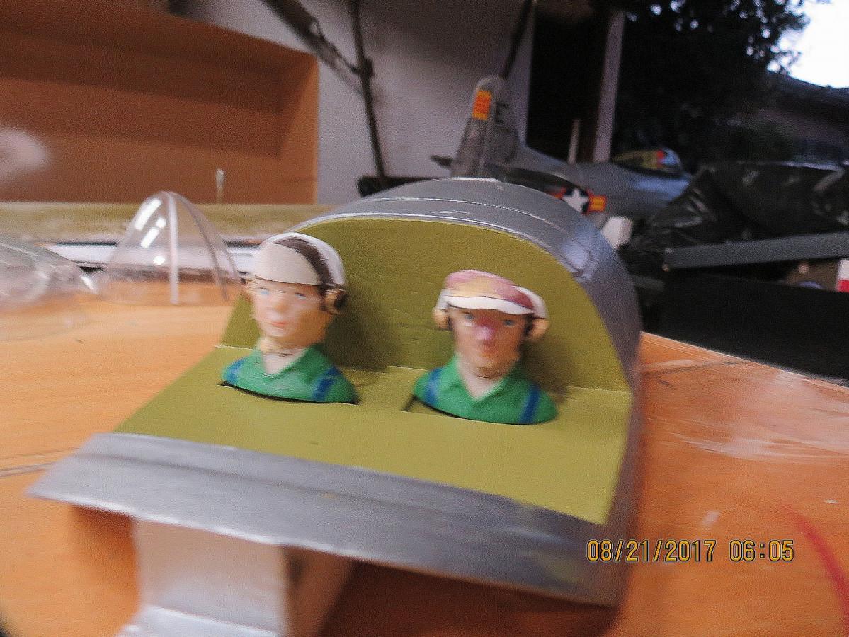

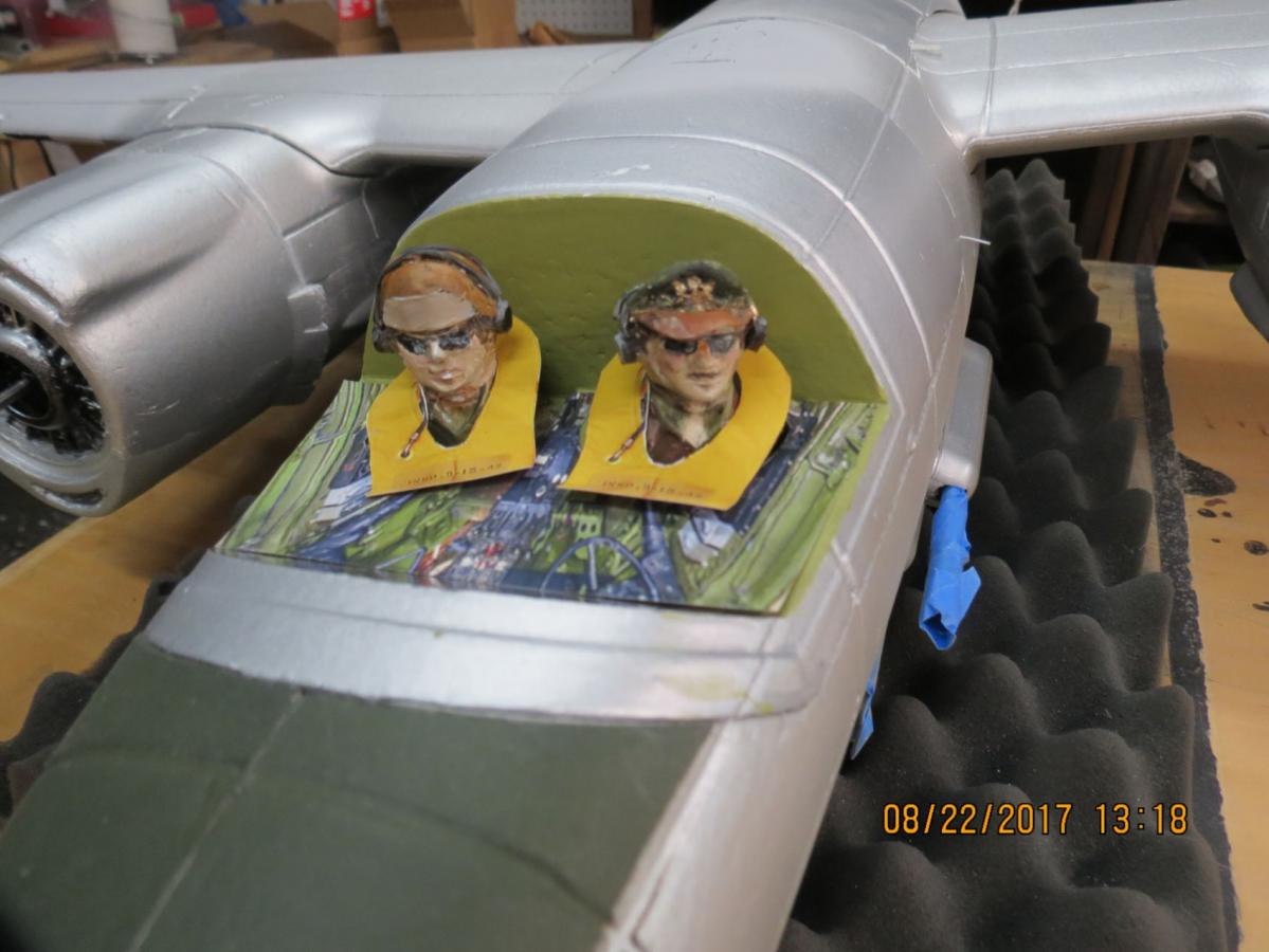

                            I totally agree re: those awful pilots. So 'here come the mod'... couldn't find any replacements in my stash of pilots the right scale, so had no choice but to 'fix'em up! With a little carving, various additions and some acrylic paint I had a couple of good ole boys that looked half way decent. I thought the additional of life jackets added a touch of color. Nose gunner. Used the image kindly supplied by one of you guys and added a gunner. Moded the gun to look more like a '50 cal' plus added a ball joint on the canopy. Paint to come!

                            • Here are the pics showing my changes to the pilots and nose gunner position
                                They weigh in at 4oz for both together

                                • Originally posted by Bigrc2 View Post
                                  That's awesome!
                                    Hahaha I love it man! Thats awesome
