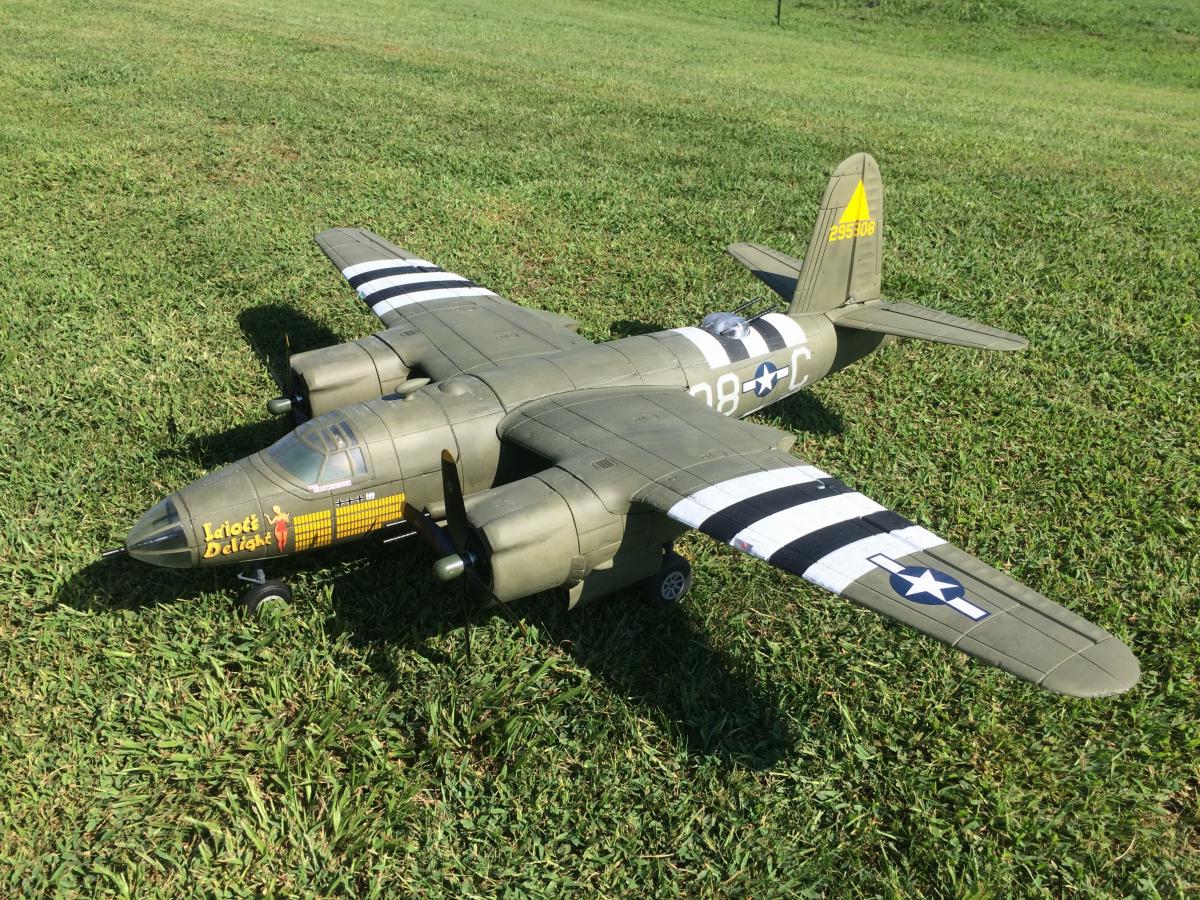

                            • I must say I'm really loving this plane, I'm getting 12 minutes on the new Admiral 4S 4000s. She is very well behaved and landings are very predictable...and she just looks awesome!
