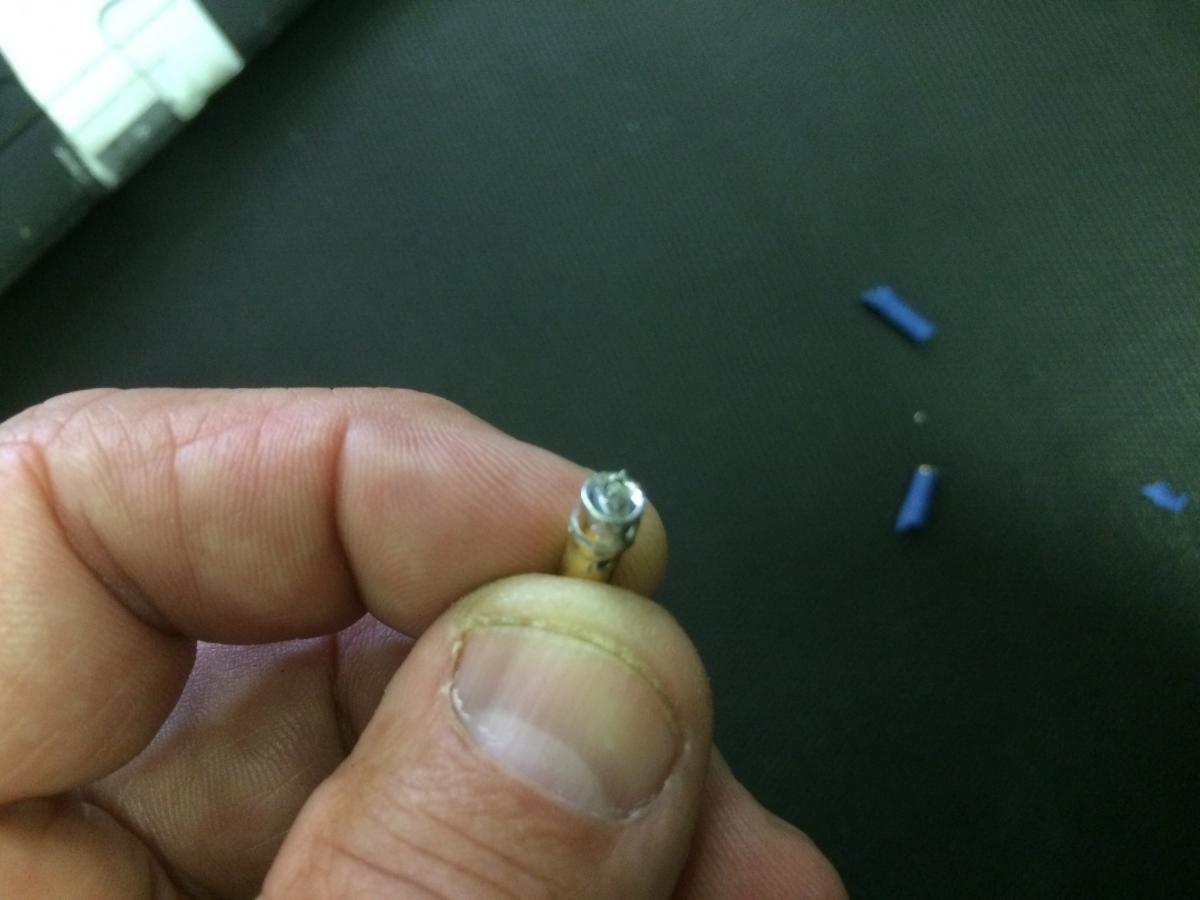

                                  Martin from Motion contacted me and is going to try and help me out on this one if it's an actual motor or ESC issue so I'm going to tear into it.
                                  • Knowing Dynam I am betting on the motor as the culprit.
                                      Excellent!
                                      • So to cover what was done with mine to fly how it was meant to with 4000 and 5000 packs... First there was no tail weights. Second cg point (for mine) was 65mm. Third was the 1/8" wedge up to the trailing edge of the horizontal stab. 4th make sure the wing screw anchors are glued to the bottom of the slots they sit. With all that checked you should have a nice smooth flight.
                                        • One of the ESC terminal ends that plug on to the motor came loose, all that was holding it was the heat shrink, it looks like both the wire and terminal were "tined" good but had pulled apart to the point were only a very small pin point was holding it on.
