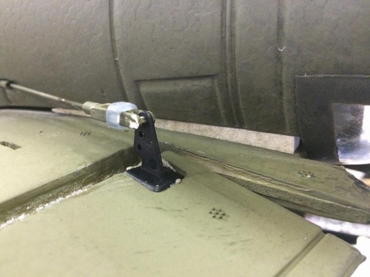

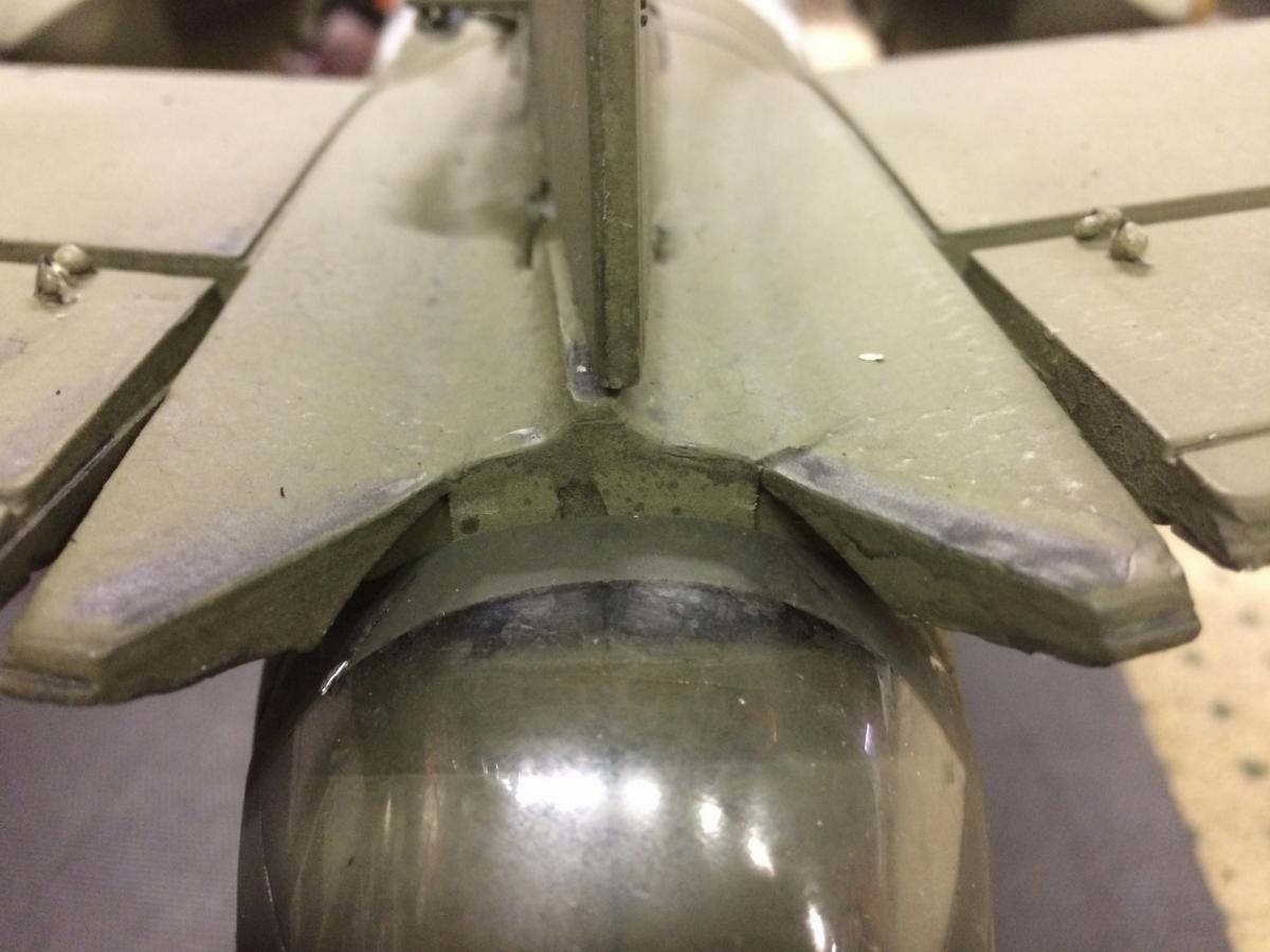

                          • I had some excitement yesterday, the elevator servo died in flight...I was able to ease it down with throttle. While I was replacing the servo I decided to follow MD's lead and work on the incidence of the stab by adding a 1/8" wedge...this made a major difference in how the plane handles, I highly recommend it.

                              I think Rifleman was the first to use the spacer. I just lowered the LE. (Either way, its the same result) Were you able to take out the "up" trim, as a result?
                              • The plane looks like it faired ok, 1/8 inch was my conclusion as well. It really seem to level the stab.
                                • I still have a little up trim but not much. RM I was able to land it without issue with the throttle....the elevator was pretty much centered.
                                  • Good to hear that
