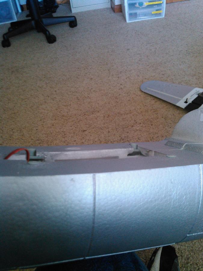

I spent about two hours last night trying to see what needs to be adjusted to get the wing's top cap to fit properly. I had already fixed the magnets and that didn't do it. The problem is that the wing isn't sitting down in the saddle correctly. After taking the wing off I discovered that the mounting plates in the fuselage aren't very secure - when you tighten the bolts they just pull up - because the soft foam doesn't offer much strength.Originally posted by xviper View PostUnpacked mine today and as someone else already mentioned, that lead weight in the tail was just rattling around loose - probably what caused the rear guns to detach and rattle around, too. Anyway, I took that weight out. I'd rather move the battery back or use smaller batteries to make it balance. That top wing cap is really ill fitting. Don't know if I'm going to mess with it. Tried shaving a little off the rear lip but that didn't do a thing. It could be the magnets aren't embedded enough and that's what's holding the cap too high up. The front lip is easy. I'll Blenderm that in place.
This could be a major problem - if you tighten the bolts too much, the mounts could come loose and the entire wing could come off!
I'm confident that if the wing can be pulled firmly down all the way into the saddle, the top hatch will fit properly. In order to do that, I'll have to epoxy those mounting flanges into the fuselage.Marc flies FW & FL: AL37, MiG-29, T45,F4, A4, A10, F104 70 and 90, P38, Dauntless SBD, Corsair, B17, B24, B26 & P61, Lipp.P19, ME262, Komets, Vampire, SeaVixen, FMS Tigercat, FOX Glider & Radian XL.

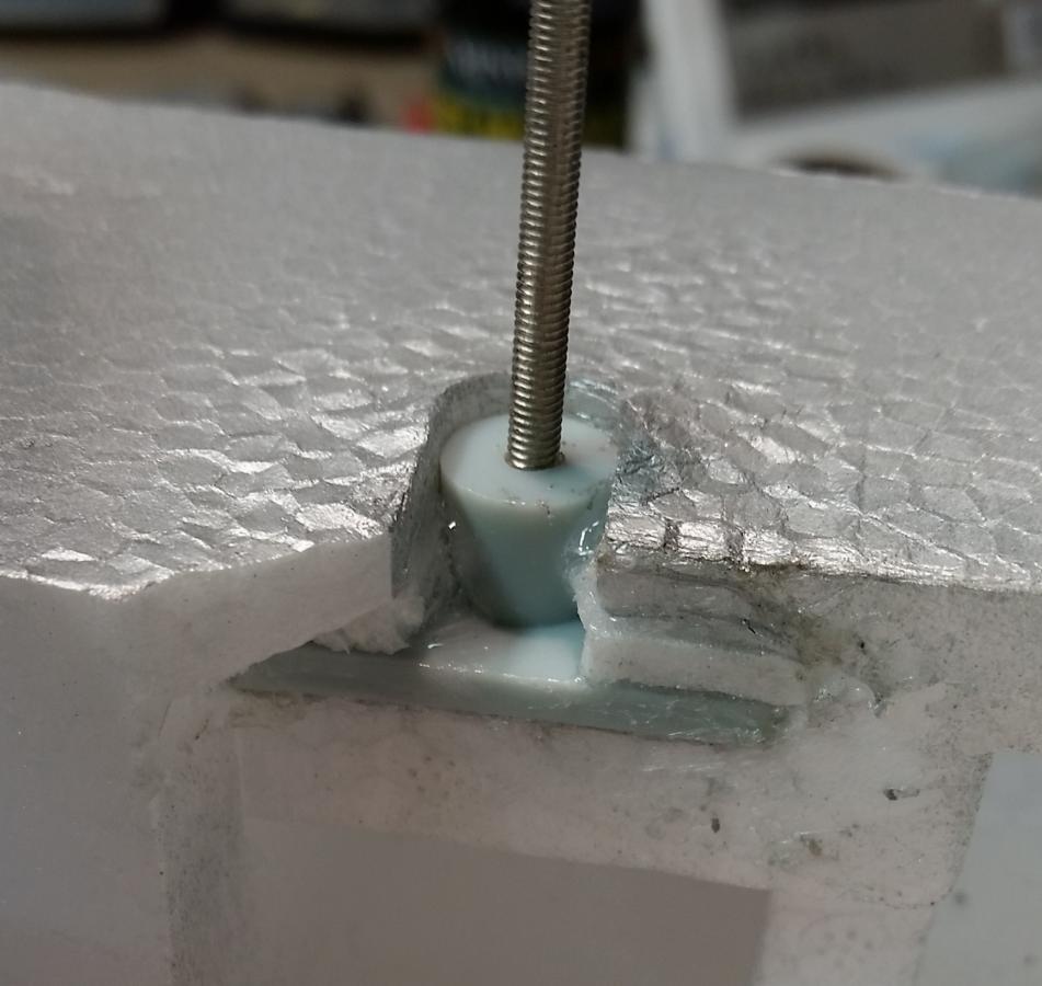

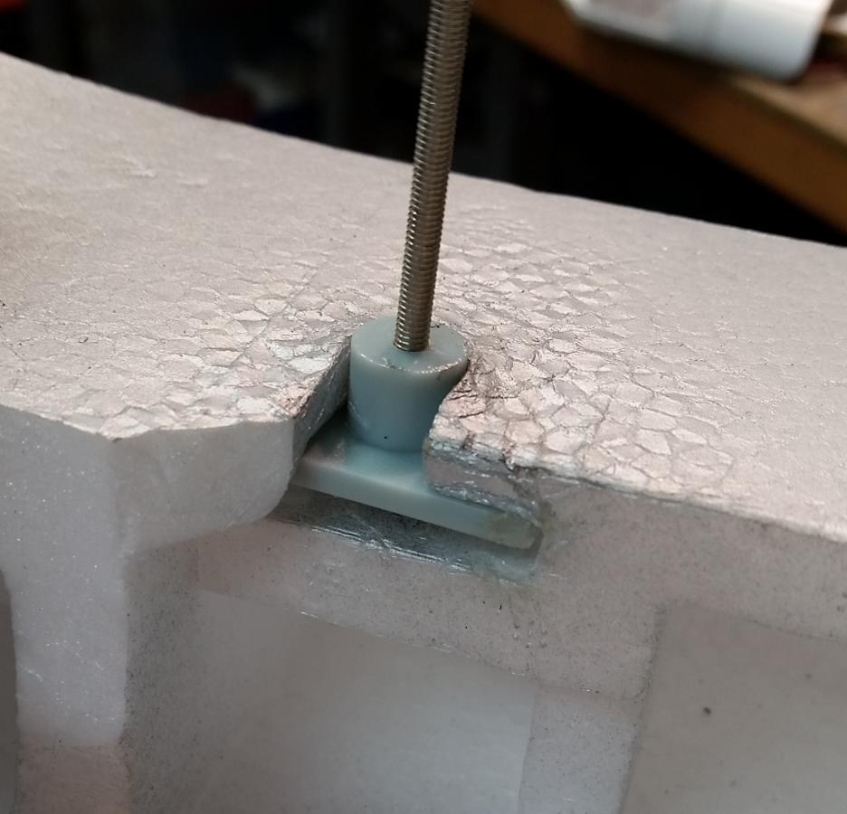

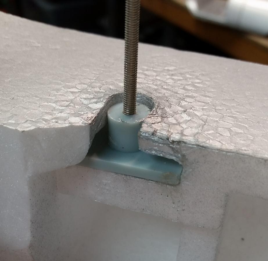

Here's an update regarding the wing mounting issue I've commented on.
With the screw in place, I was able to pull out the plastic piece pretty easily - it wasn't glued in very well. I reinstalled it (I used Foam-Tac) by gluing it to the bottom surface instead of the top surface
Then I used some scrap foam to fill in the gap. This gives it a much firmer support.
The following pictures are in sequence... "before", "during" and "after"

One must also consider that when the wing is in place, the surface of the wing that touches that area will help to hold it in place. It shouldn't wiggle around quite that much. If anything, the foam will compress a bit but not allow the anchor to wiggle like that. I think if the screws aren't turned overly tight, it should be OK.Originally posted by themudduck View PostHere's an update regarding the wing mounting issue I've commented on.
I wiggled the part in the video to illustrate that they were loose and the foam there didn't have much strength. But I do agree with you, under compression it won't move around. See the thing is, my wing wasn't sitting down all the way in the TE part of the saddle - there was a gap. As a result the wing cover was sitting up about 1/8 inch. So I tightened up those screws. Instead of pulling the wing down, it pulled the mounts up (and into the bottom of the wing, compressing the foam). There is only about 1/8" of foam above the plastic mounting pad on the saddle, so there wasn't much there for it to pull against. So my concern is that the foam isn't strong enough there. Also I found that the plastic parts weren't glued in very well.Originally posted by xviper View PostOne must also consider that when the wing is in place, the surface of the wing that touches that area will help to hold it in place. It shouldn't wiggle around quite that much. If anything, the foam will compress a bit but not allow the anchor to wiggle like that. I think if the screws aren't turned overly tight, it should be OK.
Anyway I just completed my modification. It was very simple and they are much more secure. I haven't put the wing back on yet, I need some time for the glue to dry.
Of course I'm also going to check that the wing is fitting properly in the saddle. It seems pretty good.Marc flies FW & FL: AL37, MiG-29, T45,F4, A4, A10, F104 70 and 90, P38, Dauntless SBD, Corsair, B17, B24, B26 & P61, Lipp.P19, ME262, Komets, Vampire, SeaVixen, FMS Tigercat, FOX Glider & Radian XL.

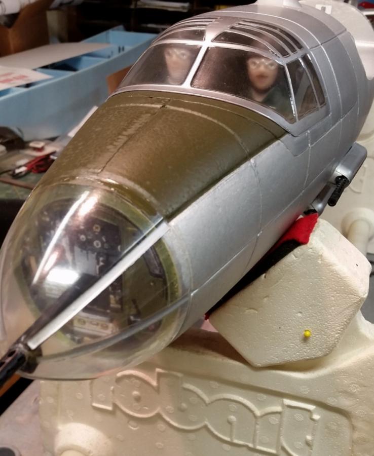

Here's a pic... I've been working this afternoon on a few details:
a) I trimmed the nose and installed that nice bombardier's office picture (see post 405)
b) I re-painted the OD anti-glare panel in front of the cockpit and also painted the cockpit interior
c) I re-painted the shirts on the pilots
d) I added a mustache and wing pin to the pilot (co pilot hasn't started shaving yet)
e) taa daa
