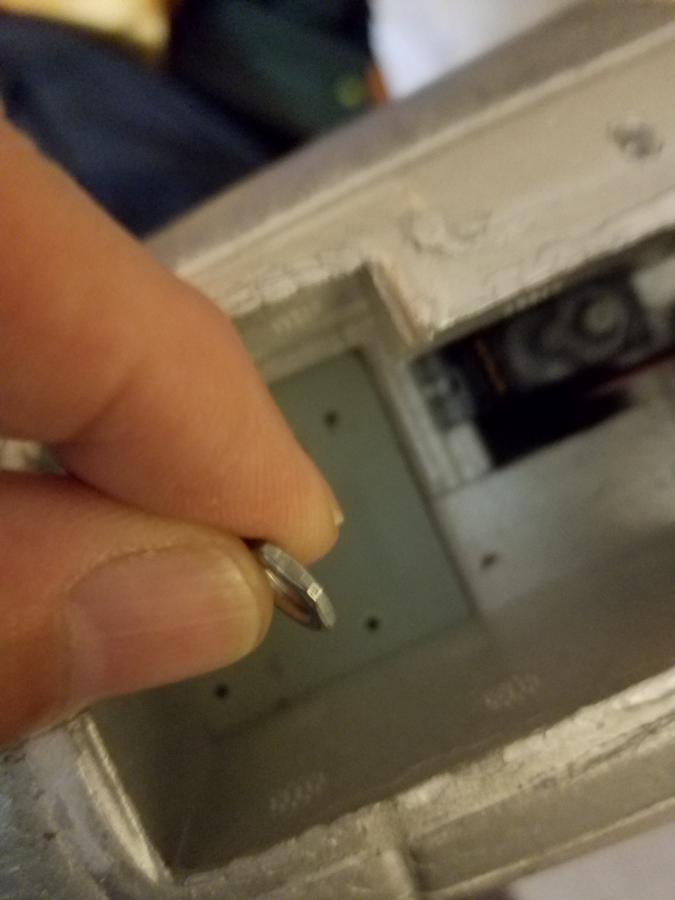

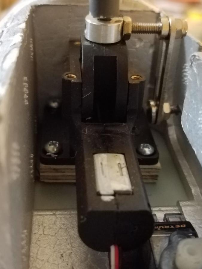

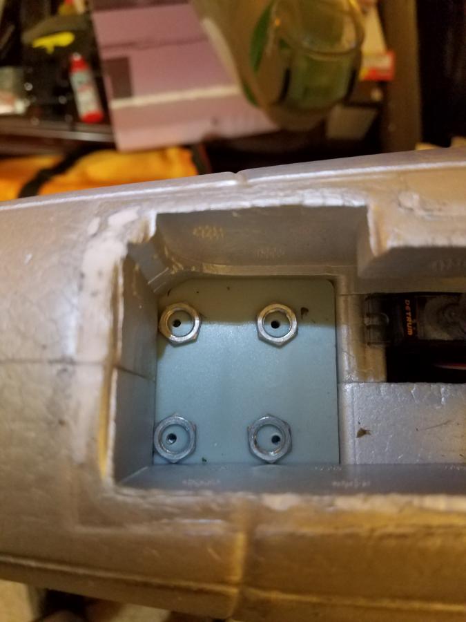

                                    My first flights have been a bit less than graceful at liftoff with the plane popping up more than lifting off. Our grass has been pretty thick and a bit tall but I still want to raise the AOA.
                                    I decided I would add a spacer under the front retract as I don't have a larger wheel at the moment.
                                    So I remove the retract and what do I find? Spacers of course. Nuts!
                                    Ummm, nuts used as spacers I mean. 1/4 x about 3/32 thick. I found it pretty funny. Use whatcha got I guess!
                                    I made a spacer out of 1/4" ply and will see if that helps.
                                    • The business about these spacer nuts was first posted about months ago ......................
                                      It was a surprise then and I guess it's still surprising owners today.
