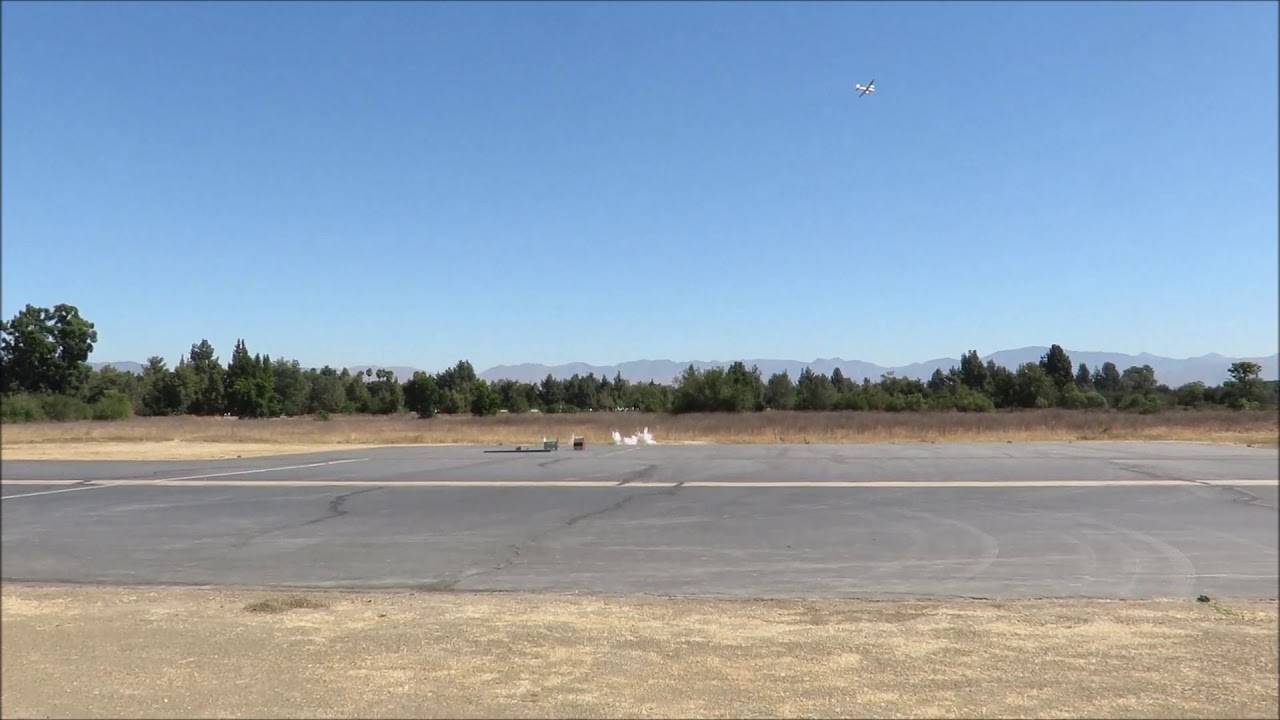

                        • Here is the combat footage of my Saturday's mission at Apollo Field. It was windy and the plane is a handful in wind. I will be putting in a Gyro for sure now. flying around at full throttle too most of the time.
                          • Nice! And yes i agree, gyro her up!

                              • Those hits were pretty close though. Closer that I've gotten :P

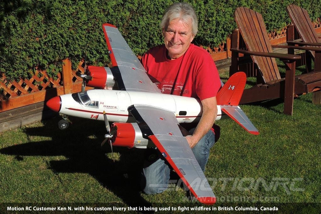

                                      • I through this is really cool. Its on the Moiton Rc sight under the B26.
