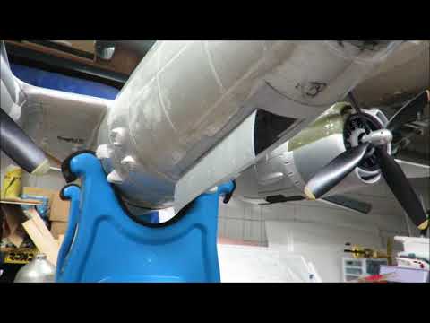

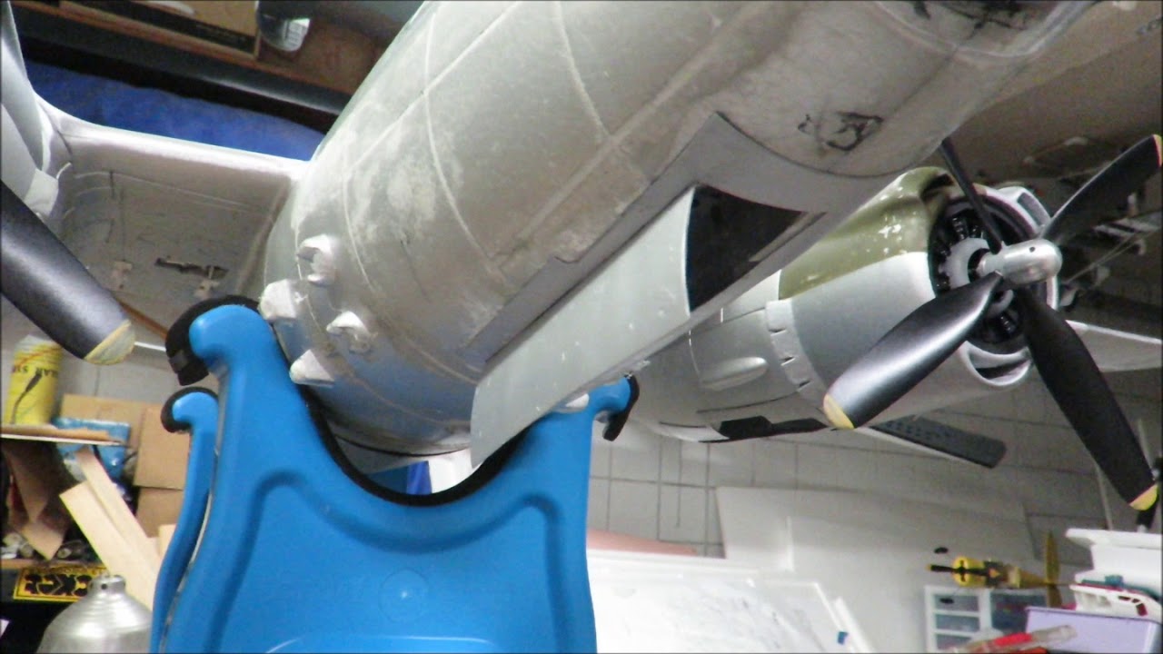

So I received my sonictronic spring hinges to do my landing gear door mod. I am a little worried the Dynam retracts won't be able to overcome the spring tension in the hinge. Those little springs are stiff.
I also got my bomb bay doors to close without making the servo buzz by lengthening the control rod on one side. Must have been a geometry error on the servo placement on one side. Now they work perfect. The bombs still come out of the plane much more scattered then with my B-17. I think the bomb bay is quite narrow on the B-26 and the bombs must bump into each other on exit. Or the plane is flying faster then my B-17 and the bomb tails have more bite. Any angle off and they go further in that direction before stabilizing.2 PhotosDon't just fly--WREAK HAVOC!!!
- Likes 3
The Sonictronic spring hinges for the gear doors worked, but they really put a load on the retracts. I am not going to use them. I even tried lightening the spring tension by uncoiling one wrap off the hinge. No luck. Instead I will use an FMS 3 second sequencer from the old 1450mm P-51 and servos. I bench tested and it works. I buried the Dymond 2.2 gram servo half way into the wall.Don't just fly--WREAK HAVOC!!!
