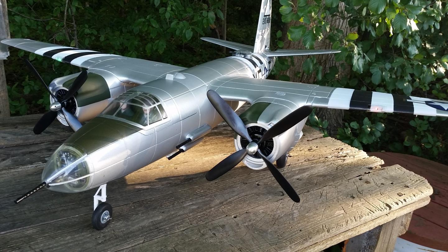

                  I guess I will chime in - there's LOTS of info earlier in this thread about the weights, balance, stab incidence, and so on. And some conflicting opinions as well.
                  I would certainly recommend going through the earlier posts, when we were going through initial impressions and flight testing.
                  I went through all of the fixing with the bad construction and bad fit and hatches and so on
                  (check the wing attachment points in the fuse)
                  , but I really like the way my B26 turned out. Its a really nice-flying unique model and has a great look.
                  I did these things:
                  - used a smaller battery and no tail weights. Result is a lighter plane (less wing loading). I can fly well over 12 minutes using a 3600.
                  - balanced it a little further forward than most in this forum (I did a lot of flight testing). Tail-heavy B26 is a BIG BIG no-no. "The Widowmaker" will get you if you don't pay attention.
                  - shimmed the stab TE up several mm. This helped a lot with overall flying characteristics
                  - cut down the control throw on the elevator in particular.
                  - replaced the race-car wheels with Robart wheels - and I installed a slightly larger nose wheel to raise the nose, this gives the model a slight positive (and prototypical) AOA while on the ground.
                  - I always take off with half-flaps and land with full flaps. Without the flaps, the model will snap in a heartbeat at lower speeds.
                  Sadly, I left the toy pilots in the office. but I repainted them and gave the pilot a mustache and flying wings!
