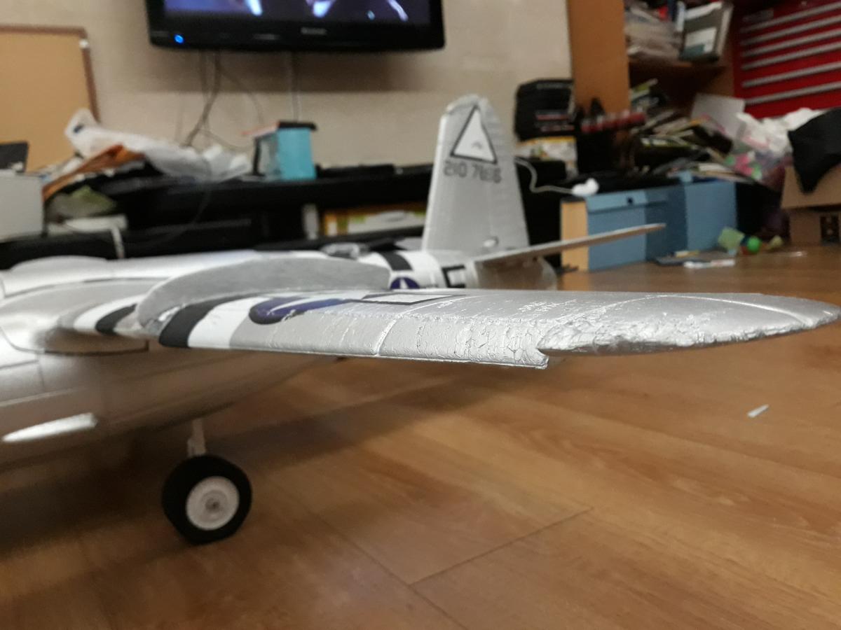

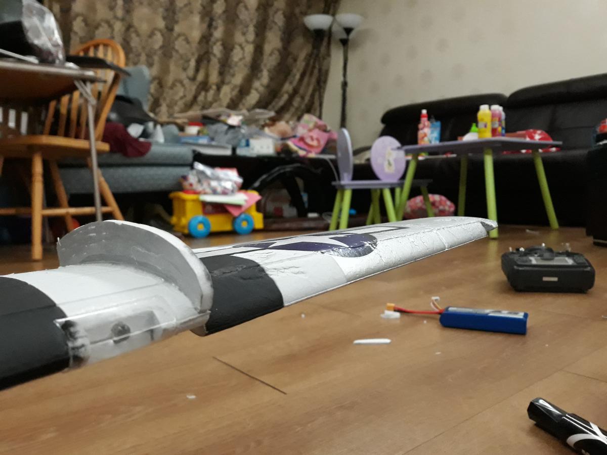

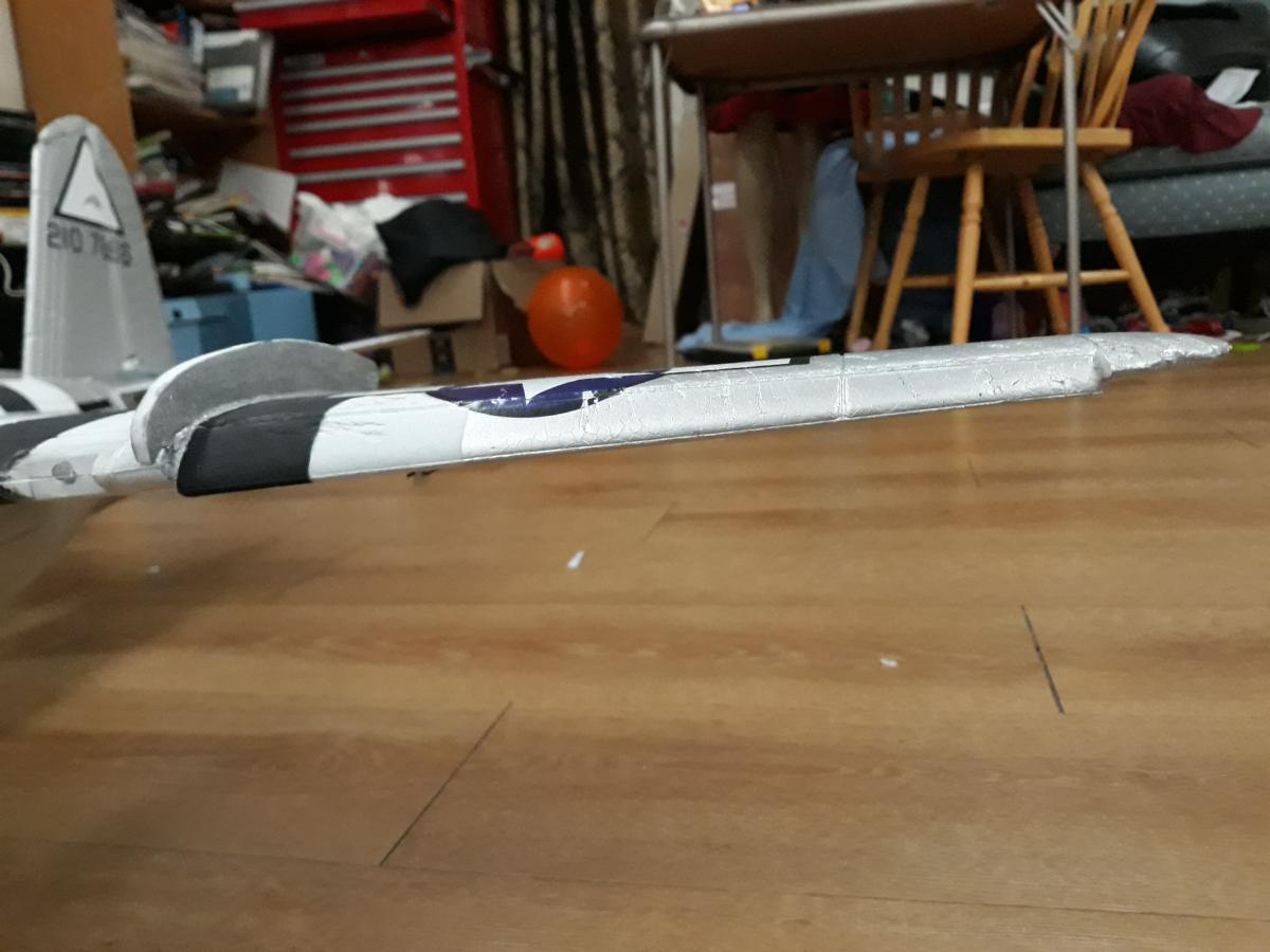

              • Step 1 of mod
                • Removed about 6mm tapered down to 3mm at the wingtip, leaving about 2mm of foam depth on the top of the wing to allow bending.
                  • Creates a "V" incision inti bottom edge of the wing's underside
                    • The end result is increasing the camber on top of the outer 1/3 of the wing so that in landing attitudes the lift is evenly generated the full length of the wing. More importantly the outer 1/3 of the wing doesn't benefit from the induced lamenent flow of air, what we call "apparent wind" from the props. That portion of the wing's ability to create lift lies solely with your head wind and the aircrafts forward speed.
                      • At higher AOA it ensures that the 1st 2/3 of the wing stalls before the wing tip, thereby ensuring the preferred nose down stall instead of the wingtip stall. Sorry forgot to add, just add some hot glue and bend and hold the leading edge down for a minute to complete the mod. Wing fences will go on tomorrow.

                                  • The mod is complete. I'll post pics tonight with the wing fences installed. In the landing configuration, drooping the ailerons, like flaperons in conjunction with the flaps is an awesome idea. It would be like an F-14 or F-18 using the whole wing to create extra lift and drag, by adding all that camber on the full length of the wing. I might split my ailerons into two separate channels and program that in. Can't fly it until this weekend anyway. But my real reason for completing this mod was to see if I can cruise around in the clean configuration nice a slow flying patterns without adding flaps or being in the upper 3/4 of the power quadrant to keep from stalling in the turns.

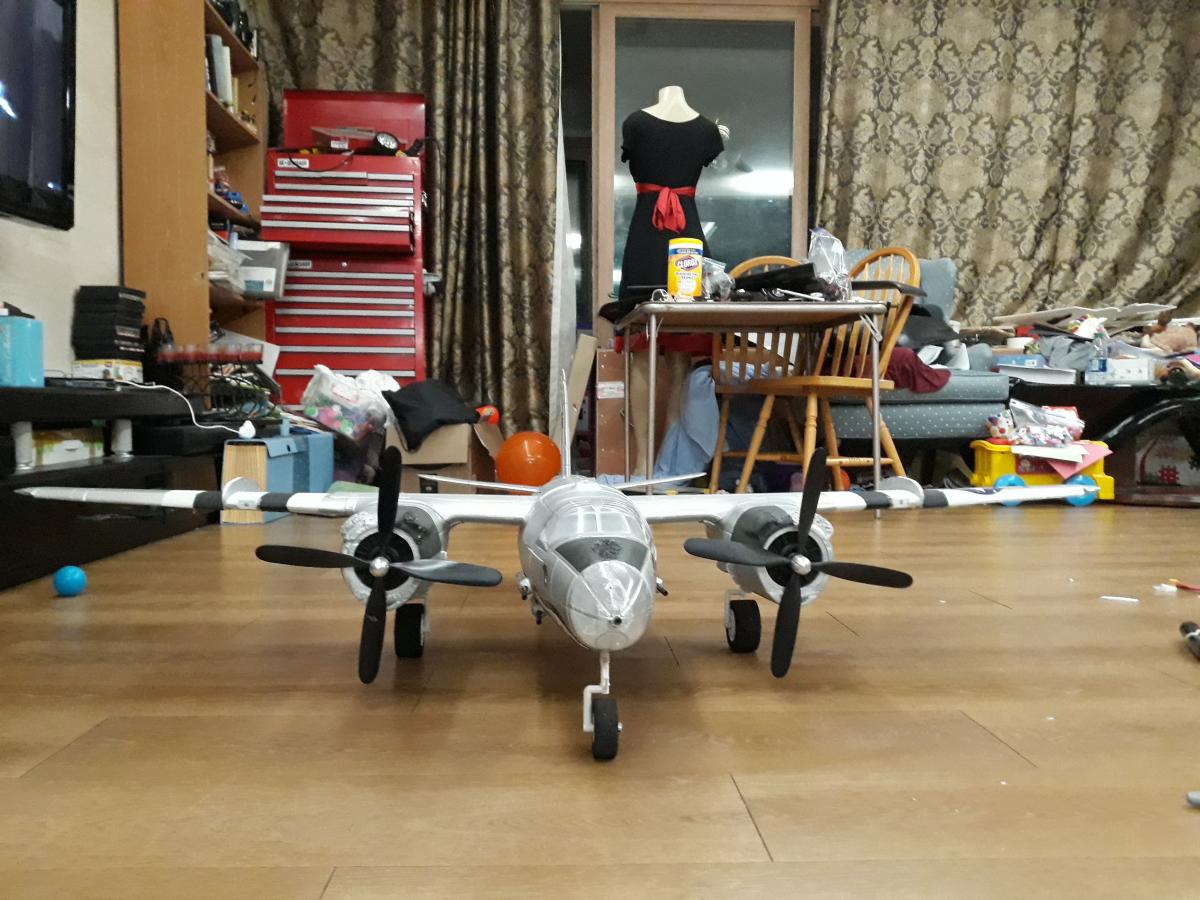

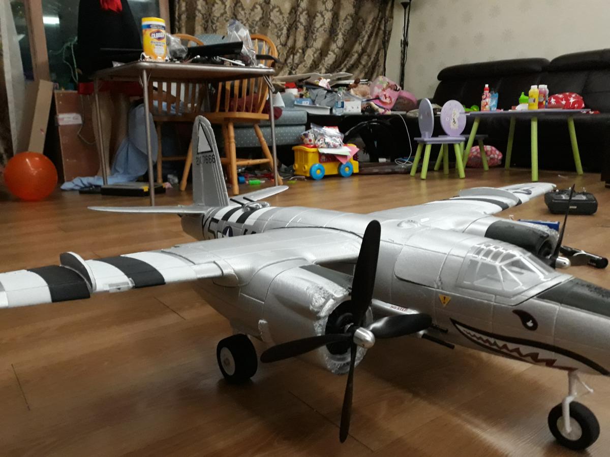

                                    • Mod pics and a vid below enjoy.
