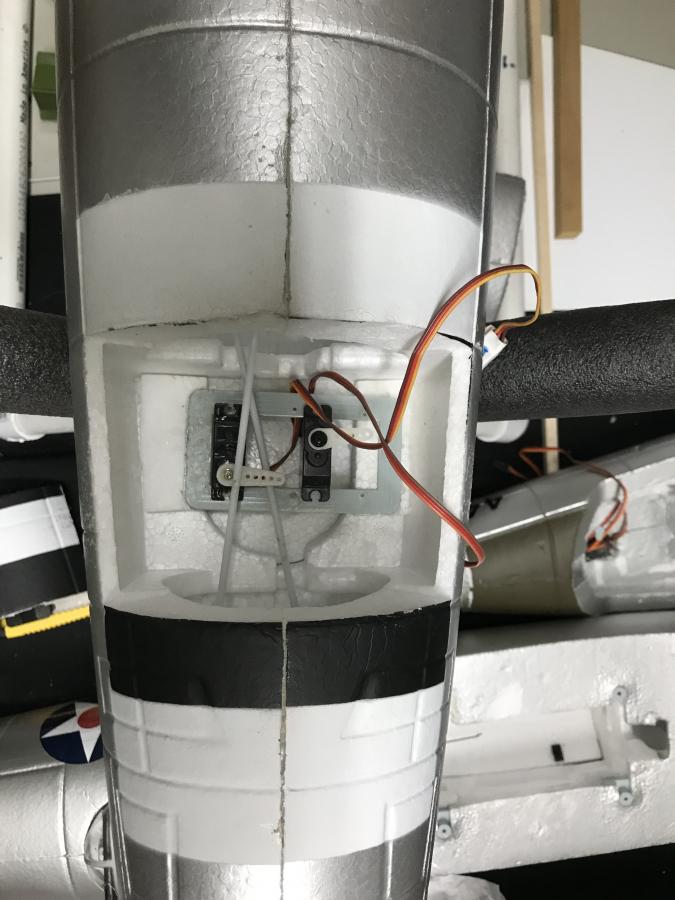

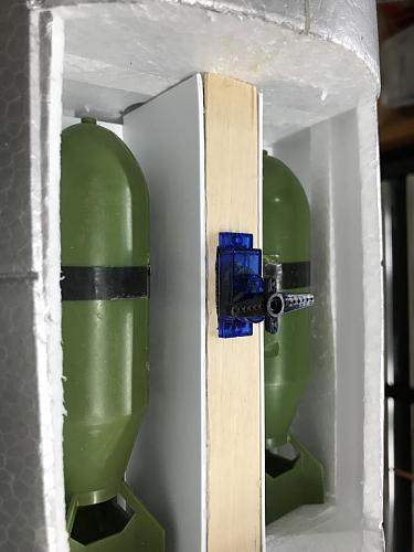

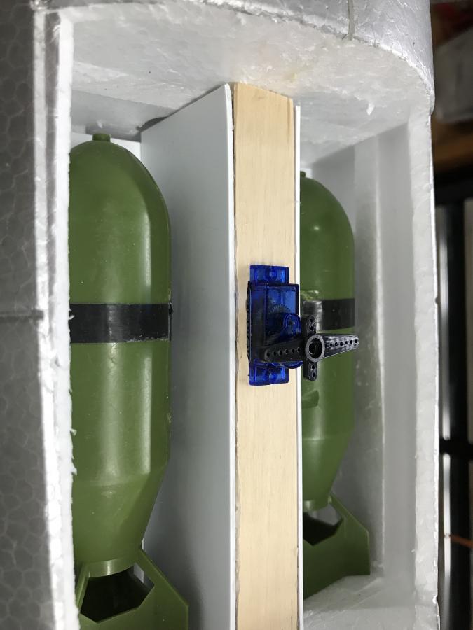

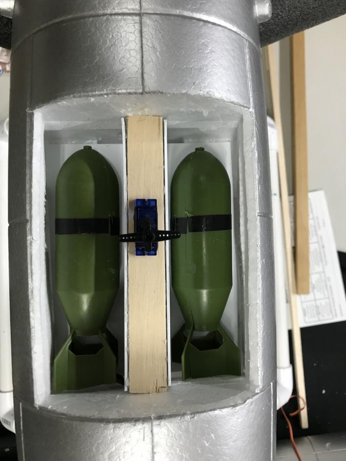

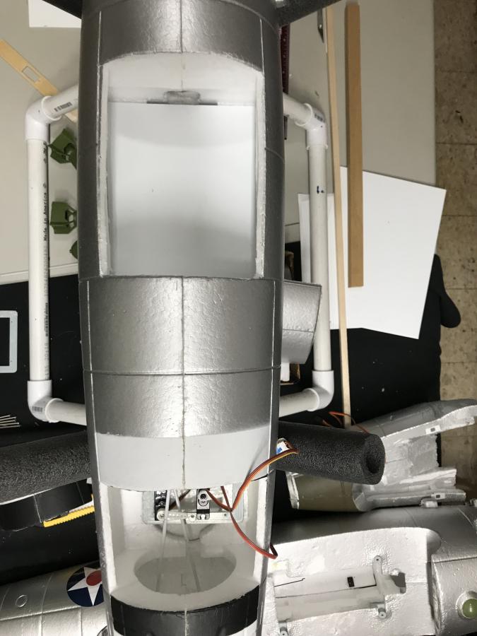

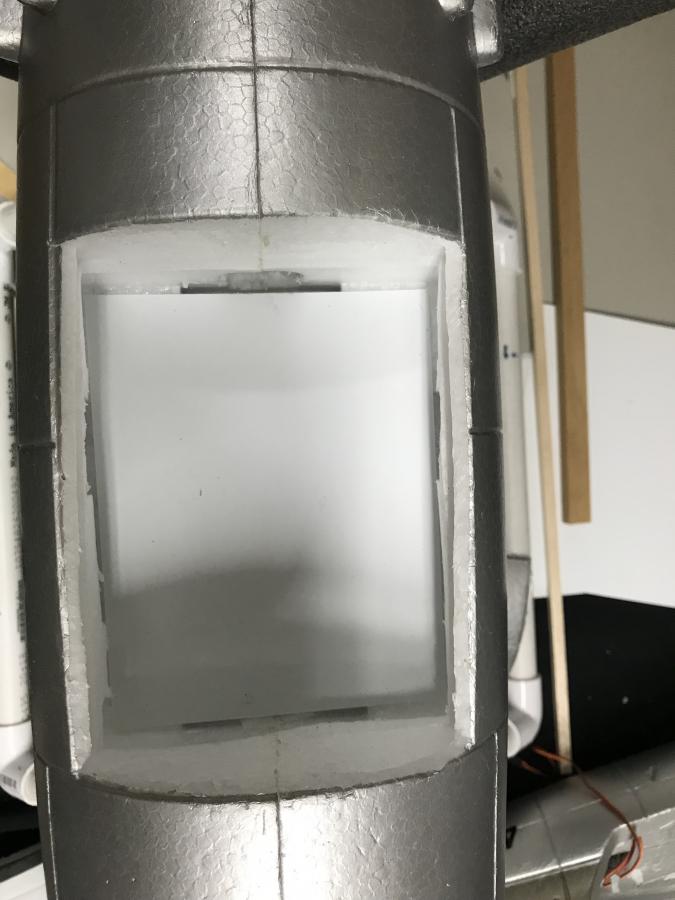

          My B-26 had an unfortunate mishap about a month ago. Since I needed to repair the fuselage anyway, I opted to modify the bomb bay to a newer version. Thanks to Quitcherbitchen's advice, I decided to move the rudder and elevator servos further aft. I ended up moving them about 10 inches (254mm) back towards the tail. The allowed me to gut the bomb bay area under the wings. I could have fit 4 or 5 "Adam Bombs" in a free fall (when the doors opened) or 2 "Adam Bombs" with a bomb drop device. I already have a B-17 that will drop 4 or 5 bombs so I went with the toggle device. I am not finished but I took some pics of the progress so far if anyone is interested. I would also like to give credit to Tom Hunt. His bomb bay design for the B-17 inspired me in regards to the toggle device. Thanks Tom and Adam!
          Bob

                      No one has modded the outer third of the wings as far as I know. Just the tail incidence, which is way off. I don't think the tip/accelerated stall is much of an issue as long as you don't use too much elevator throw. My biggest problem with flying this model is lack of power and wind issues causing it to get really tossed around in crosswinds. I plan on putting a Gyro in mine. Power wise stock is just sufficient. In wind it is barely sufficient. Flying around at full power in a 8 knot breeze is not comfortable.

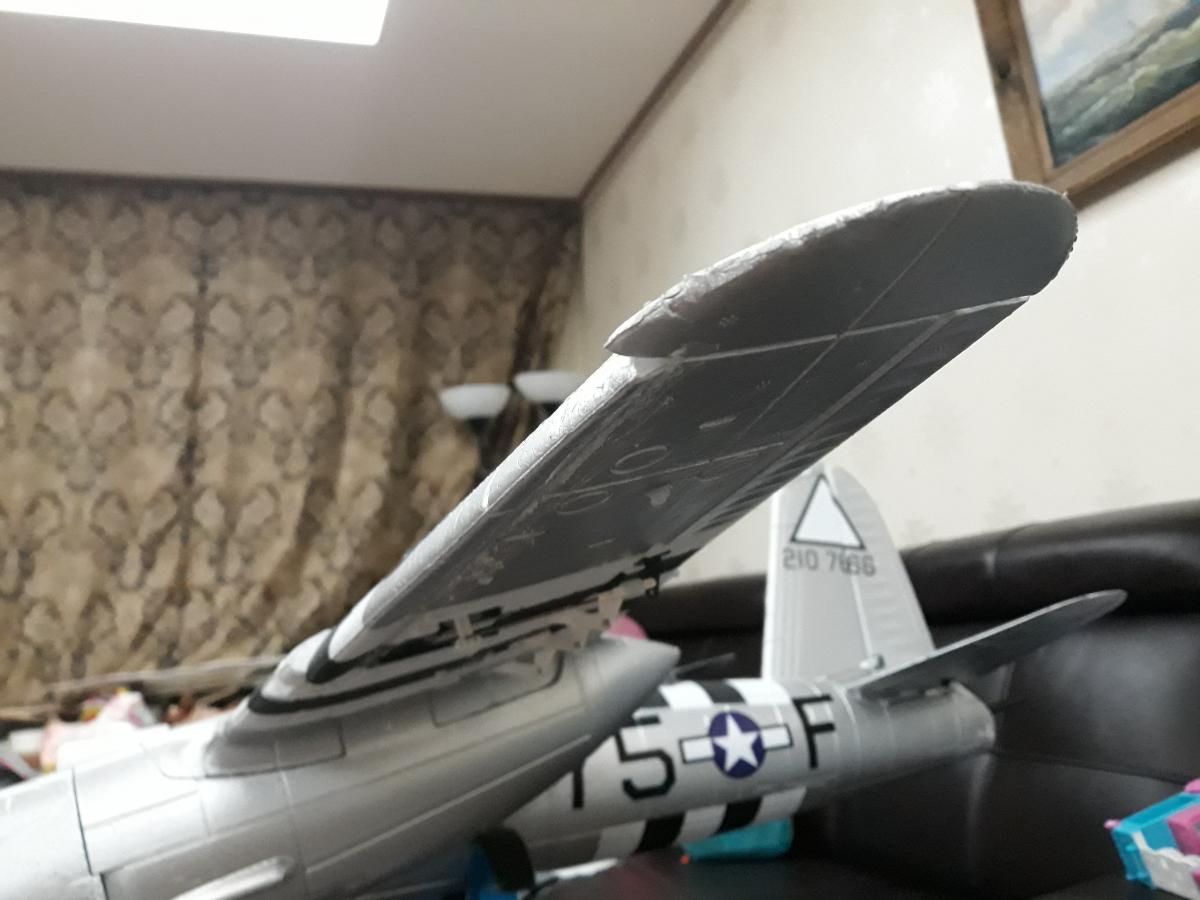

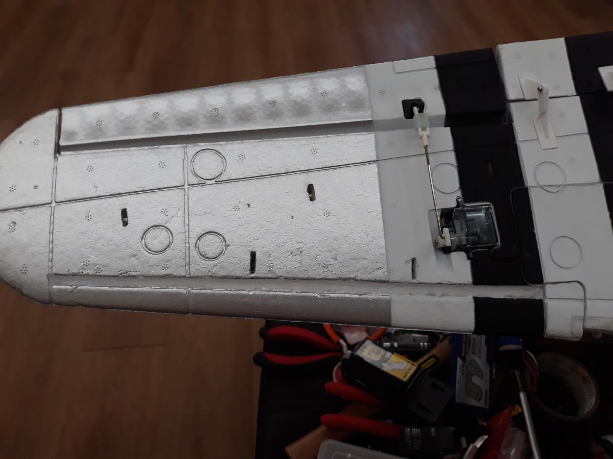

                                  Step 1 of mod
                                  • Phantom
                                    • Mar 2019
                                    • 504
                                    • M.D.
                                    #1597
                                    Removed about 6mm tapered down to 3mm at the wingtip, leaving about 2mm of foam depth on the top of the wing to allow bending.

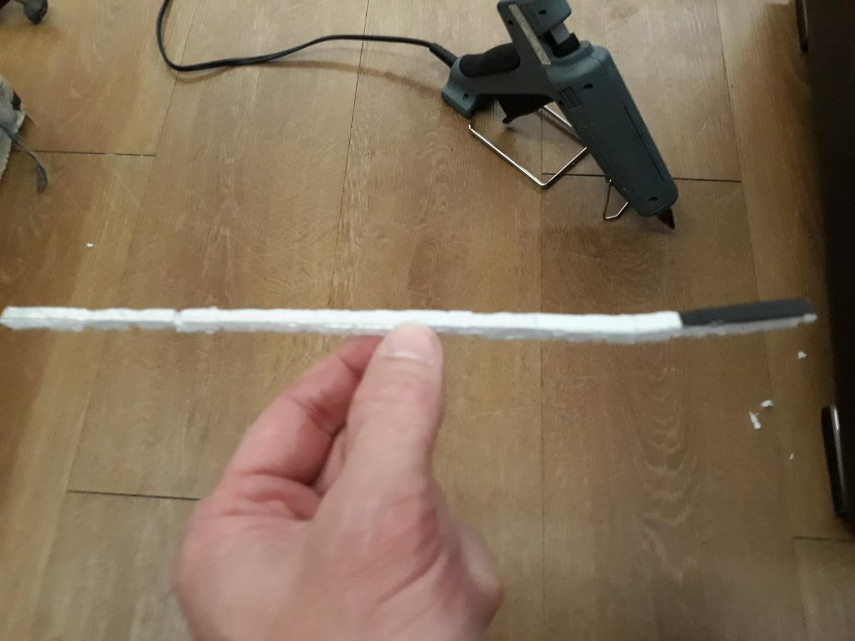

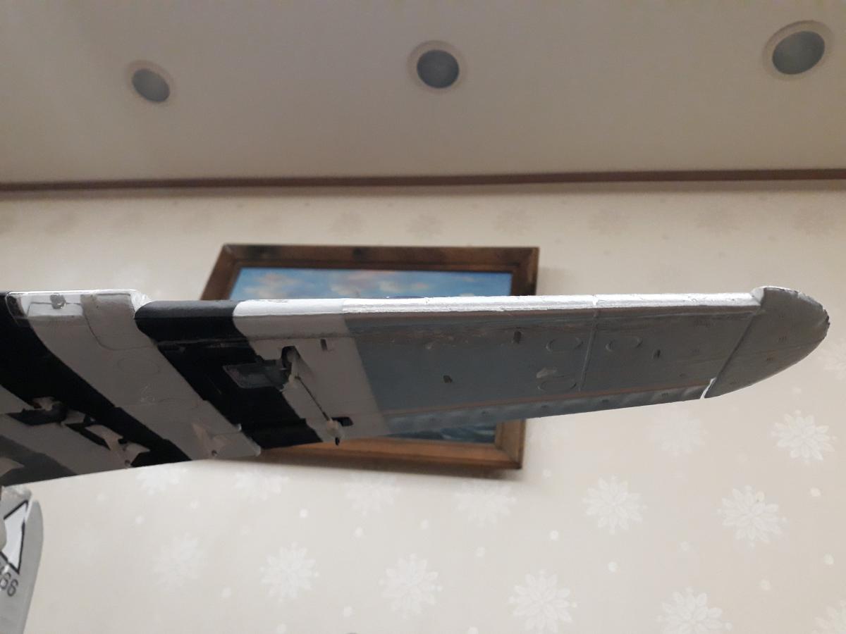

                                      Creates a "V" incision inti bottom edge of the wing's underside
                                      • Phantom
                                        • Mar 2019
                                        • 504
                                        • M.D.
                                        #1599
                                        The end result is increasing the camber on top of the outer 1/3 of the wing so that in landing attitudes the lift is evenly generated the full length of the wing. More importantly the outer 1/3 of the wing doesn't benefit from the induced lamenent flow of air, what we call "apparent wind" from the props. That portion of the wing's ability to create lift lies solely with your head wind and the aircrafts forward speed.
                                        • Phantom
                                          • Mar 2019
                                          • 504
                                          • M.D.
                                          #1600
