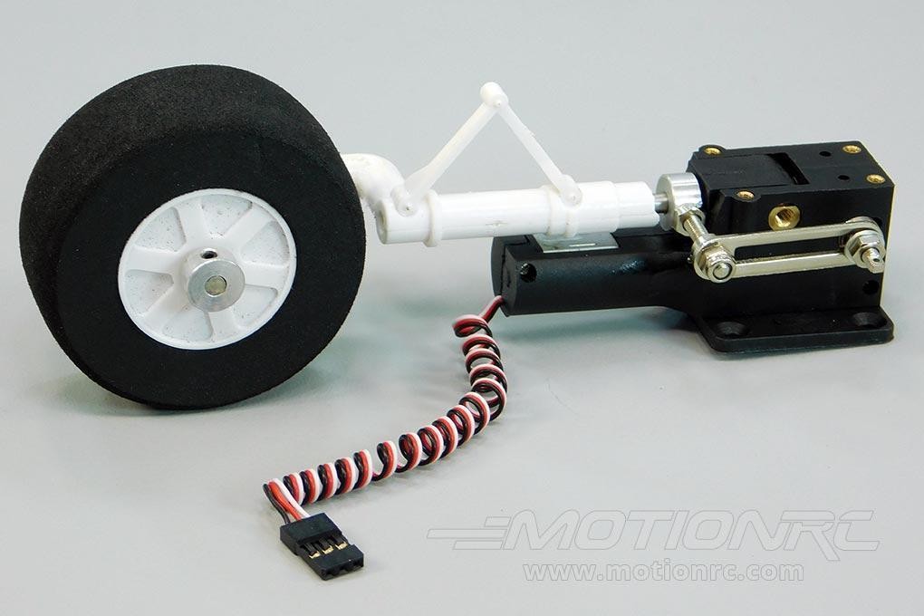

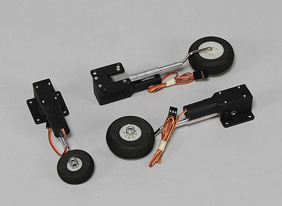

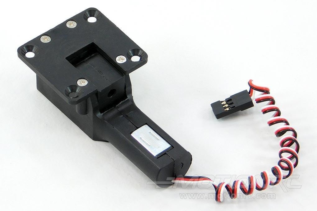

      You might want to take a look at the retracts from the Durafly line at HobbyKing. They seem to be the same design but not the same control board. I took one of the retracts from an old Vampire and transplanted the mounting plate from the stock B26 nose retract and then the whole strut assembly over and it all worked. The holes for the mounting plate is the same. Unfortunately, the Vampire part is not in stock and you have to buy all 3 but if you're looking for a complete replacement, this might not be a bad way to go. You can also look at other Durafly plane parts and see if you can buy just a single retract.
      See the similarities ............................................
      Vampire ...............
      Click image for larger version  Name:	35161.jpg Views:	2 Size:	41.1 KB ID:	120394
      B-26 ..................................
      Click image for larger version  Name:	dynam-1500mm-b-26-nose-retract-electronic-retract-motion-rc-767916146713_1024x1024.jpg?v=1513888731.jpg Views:	3 Size:	82.6 KB ID:	120398
      Click image for larger version  Name:	dynam-3-6mm-dia-90-degree-e-retract-v2-retract-motion-rc-26968366988_1024x1024.jpg?v=1501014841.jpg Views:	2 Size:	74.1 KB ID:	120399

          I will check these out as I am getting aggravated with the stock retracts. I just don't understand why the Dynam retracts are sensitive to cooler temps. I'm thinking that maybe the grease that is used on the gears in the retract is possibly too thick it might be stalling the gear train and maybe fouling the limit switch. I might open one of the retracts to see if that might be the problem. I just checked out these Durafly retracts and they are out of stock right now.
