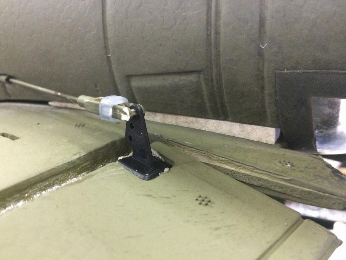

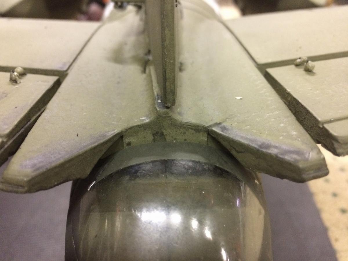

                        #951
                        Anyone have pictures of the shim mod ?
                          #952
                          I posted them in RCG, but here you go...
                          • weedsnager
                            • 202
                            • Winfield, In
                            #953
                            Is the entire shim 3mm or is it tapered?
                              #954
                              3mm at the back end...you can see the taper in the bottom picture.
