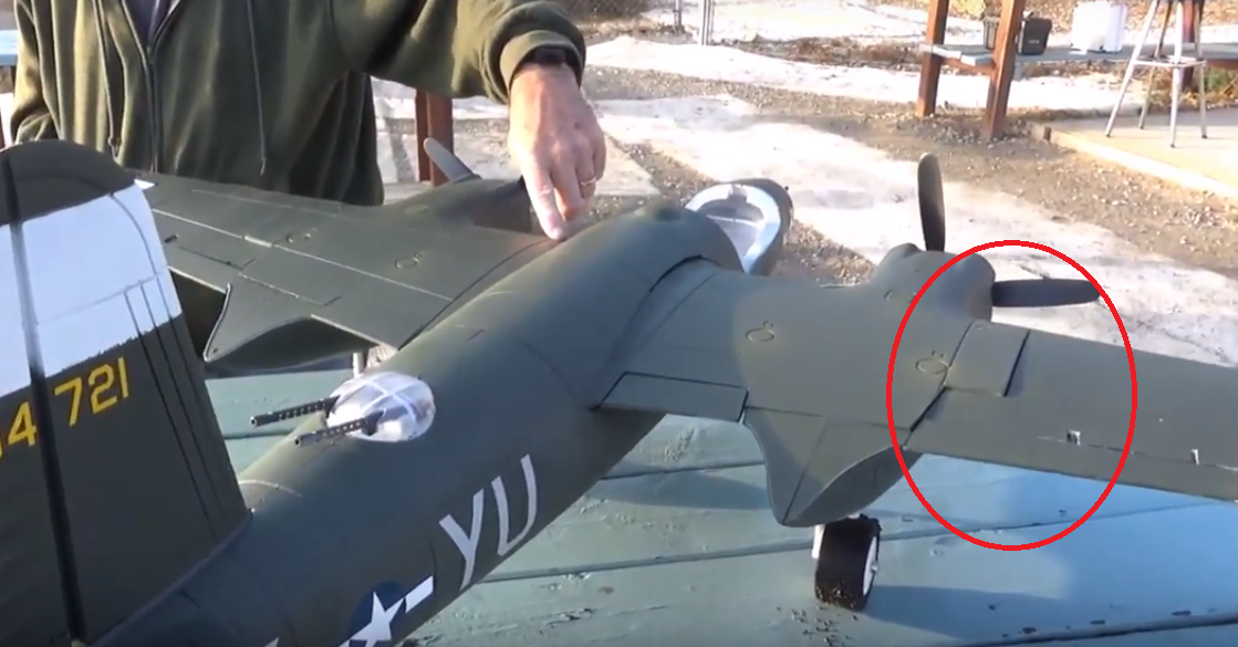

      I noticed that Klink's Tanks has the same issue with the wing as mine.. it's not flush with the wing where the halves screw together.
        Yeah I know... Don't know how to fix it... Maybe the wires not tuck away enough.

            Bearcat, Ted7ms, check the wing mounting pads (inside the fuselage) - many of us have found that they are not glued in very well, and can pull out. This will make it so the wing won't seat properly (and the whole wing can pull out).

                I opened a ticket with Motion RC and sent in the pictures I have posted here, they said this is the first time they seen this, but now this is the second case of it we have seen.
                I have checked everything and even measured the thickness of the wing and the inner wing thickness and checked for loose parts, everything is tight - and the wires are not outside of the tracks so there is no pinching going on there. If I can get somebody to measure the thickness of the inner wing where it bolts to the wing and then compare it with mine then it can help find the problem.
                But Klink's tank flew fine like this correct?
                  That's some nice flying Ted! Great video!
                  It's the outer wing we are talking about and where it bolts on to the main wing..
                    OK gotcha. I remember that from a previous post. Its a flush fit on the bottom but there's a gap at the top. Of course the wing mounts are on the bottom side. Do you think that its the wingtip that is causing the problem, or the wing center section? Just curious. I remember when I assembled mine, there was no place to put the wires and cramming them into the small pocket was the only way to do it. I commented back at the beginning that they could have left more room in the design...

                      If I can get somebody to measure their outer wing thickness and then the main wing thickness so I can do a comparison that would answer that $250 question. :-)
                            Kink's Tank flew fine. I will look at more this weekend.

                                This is the Gap. I really only have it on my Right Wing... I need to take it a part and look at the wires. I believe they are pushing it up. Anyone else know?
