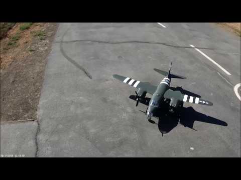

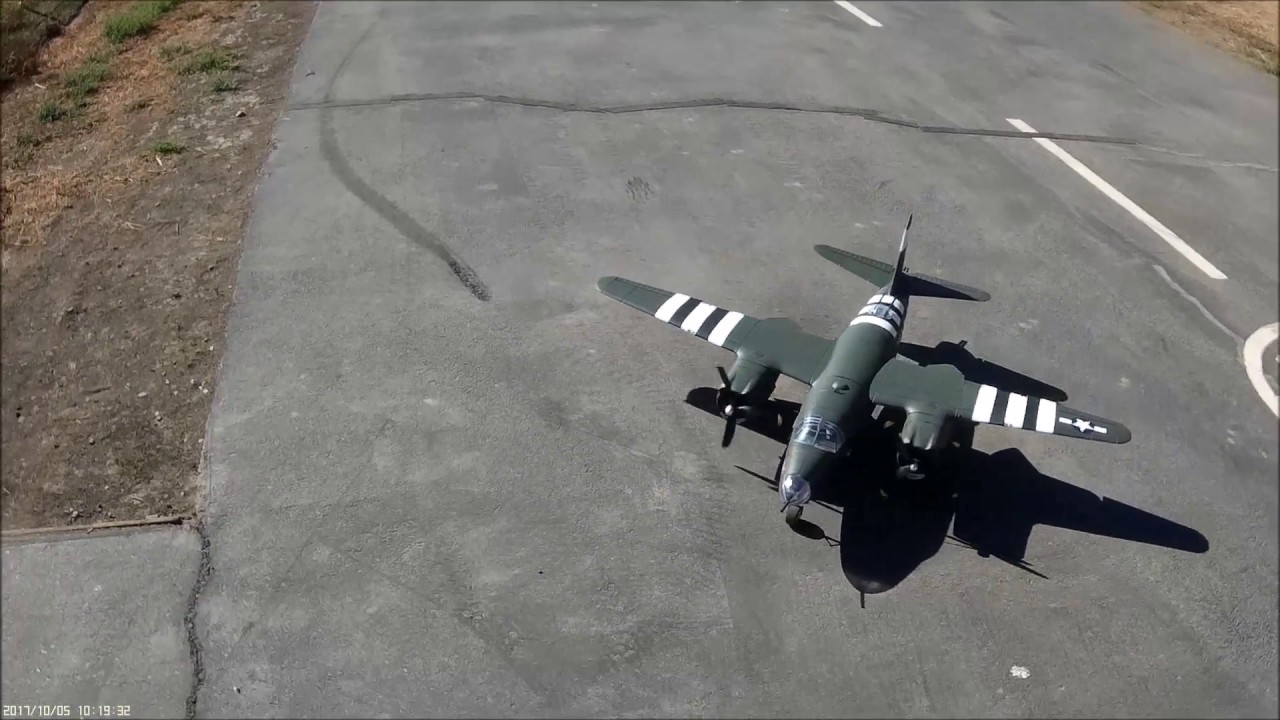

In the last week we've test flown three Dynam B-26s: Bird Dog Special, Klank's Tank, and Rosie O'Brady. All three have the CG set at the third panel line from the leading edge (70mm), and the throws set at 1/2 inch for elevator and 5/8 inch for ailerons, with expo on both. Klank's Tank and Rosie O'Brady have the 1/8 inch horizontal stab shim, while Bird Dog Special has a modified thrust line on both engines. This was done by adding one washer to each of the bottom engine mount attachment points.
We found that you have to include a very small amount of rudder to coordinate the turns or she drags her rear and looks like she is tail heavy when she's not. I'm going to mix in a few degrees of rudder deflection for my next flight.
Here's a clip of Bird Dog Special doing a little "IOE training" the other day:

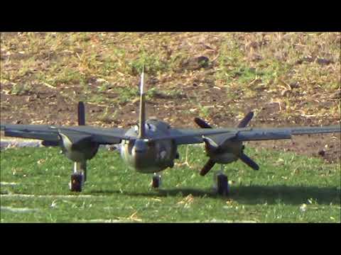

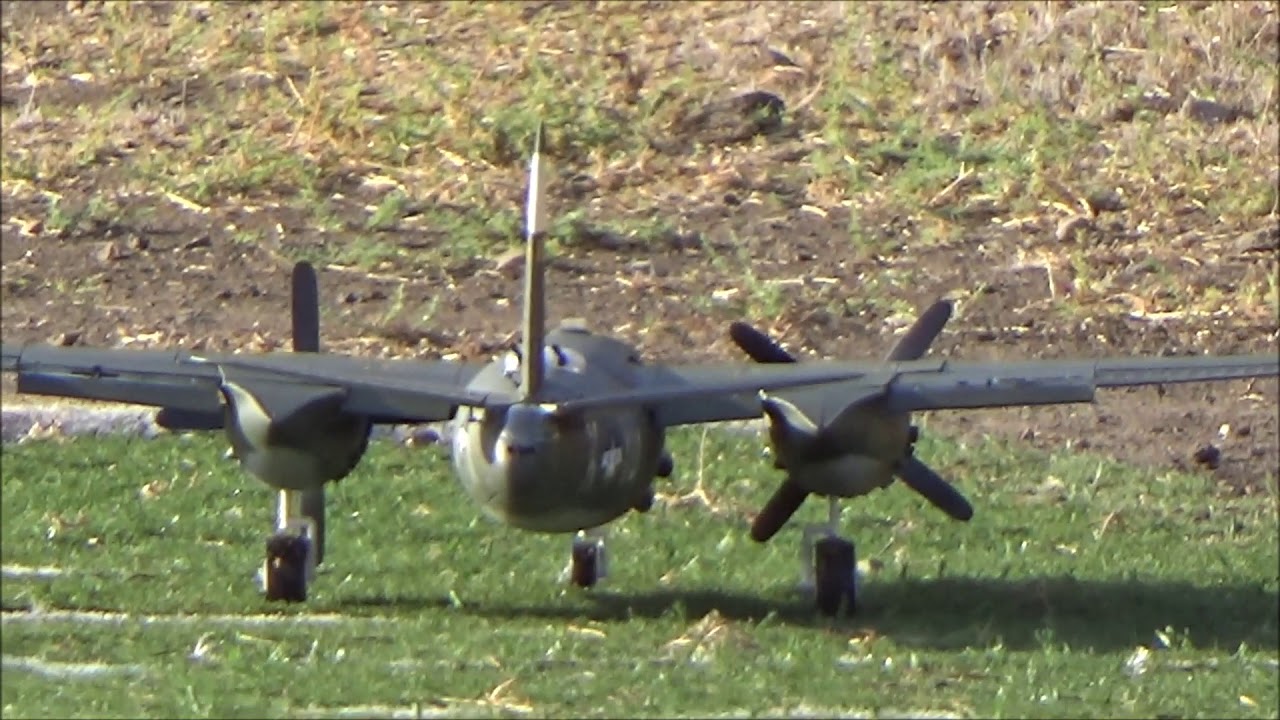

Our Squadron is growing, we are up to 4 B-26s.
This video captures some new additions to our club squadron.... the Dynam B-26 Marauder. These planes have been custom painted & have decals from Callie Grap...Comment

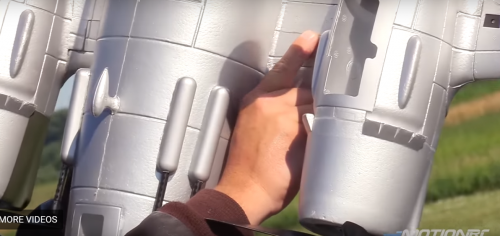

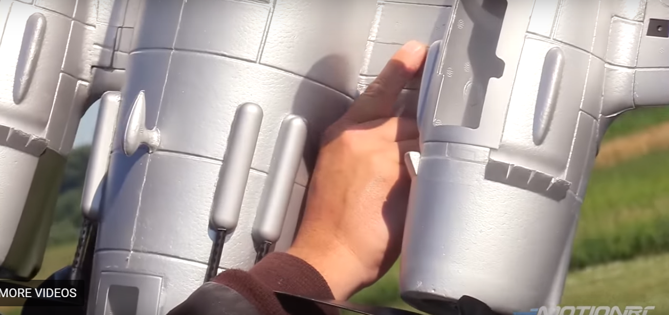

I don't know if we need to fly it to check if it's nose heavy or not... It seems to fly great with the CG out of the box, we didn't have to add weight (There was no weight in the tail). I don't remember the measurement of the CG, This where Motion RC said it should be.For example:

This where the CG's for us. We pretty much try to fly it scale, like a B-26 should be flown as. ;)
