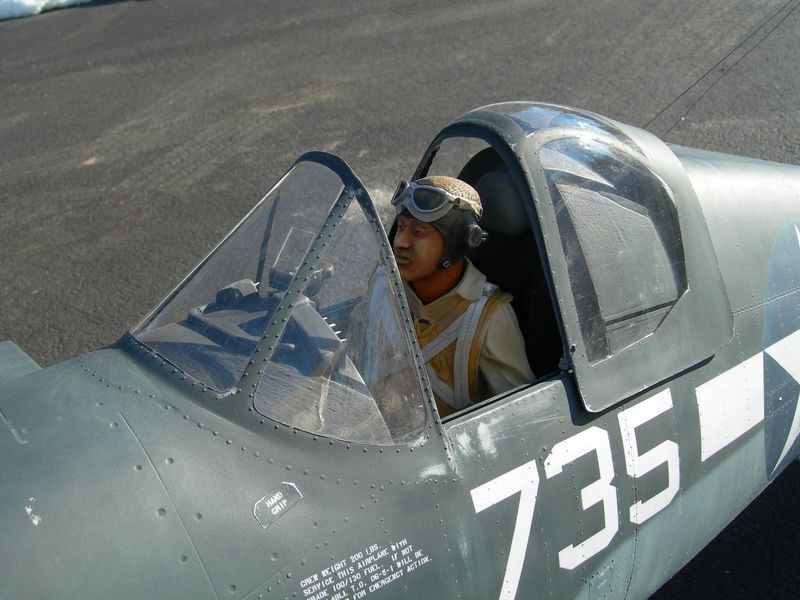

      As for the build, I am looking for how best to emulate the button-type of rivet work as you can see on the canopy below. I think it looks fantastic and I want to have those mixed with the depressed type as well (you can see both in the photo). Any thoughts?

        The old riveting tool is all I'm aware of which involves a hypodermic syringe connected to a plastic bottle. In the old days you would fill the bottle with RC-56 canopy glue thinned with water and squeeze tiny droplets through the syringe onto the surface to form those rivet heads. When it dried, it was ready for paint. It takes some practice to get the hang of it. Very time consuming but well worth it. You might check with Frank Tiano to see if he still sells them. Brad

          Cool thanks Brad I will check into that. I think I came across something like that recently...Maybe it's an improved method these days? But then again, there are just certain things you must go walk the many grueling miles for, and rivets is one of them.

            My thought on the indented rivets would be to use a small nail with the proper sized head, pushed gently into the plane. For your scale, that may be an option.

              Take a look at the Starwood scale models rivet kit. It is more or less the same syringe/glue method, but includes a variety of tips for different rivet sizes and a very nice rivet solution. That is what I used for doing the rivet detail on my Apache.

                  I checked that kit out, it looks like exactly what I need so thanks again! I will grab a kit and start tinkering. The key is to research how many were "button" or raised and how many where flat or recessed. I don't want to do the entire Corsair in button-type rivets as I know the full scale doesn't have that, but some strategically-placed button rivets could really work great along with the flat/recessed type.

                          I am currently kit bashing an ESM J2M3 Raiden, which will be electric also. I am using the "Finish Set". These detail sets are great products, easy to use, quick to apply with a really effective result. Mirce is also very helpful. I have attached a photo of the Raiden and Mirces Hellcat.

                              My hat is off to you Sir. Great workmanship on the rivet detail. Brad

                                Excellent work! Looks fantastic! Another great resource to check out so thank you!
