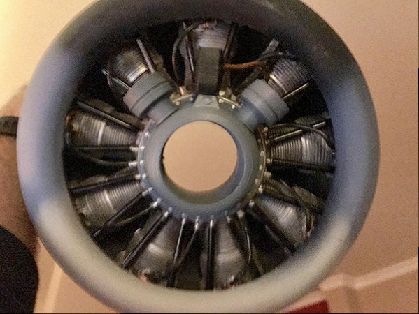

It would be good if you could have it open between most of the radial cylinders. When I do that, I'll paint the firewall are black so it's not seen. Try to ensure your ESC has good air flow too. And as Rifleman said, make sure you've got a place at the rear for plenty of air exit as well.

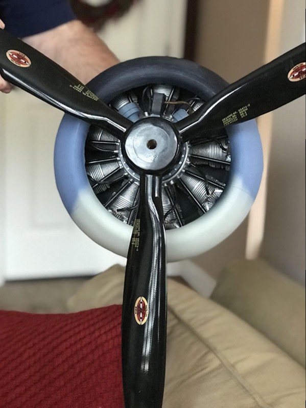

One other tip for your maiden, if I may....put that nice Biela prop on a shelf somewhere and install a two blade wood prop. I learned this one the hard way. I had a nice 3 blade Biela on my BV-141B when I maidened it. As luck would have it, I had a nose over on landing and cracked a blade. Expensive $$:Scared:.

Thanks! Yeah that's really not a bad idea i.e. the prop for the maiden. I'll snag a 2 blade to have as an option if I choose to forgo the Biela 3 blade. I believe the battery configuration will be 12S so two 6S 5000's in series. With the radial and batteries the nose is going to be nice and heavy. I am hoping I won't need to add any tail weight. I hear these giant Corsairs like a lot of weight in the cowl.

I swing that prop albeit a 17x10x3 on my H9 20cc Corsair on 10S with a P160. I will tell you the sound is way too cool and the prop pulls like a banshee! I personally love it and now that I'm working on the TF Giant Corsair I'll be using the Rimfire and this prop...unless you report the Vario is better. More to come and I look forward as I did on my Legends P-38 to watch your progress. Bob
Yeah I don't know why the hub has to be that big. I'm sure it can be explained in the engineering of it. I decided to request the 3D crank case be redone larger. There's a gap between the base of the molded crank case on the dummy radial and the base of the 3D crank case, about 1/4" which will cause the prop to stick out too far from the LE of the cowl when everything is in place. In order for the 3D crank case to fit perfectly over the molded piece it needs to be 1/4" wider diameter. Once that's done then the radial is done done.
