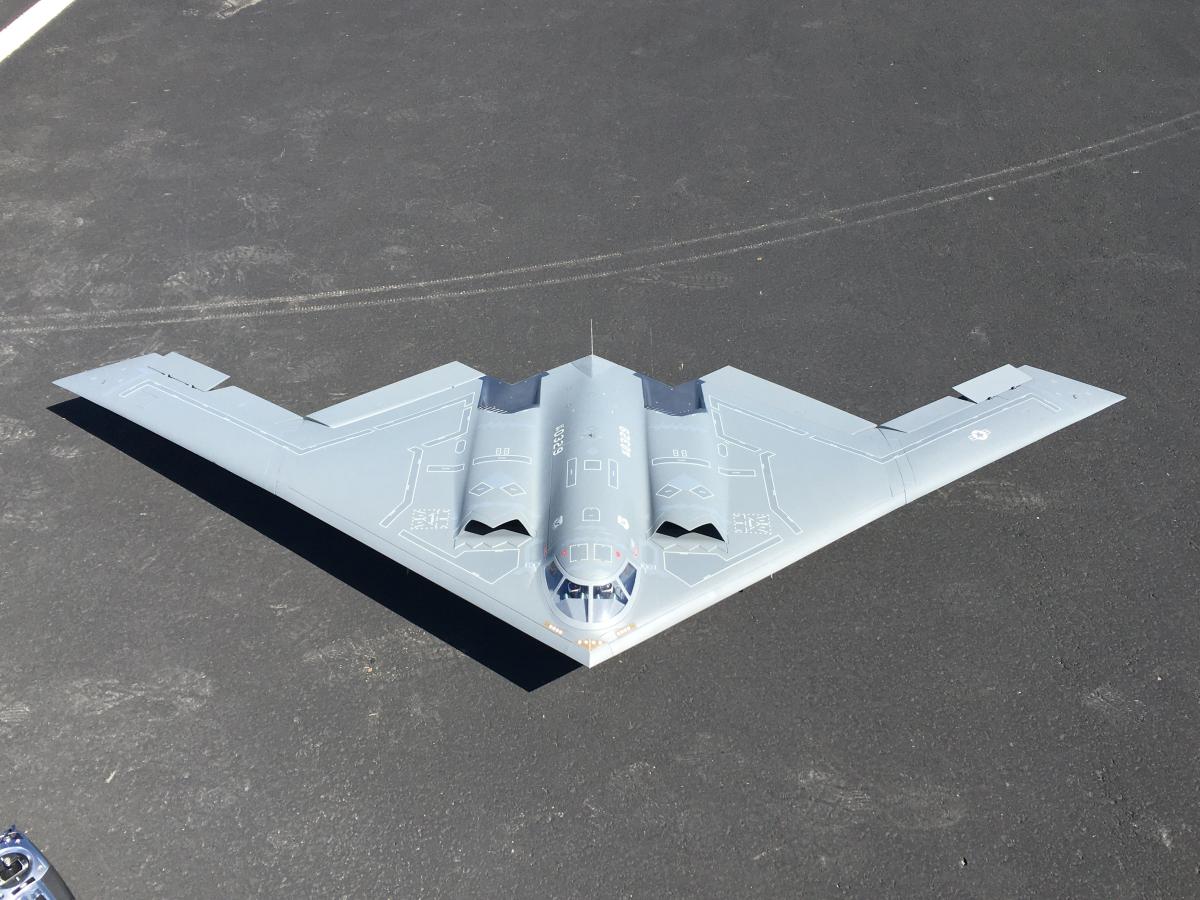

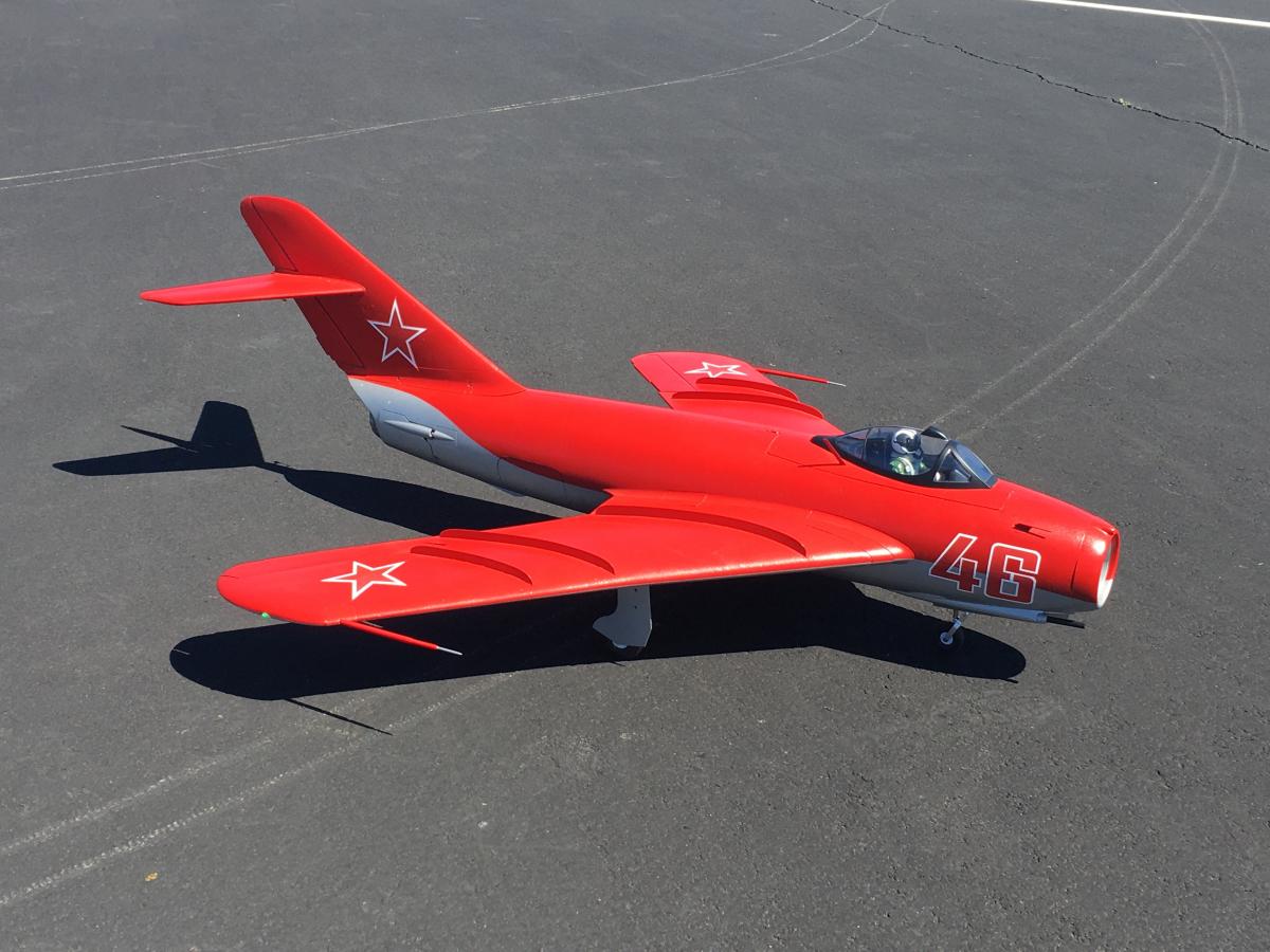

                      My MiG is still going strong, flew it and my B-2 Tuesday.
ID:	398883 Click image for larger version

                        Like that mig. Ye early in the piece. Was flying off dirt with little stones and the odd pot hole.. that's my excuse anyway.. again that mig is really nice

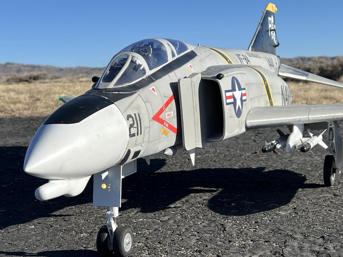

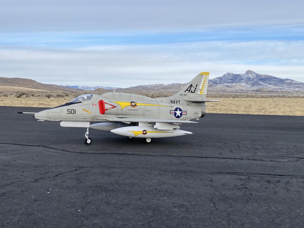

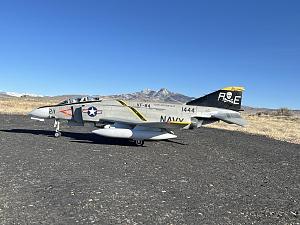

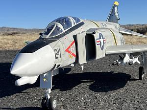

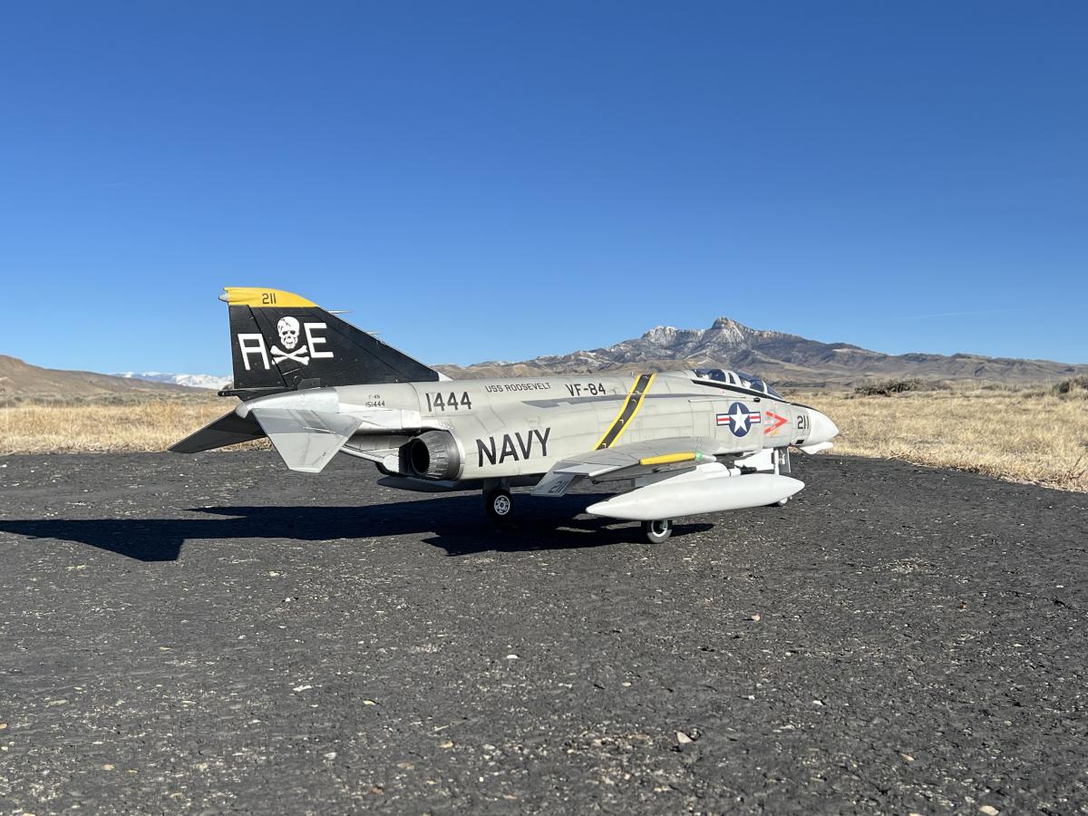

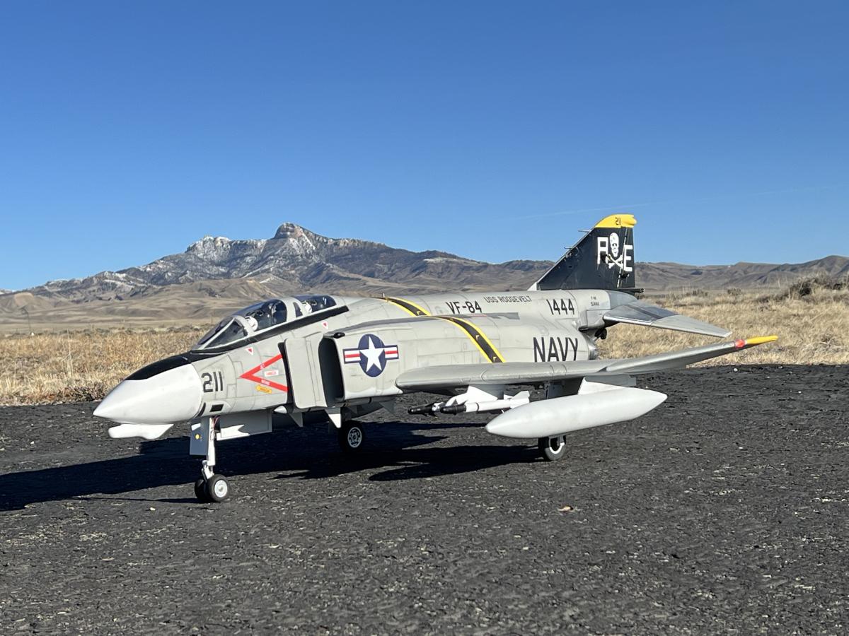

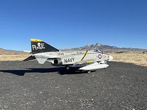

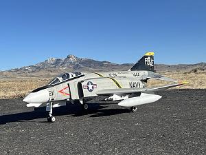

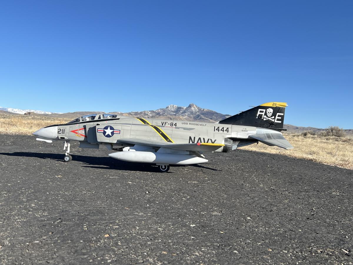

                                  I took two airplanes out to the field this morning. I've had both for a few years, one is an F-4N Phantom II in VF-84 paint scheme, and my A-4E, in the colors of a Viet Nam era VA-152 squadron. Hadn't flown either of these for a few months. The first flight with the A-4 with both the drop tanks and the missiles on the wings went fine, although I was a bit rusty, as can be expected.
                                  I took off the big drop tanks and kept the missiles on for the second flight. Not long after takeoff when I was climbing out and turning for a left-hand pattern, I started having severe directional control problems. I couldn't really see what the issue was, but it was barely controllable. I tried to see what the issue was like asymmetrical flaps, a gear stuck down or something, but that wasn't it. While trying to bring it back for an emergency landing, I lost control of it and it crashed into the weeds short of the runway. When I picked up the pieces one of the missiles couldn't be found, so my guess is that one of them departed the airplane early on, causing the directional control problems.
                                  It is definitely repairable, and all the internal things like the 6S battery, electronics, receiver, motor, ESC, etc., weren't damaged. I could replace the fuse, and I think could put it back together, but I think I might just harvest the pieces from it and call it good. I've had a lot of fun with it, but I think I'll move on from the A-4. Possibly might look into the new F-14A that just came out.
                                  My other plane, the F-4N Jolly Rogers scheme, by comparison is a joy to fly. I have the afterburners and wheel brakes, and it drives like a fast, solid, sled. One of my favorite EDFs to fly. I took a few pics of them, plus an older one of the A-4 since it crashed before I could take a photo of it at the field.
                                  A friend of mine once said about RC airplanes: "Sooner or later, they all come back in a body bag!" I look forward to replacing this A-4 with another fun airplane.
                                  Cheers
                                  Davegee
                                  Click image for larger version  Name:	IMG_1833.jpg Views:	0 Size:	161.5 KB ID:	398942 Click image for larger version  Name:	IMG_1832.jpg Views:	0 Size:	151.8 KB ID:	398943 Click image for larger version  Name:	IMG_1835.jpg Views:	0 Size:	161.7 KB ID:	398944 Click image for larger version  Name:	IMG_1834.jpg Views:	0 Size:	169.0 KB ID:	398945 Click image for larger version  Name:	IMG_0827.jpg Views:	0 Size:	116.5 KB ID:	398946

                                      davegee I presume your Phabulous Phantom is of FreeWing origin.
                                      If that is correct, whose 'wheel brakes' did you install?
                                      I fly off pavement and had thought to upgrade the EDF and add a reverse thrust ESC, but she flies good as is.
                                      However, adding wheel brakes could solve the inadvertent run-off problem I suffer with continued frequency.
                                      Brakes might be less expensive than the aforementioned upgrades.
                                      Best, LB

                                        Hi Steve: I bought the JP Hobby electric brakes for the F-4. They really work great and I used them today on the two flights I had with the F-4. Yes, it is a Freewing F-4, converted to an N model per some history books. It is based on a scheme of an actual airplane used about 1975 or so.
                                        I haven't put the wheel brakes on any other plane so far, but have certainly considered it for some planes that seem to want to roll forever on my less than ideal runway surface that I operate out of.
                                        If you need any other details on the JP brakes, I am more than happy to assist.
