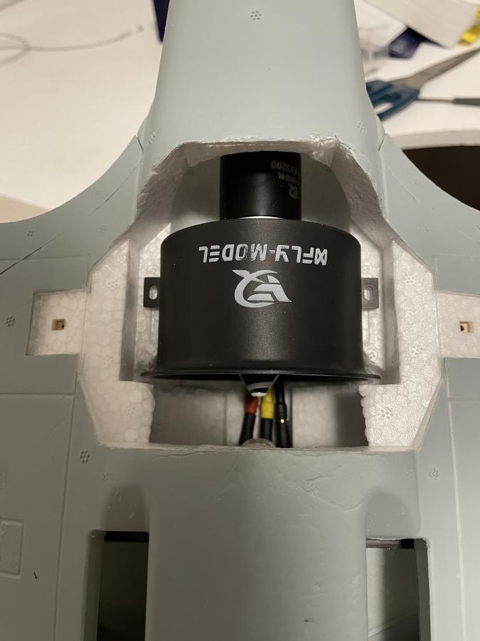

    I’m about to pull the trigger on this plane. Has anyone swapped in a 4s fan? I’ve got an Xfly 4s 64mm and a 40 amp esc sitting on the shelf that I could put in it. I’m sure the weight would be increased and flight times decreased, but I bet it would be a rocket.
      • 8835
      #422
      I found this little jet to already be a rocket but I guess some like it even hotter. No, I haven't done the swap, but with the X-Fly 4s fan, you'll double your thrust but it'll draw 50A to do it. It's also 5mm longer and 1.5mm smaller diameter. It may or may not fit without some sealing and/or foam removal.
      A 2200mah, 3s battery fit just about right. A 4s battery may limit you to less mah.

                Got the Xfly 4s fan fitted. It just took some carving around the inlet ring. I will hopefully maiden it today, fingers crossed.

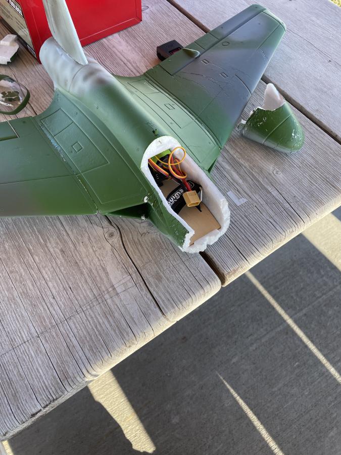

                              Maidened the xfly P.15 today. First flight was fairly smooth once it got trimmed. It’s an absolute rocket with the new fan, I did one high speed pass where I went full throttle for maybe 2 seconds and it hit 105 mph, straight and level. Sadly on the second launch it got a little Wild, breaking the nose off. I was flying with a 1800 mah 4s pack with a timer set for 3:00, it came down with 50% left. Most of the flight was done with 1/4 to 1/2 throttle.
                              I should add, all up weight was 560 grams, I did a static thrust test and it produced 895 grams.

                                  yeah, the 3200kv. I already got the nose back together, a little foam tac goes a long way. I had someone else throw it, but they threw it almost straight up so it kind of turned into an uncontrolled rocket lol
