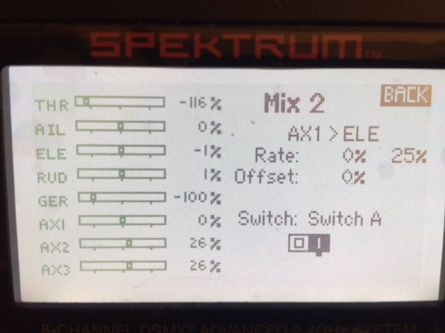

                        You can pick any unused switch to do the reflex. Just make sure it's not assigned to something else. If it's a 3-pos switch, just skip over the middle position.
                        HINT: This is for my Lippy. I use the gear switch, but you could use (eg.) AUX1 or AUX2 and choose any unused switch. Just assign the switch to AUX1 or 2.

                          First attempt was a failure. Actually it cut even my gyro off until I unplugged it and plugged it in again. On switch A where the gyro used to be in the gear mix the switch still moves the gear meter or gain but nothing happens. It works find using the R Knob though.
                          • That little tailpipe piece is just straight, not angled up. When you get this plane, you'll notice that the exhaust tube is not uniform in thickness, top to bottom. That difference in thickness causes the exhaust to go down, which is in effect, producing down elevator. That plastic is just enough to deflect some of the exhaust back up or at least, reduce the amount that goes down.

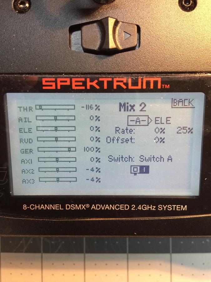

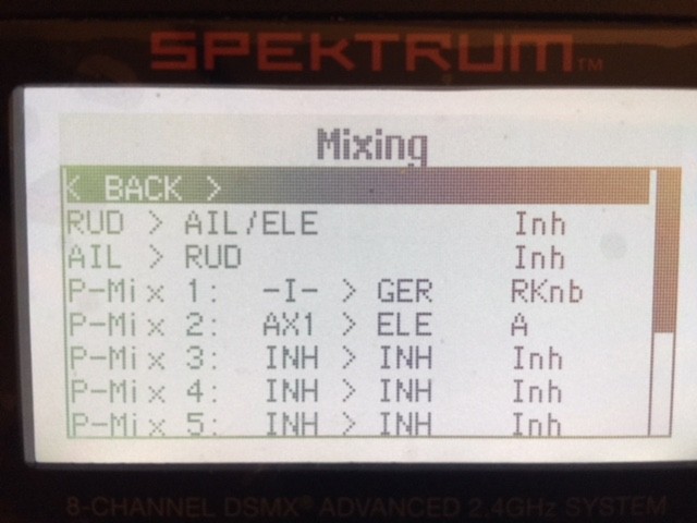

                              • Having trouble getting the reflex to work on myDX. I think I set mine up like the picture you took above. The difference is my gyro is in mix 1 so I am trying to program it in mix 2.
                                I go to Mix 2,
                                Aux 1 elevator, rate 0%-----25% offset 0%
                                then I trie to set it up on switch A
                                When I flip the switch the box in the Ger moves from -100% to 100% Nothing moves in Aux 1
                                When I plug the receiver in the elevator does not put in the reflex. I know I am doin something wrong but there must be a step here I am missing. Again when I flip switch A the indicator in the Ger bar moves not the one in Aux1. It may have something to do with the 0% for the bar on AUX 1. Idono thanks
                                • You have to tell the TX what "A" is controlling (or not controlling). In your case, you want switch "A" to affect AUX1 but you haven't told it that yet. Normally, AUX1 is for flaps and that's controlled by that long switch on the front of the TX. On my DX8, that's switch "D" by default. If you are going to use AUX1, you have to tell it what switch you want to control it. You are using switch "A" but that's normally for gear, which you are using the knob to control (according to the picture you put up). You are getting all your switches and knobs and ports all jumbled up. The TX can't figure out what you're trying to tell it to do. You need to go into port assignment and switch assignment to straighten all that out. Aren't you using the knob to control the gear channel to control the master gain on your gyro? You have to tell the TX NOT to use switch "A" for gear in that case because right now, it seems you are commanding the gear channel with BOTH switch "A" and the knob. That's confusing the heck out of the TX if you try to use switch "A" for something else.
                                  It might be helpful to read the manual for the transmitter to understand what all that means. In essence, you're jumping several steps ahead without learning the steps you jumped over. It's somewhat hard to teach you all the steps over the internet. It's something that must be learned by reading or by trial and error or by another person in your presence who knows what to do when told to "do a mix for reflex and put it on a switch". Then that person can actually show you.
                                  For now, it might be better to just count the ELE trim clicks when you get ready to launch the plane. Then unclick it once the plane is flying. I hope I'm not offending you by insinuating that you are "old" (as you already stated). That's not my intention. I'm 70 years young myself.
                                  • Crap. I edited my last post but it didn't edit. What you said is exactly what I did and it works. I tried to edit the post to let you know. When I throw switch a the box in the elevator bar moves and the elevator on the plane is raised about 3*. Everything else works fine. I tried to let you know what I did but again it just didn't go through. Sorry about that
                                    I had to figure what the heck was goin on. Then I realized what the problem was. At least now I can dial in the reflex in the P15 if I get it. I think Ill leave it on the 190 and not use it unless I have to. I should probably take a pict of the proper setup and post it in case someone is reading this thread. It may help them set the DX properly, or at least the way I did it.

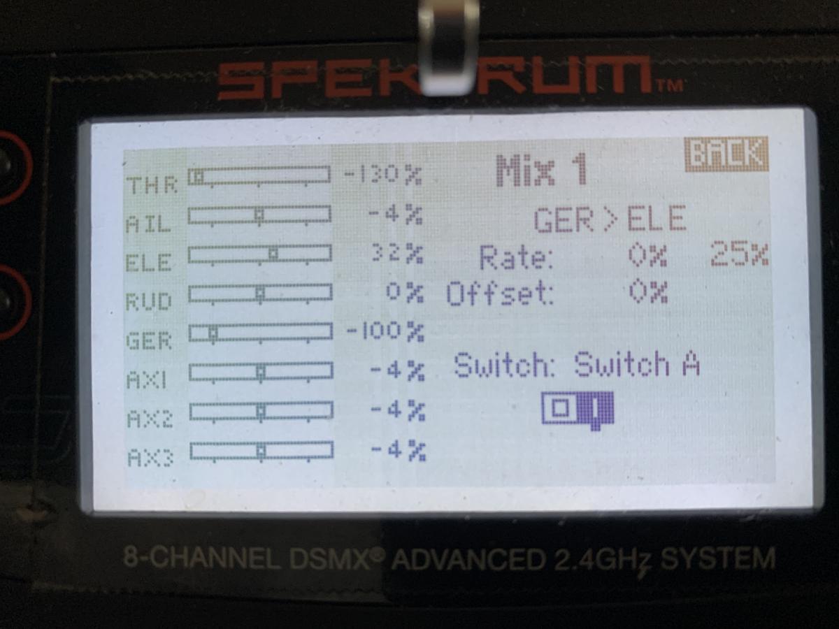

                                    • This is the way I have it setup on my DX8 for reflex. Mix 1 for the Gyro on the Ger R knob..Idono maybe this will help someone.
