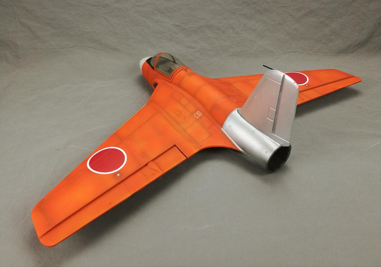

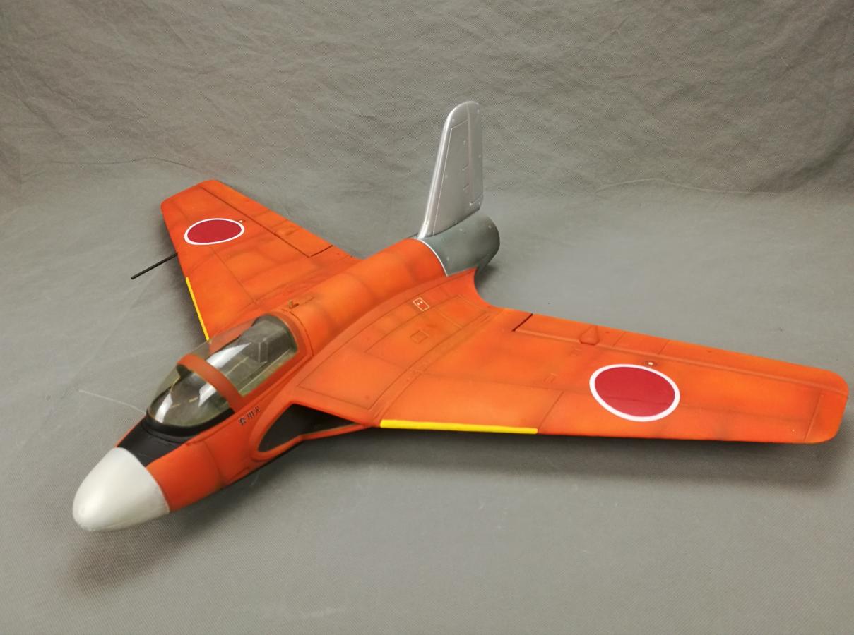

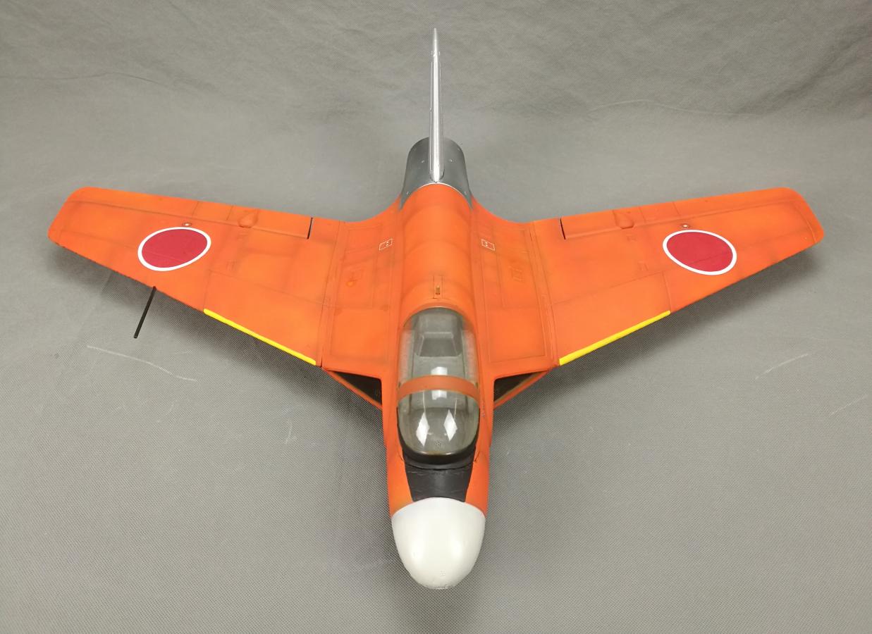

                    Here it is finally ready to go. Will try on the short grass of our field. I hope the makers of this plane will come up with a larger one with either an 80 0r 90 mm fan. If this one was a good seller, then a larger one will no doubt sell well. I feel there is a large interest in the German designs which were never produced like this one.

                            Orange upper and black belly helps.

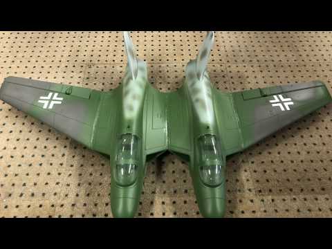

                                  Had some fun down at Nall in the Fall with my 2 Lippy's! I wanted to make a twin Lippisch and when I mentioned it to George he loved the idea and we got to work one night. Love having fun like this with RC!
                                    #257
                                    Wait until I get the "Triple Lip" done ;)
                                      #258
                                      Add differential thrust! :)
                                        #259
                                        Twin Lippisch "Lips"
                                          #260
                                          Thats such a cool setup
