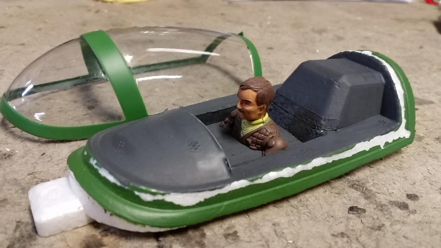

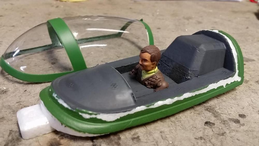

      • Had to repaint the cockpit to a color closer to scale... Used Model Master RLM66 Schwarzgrau. Also did a recess in the foam with the dremel for a "cockpit" and added a German Stuka gunner from The Ultimate Soldier toys. 1/18th scale. Touched up the frame with RLM 83 Dark Green from Hataka Paints. I am installing the A3-L gyro with a Spektrum 610 receiver. Should fly great!!!!
        • Nice job! I like the grin on that pilot. Seems appropriate!
          • Thank you Marc!! I thought it looked the "part" for a war crazed Nazi pocket rocket jock!!! :)

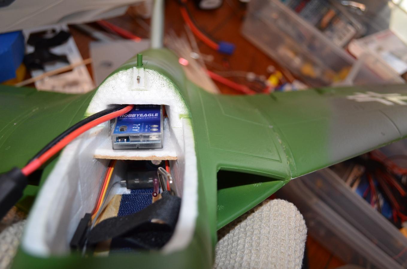

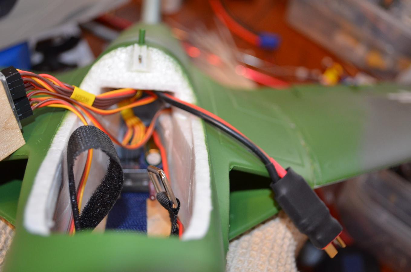

                        • Finished the wiring of the A3-L gyro and the Spektrum 610 receiver. I had to plug the gyro capacitor into channel 5 on the receiver due to gyro clearances. Put the 610 receiver as far back in the fuselage as possible. Attached with Velcro to the fuse bottom. Ran the wiring up and behind a 1/16th inch plywood gyro mount, laminated to 3mm Depron foam. You have to mount the gyro to foam, not wood, or the 3M double-sided tape will fail to hold the gyro. (BAD). I made sure to have a bind plug extension as well as a rudder extension routed to the front of the fuselage since I can't reach the receiver.... For binding and for a possible nose wheel in the future.... Very fiddly, but it works great so far!! I have done the same setup in the F-105 and F-8, using a 1600 MAH Admiral battery. Hope the maiden goes well....

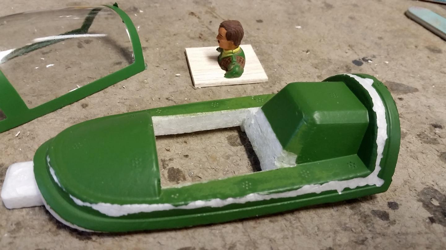

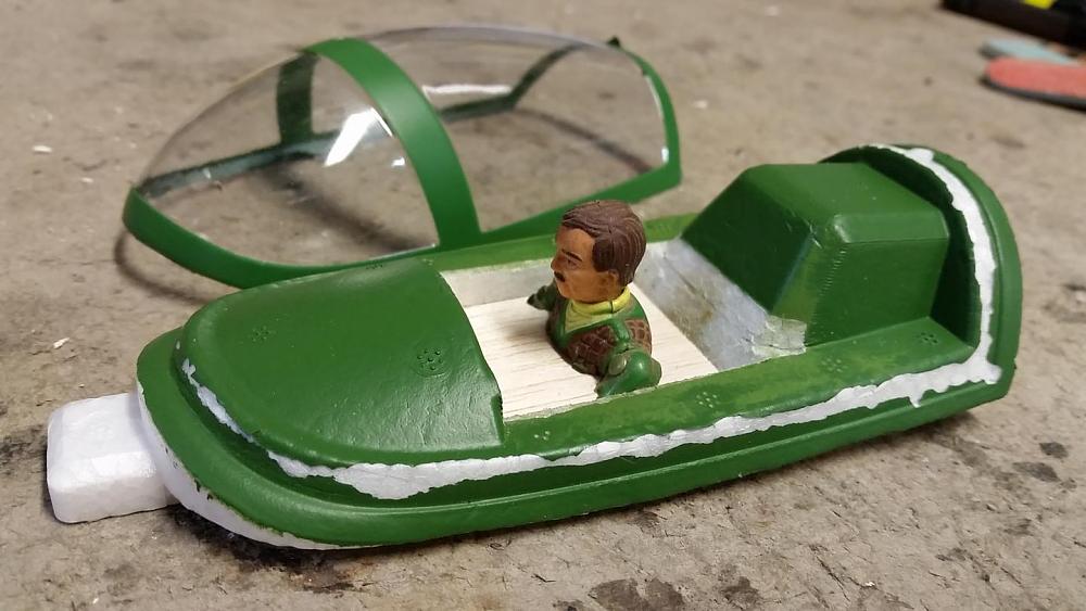

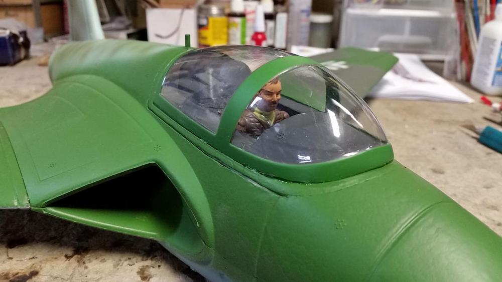

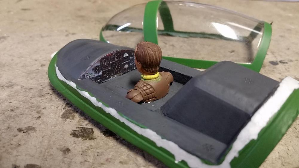

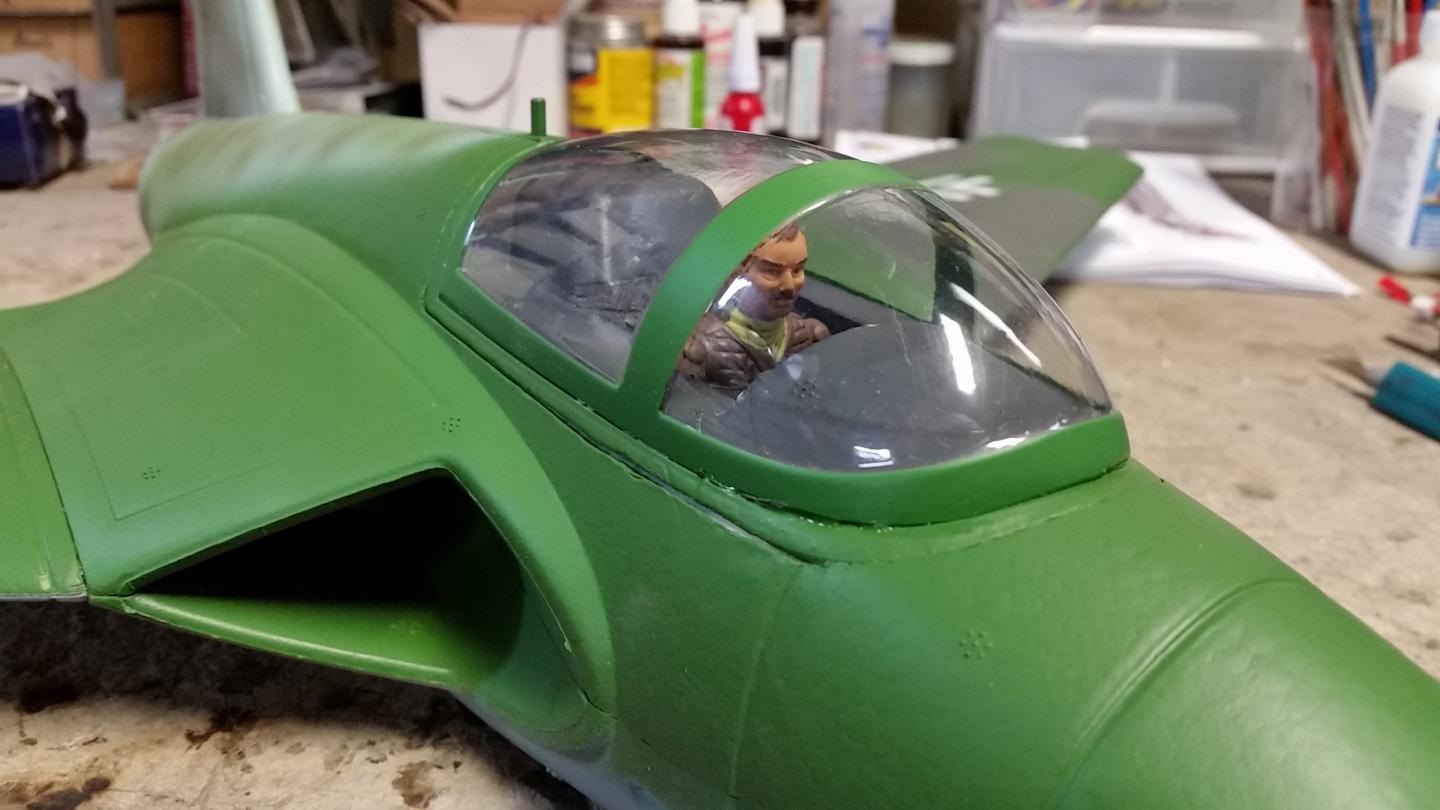

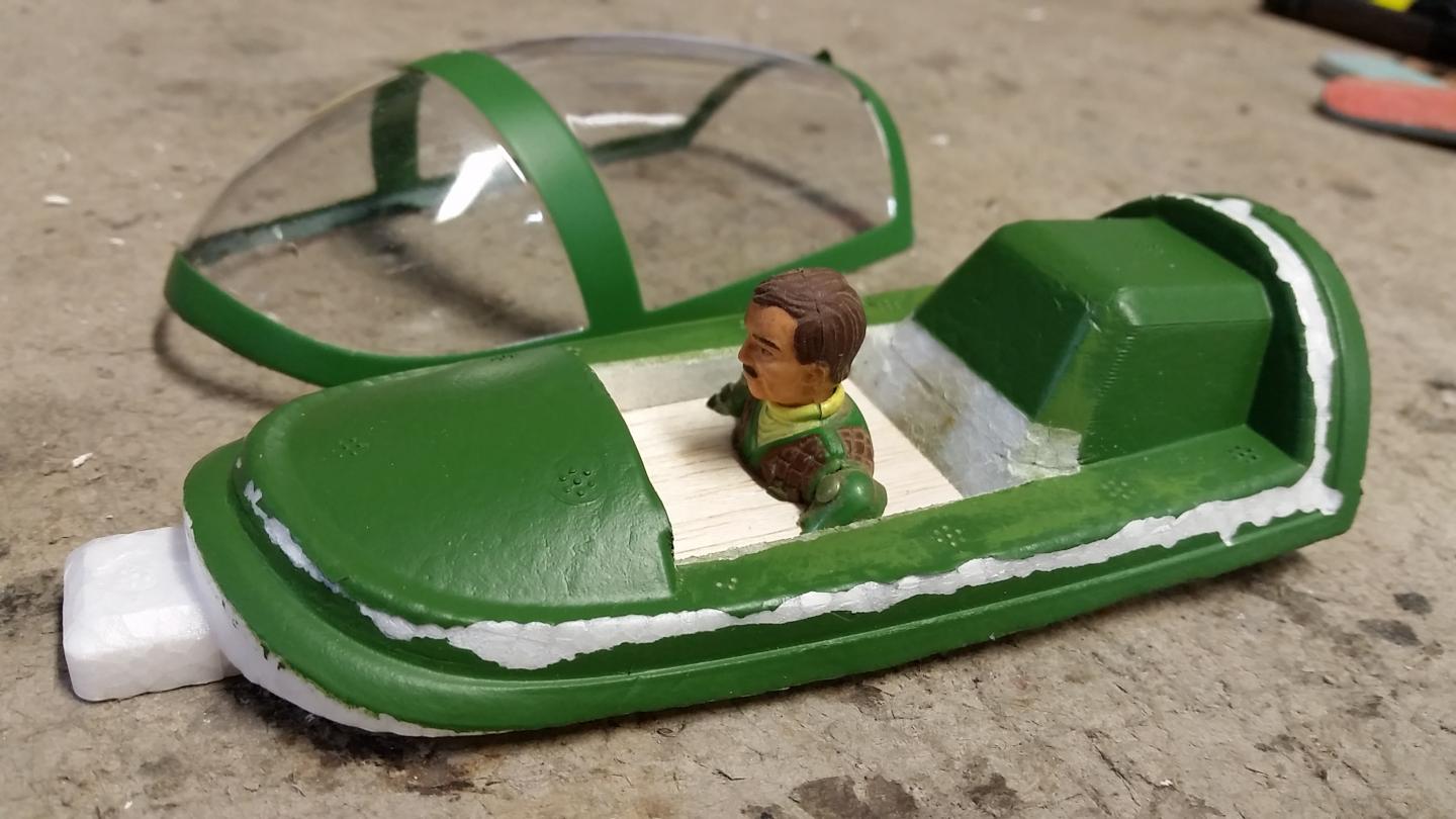

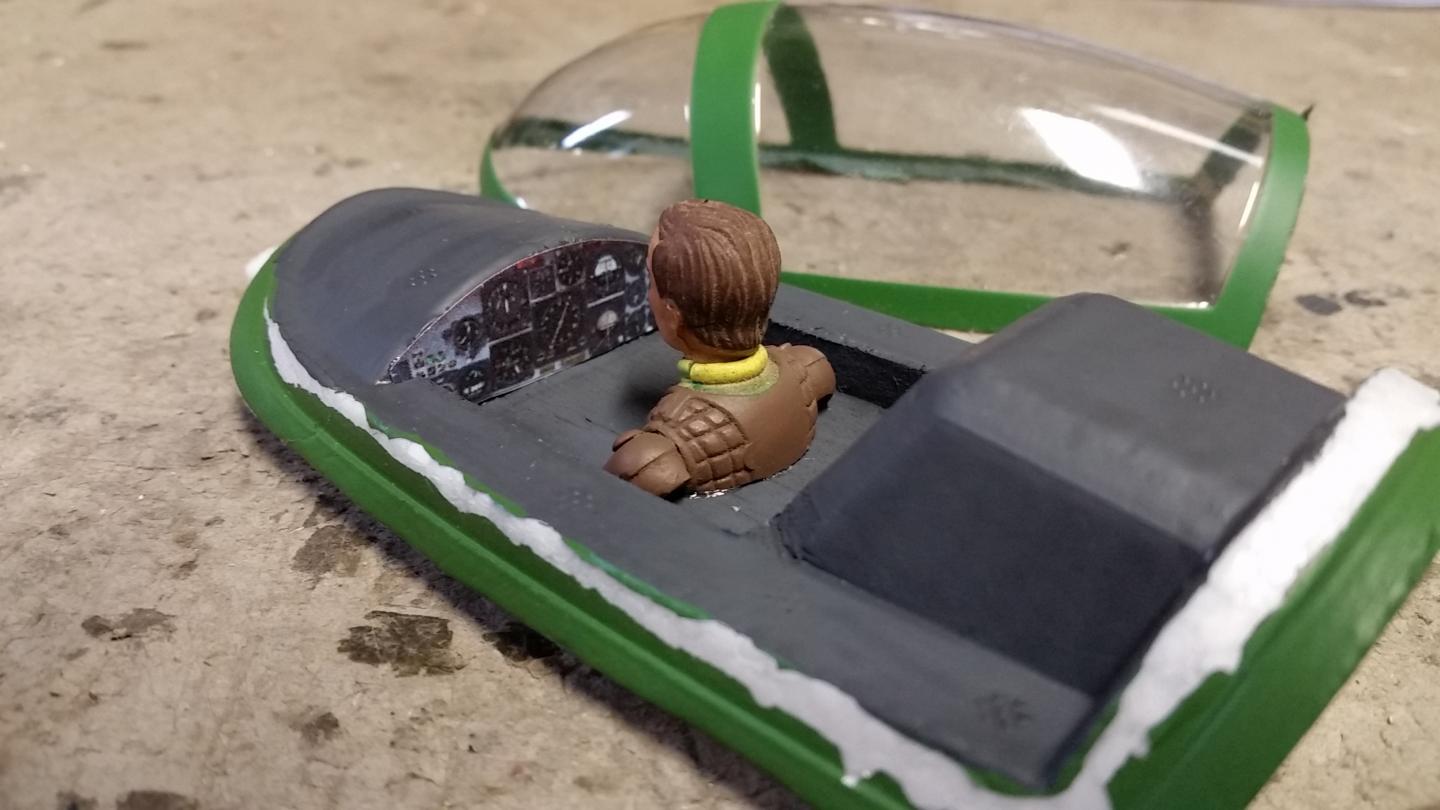

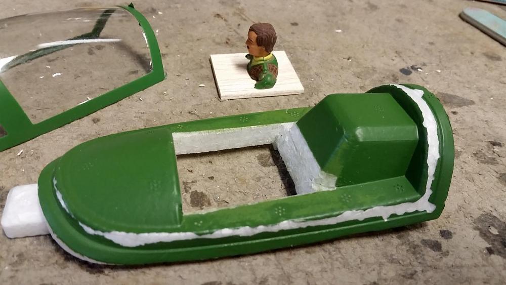

                          • So for fun... I decided to take Hardway's lead and painted the inside of the cockpit dark grey.
                            But first I cut out the cockpit floor and installed a balsa bottom, just to make it a little deeper overall.
                            I had this old crappy figure that seemed like the right size. I repainted his duds (left the yellow scarf).
                            Then I printed out a tiny F104 cockpit instrument panel and glued that in.
                            Ta daaaa!

                            • Has to have a pilot!! Very cool!! I should have done the instrument panel, but the color printer had too much junk on top of it !!! LOL Good job...

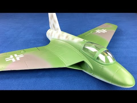

                                • I wasn't able to fly it today (hopefully tomorrow), but I was able to get my unboxing done and posted for it. Boy it is a beauty!
