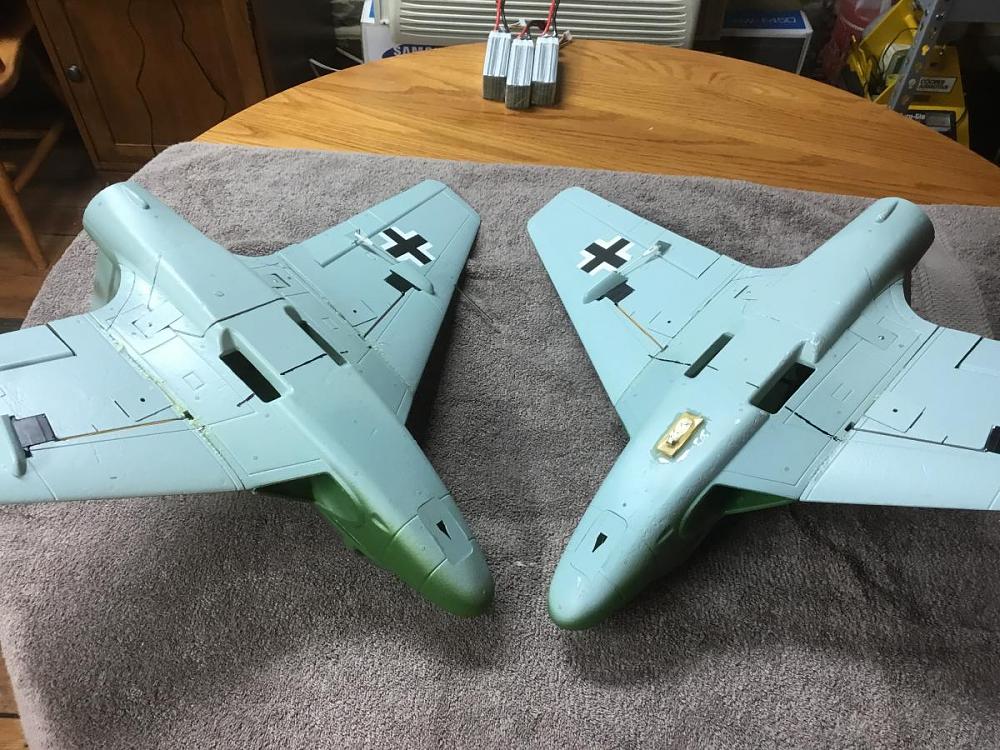

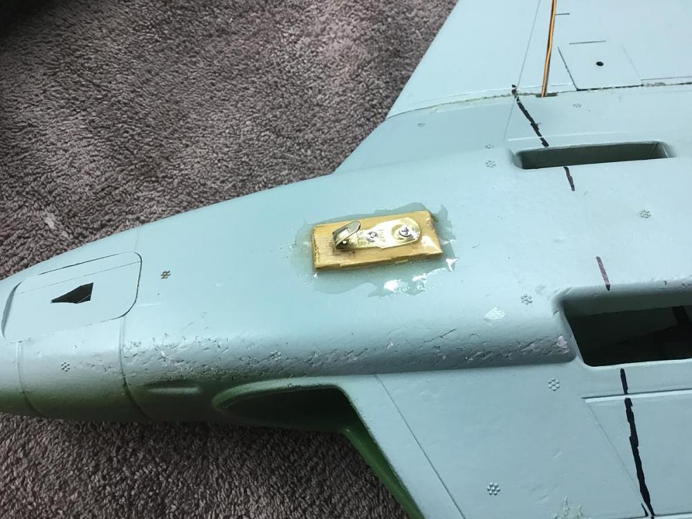

                Sorry, but every time I try and post pics and text in the same post, I wind up wasting my time, but in seperate posts it works fine.

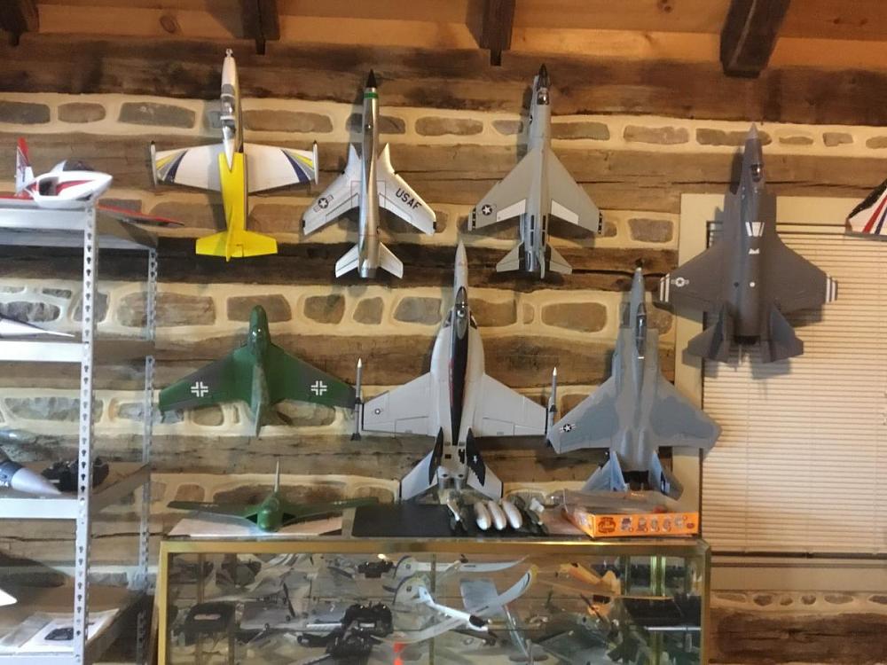

                For you guys concerned about hand launching your P-15s, here is an idea. On all my 64mms I use a small easy to use bungee launcher. You'll need the following: 1 30 foot section of 1/4 to 3/8 inch surgical tubing (Amazon easiest and cheapest place to pick up) a large landscaping nail, 50 foot of quality kite string, and 3 rings (key chain type). Take the tubing and tie one end to one ring, then tie the other end to another ring, then tie the kite string to that same ring. then tie the last ring to the other end of the string. Take your landscape nail and drive it in the ground at an angle in the direction you will be launching into. Then put the ring on the end of the tubing over the nail.
                Now on your plane you will need to put a hook a few inches in front of the CG. i use a small picture hanger that is screwed onto a lightweight piece of ply, which is then screwed into the foam, with a good coating of epoxy under the ply when you screw it on. be sure and sand the paint off below the foam before epoxying. See pics.
                When I built my two P-15s, I built the first one which uses a 3S 1500 mah battery with the launch hook and the second one which is using a 40 amp ESC, a 12 blade FMS motor and a 4S battery, without the launch hook. the first flight with the 3S I used the launcher, but found I didnt need it. The 4S is so powerful, i could launch it underhand no problem. With my bad shoulder I absolutely use the launch hooks every time after lawn darting my bigger planes such as the FMS F-15, F-18, F-35 etc, one to many times.
                To launch, just hook the ring to your plane. Walk back until you feel you have enough pull on the tubing to do the job (this takes some practice and usually less pull than you think it will), then holding the plane in your left hand, use your right to push the throttle forward and then place your hand on the right stick to control aileron in case she wants to roll, pull full back on the elevator and release.
                Another nice thing about the launch hooks are that they make it super easy to store your planes right on the wall.

                  #168
                  I'd like to see a photo of your bungee launcher, if you don't mind.

                    #169

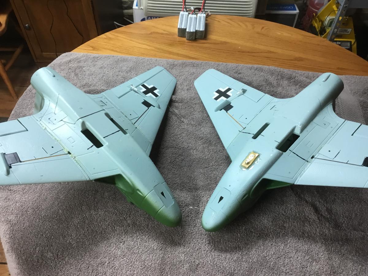

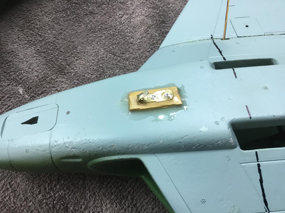

                    Here are a few pictures of it. I keep it outside full time in my flying field here at the house, which forces me to replace it two or theee times a year due to UV damage, but it’s worth it to me to be able to walk out of the shop and fly in a minutes notice.

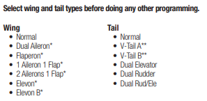

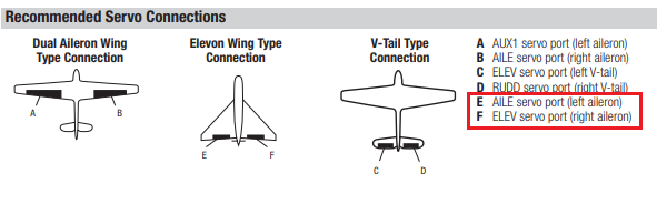

                          I have the Freewing Lippisch P.15 and a Spectrum DX 6e. How do you configure the transmitter to work the aileron and elevator? I have trued every setting. Elevons, etc. Nothing seems to work. All combinations behave as ailerons.
                          Jeff Armbruster
                          • davecee
                            • 179
                            • Nashville, NC
                            #173
                            Jeff Armbruster
                            From the manual
                              • 8835
                              #174
                              Jeff Armbruster
                              You must have them "Y'd" together.
