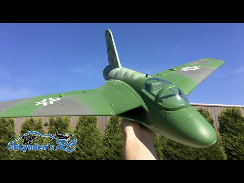

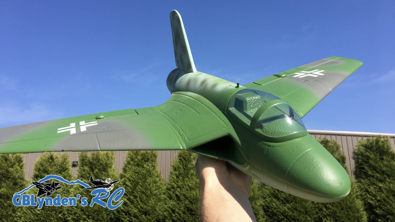

                                This is a very underrated plane that I have been flying a lot lately due to nasty crosswinds on my curb and light post riddled runways lol
                                It is a winner and a great warm-up plane!
                                GB
