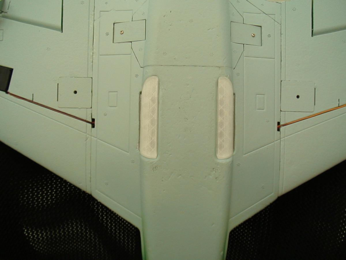

              • Hi folks. I just got this plane and joined the forum. I've read people get better performance with this jet blocking off the hand holes. So I developed a 3D printed design that matches up pretty well. Just glue in place. Attached is a picture of them in place and a zip file containing the stl to print. Enjoy! [ATTACH]n249171[/ATTACH]

                  Good work billyd, thanks for joining squawk and nice work on the .stl. I never tried to do anything to my lippsich's. But I may give these a shot just for the heck of it
                  • If the hand holes are plugged, how do you hold it to throw it? This plane can, at times depending on the how it's thrown, require quite a good toss.

                      Thanks. It fits better than in the photos. I've heard plugging the vents will stop the throttle from changing pitch and makes the Jet faster. We'll see.
                        Actually there is still a fair amount to grip. More than on many of my aircraft. However mine has a full fpv setup, so I will be using a bungee launcher.

                          I designed our P.15 to be able to fly without the aux inlets, and it's true that without them and thus less turbulence, the model flies faster. The tradeoff is your static thrust available during a hand launch condition. With less airflow readily available to the fan, you'll need to help "feed" it, with either a faster headwind, faster hand launch, or both.

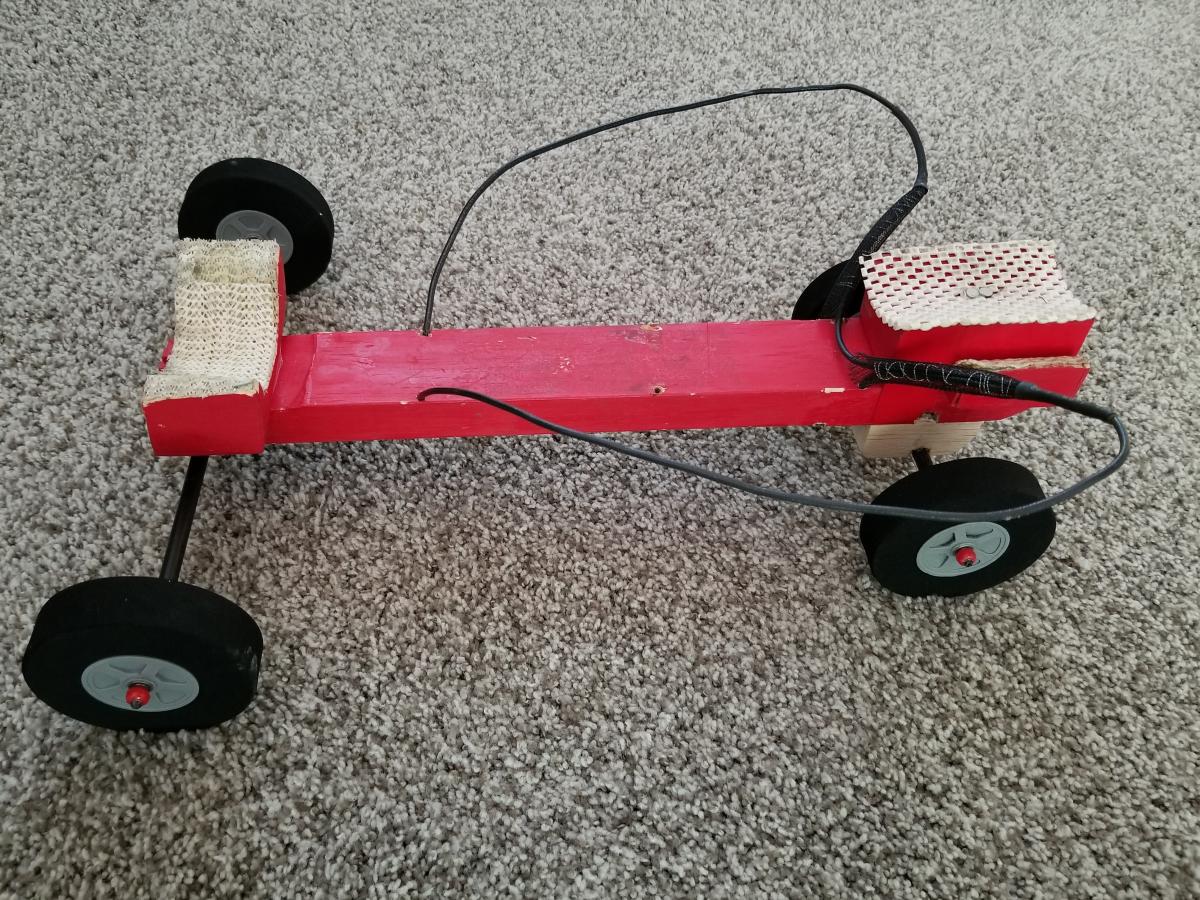

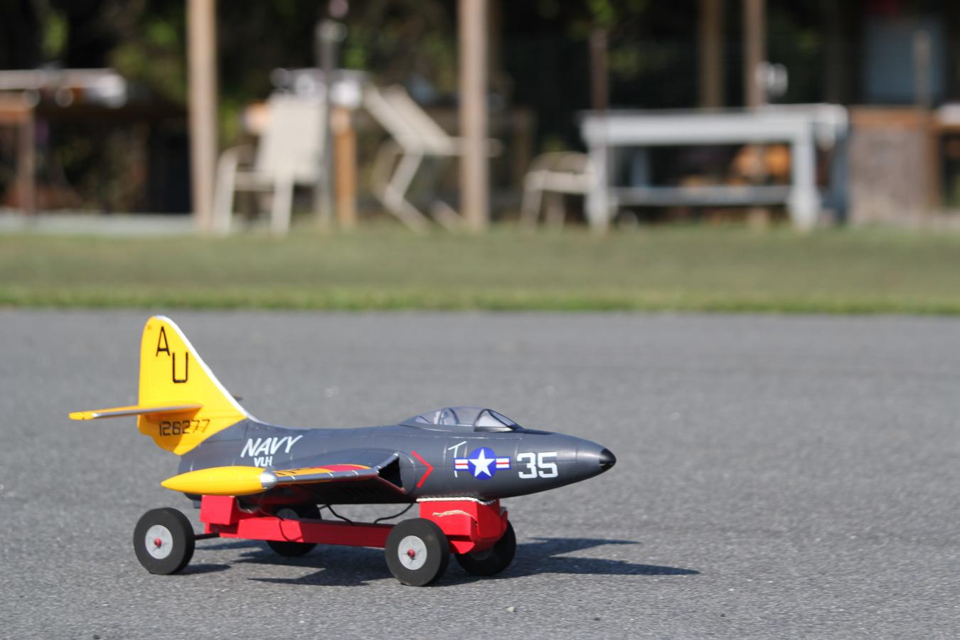

                            • I made a cart to launch mine as I really don't like hand launching DF planes plus it was a fun project.
                              the 4 cell fan/ setup for the 64mm is EXCELLENT !

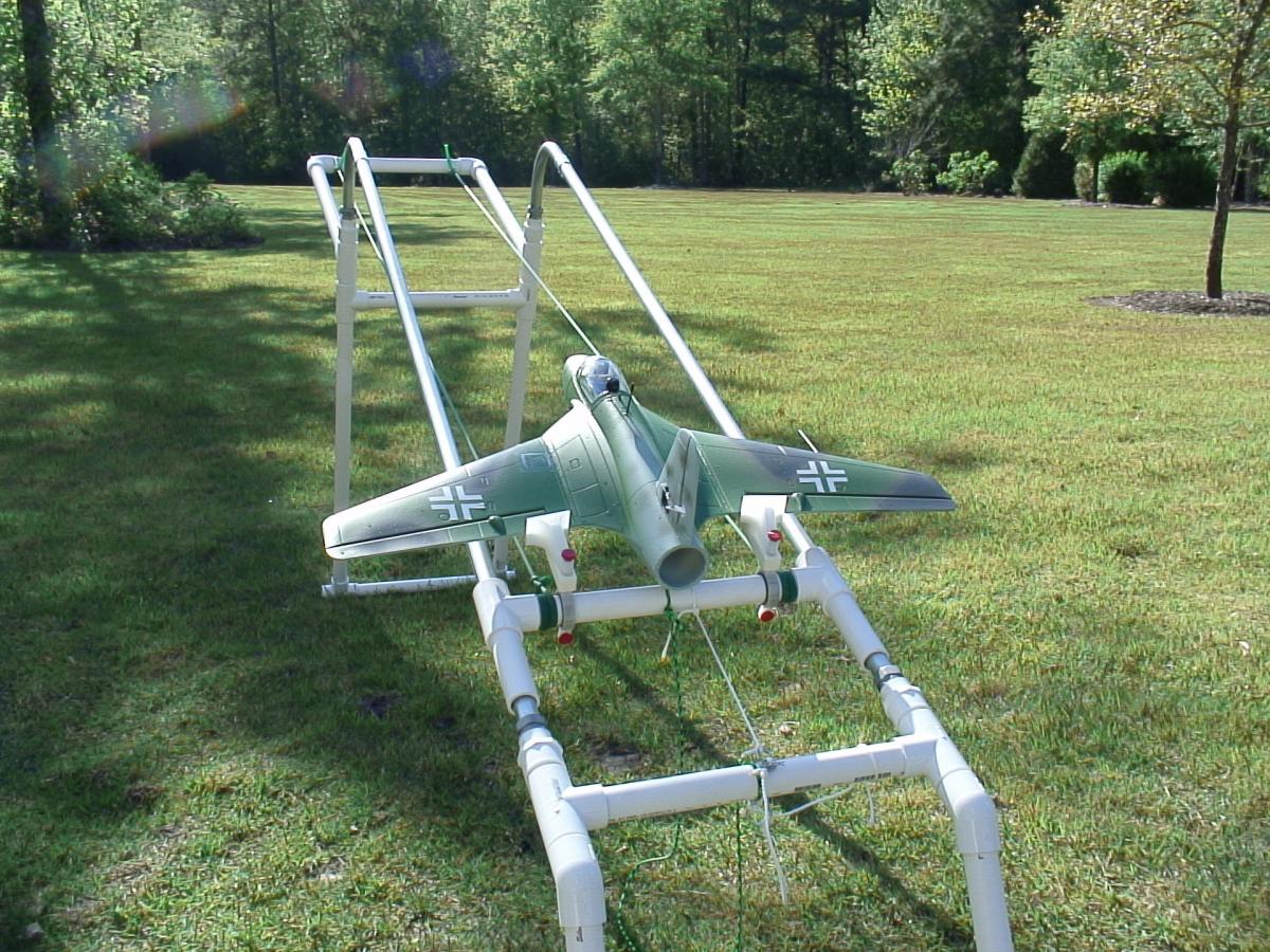

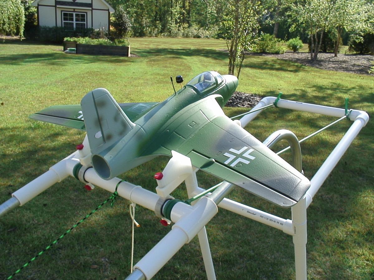

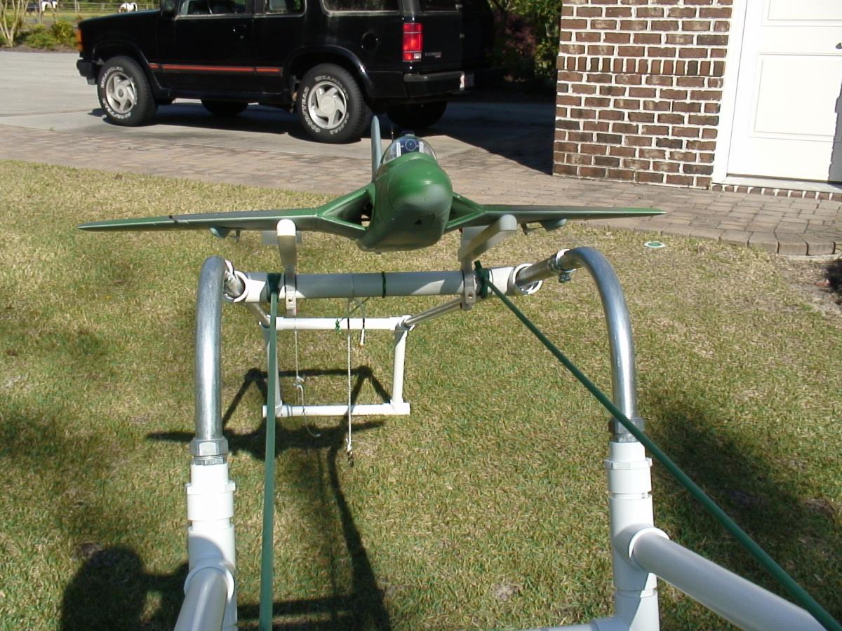

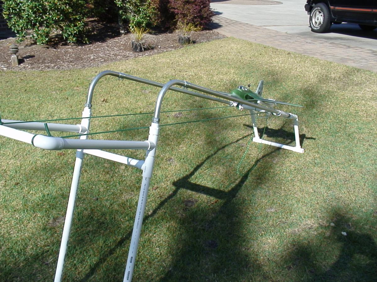

                                Here are some pics of my IB crazy launcher with some special 3D prints I designed to be able to use it for smaller aircraft like this one. As an edf and heavier, this would require a really strong throw. The launcher is much more reliable. Click image for larger version
