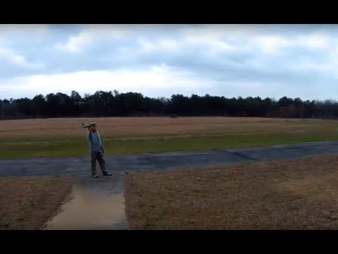

                            I squeezed in a flight of my Little Lippisch today, just before a storm moved in. The winds were really howling (15-20 knots). The P.15 handled the wind quite well. I'd mechanically set my elevons before this flight, and I was crazy out of trim. So, due to the turbulent wind and the out-of-trimness, I kept the plane pretty high and out a ways (other than a couple close passes); so, it's a very dust-dotty video. Sorry. The best part of the video is the falcon attack at 1:03. The falcon didn't miss by much.
