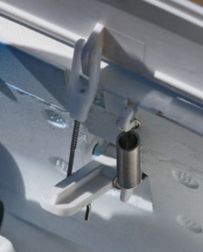

      More flights for media ... this time in bluer skies! Also, seems like a user asked about the nose gear door mechanism? Here is a close-up ...

        Nice! Looks servo driven, right? The screen is small and I’m not on my laptop so it’s harder to see.

          No servo in the photo TC. The rod disappears into the fuselage so if it is the servo is on the top side..

            Thanks Bill. It’s not under what looks like a spring? Maybe the door pressure closes on that white tab sticking out. I need to go on an iPad or Laptop to see it better. LOL

              If it is, it's well hidden. It's possible that the gear strut may hit that white tab the linkage goes through and pull the door shut. Looks like the spring is there to lift the tab when the gear is down.

                Looks to me like a simple push lever setup. The NG strut pushes the lever as it retracts into the bay, closing the door. The spring holds the door closed so as not to have to make finite adjustments to the lever/control rod.

                  Exactly!

                      Looks to me like the spring actually holds the gear door open. The NG strut hits the white tab to close the gear door upon retraction and mechanically holds the gear door closed. When lowering the gear, the NG strut removes the mechanical pressure on the white tab and the spring pulls the tab upward (in this picture, actually downward with the plane upright) and holds the gear door open.Click image for larger version  Name:	Capture.PNG Views:	1 Size:	197.7 KB ID:	150613

                        ...and so far it works very well. I am used to seeing a nose door like this "creep" a little I.E. be a bit ajar inflight. Not so on this mechanism.

                            Great close up. It appears you’re right on the money. I can’t see it working any other way with the way it looks to be designed. That’s great and hope it works well.

                                Yes, the nose mechanism is a new design, adapted from similar designs probably most recognizable to those of us who used to DIY our own doors on balsa planes before the Age of PNPs. The "sprung lever" has an advantage in terms of holding power and as Pat guessed in not requiring frequent adjustment. The spring is calculated in reference to the range of incidence angles possible with the strut in the stock location and also a rearward "bent" position. Translation: The door will close and hold closed even if the nose strut happens to be bent or kinked in any way.
