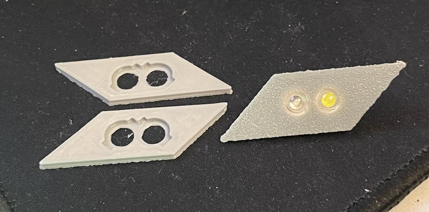

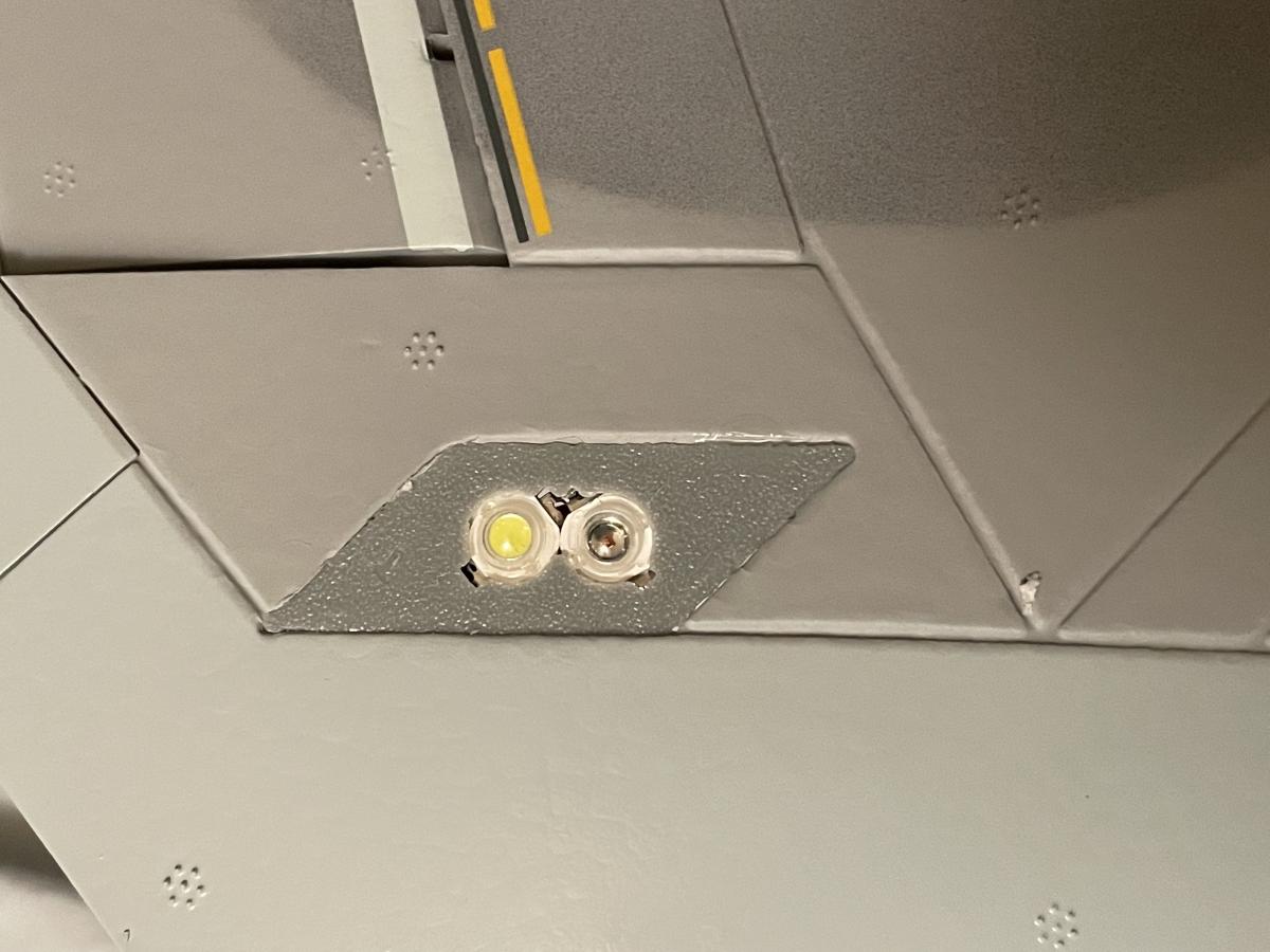

                        3D-printed light mount, simplifies adding navigation lights to the wing - just cut the parallelograms. Recessed mounts for high-power LEDs pre-spaces and orients them for a common lead. Install them flush with the wing with optional faired covers, or recessed with clear flat panels.
ID:	388154Click image for larger version
