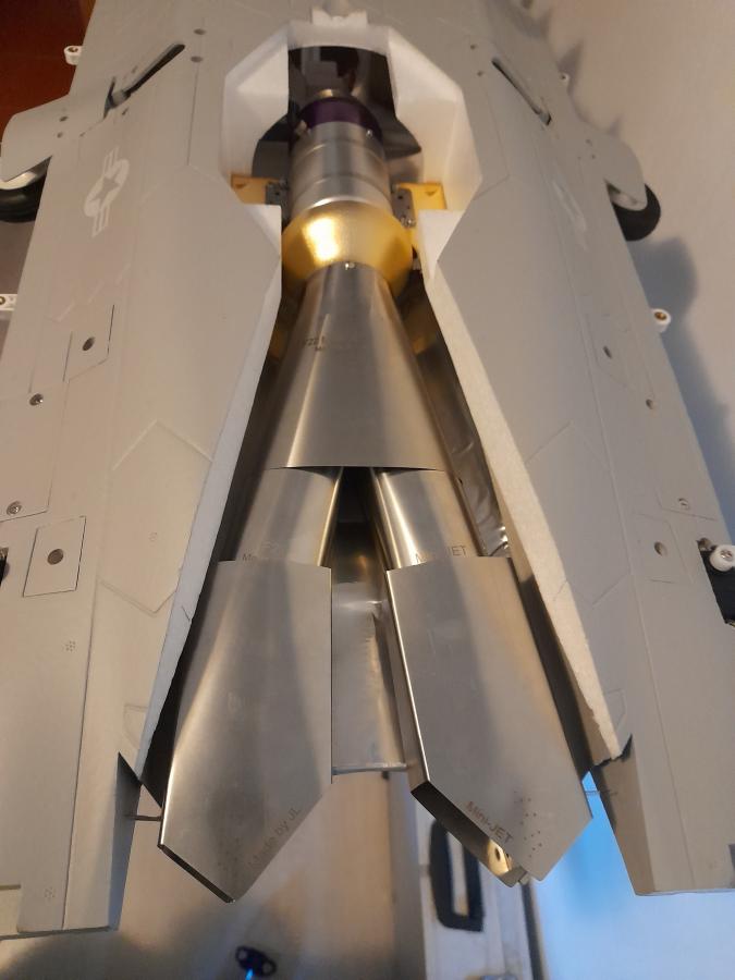

          • At the end i made and finished the conversion of my F22 to turbine using the kit from bigboysrc. It will be equipped with X45. I can't wait to fly it. Total weight is 3700 g, without fuel in the main tank, so in my mind will be just fine comparing with the EDF version where i had around 3900 g.
            Badan Kit - Yak55M 2.8m; EF - Extra 300 2.3m; Multiplex - Funcub;Funjet Ultra2;Parkmaster;FW - F22 90-X45 Xicoy;ROBBE MISTRAL 2.0
            • Looking great!
              • So this Monday i have the maiden. It flies awesome with the turbine, what sound!! Unfortunately someone told me that because of the bifurcated pipe i will lose from total power and also will increase the fuel consumption, yeap it is right, the flight is around 5 min, but i have full power when i need it. I will make a film next time.

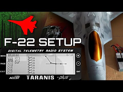

                                  • Originally posted by Airguardian View Post
                                    "This your last chance. After this there is no turning back. You take the blue pill, the story ends. You wake up in your bed and believe whatever you want to. You take the red pill, you stay in Wonderland, and I show you how deep the rabbit hole goes. Remember, all I'm offering is the truth. Nothing more."
                                    That is the most impressive and extensive programming I've seen yet in OpenTx to open the flight controls and envelope in a model, very well done. And here I am, just now finally purchasing the 8s version with only 8 channels to play with on my Spektrum NX8 radio, but your setup makes me want to put the F22 on my Radiomaster tx16s to squeeze every bit of performance out of this aircraft 😁
                                    • Hey, sorry!
                                      I somehow missed your reply... thanks!
                                      I definitely do think you'd make a lot more out of your Raptor on the Radiomaster than the Spek transmitter. 16ch FTW! :)

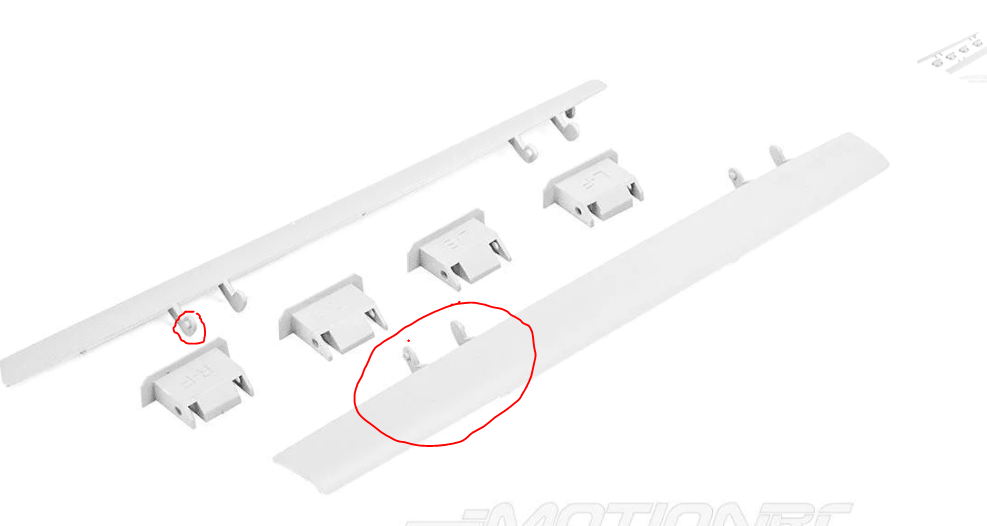

                                      • Hello,
                                        Last weekend I had a bad landing and I broke the nose door (the fixation in the red circle). Because on the site they are out of stock can someone with F22 90 mm to tell me from the surface how many mm is the height and depth for the small circle. I want to print some and glue until will be again available.
