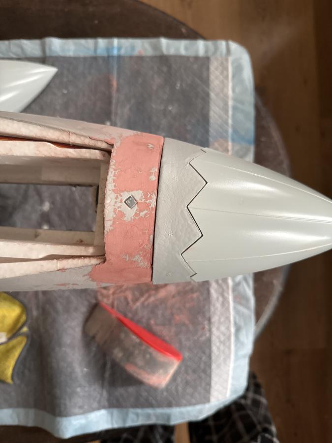

    Thank ya working on wing leading edge protectors right now, have it mocked up just need to refinish them before install

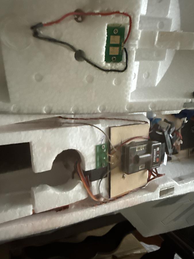

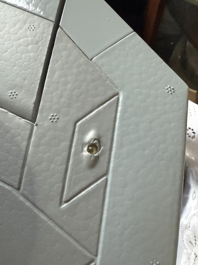

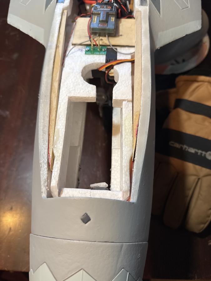

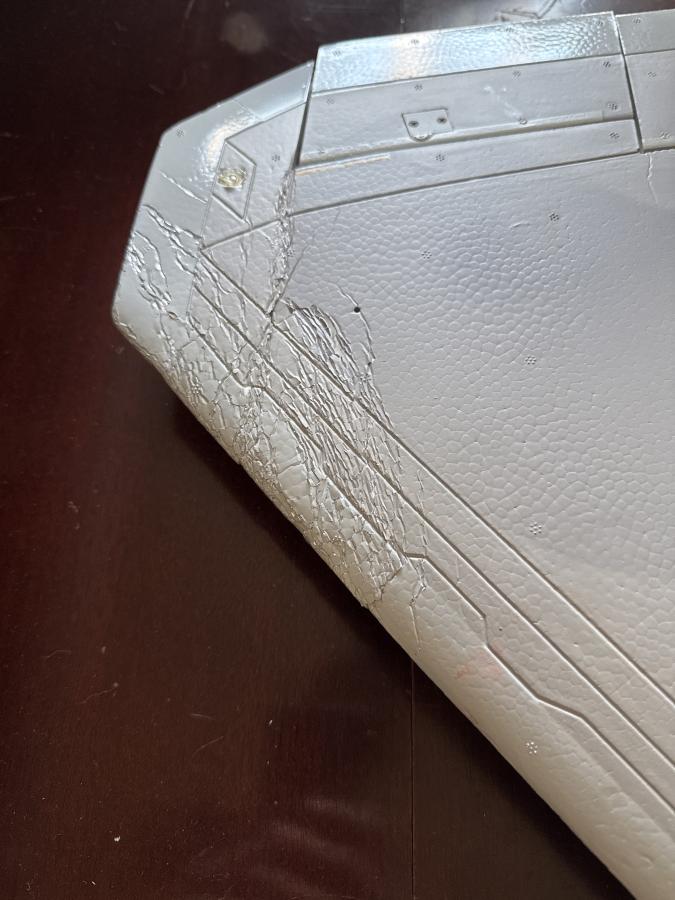

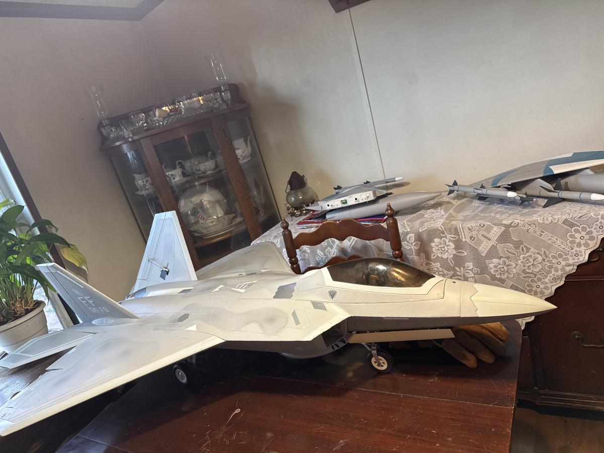

    Just did a refresh on the 90, 8s some foam repairs supports ( nose area getting soft ) added wing lights along with a 8s 5280 burner that I modified. Guys check your main gear shaft pin screws mine came out on taxi causing some bad wing damage, remove clean and locktite them trust me. Here’s a few pics of where she’s at now and in process
