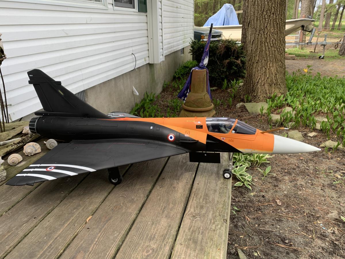

  • shortround91
    That’s super cool I love to do mods or add ons to my planes. I’ve done lights etc on my Mirage 70 Raptor many more I made my own cockpit set in the Mirage I get lots of compliments on how I did it

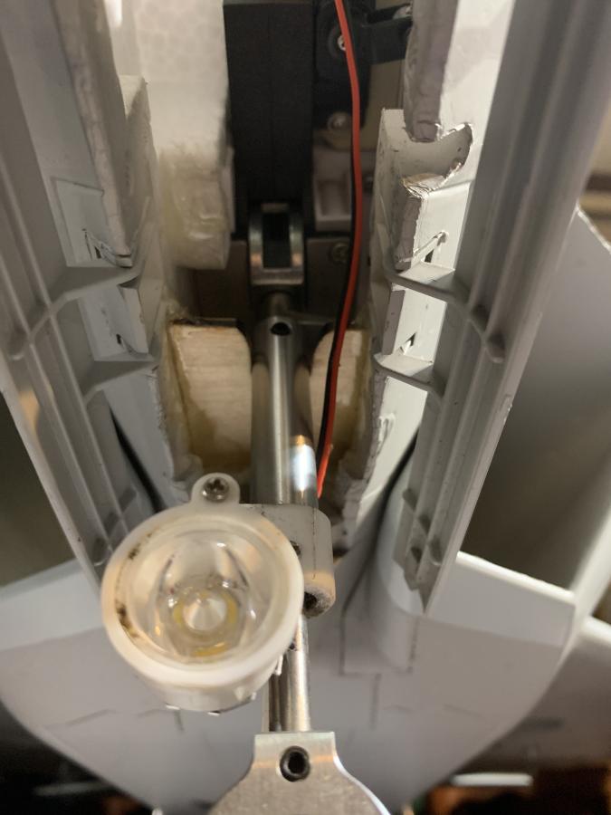

  • Fast N Light
    Originally posted by shortround91
    That looks amazing great work
    Thanks The download includes a .PDF with assembly guidance and more photos. The landing light is probably much easier than the others you have already done.
    I am also working on printed housings for the navigation and formation lights. Hope to get those and a number of other projects finished in December.

  • Fast N Light
    Just finished up my 90 Raptor, KMRC blue burner, nav lights, running lights and illuminated cockpit. I also wired in disconnects for the wing lights so wings can be removed without wiring issues. Think she turned out great
    If you are interested in a dual beam landing light, 3D print files (link) are available.
Name:	F22 LandingLight Side.jpg
Name:	F22 Nose Gear Light Side.jpg

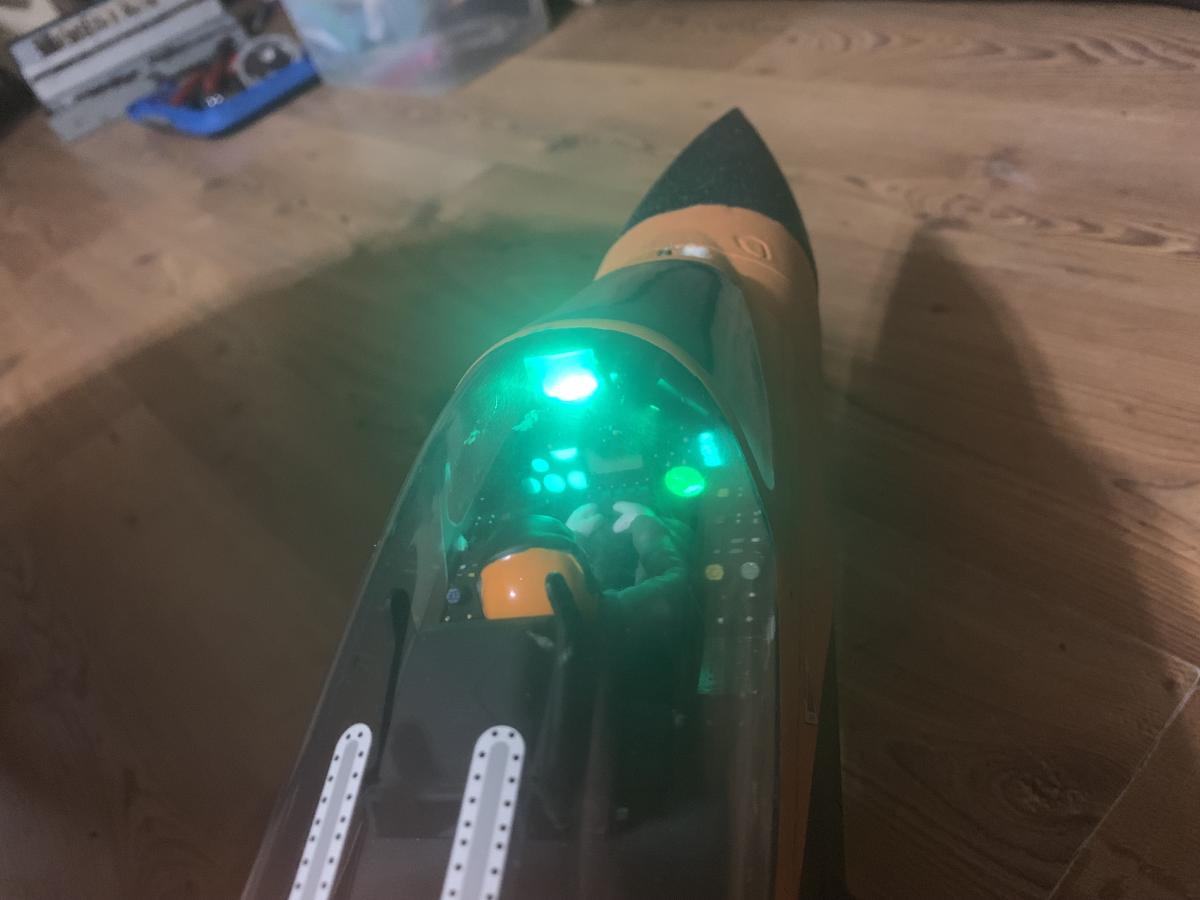

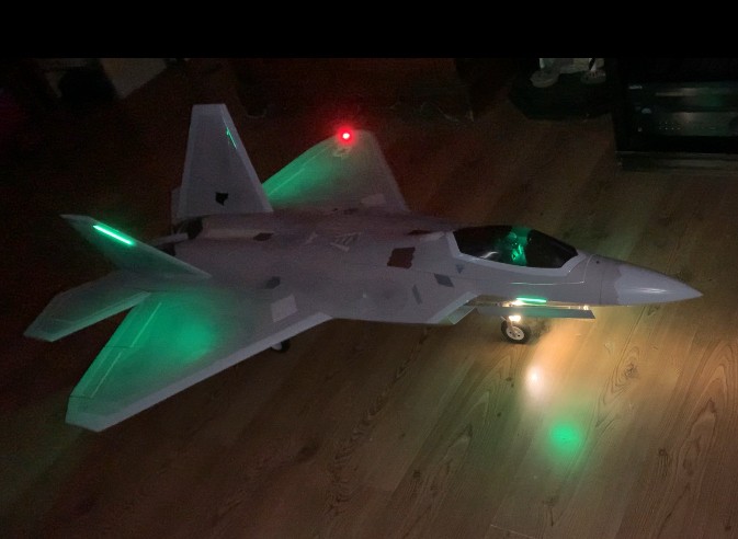

  • shortround91

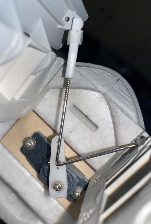

  • billd3
    [QUOTE=Fast N Light;n414076]
    Hope this helps
ID:	414077 Click image for larger version
    ABSOLUTELY PERFECT, Fast N Light...Many thanks!
    Bill

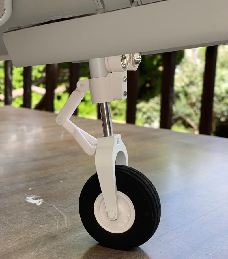

  • shortround91
    Only issues I’ve had with my 90 that I’ve since fixed, front landing gear support and main landing gear strut screws kept coming loose. Ended up green locktite for the screws no more backing out and I bought a 3D printed support which cracked and I’ve yet to have a bounce landing so I made a 2 support mod that many many flights since not a single issue. Posting pics of what I did for the front gear. Very easy to do guys and no worries about 3D plastic cracking.

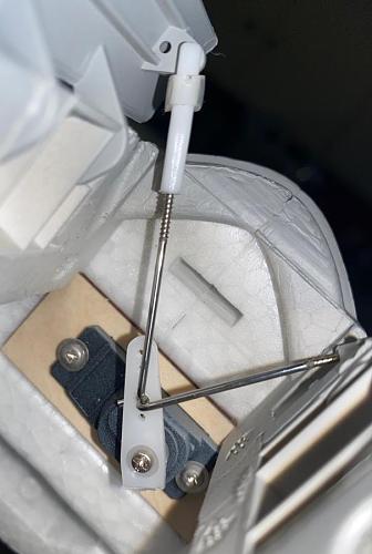

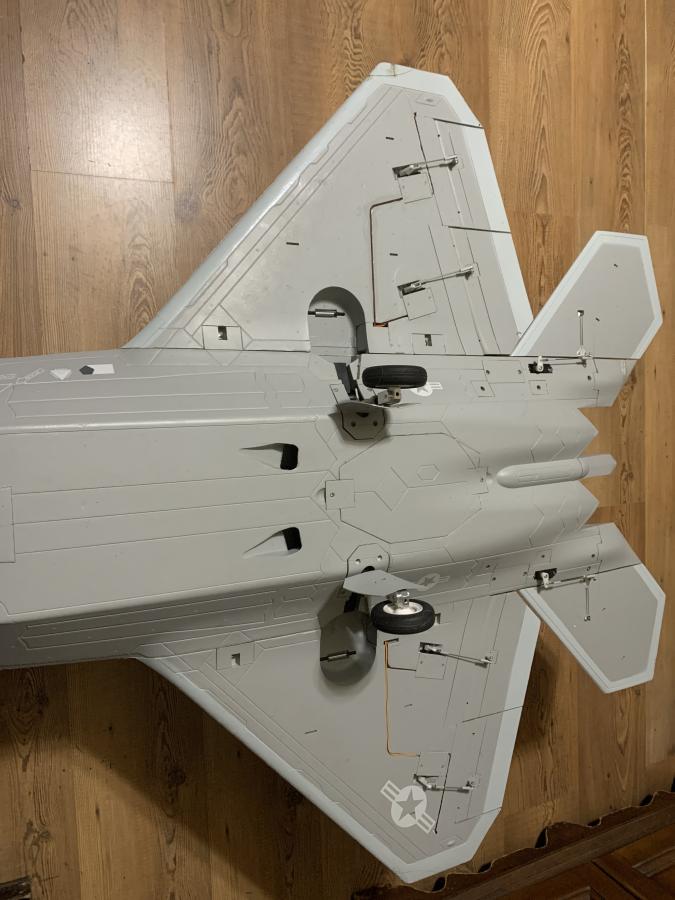

  • Fast N Light
    Originally posted by billd3
    ..., so I need a couple if pictures of the push rods and how they are installed on the servo arm so I can make new ones...Can anyone help by posting some pics of this area?
    Thanks in advance,
    Bill
    Hope this helps

  • billd3
    Originally posted by DCORSAIR
    You can purchase all the pushrods separate, wouldn't hurt to have an extra set plus if you watch the build video on their web page you can see the nose gear door set up at around the 4:50 mark but you may have to slow the video down to see it properly, just a thought on that.
    Which video do you mean? ...Can you tell me what the "post number" is?
    Thanks,
    Bill
  • DCORSAIR
    I am rebuilding my 90mm F-22 after a mishap...I ordered a new fuse which thankfully had all the extension wires installed...BUT... has no control rods installed on the nose gear doors. After my crash I could not find my old push rods for the nose gear doors either, so I need a couple if pictures of the push rods and how they are installed on the servo arm so I can make new ones...Can anyone help by posting some pics of this area?
    Thanks in advance,
    Bill
  • billd3
    Thanks in advance,
    Bill
    I would try to troubleshoot the stock ESC first. Is it the big black one with a separate BEC or the newer blue one? What is it doing or not doing?
