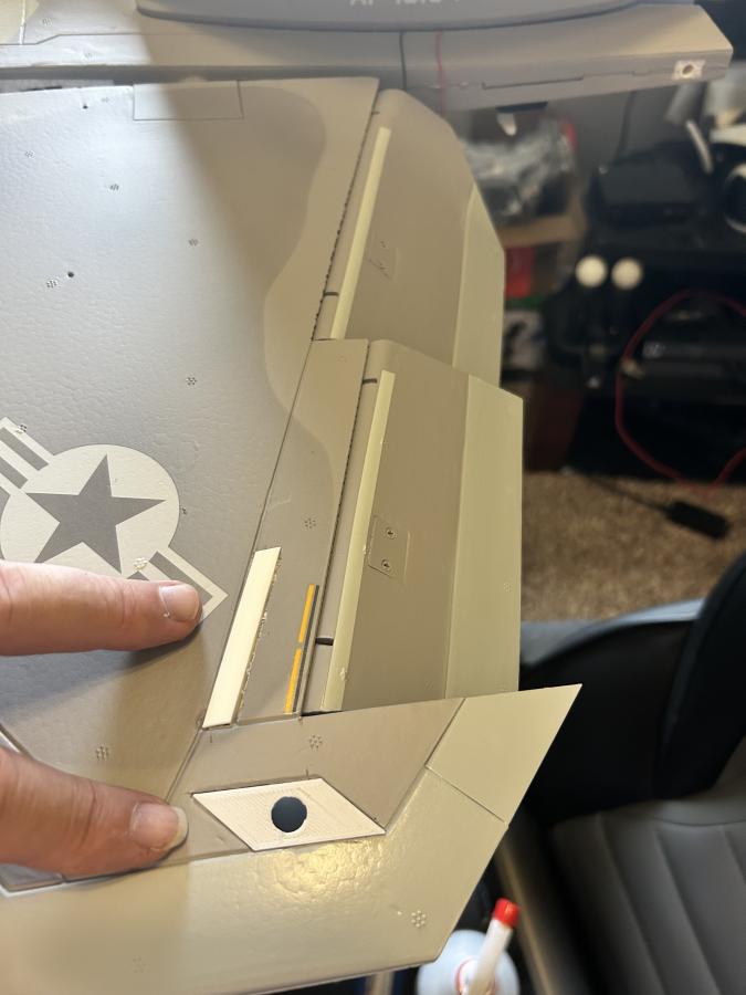

    Just need to finish up the nav lights and change out the main tires when they get here. I love how the slimes look powered up.
    Gravy

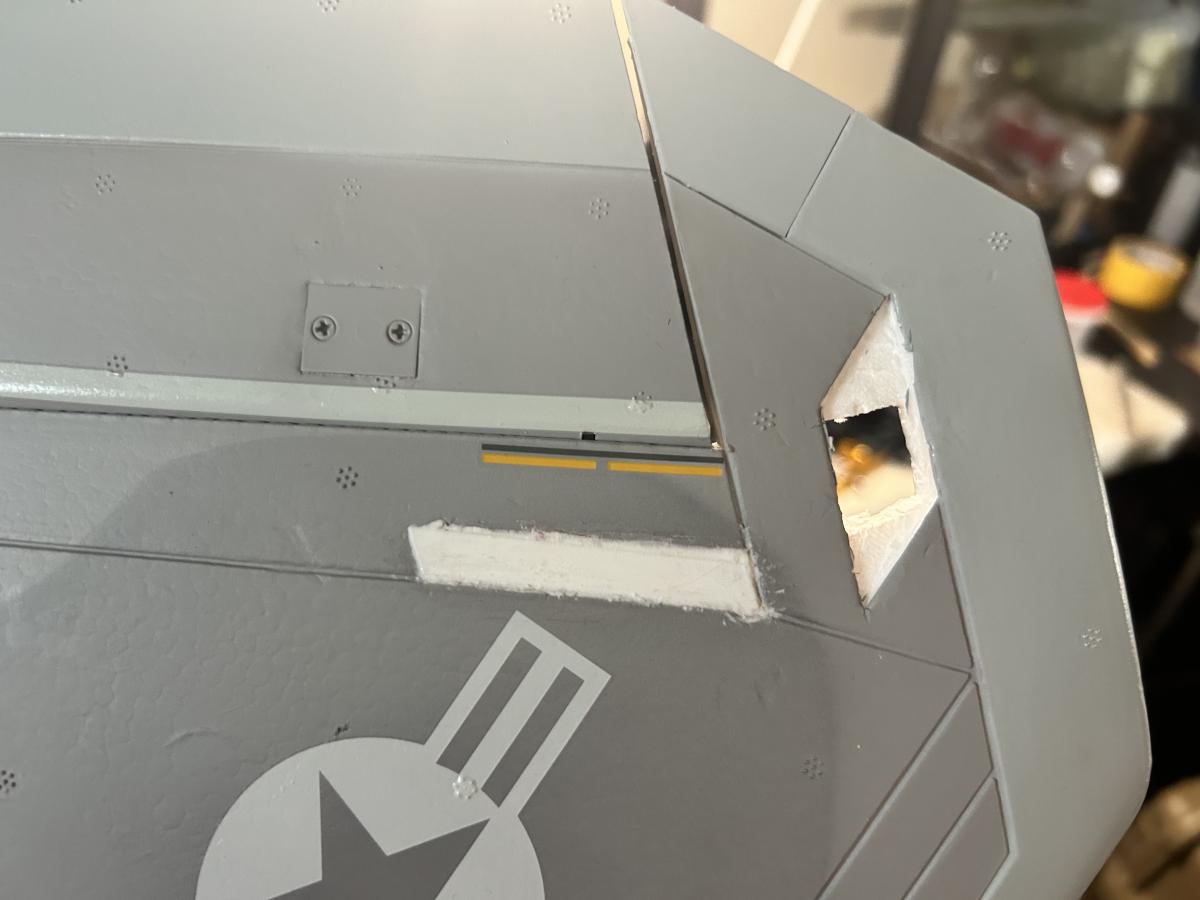

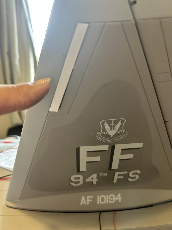

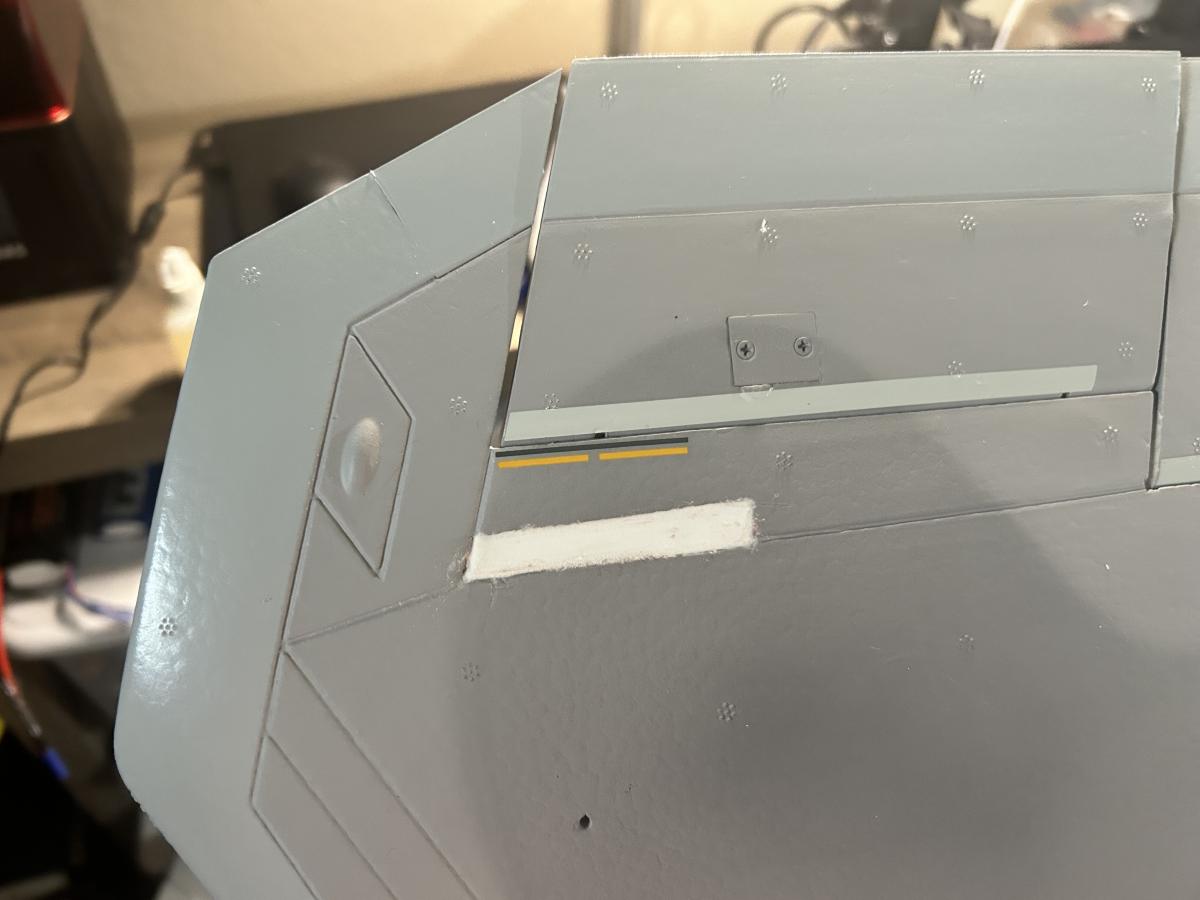

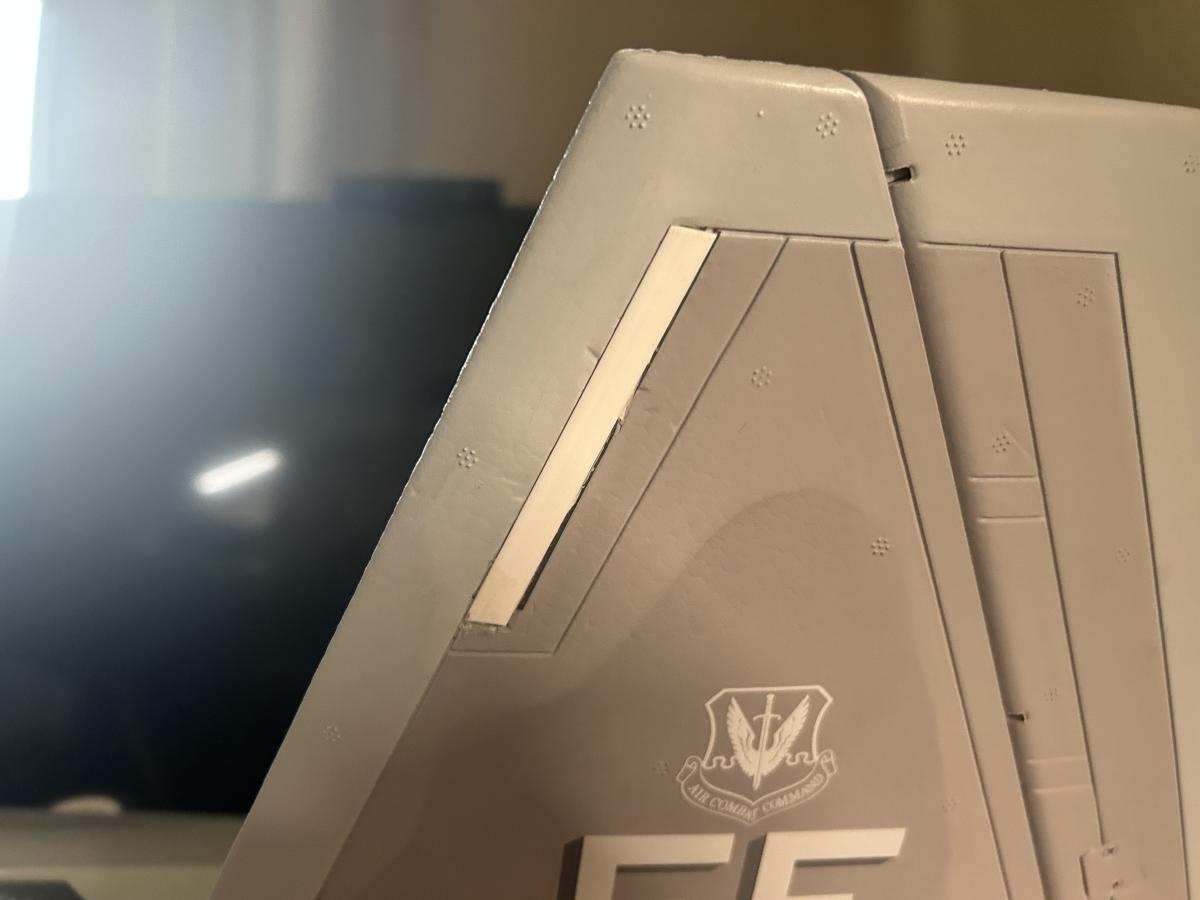

  • Gravythe clown
    yes it is it went in nice. However I changed out blades very often. I used a new blade to cut in each of the six lights. I used gorilla glue to set them. I used very little but it still foamed up through the seams in the wings. So I got some clean up to do there.
    I'm hoping to finish her up today. Not sure when the maiden will be. Not worried though as this is my second 22, so I know how she flies

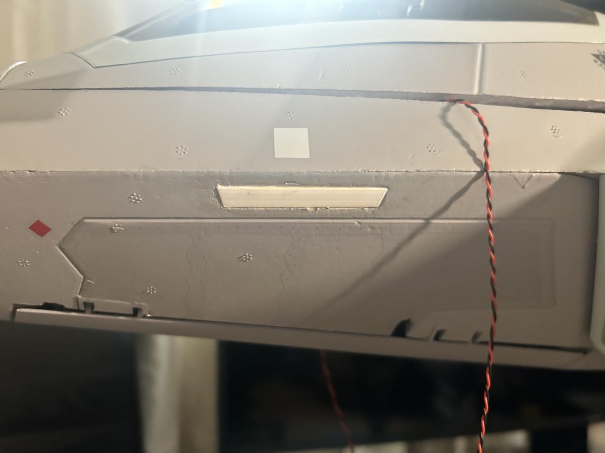

  • Gravythe clown
    Well I learned today that the ribbon cables are not wired like I thought. I made the faulty assumption that the red and black wire of the 8 was + and - .
    it was only after I cut into my cables to splice out for the wing slime lights. Thank god I figured it out before powering anything up
    only question is, why would they do that. If they would have wired it up revers of how they did it would be color coded correctly.
    I do like how the slime lights look, I just need to finish up my nav lights and I can wrap this baby up.
