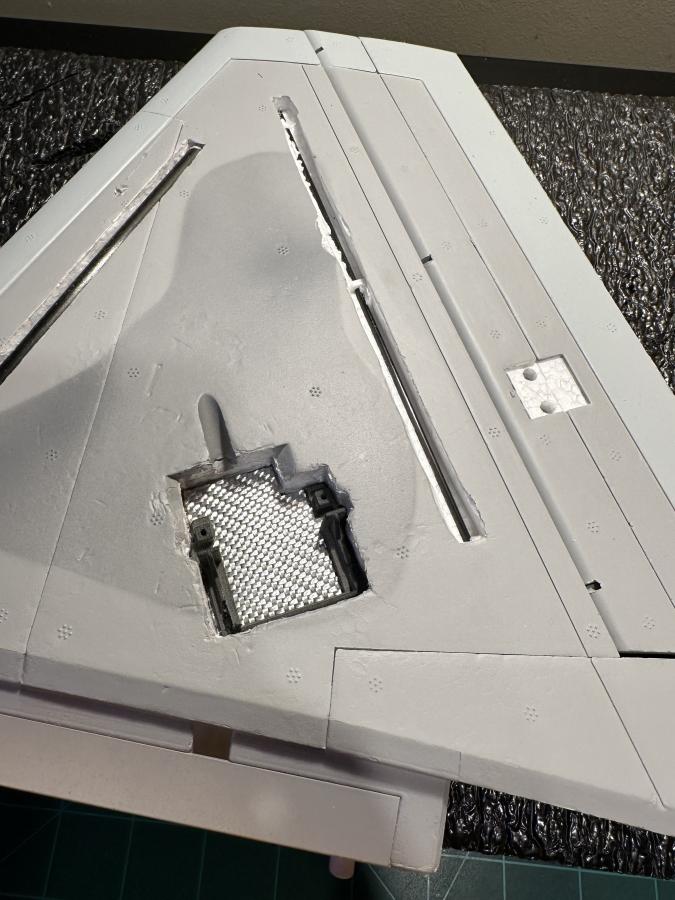

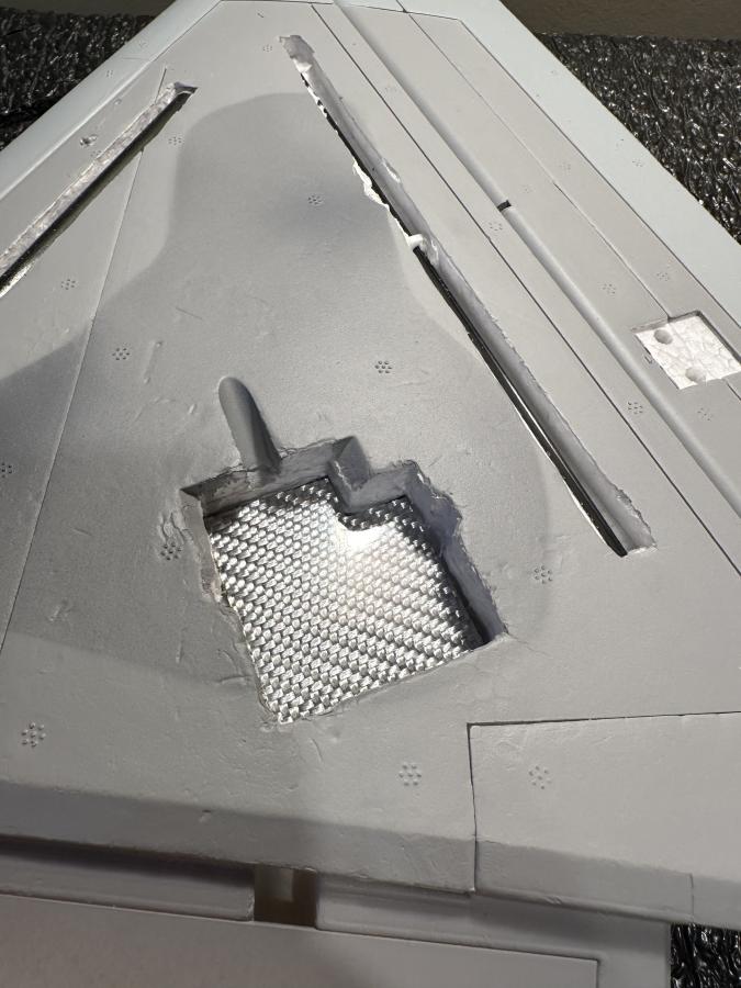

  • Fast N Light

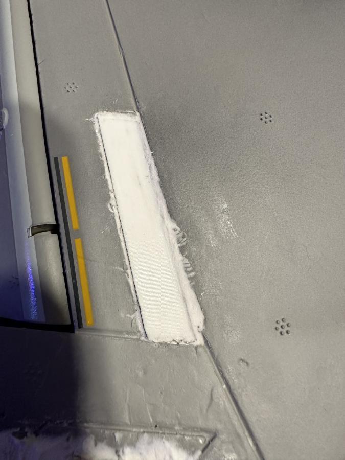

    Almost done on the F-22 wheel set...
ID:	402816 Click image for larger version

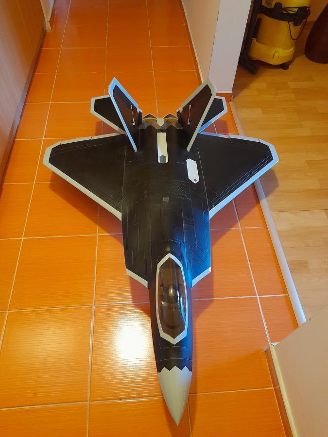

  • Oachidori

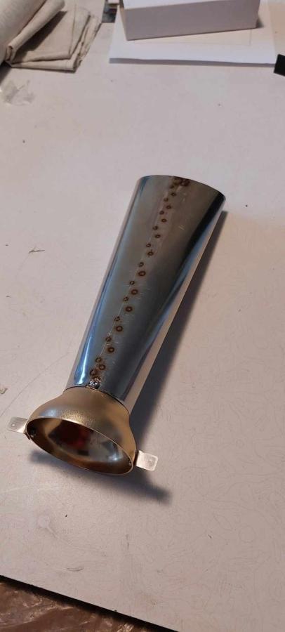

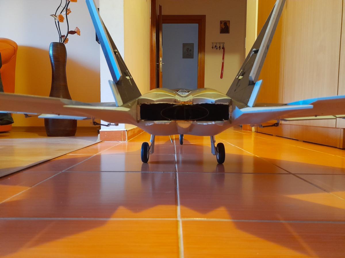

    For the third F22 i decided to put a straight oval pipe with the X45! Good decision! the plane fly awesome, i flew around 10 min with 1 l tank, so that is very good. Before with the bifurcated pipe i flew only 4 min with a 0.8 l tank and the tale off was difficult. But how you can see in the movie, i fly only on the grass field and my problem is the behavior of the plane. How can avoid the hopping of the plane? My Sebart's friend doesn't have this behavior..

  • Oachidori
    After i tried the bifurcated pipe and i saw that wasn't the best solution(lack of power and more fuel) i decided to buy another plane and install an oval pipe. This time i didn't had to cut the plane to install the new pipe. I also painted in black to see better the difference between the two faces. Also i replace the receiver with a 12 ch to have the rudders on separate chanel and to have the possibility to make some mix, in order to help me to take off easier from our field. We will see.

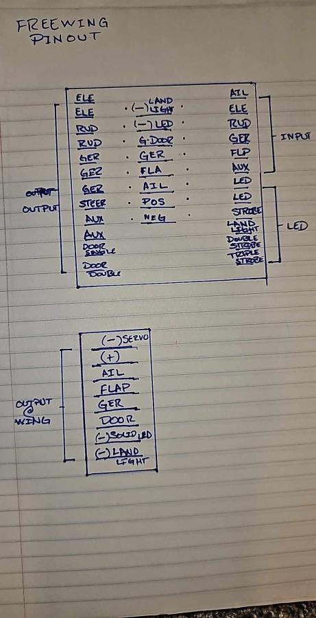

    Well I learned today that the ribbon cables are not wired like I thought. I made the faulty assumption that the red and black wire of the 8 was + and -
    Gravy
    For those wanting a quick reference, i finally spent a couple hours sciencing the **** outta the pinout of the bluebox and drawing it up😅

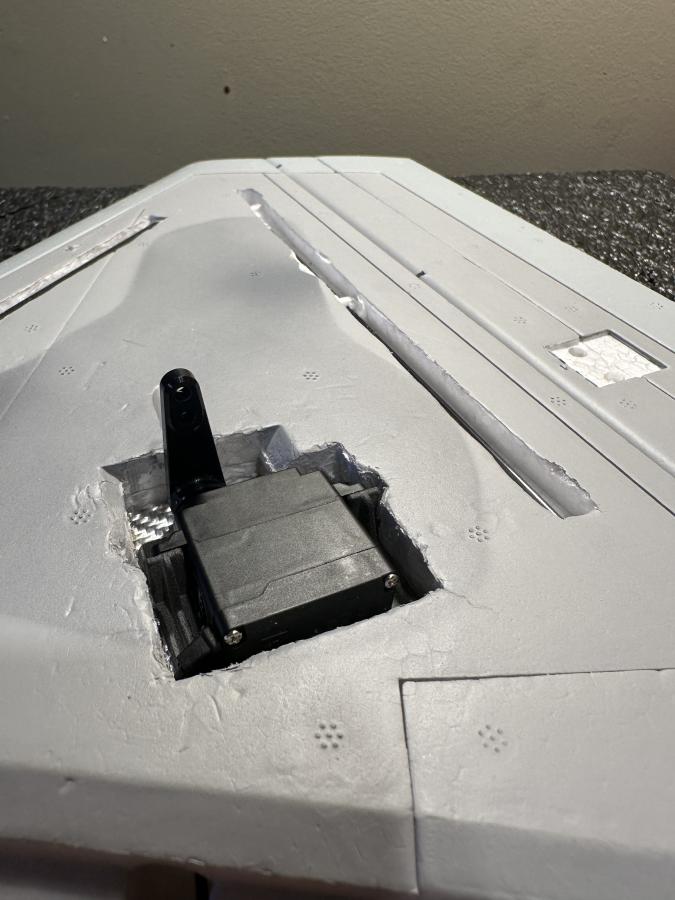

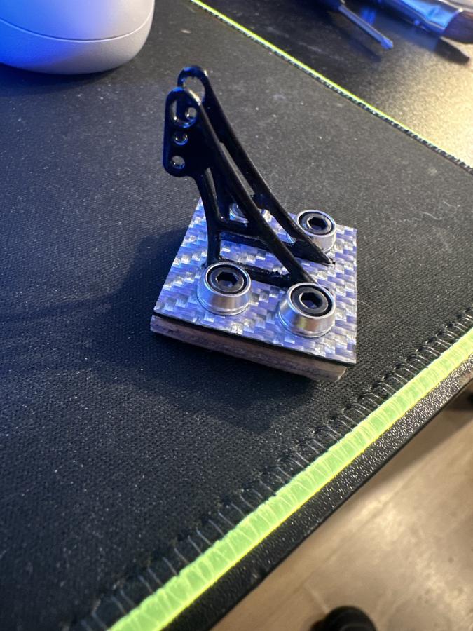

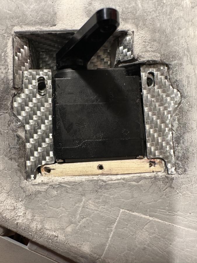

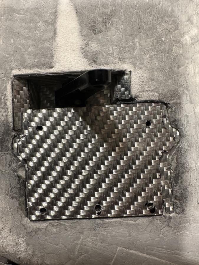

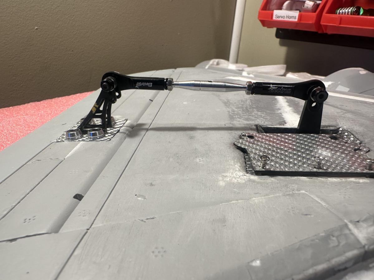

    Here are the rudder servo trays I created along with the hardware placed to withstand the HV servos. I love the way they look! This turned out great and I am happy with the end result! :)

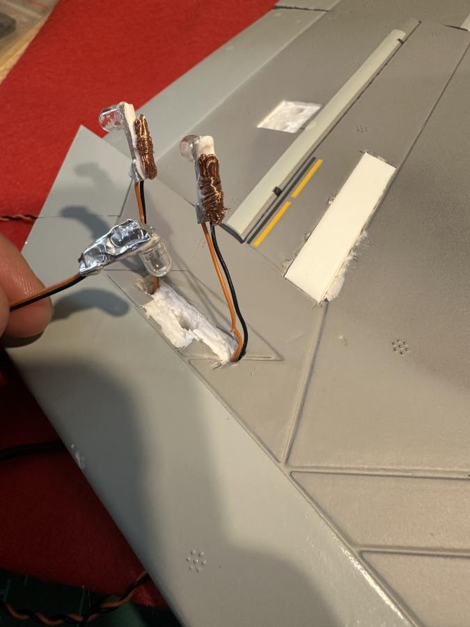

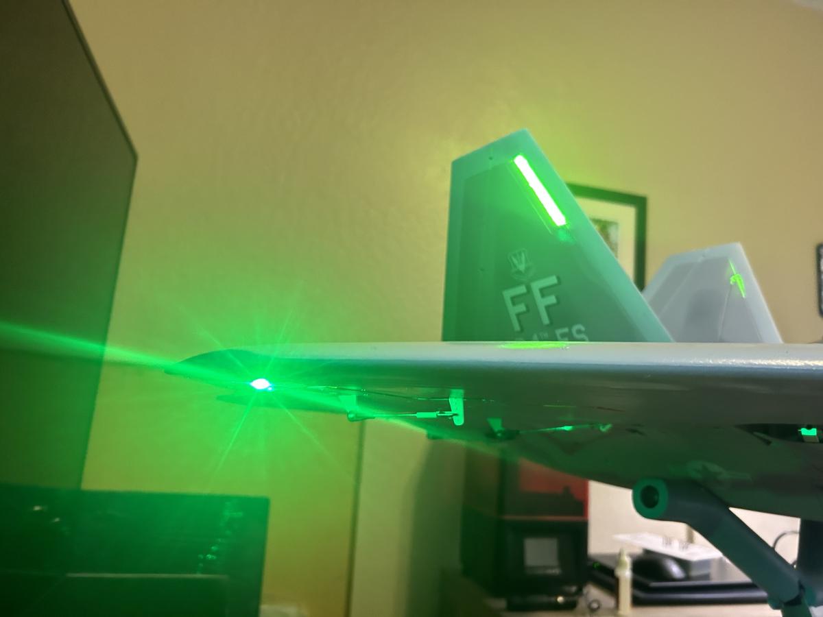

  • HamiltonsHangar

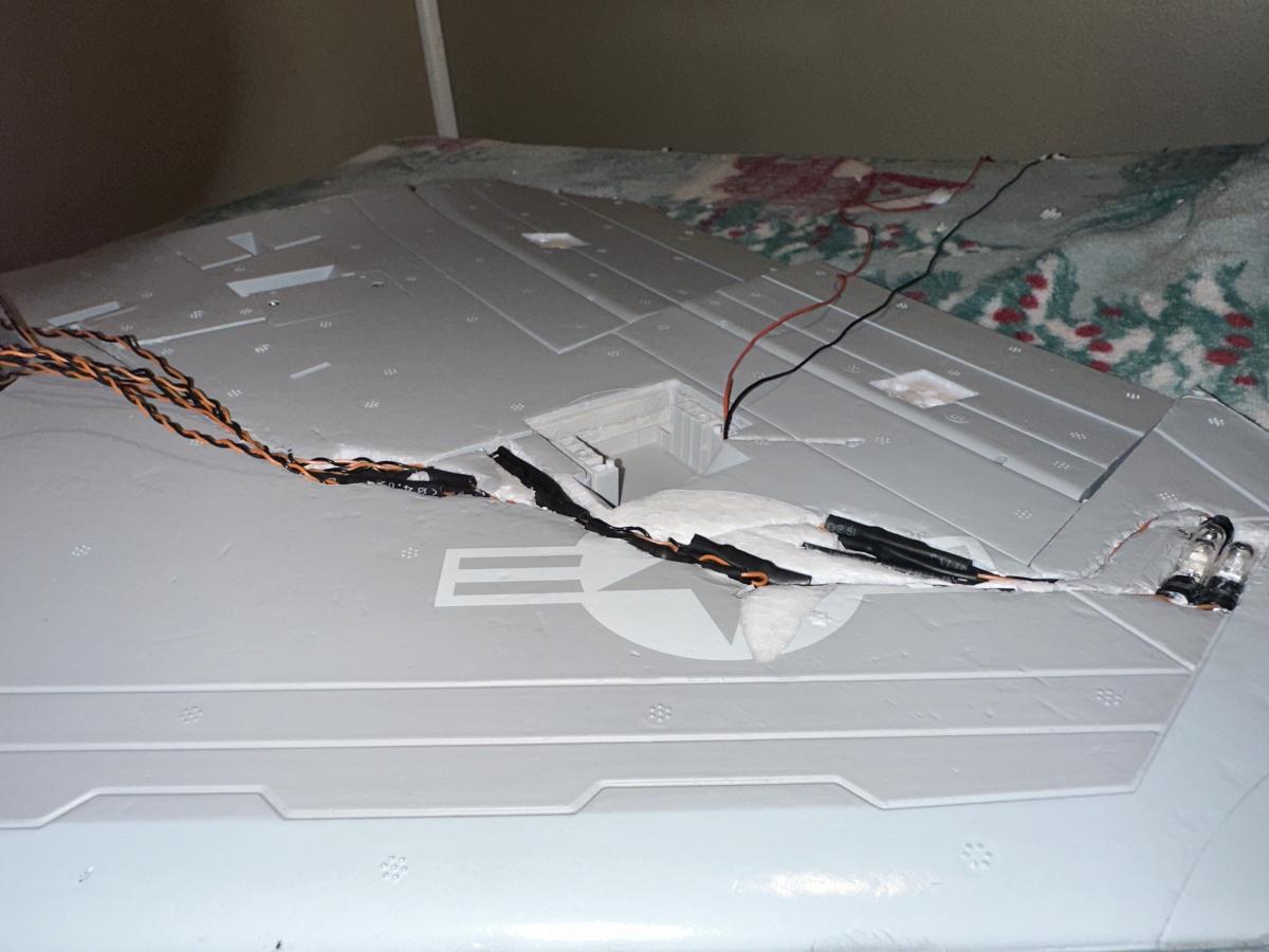

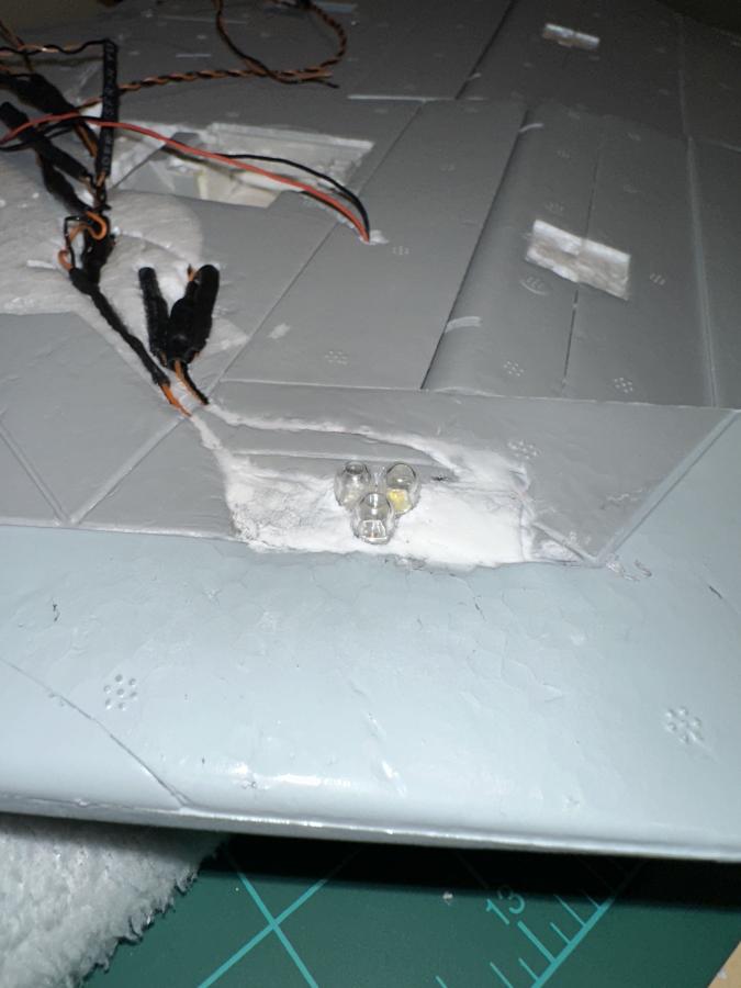

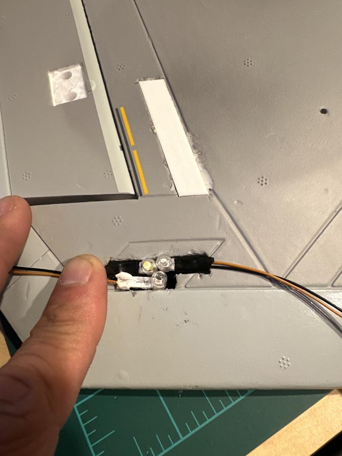

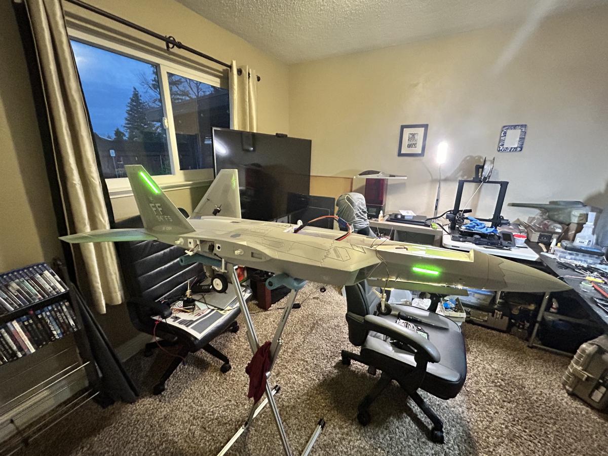

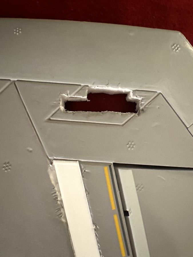

    Some more work in the scale lighting. The lights on the top of the wing, and the bottom. I went with 5mm unilights :) 🔴🟢⚪️

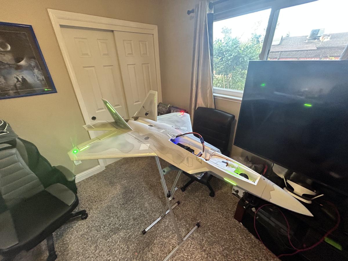

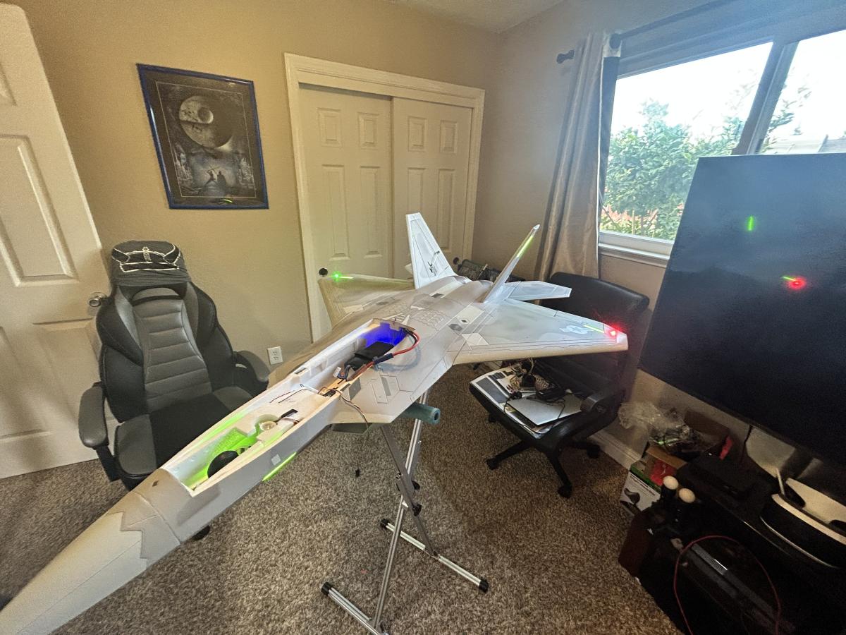

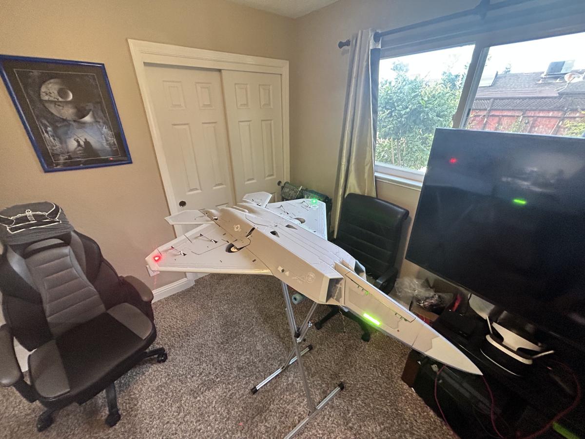

    Hello everyone,
    Here is some of the build process of the Freewing F-22 Raptor (Super Scale) I am currently building. I have completely gutted the entire plane of all servos, wires, and wing connectors. Everything will be custom and high quality, as this is my personal preference. Ive flown this same model but different airframe many times over. This is my favorite jet of all time. I have had the jet for 4 months now and have slowly been working on it. I have some more to post on here as well. She will be powered on 12s with 17lbs of thrust for no reason :)

  • Gravythe clown

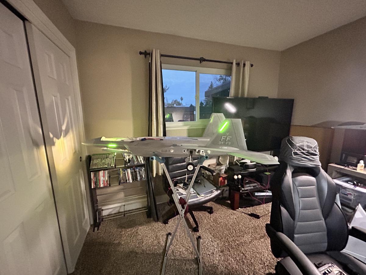

    Got my maiden done today. The new power system is much better, tailerons is the way to go, and the Dubrovnik tiers are great.
    the biggest thing though was the Nav and slime lights both visible while flying by the eye in partly cloudy sky.
    I got 3 flights in with a HRB 6s 6000. Good flight times, I going to see if there any improvement next time using a 5000.
    Gravy
  • Gravythe clown
    Originally posted by Elbee
    Gravythe clown Outstanding light mod. Bravo Zulu, Sir. Best, LB
    thank you sir. After doing the nav light mod, I now even understand less why they are not included in the kit.
    that was one of the this I disliked about my first 22, no nav lights in a big 90.
    Gravy

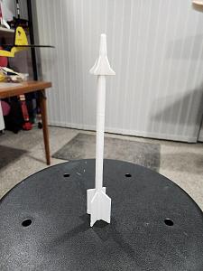

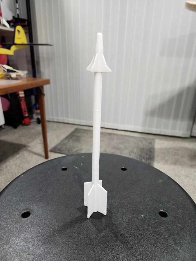

    My daughter made the AMRAM base symmetrical if you want to display it outside the launch rail Click image for larger version
